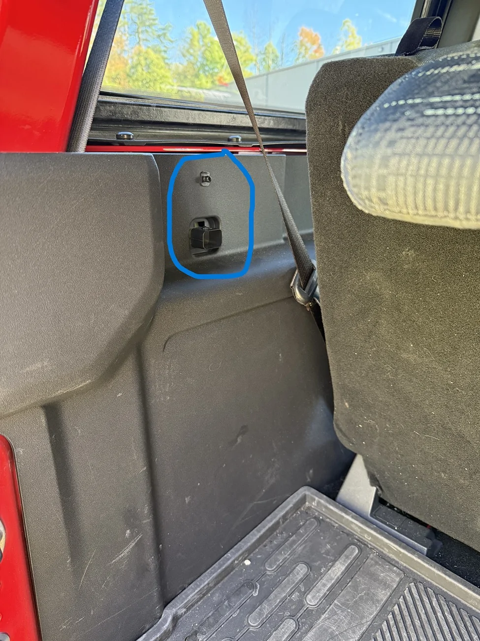

Hello everyone, new member here. First forum I have every joined so if I post this in the wrong place, I apologize. Have enjoyed reading the different posts here for the last couple of months. I bought my first Bronco a few months ago (2024 2dr Heritage) and just noticed what could possibly be some missing trim or something in the rear compartment area. Just wondering if it is indeed missing or just looks like that. I have really enjoyed my Bronco and get a lot of comments on it and I'm glad I traded my Rubicon in for it. Posting pictures of my baby as well as the section in question. I have hauled a lot of stuff in it and wondering if maybe I broke something off.

If im not wrong i think its for the connection that goes to lights when you take top off

When you remove the rear clamshell, you plug the harness that supplies power to the defroster and wiper goes there.

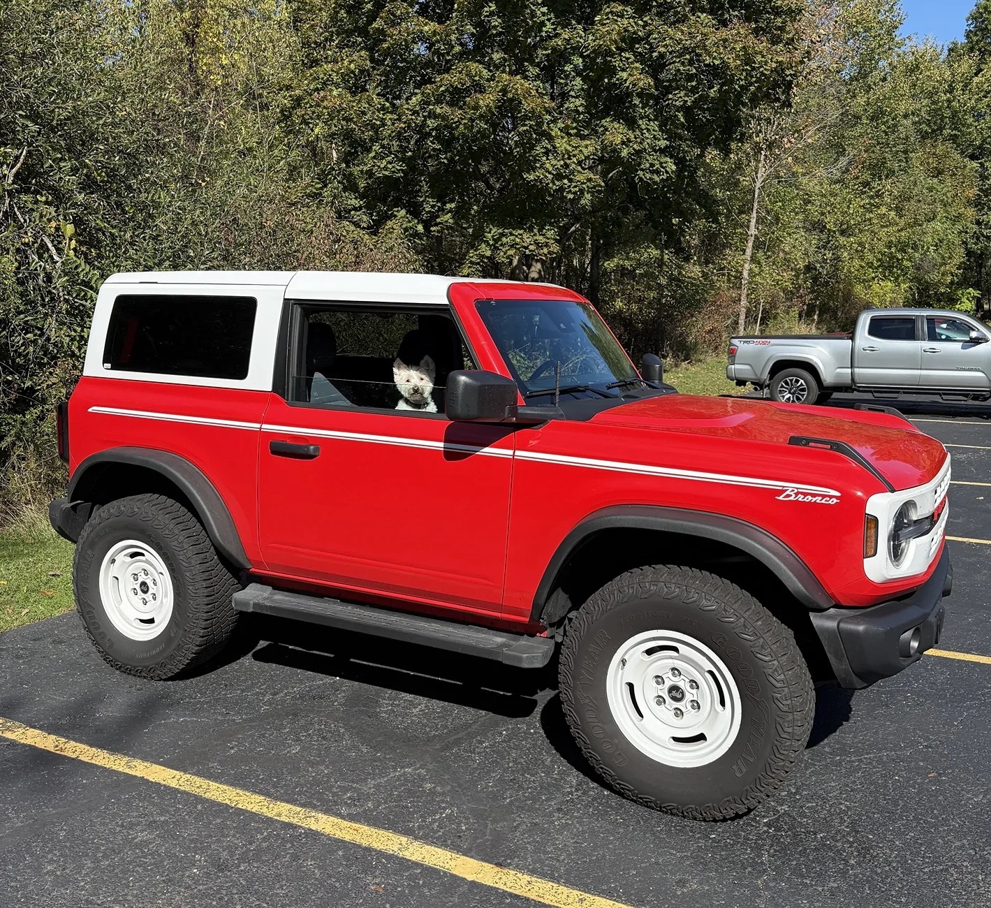

Great looking Bronco. I see you got a dog to match the wheels. Cool!

I actually got the wheels to match the dog but same thing. Thanks everyone for the quick responses, I really appreciate the help.

Yep - plug connectors (per above). No worries - I'm still finding little "Easter Eggs" in my Bronco & owned since March. Enjoy! :D

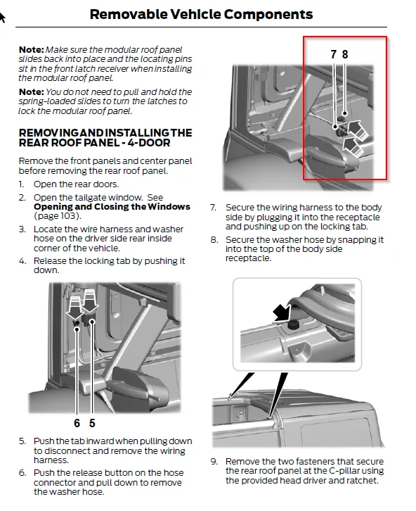

This is SO funny... There was a time when this was asked 3-4 times a month (I'm exaggerating, of course). Search on "What is this?".
A careful review of the Owners Manual will still be hard to identify what these are for (buried in the Removable Components section):

Anyway, great looking Bronco! I feel maybe ford should have put some kind of label on those since they are such a source of confusion.
