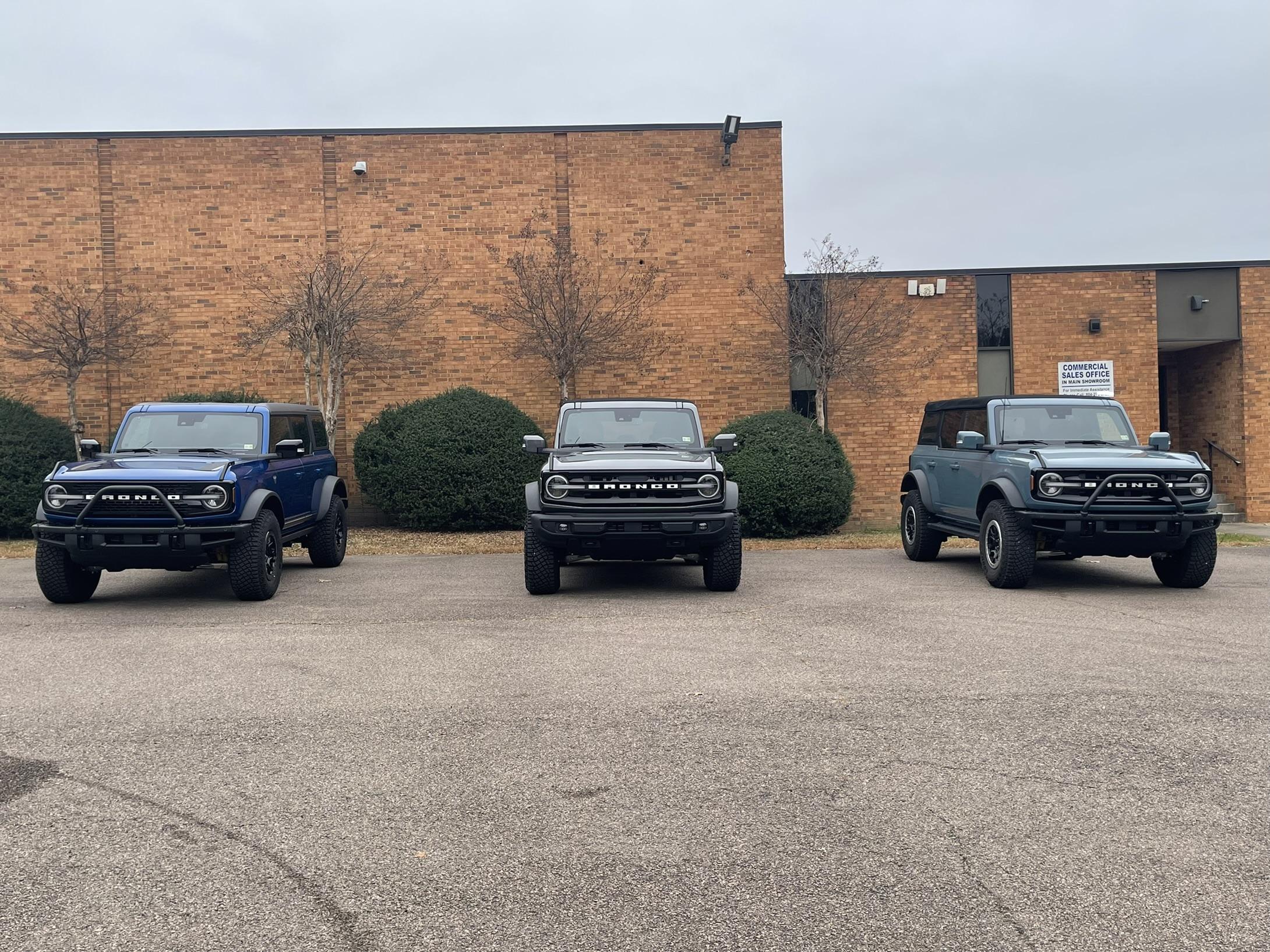

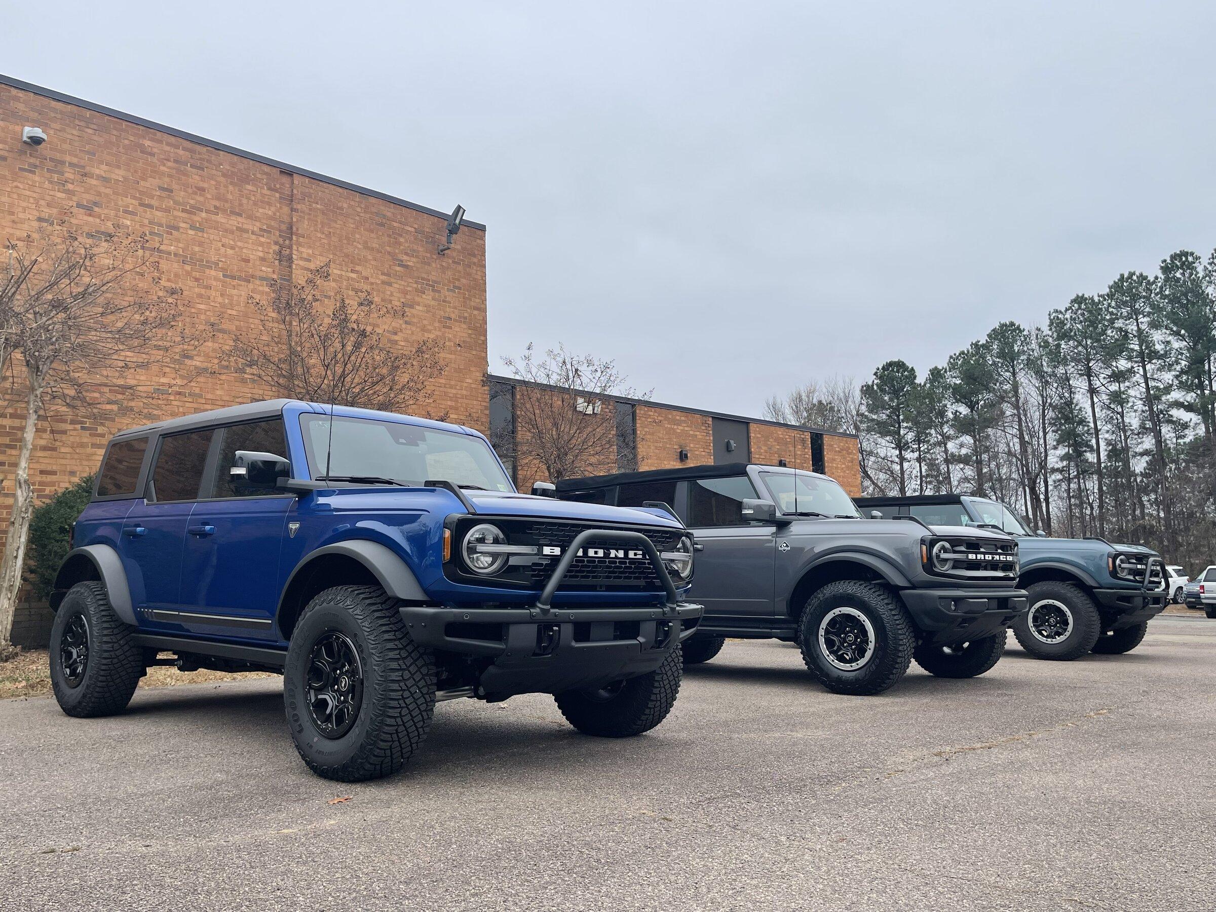

Some of my coworkers and I have finally taken delivery of our Broncos and are loving them!
We decided to park together at work yesterday when we noticed something odd.
One Sasquatch is noticeably taller than the other 2!
At first I thought maybe the FE was slightly lower because of the additional weight (hard top, hydraulic sway bar disconnect, etc). The weird part is the other two are both OBX soft tops and there is a significant difference between them!
The Carbonized Grey OBX does have a standard bumper instead of the modular, but I wouldn’t think that would make a difference of over 1/2” in height?

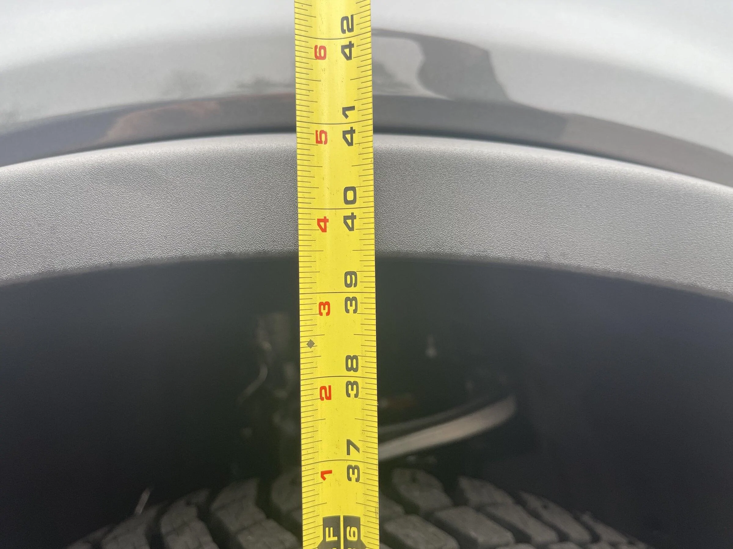

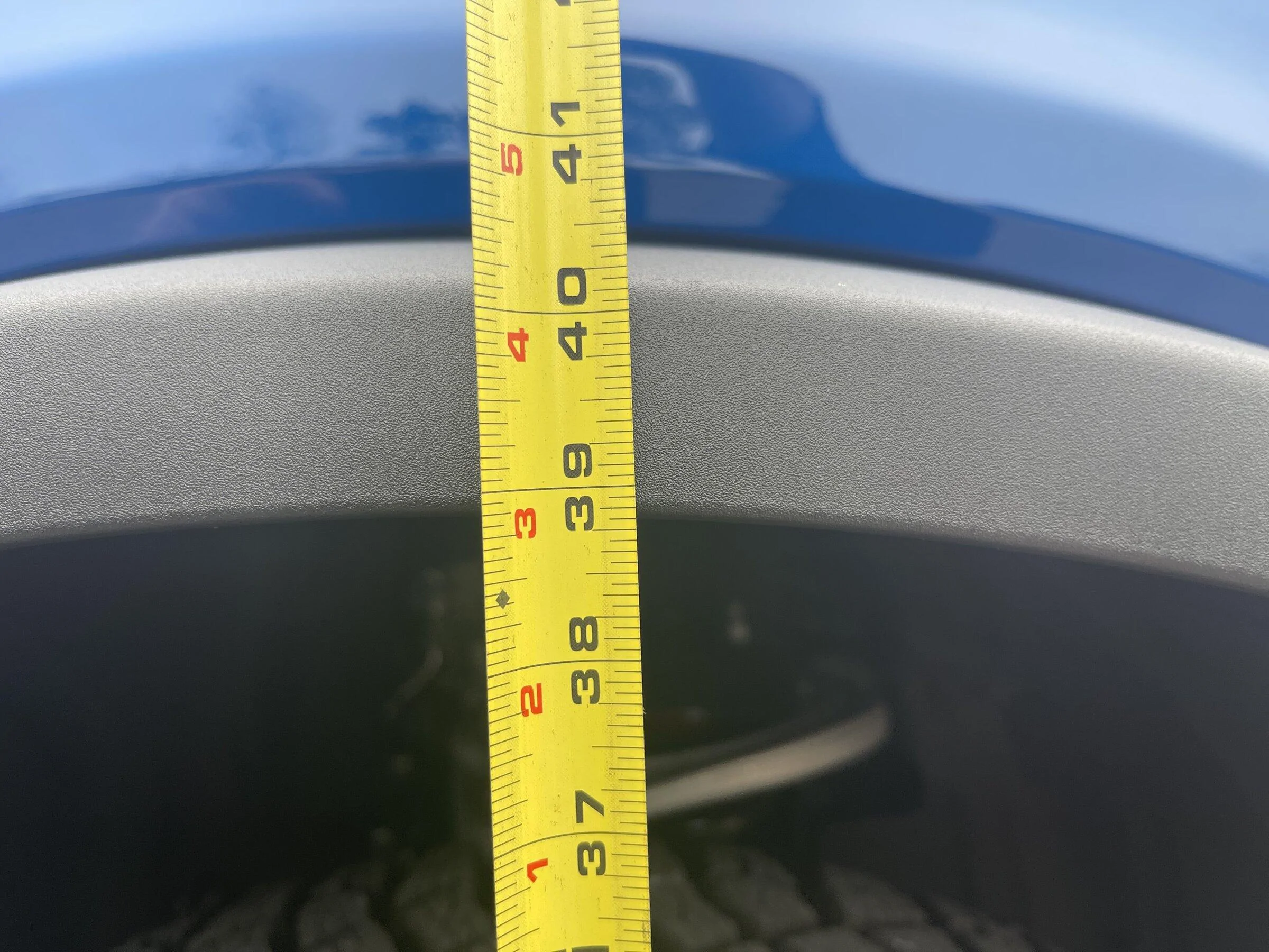

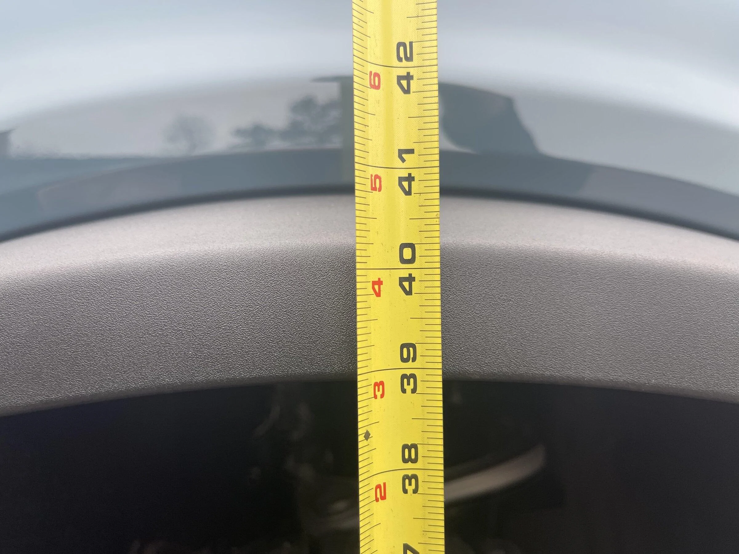

Area 51 OBX & LB FE measure less than 39” while the CG OBX IS NEARLY 39.5”
weird…
