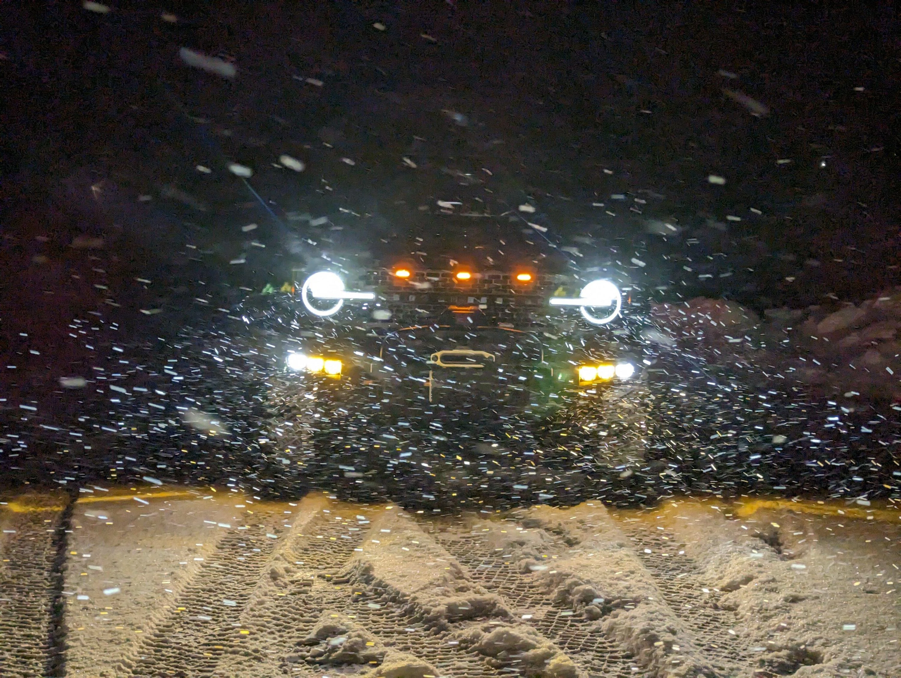

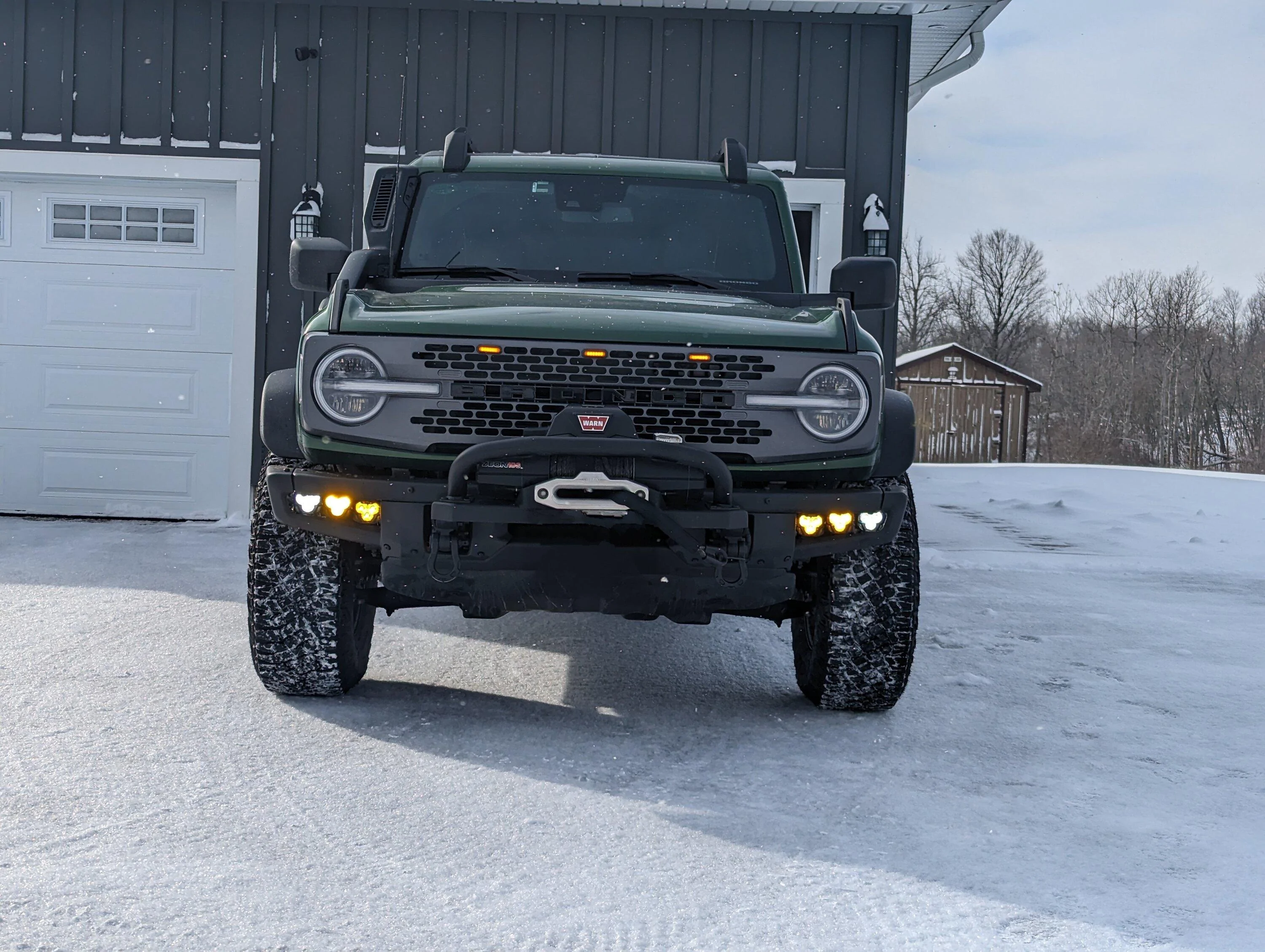

Installed the Morimoto fogs over the holidays.
I went with 4 Amber and 2 white beams. All in the wide beam pattern.
I decided to get the NCS models as the HXB I don’t think are street legal. I’m very impressed with the NCS line. Super bright and wide beam pattern.
I could easily drive with headlights off with these. I tested it. They have plenty of distance and I haven’t had one driver flash me yet so I guess they are aimed right.
It’s amazing how the amber helps with nighttime driving. I can see much better especially on poorly lit rural roads.
I bought the plug and play harness from Morimoto with the lights and brackets. Easy install. Harness is great quality.
Here’s a couple of pics. Highly recommend them. They are very high quality. Fit great. They Fill in the front bumper nicely.
