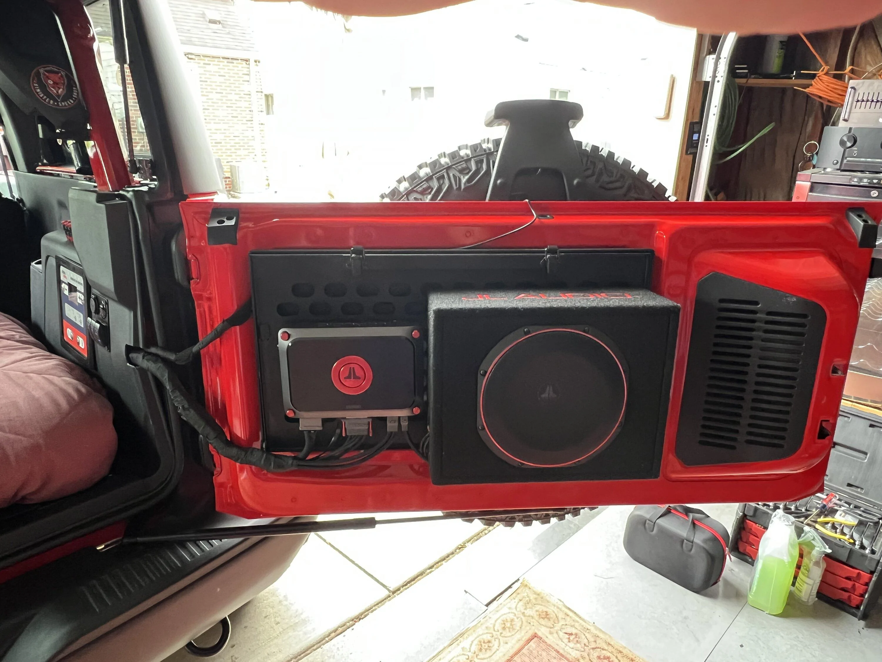

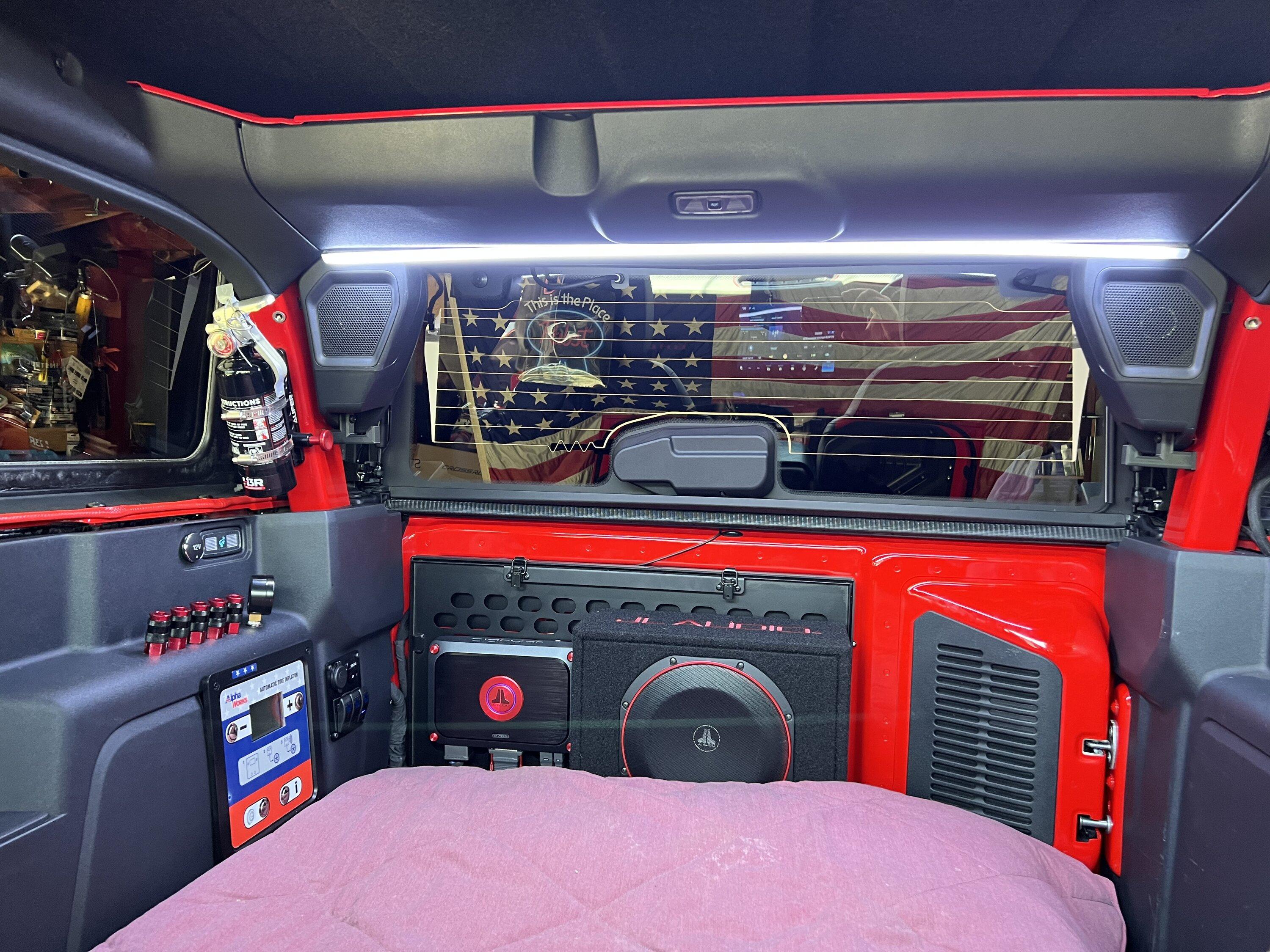

Kinda shocked that sub doesn't rattle that table like crazy...
No rattle's inside or out. That’s a little sealed 10 pushing 200 watts at 2 ohm. Can’t tell on the vid but it sounds real good.

Is that the ford tailgate or some other brand? Anything special that you had to do to keep it from rattling?
That’s the Ford table. Put 2 micro fiber sponges for waxing in the table and closed it up. Every rattle went away. Still fold down to work off of. I did use better rivet nuts and stronger cables. Easy upgrades. 25 lbs max load is bs for a table.
Mti makes a box for the tailgate too. I still wanted my table.
