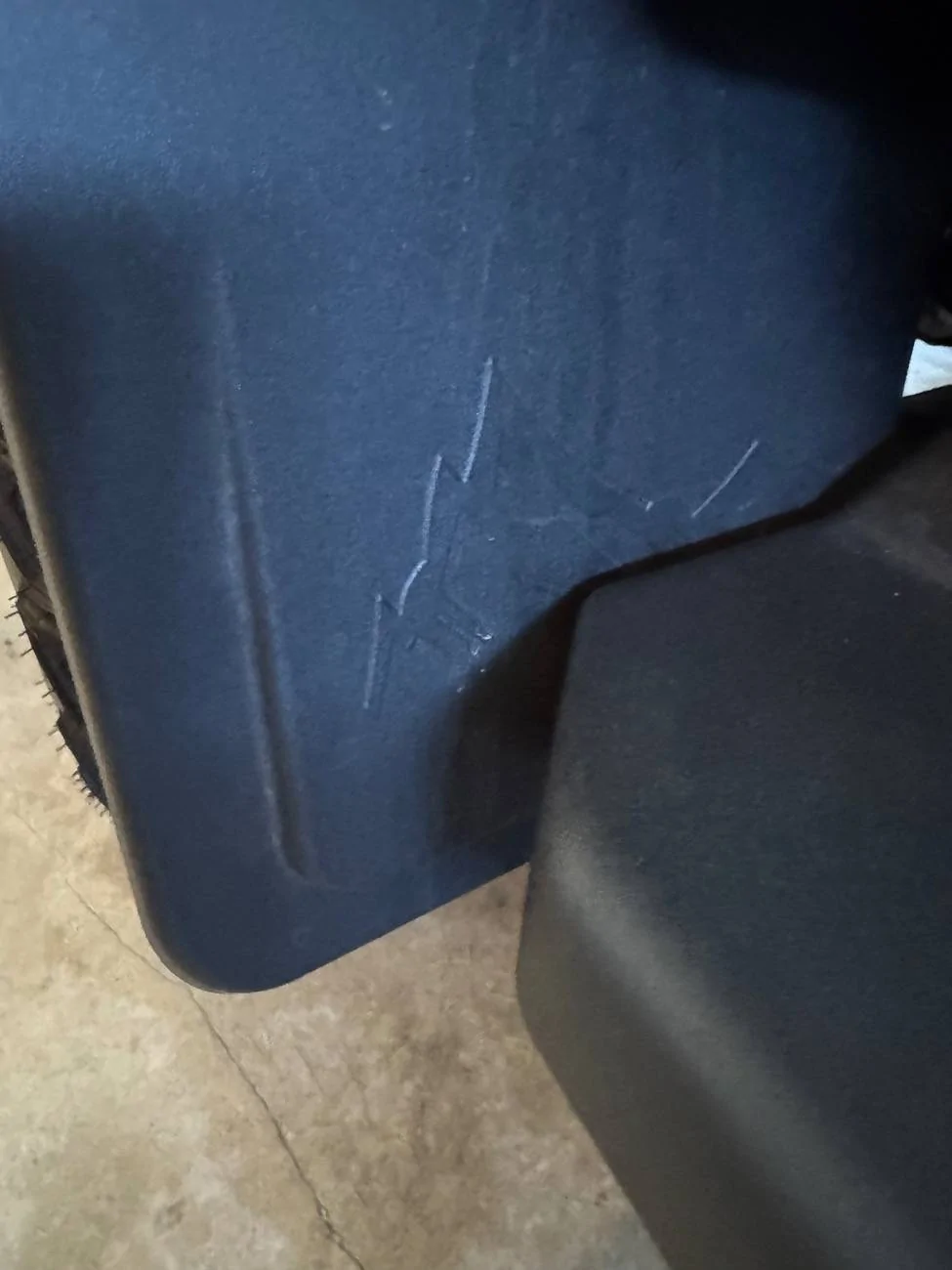

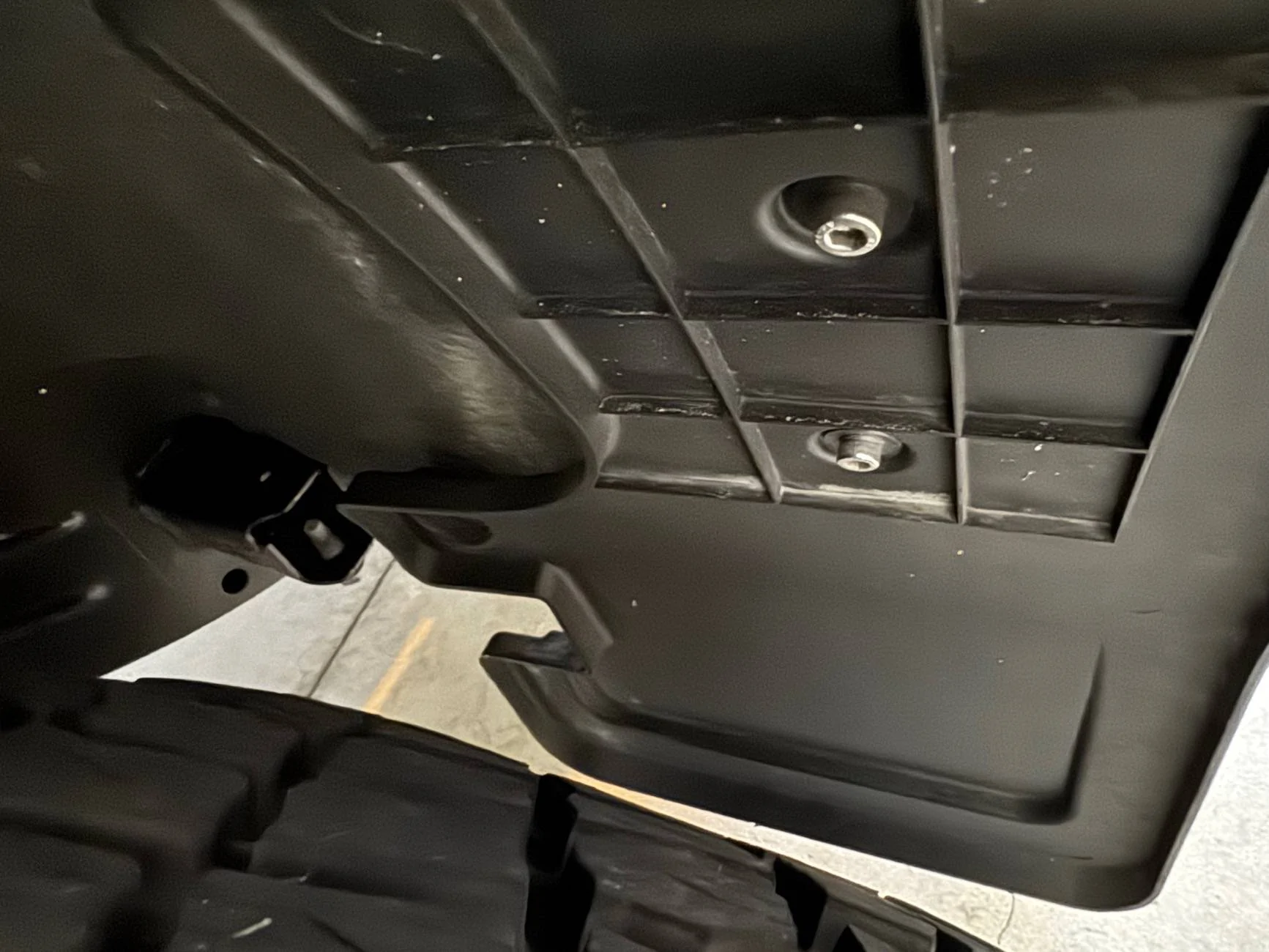

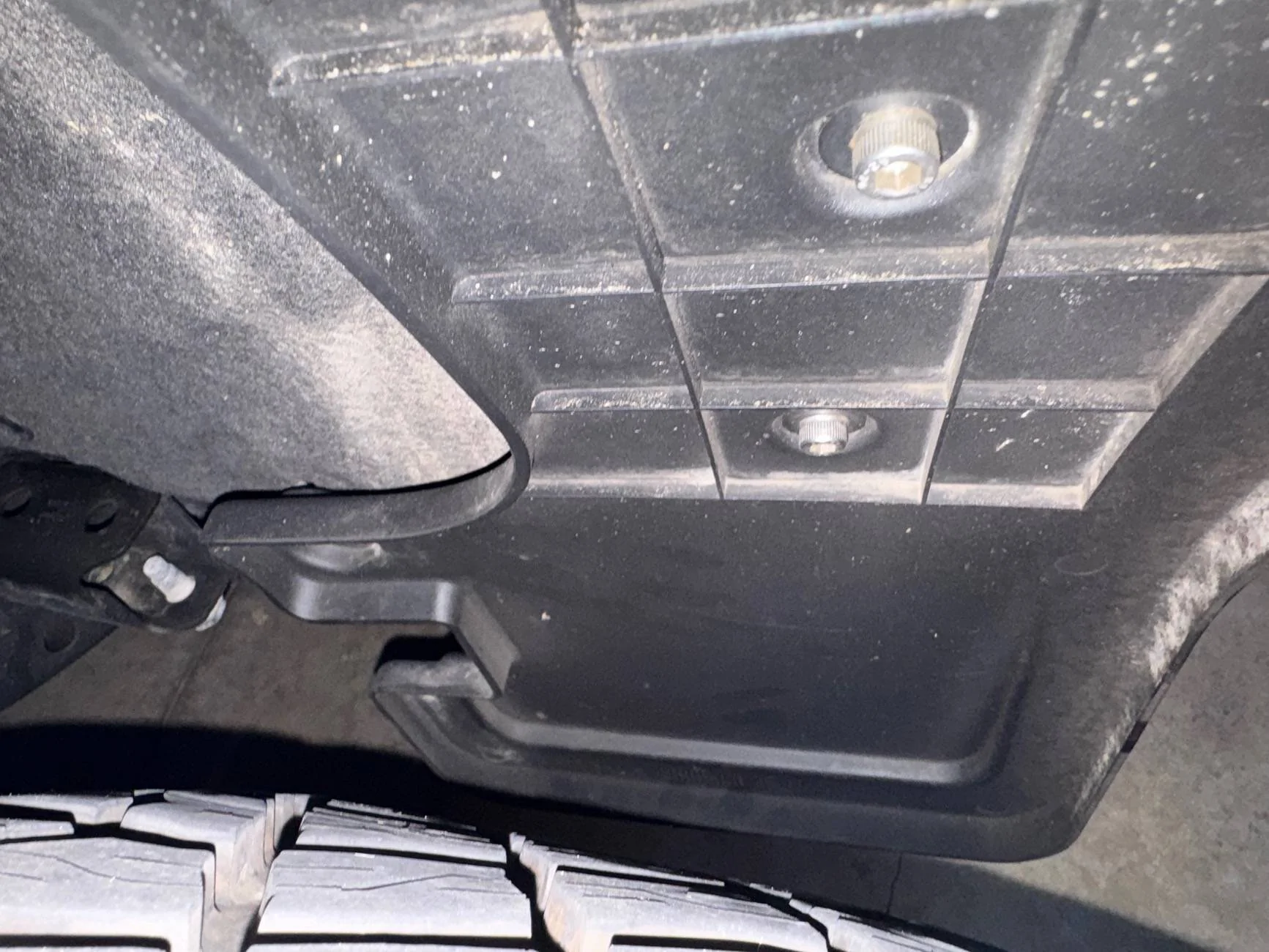

Good morning! I just got my Bronco this past weekend. The previous owner put in some mud flaps that I like but both of the front ones look like they are missing the innermost bolt. Anyone know what brand these are? Is there supposed to be a third bolt in the innermost hole for the front ones? They seem to be rattling at highway speed. Appreciate any help you can give me!
Ford Bronco Mudflap/Rock guard question IMG_4759
Ford Bronco Mudflap/Rock guard question IMG_4760
Ford Bronco Mudflap/Rock guard question IMG_4761

Those look like IAG. That third hole is for a push in Christmas Tree type trim fastener.

They aren't ours. But yes, a christmas tree fastener or the plastic 'scrivets'.

Oh no! I just got off the phone with you guys and you guys were going to send me some replacements. I guess I will see if they fit. Thanks for the heads-up.

YEP YOU REMOVE CHRISTMAS TREE AND REINSTALL
