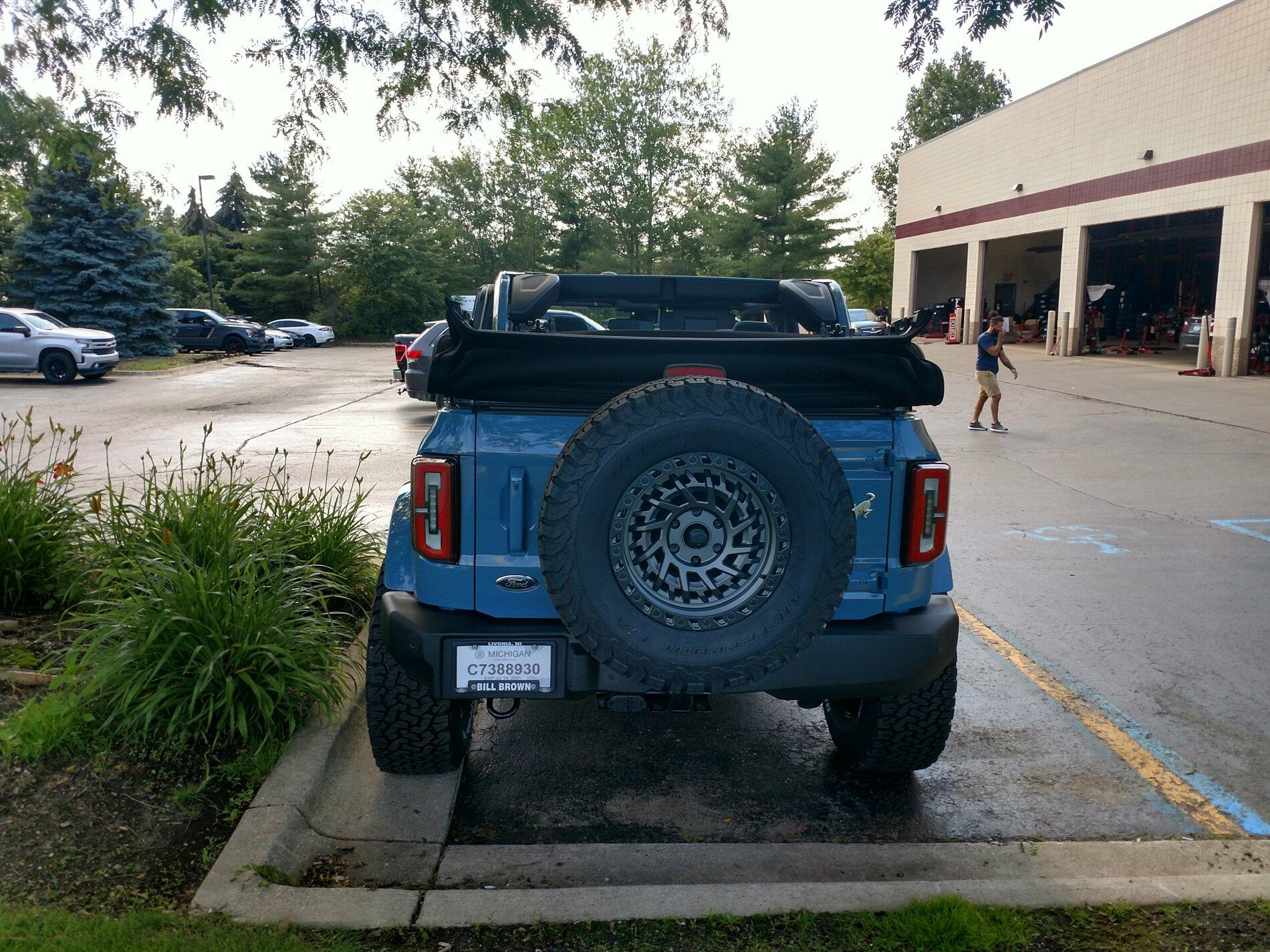

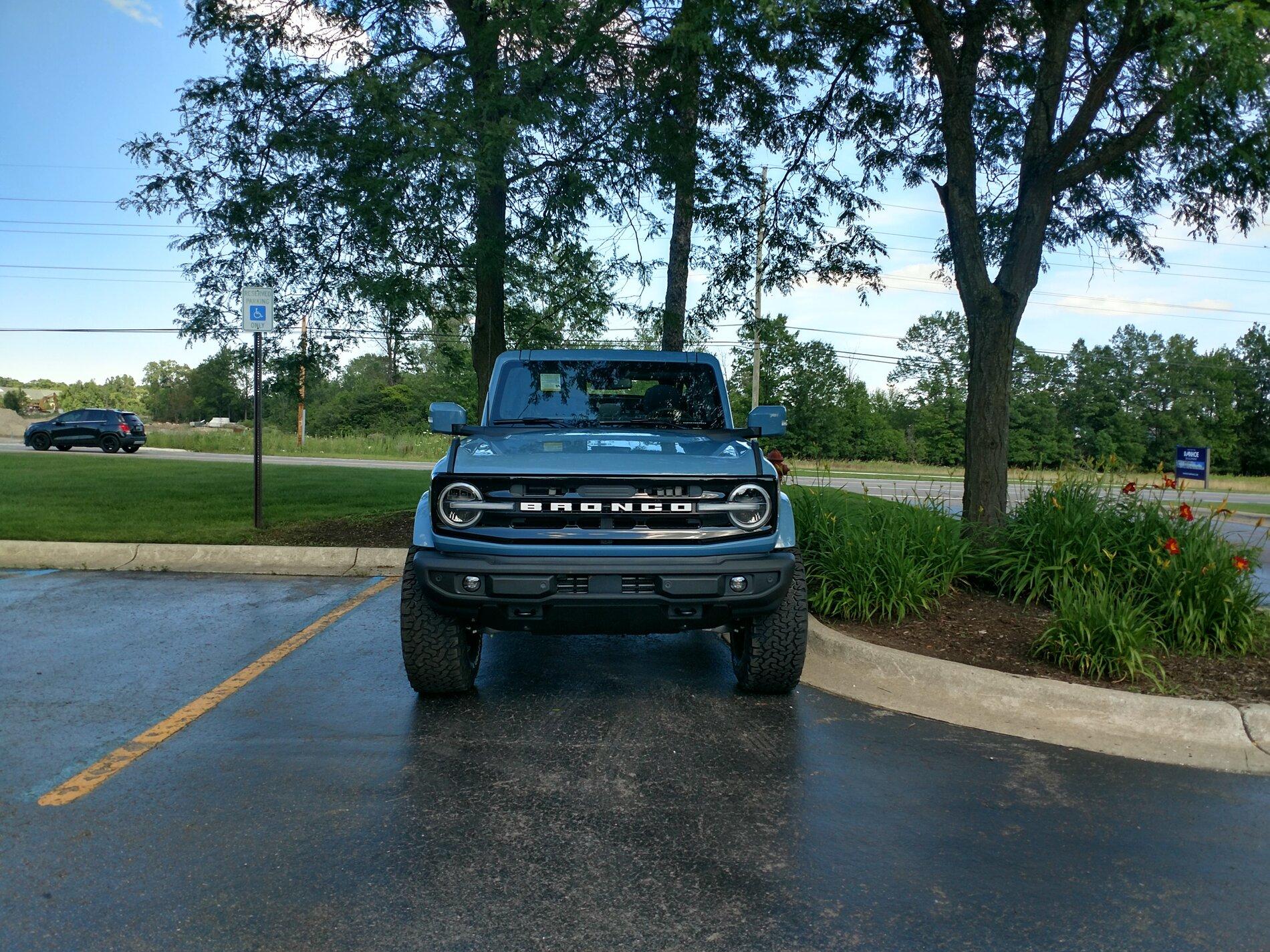

Then we went to discount tire and my son had the wheels and tires ready.

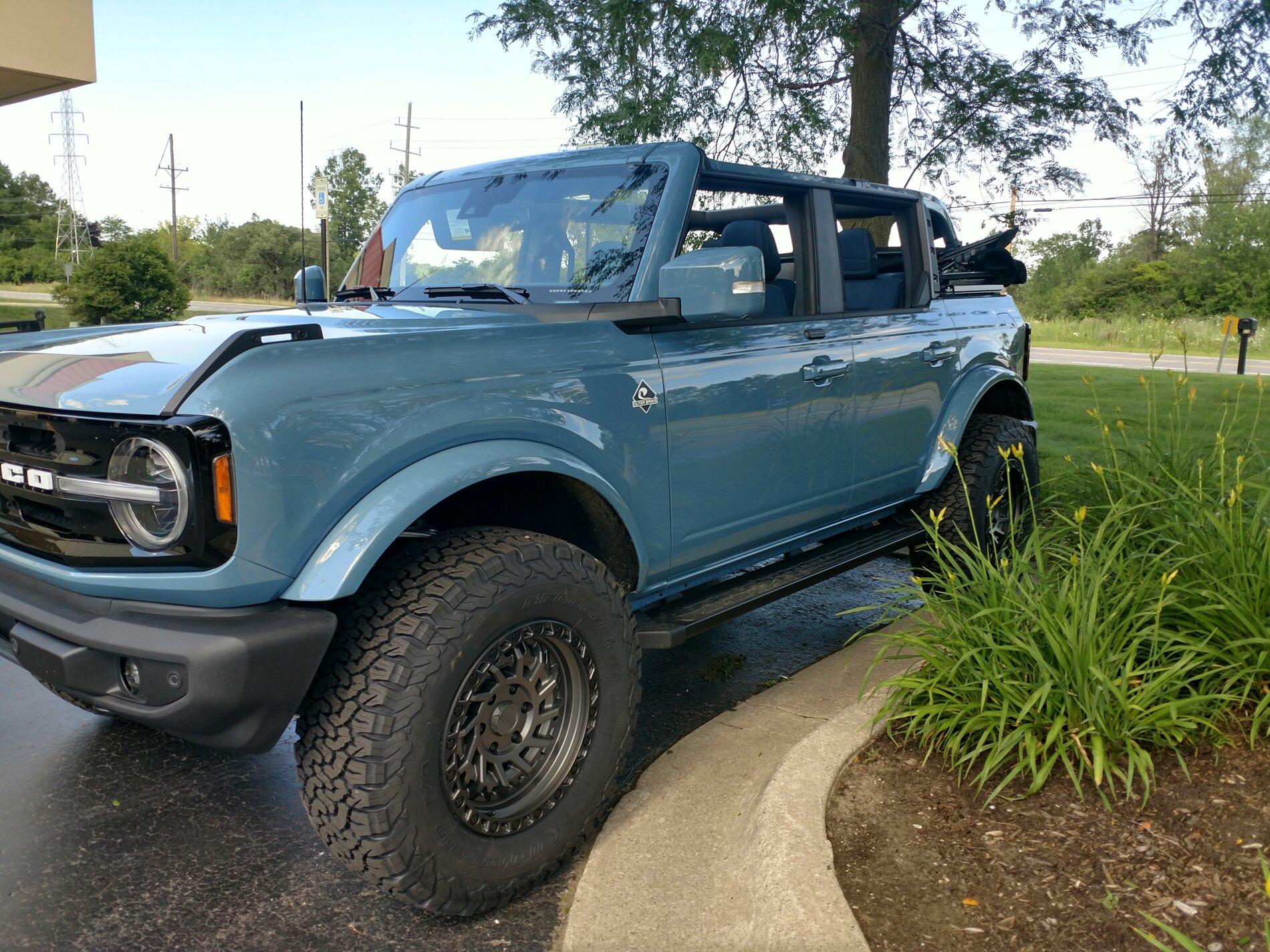

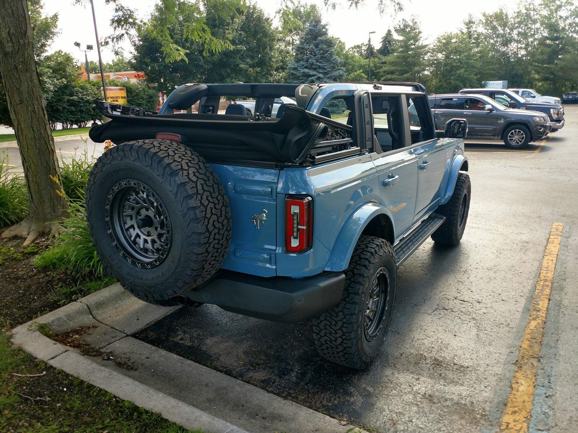

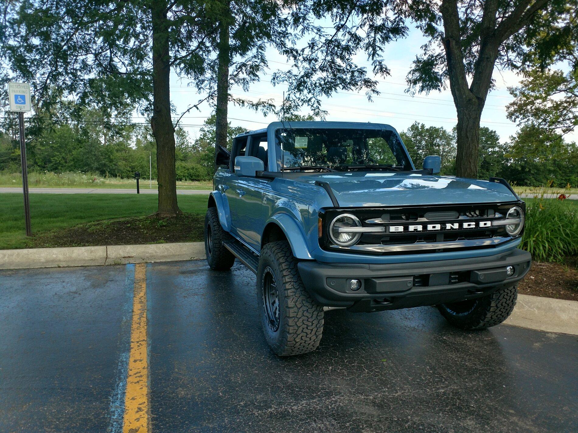

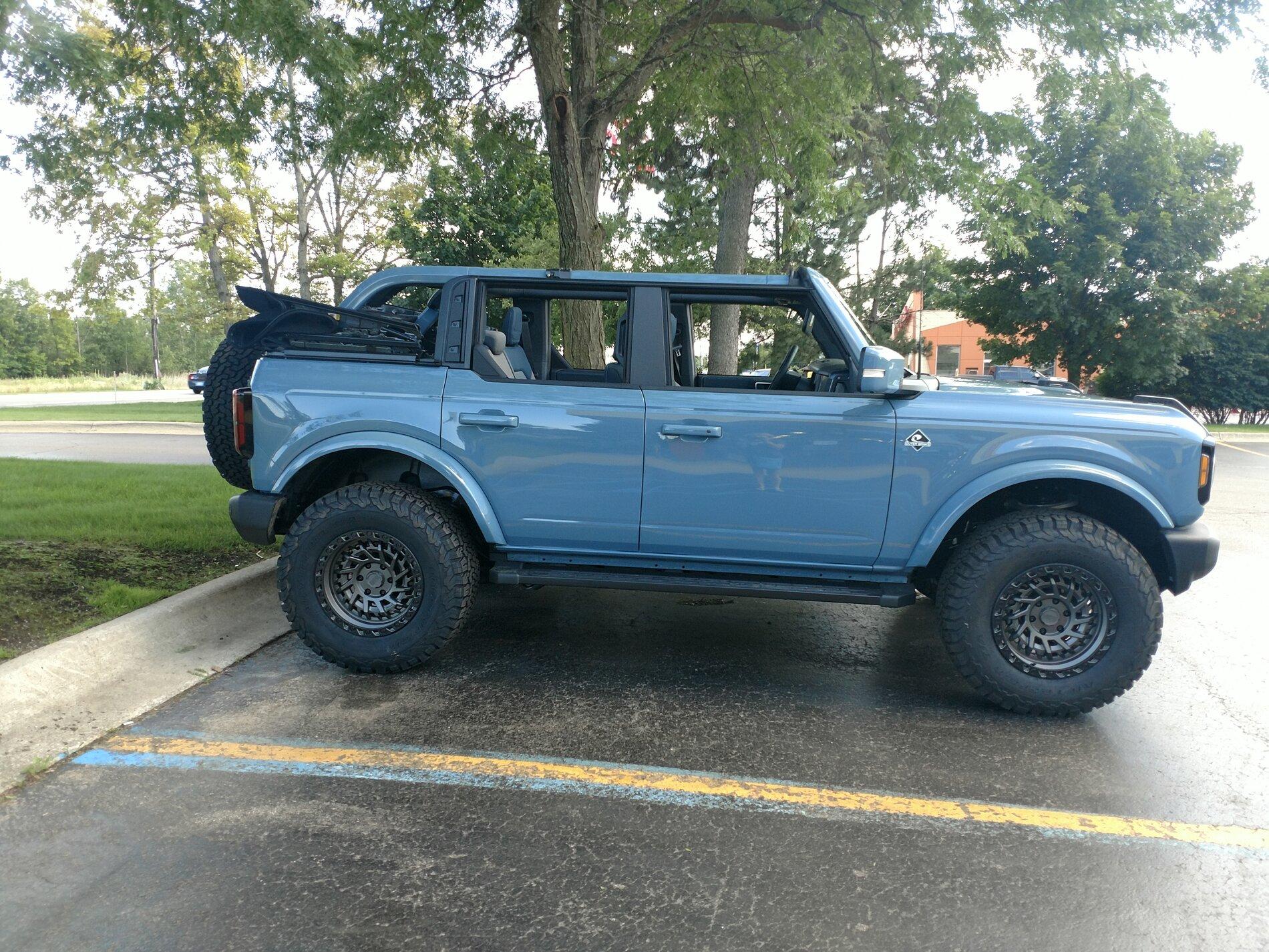

35 x 12.5 x 18 bfgoodrich ko2's on black rhino shredder Wheels 18 x 9.5 with +12mm offset.
What a change, doesn't even look the same. We are super happy the way it turned 6.

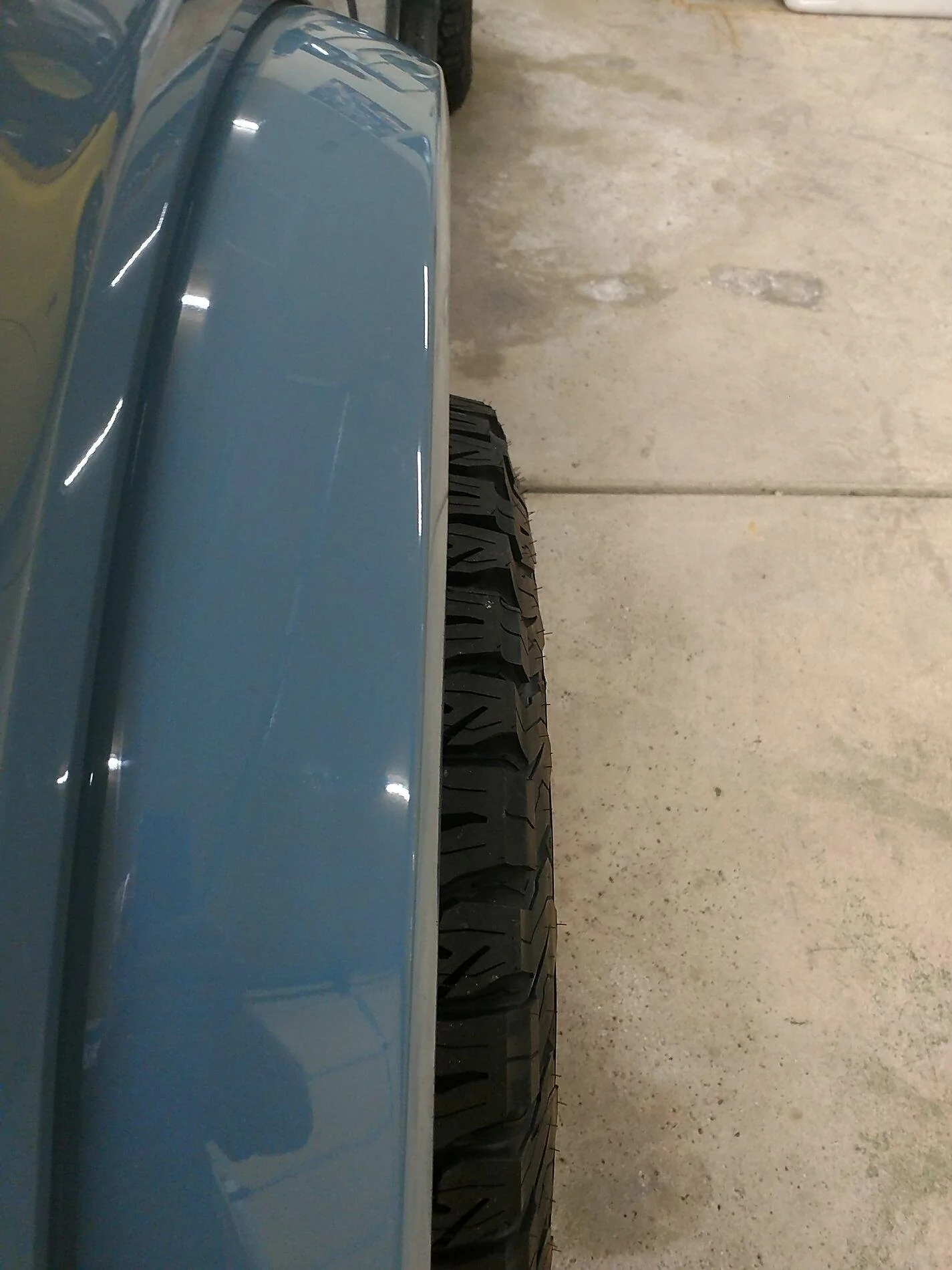

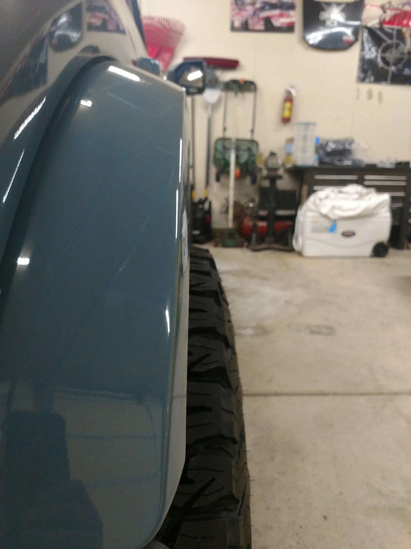

No trimming, no rubbing. I did remove crash bars
No modification to spare mount, so far no issues
