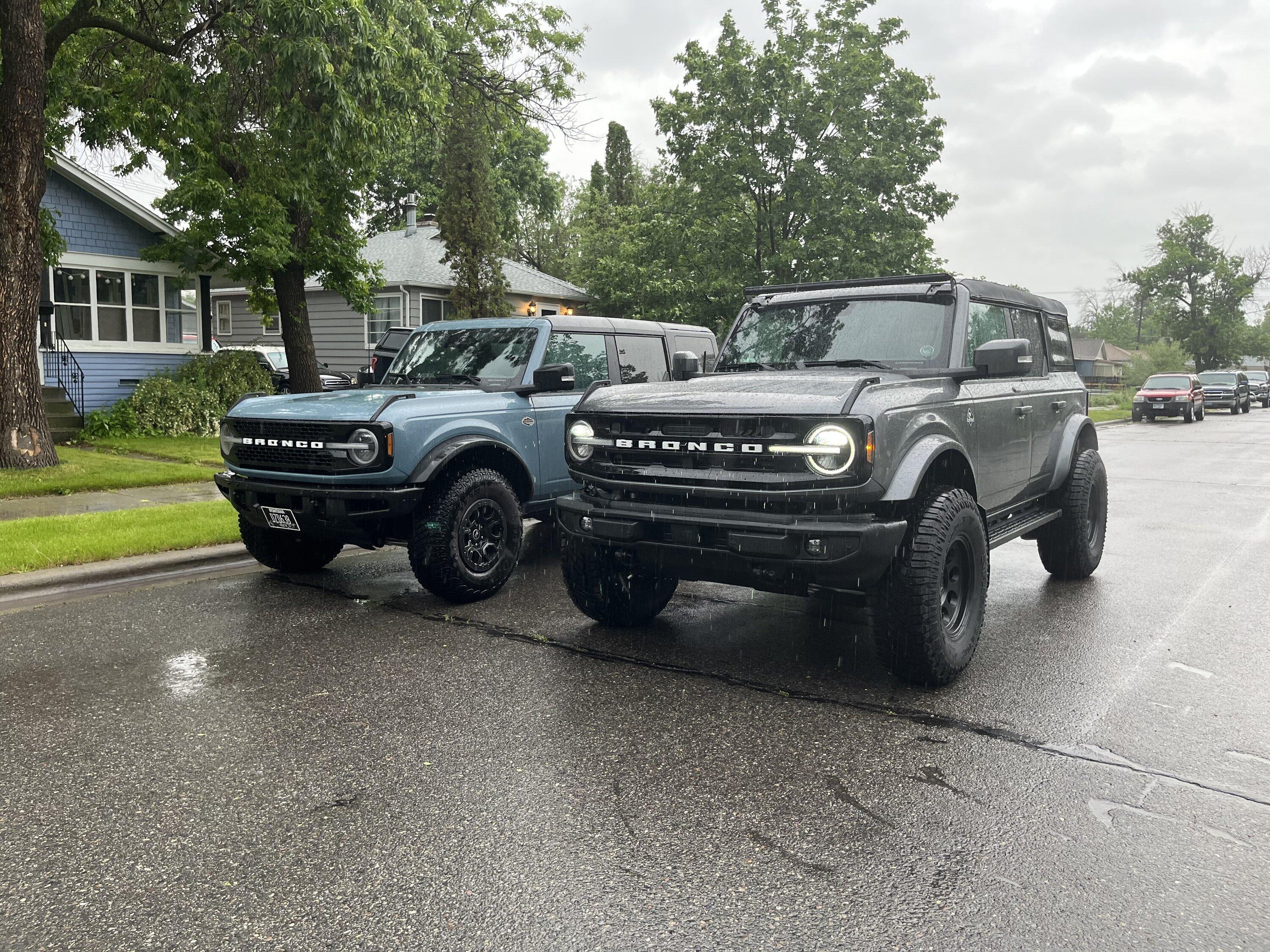

Above photo: Left is mine with 2” lift and 2” body lift, and stock tires. Middle is the wife’s on 33’s. Right is a guy who parks on my block to get a ride to work (he just wanted to get in on the pic).
Ford Bronco Montana Bronco Outer Banks Build IMG_0976
Above photo: 37’s installed next to the guy who parks on my block for comparison.

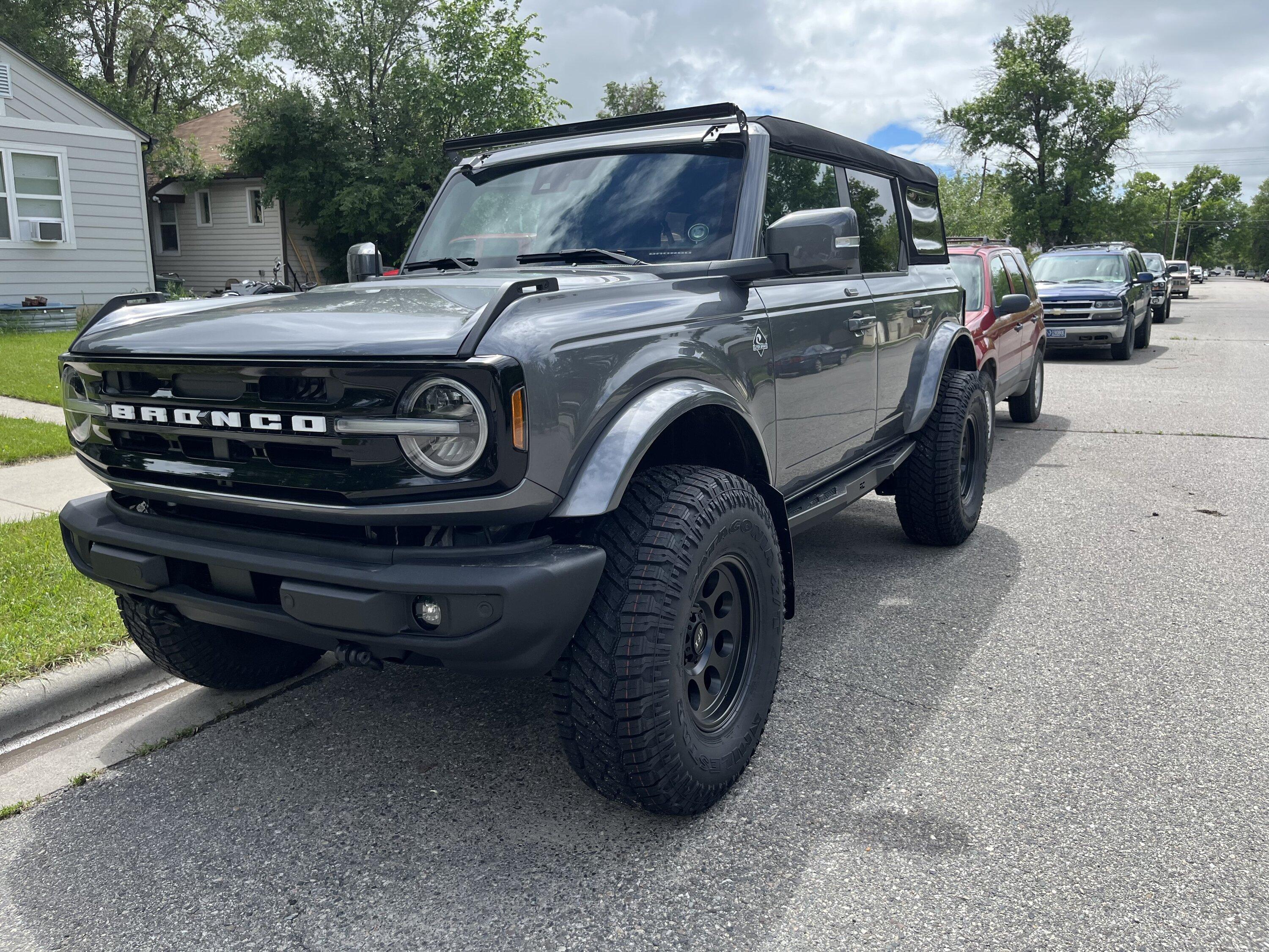

I opted for a 2” spacer lift to get more articulation out of the front with more droop. I added 2” body lift to squeeze the 37’s in. I knew I would lose lift when I added all of the weight. My wife’s is stock, except she put on 33’s. I’m only 4” higher than hers. That’s with 2” lift, 2” body, and 2” more from tire. So I lost 2” with the weight. Not horrible. My back end is about 1/2” higher, but when I eventually put on a steel rear bumper I’m sure it’ll be closer to even all around.

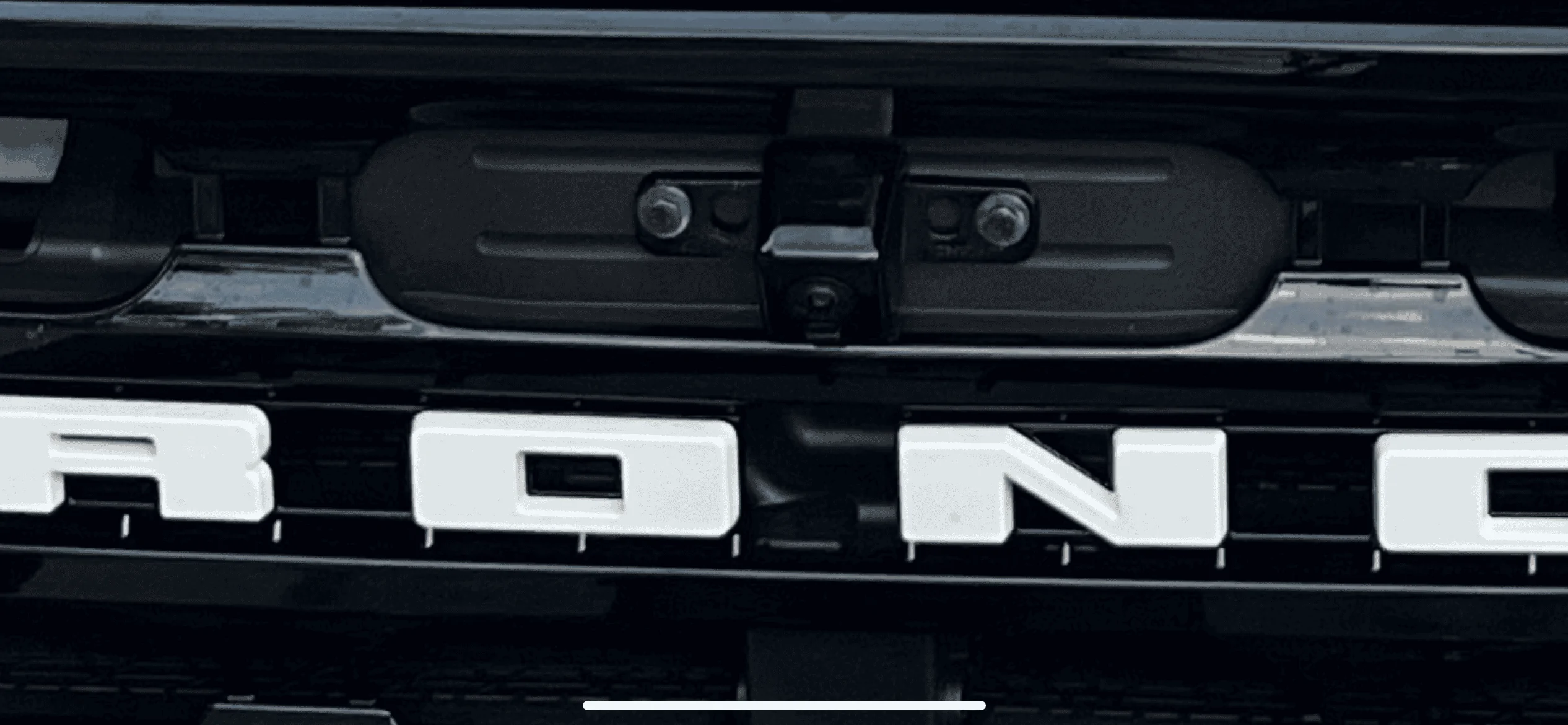

Love the build. What bumper is this??......
Ford Bronco Montana Bronco Outer Banks Build 1691351643479
MikeM173
May 15, 2023
Montana
2023 Bronco
Just based on photos of it and how it mounts I would imagine it would. I didn’t use a relocation kit. I just moved mine up. Here is a pic of how I did mine. Free minus hardware which I already had.
Ford Bronco Montana Bronco Outer Banks Build IMG_1156
That bracket would give you a cleaner camera view I would bet. It definitely looks like it would work though.

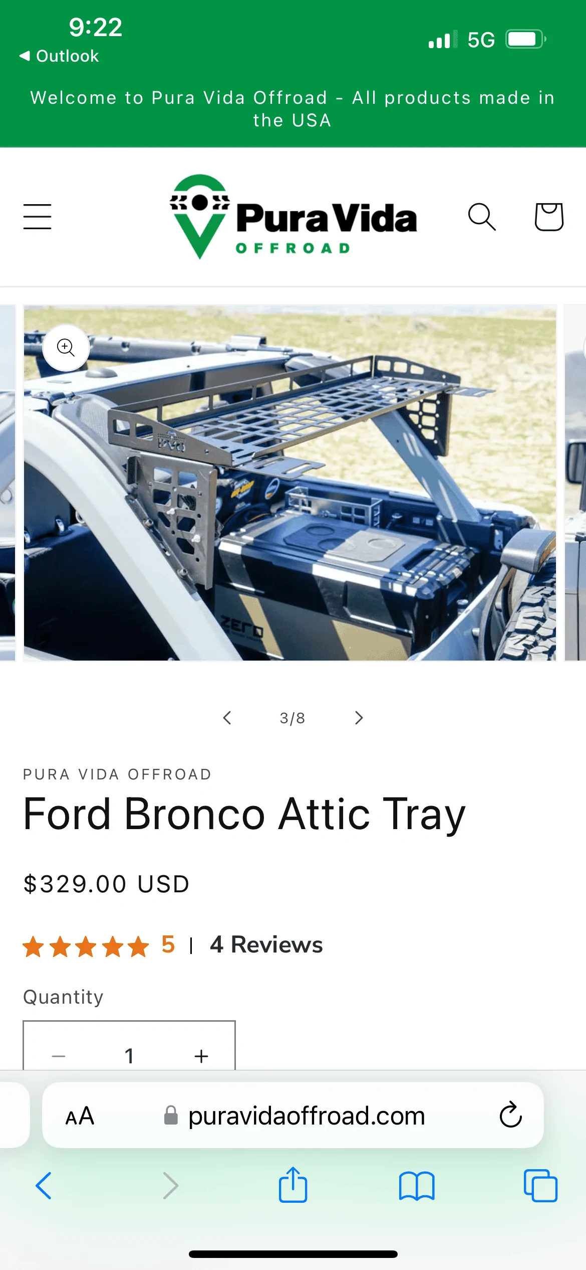

The upper rack is from a member who created it and then started producing it. It’s costly, but it fits my needs on allowing more storage without just packing stuff on top of itself. Is it needed? No. Do I like it a lot? Yes. I did shave part of the brackets that hold the upper tray down, as they stick out bast the tray and had no real purpose to. I was still able to mountain the traction boards with no issue.
Ford Bronco Montana Bronco Outer Banks Build IMG_1158
$329 is for the tray by itself. You would still need the brackets. I used this picture as you can see how the brackets stick out past the tray. That is what I trimmed down. Otherwise the brackets kind of make contact with my soft top when I raise it. Plus having them stick out limits the length of items I can put in the tray from the rear between the back window and tray.
