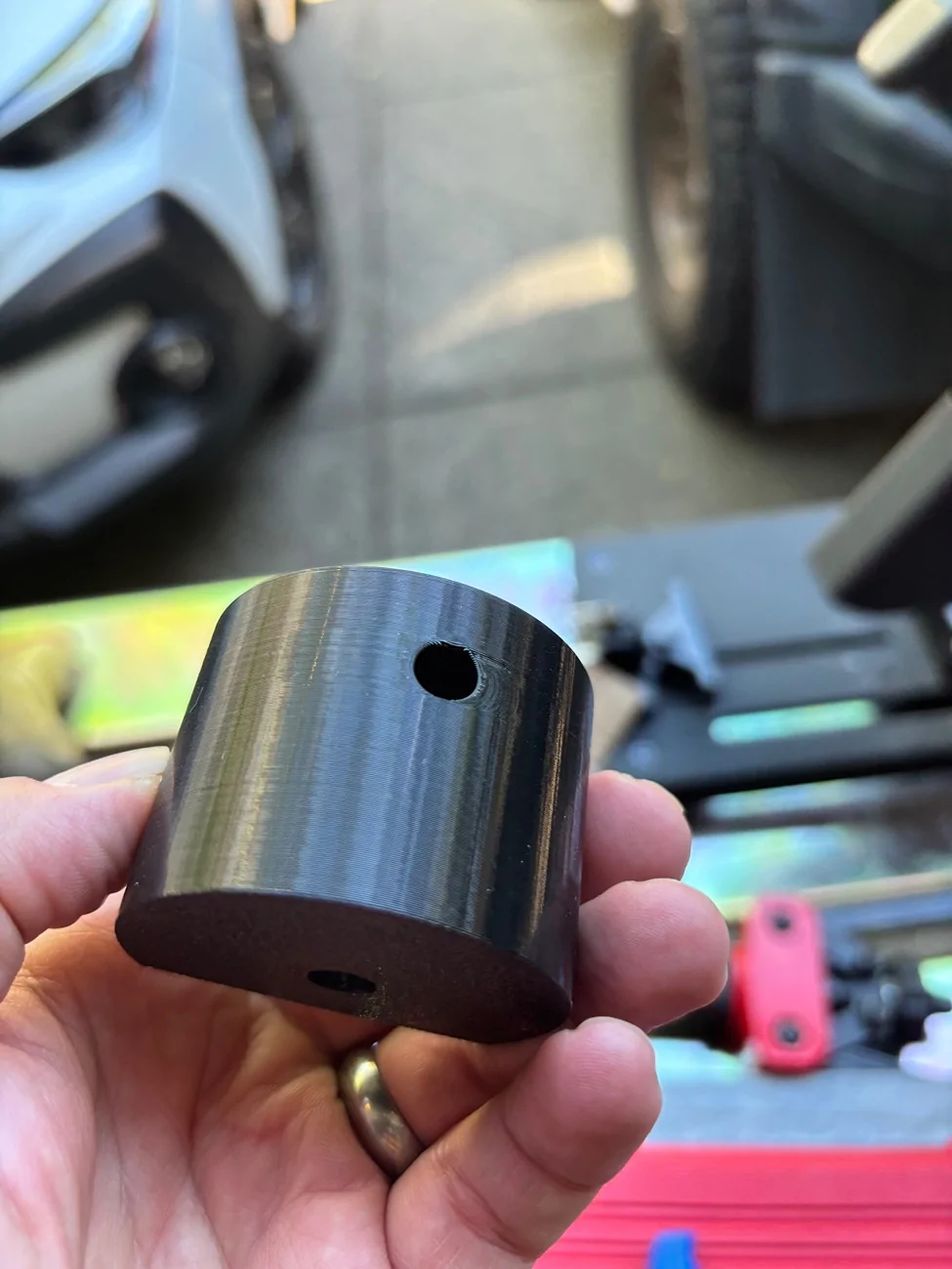

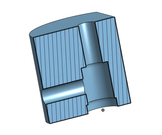

This is my take on the excellent design by @RHeinz https://www.bronco6g.com/forum/threads/starlink-mini-installed-for-remote-camping.106167/
I'm not sure if this will be my final design but I had all of the components sitting around. Don't ask why I have spare 1in wide steel in my inventory. But I definitely keep a supply of rivnuts.

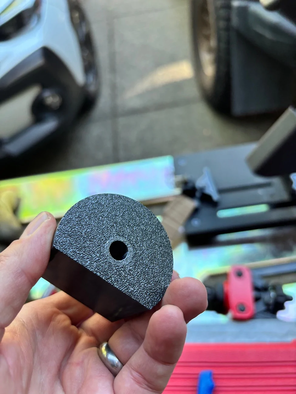

The first step was a mount, I think some people use a camera tripod mount, so 1/4-20? but since I could print my own mount, I did.
Ford Bronco My Starlink Mini Mount Screen Shot 2025-08-22 at 3.22.05 PM
Ford Bronco My Starlink Mini Mount Screen Shot 2025-08-22 at 3.22.35 PM
Ford Bronco My Starlink Mini Mount IMG_6574
Ford Bronco My Starlink Mini Mount IMG_6572
Ford Bronco My Starlink Mini Mount IMG_6573

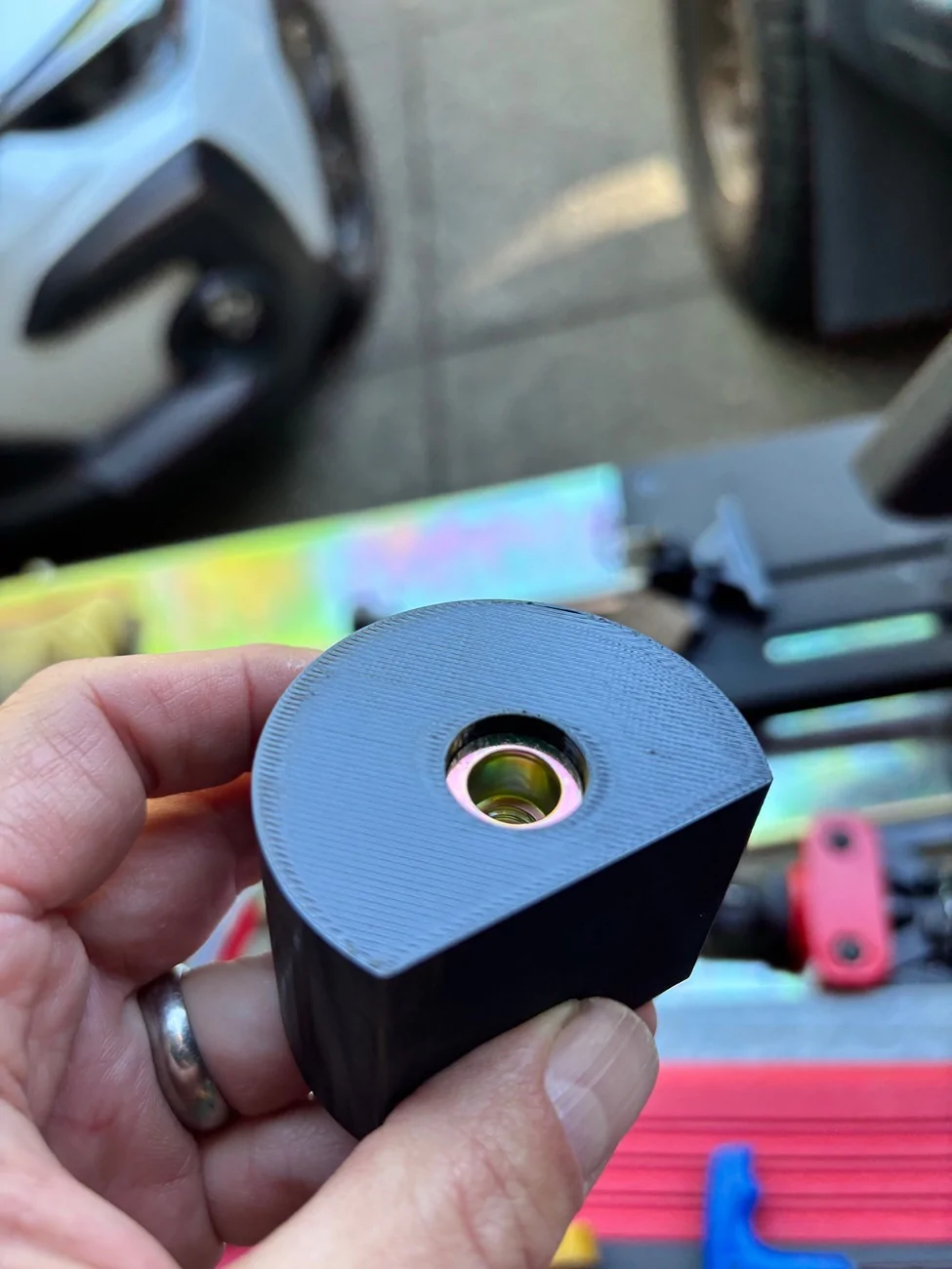

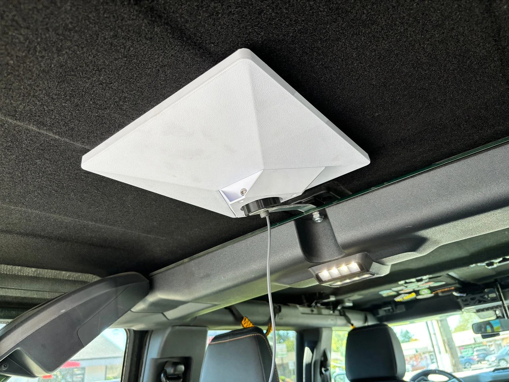

I inserted a M8 rivnut in the mount and then a shorter M6 as a set screw.

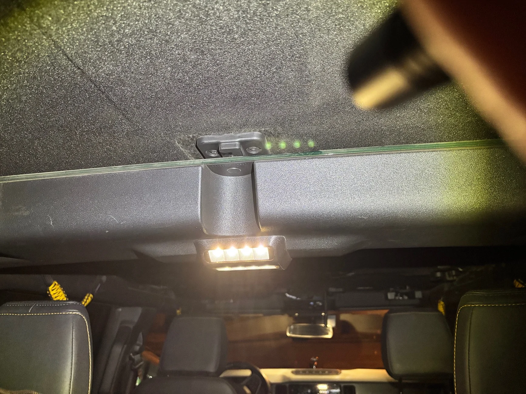

Then for the strap/bar I just drilled one end for the M8 and the other end for a M8 rivnut. The rivnut was too long so I cut it down and that was just enough to clear the roof bracket perfectly. I found a short M8 but it was too long so I used a large nut as a spacer. I will find a proper length or print a better spacer. If I remember to.
I calculated out the bend at 19.5˚ and went over to a friend's to use his vice. Of all the tools I have that's the one thing I don't.
First pull was exactly 19.5˚ but since I didn't account for the weight of the antenna I had to lessen the bend and now it presses the antenna nicely against the roof.
This whole thing works so well I'm not sure if I can improve it. Although I may still print out a frame just to protect the edges. And maybe add some M8 thumbscrews like @RHeinz did.
I could also design a frame that uses the bar but allows the antenna to slide out. But we'll see how often I need to do that.

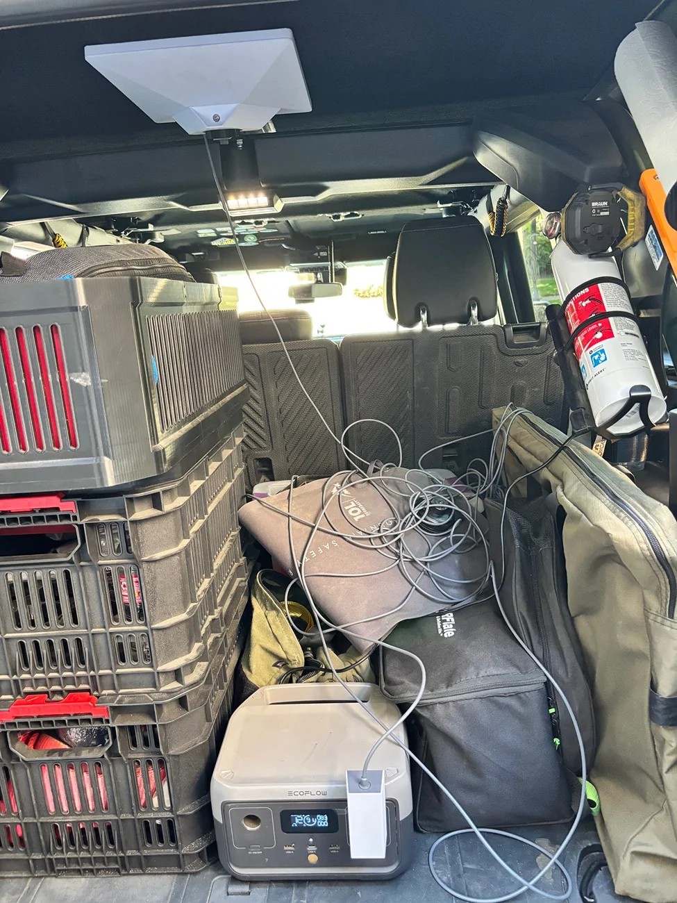

For now I will just plug the AC adapter into the Ecoflow (which will be plugged into the Bronco). I'm printing out a cord reel to take up the slack. I will look into a shorter cable. Not sure if it will be USB-C or 12v.
