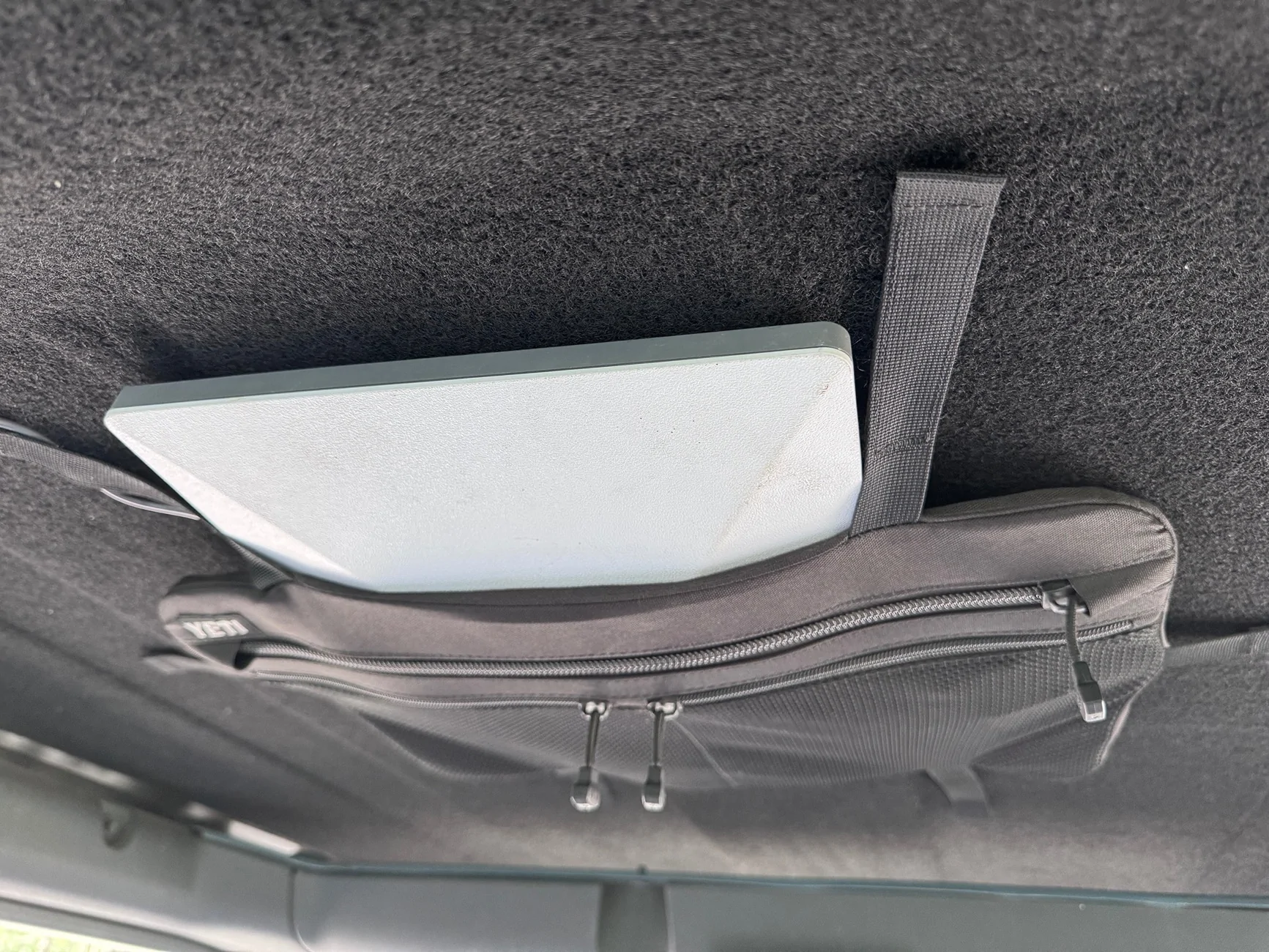

Before I discovered Starlink would work through the roof, I repurposed the velcro zippered storage compartment of my yeti go-box 30 liter and attached it to my headliner as a mini "attic" for park and trail documents. Removed some heavier booklets and it now holds the Starlink Mini perfectly.

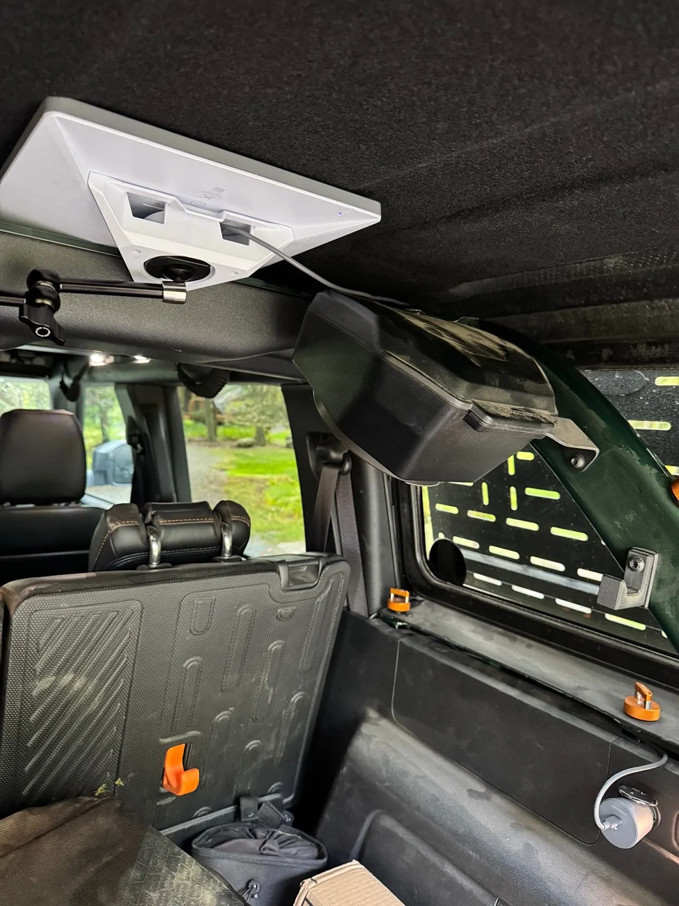

Plugged in a cheap DC power adapter, and adjusted it so the unit could be partially exposed and cooled off, and haven't received overheating notification since with a couple weeks using it now

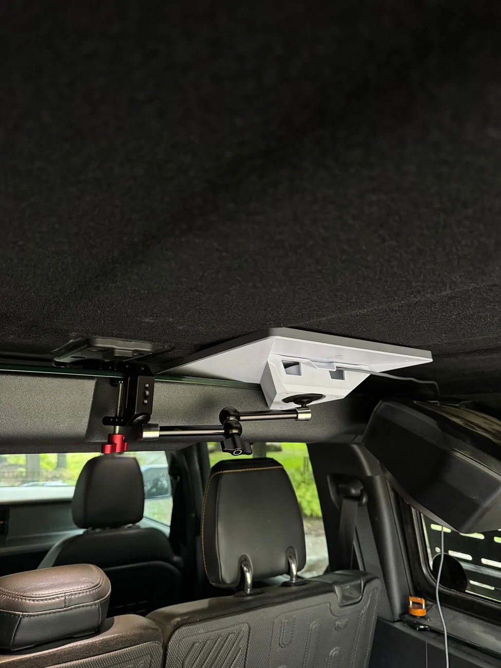

Last pic before cable management

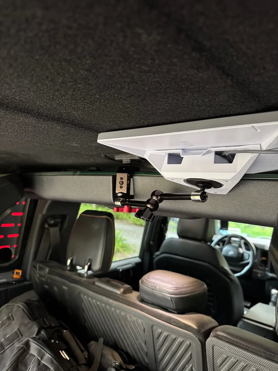

No issues going through my soft top or fiberglass Rallytop, but I suspect if you had any sort of metal top (the aluminum, for instance), or some roof racks, that may block it.
I can see the edge of my C-Pillar / Roll Bar on the Starlink obstruction map

That’s why I tucked it above the c pillar

Mine is on an attic shelf in the back, since I occasionally drop the top and change between hard and soft with the seasons

Which shelf is that? How did you secure your mini to it? Thanks in advance. I just got one and I'm researching mounting options.

The Mount cost more than the dish, I'm glad my DIY works so well.
