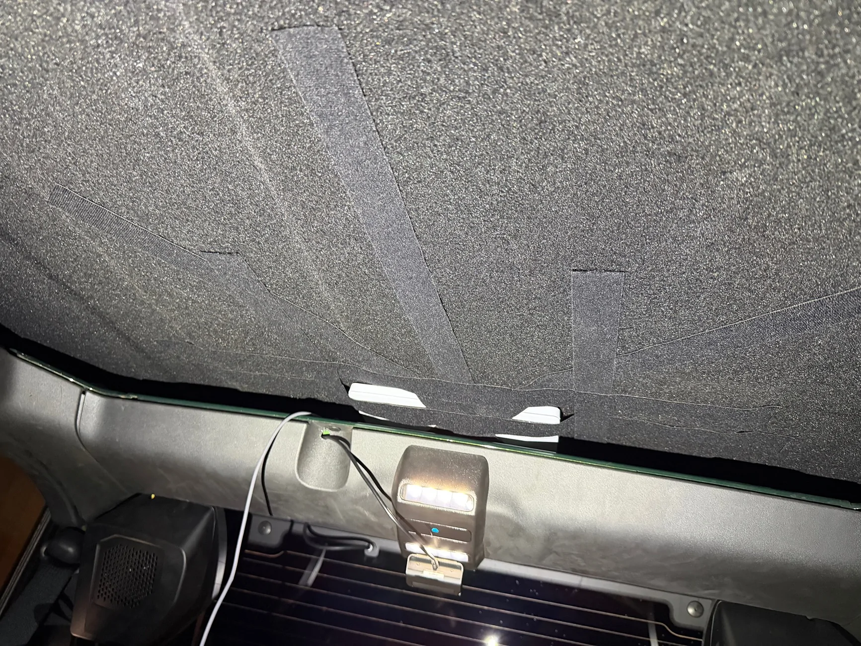

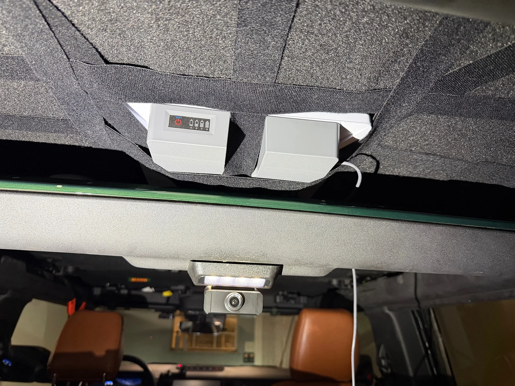

I Velcro’d it to the ceiling with a ravion battery
65 watt charger

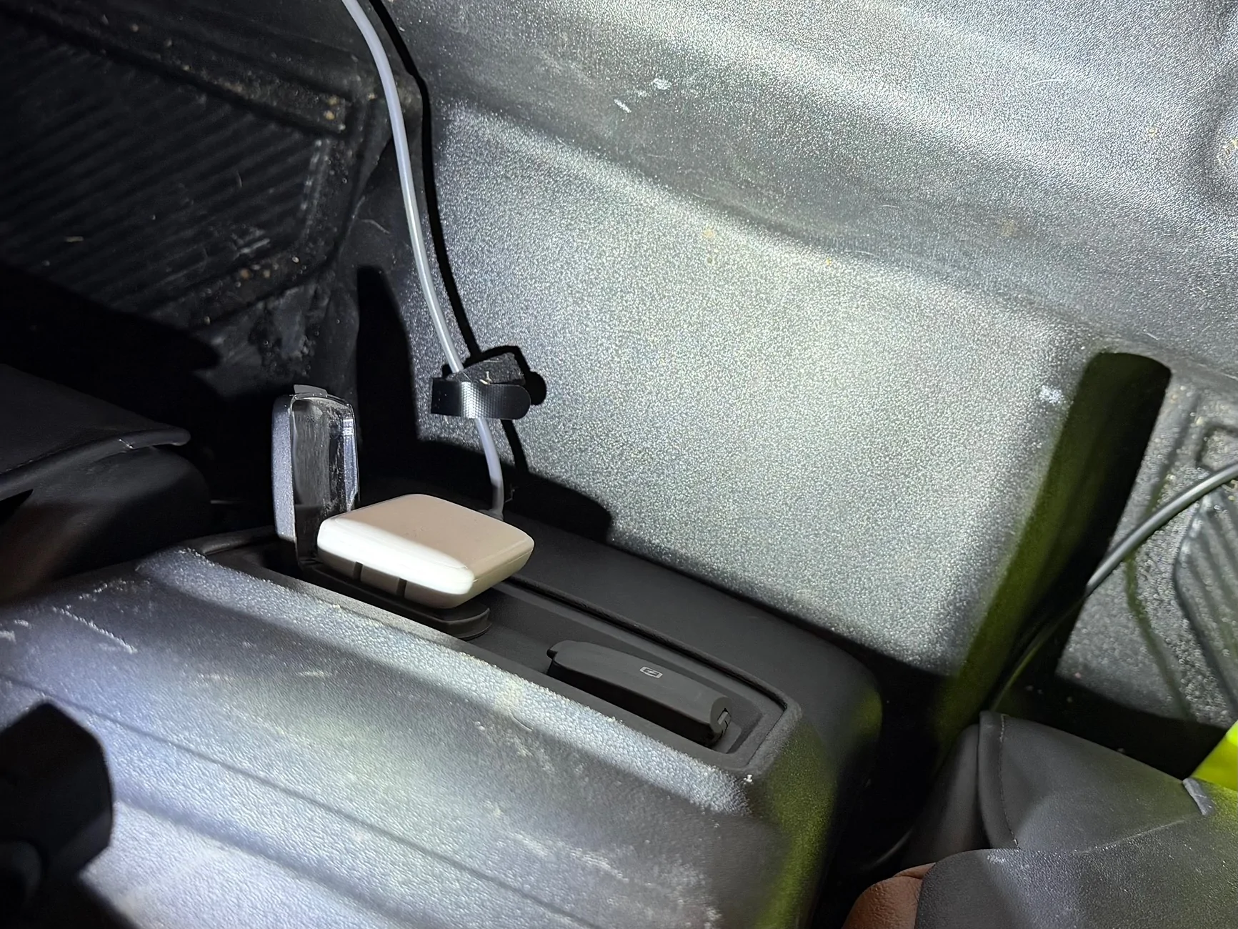

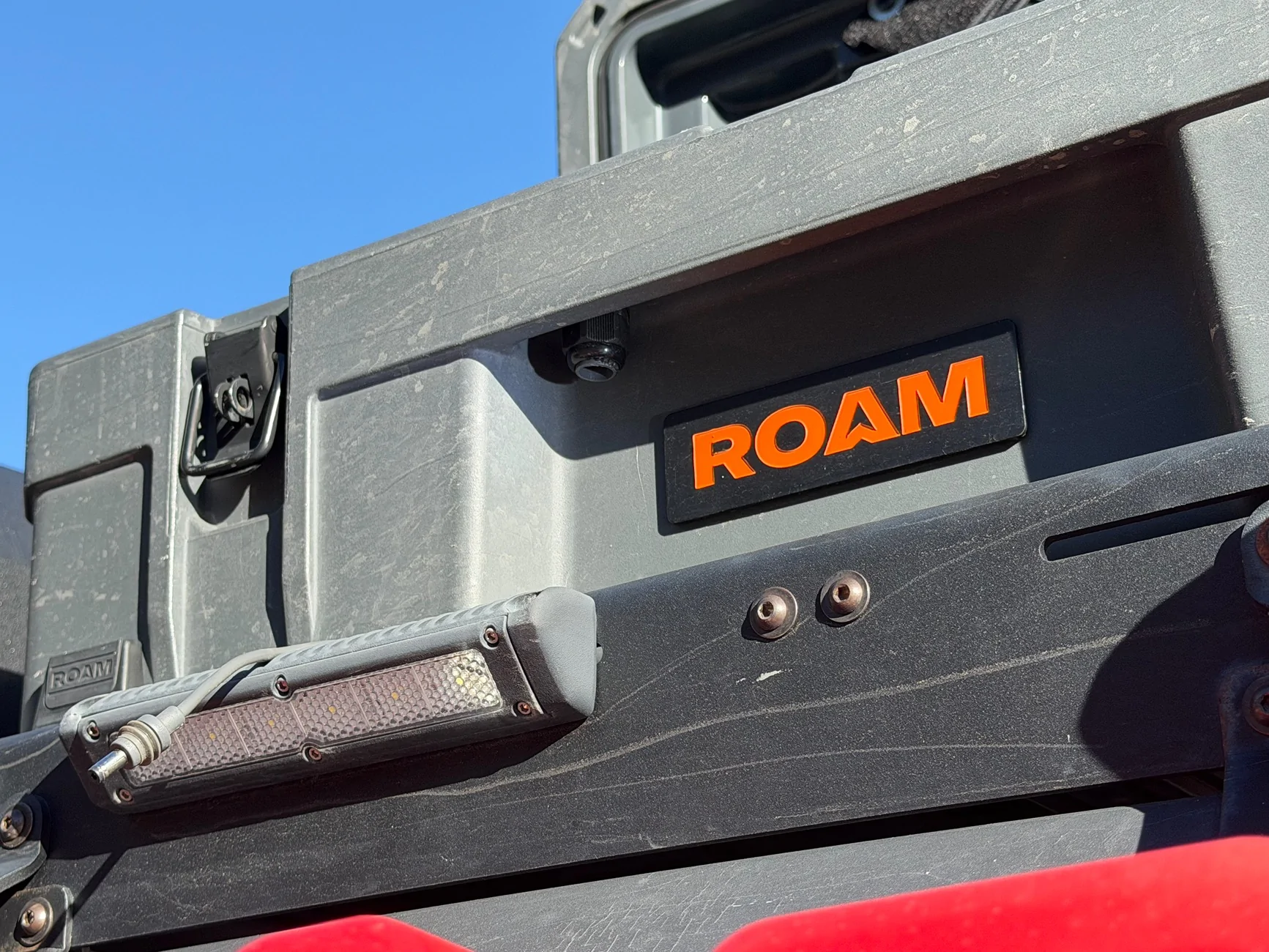

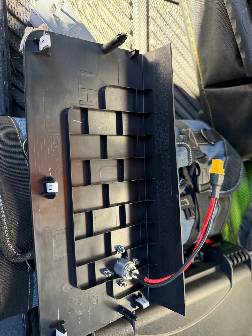

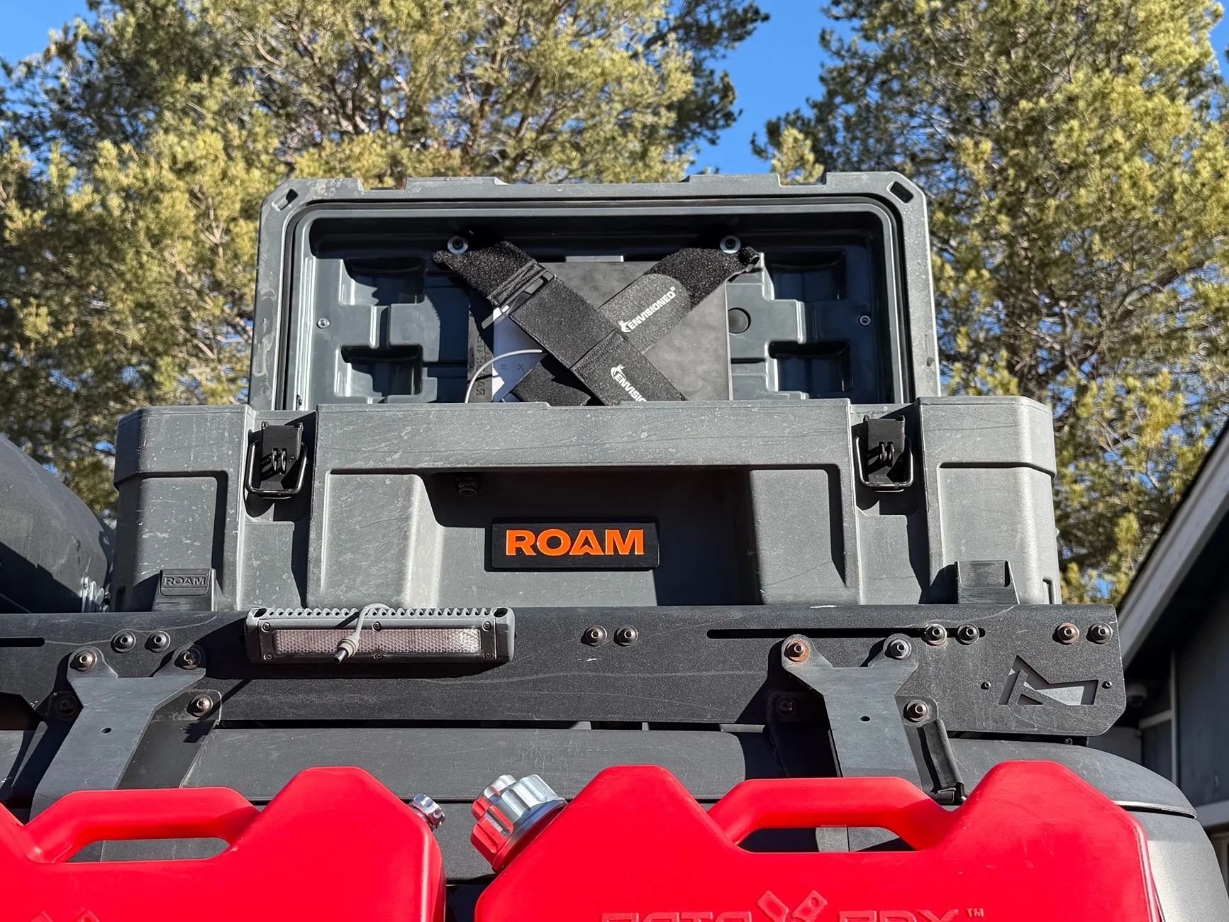

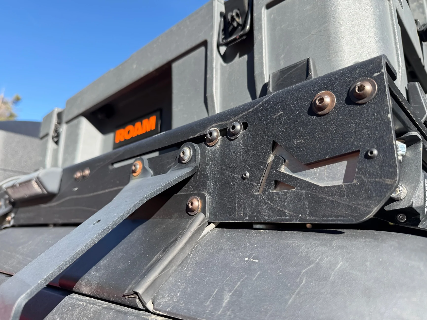

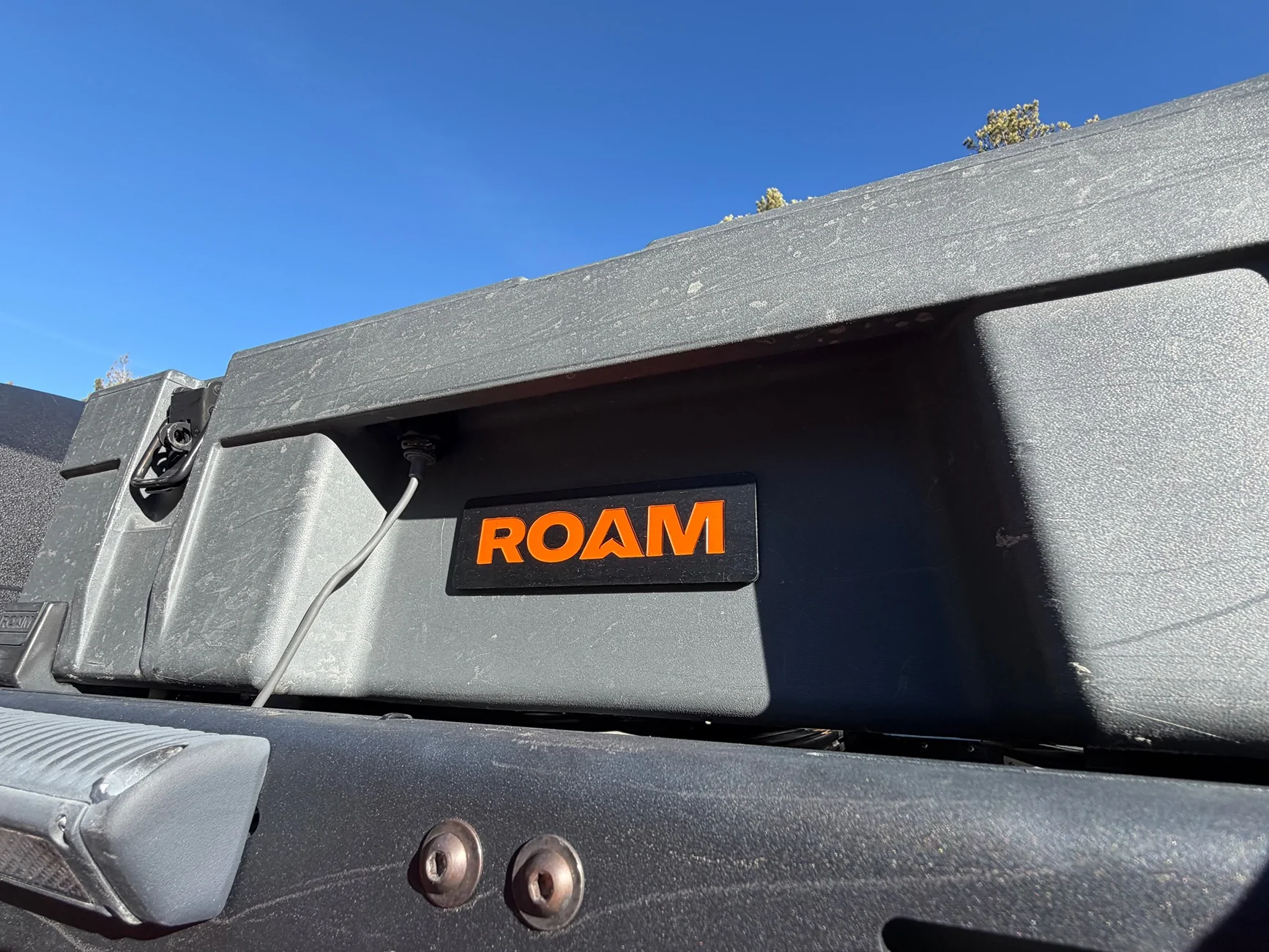

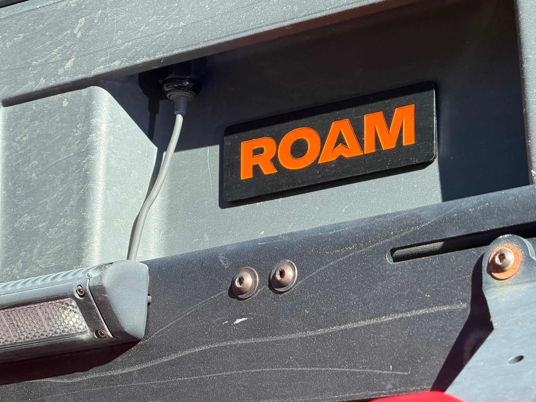

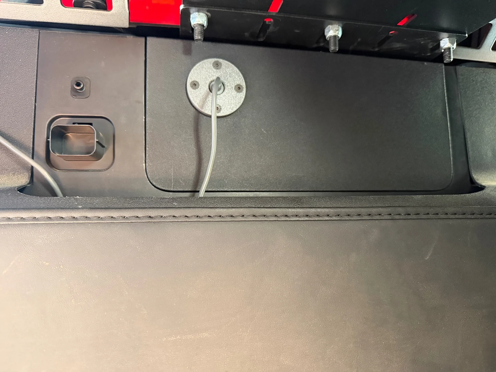

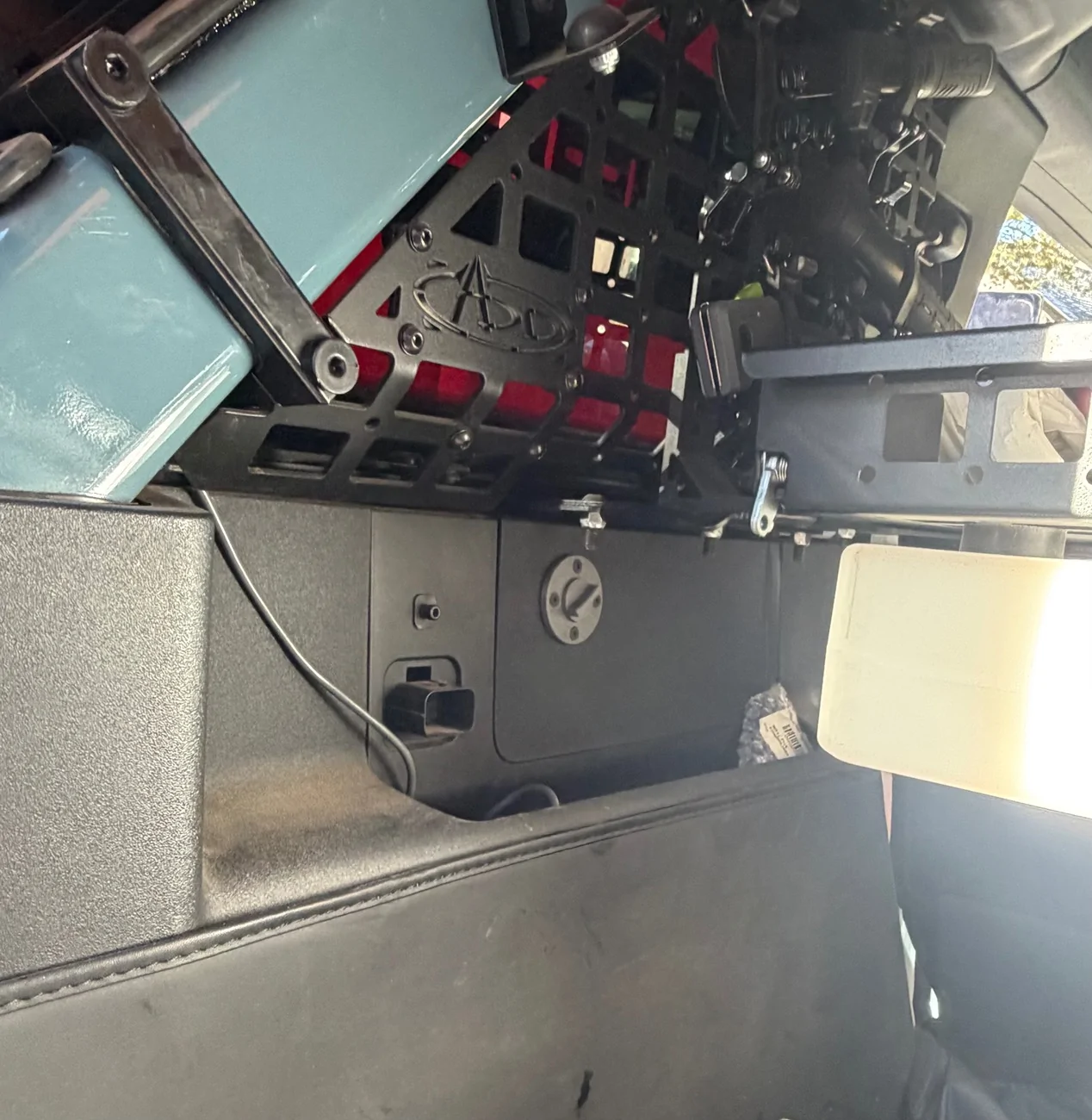

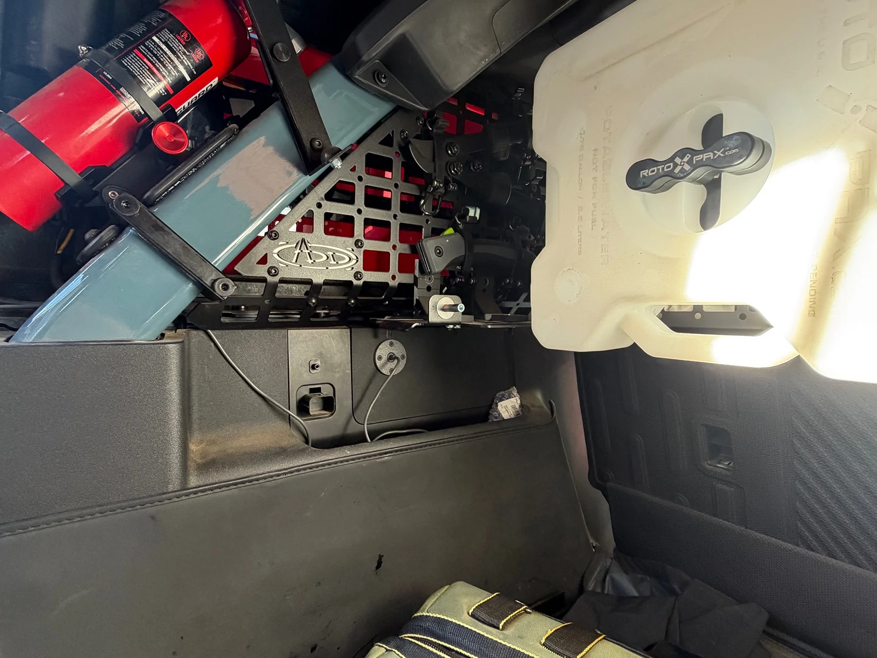

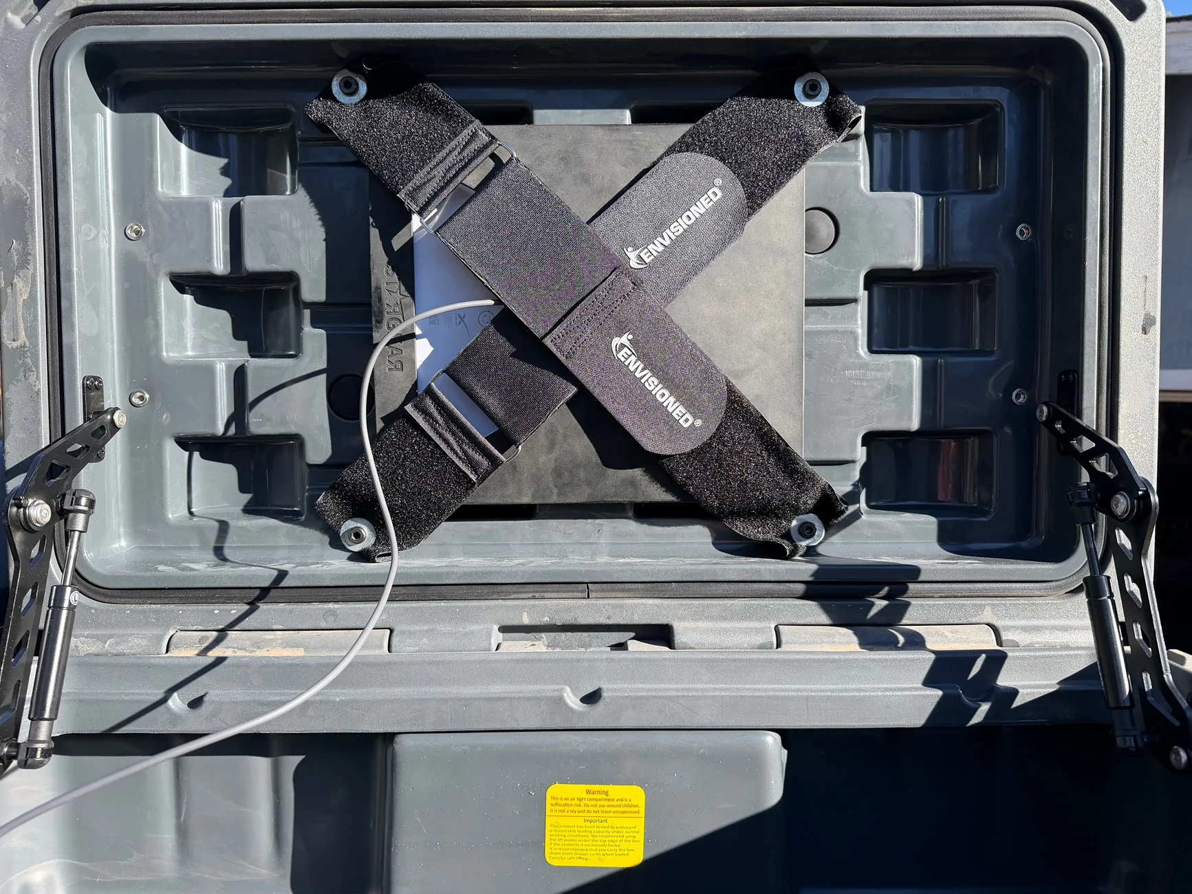

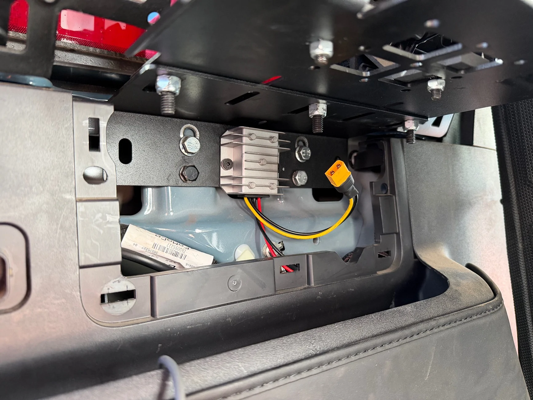

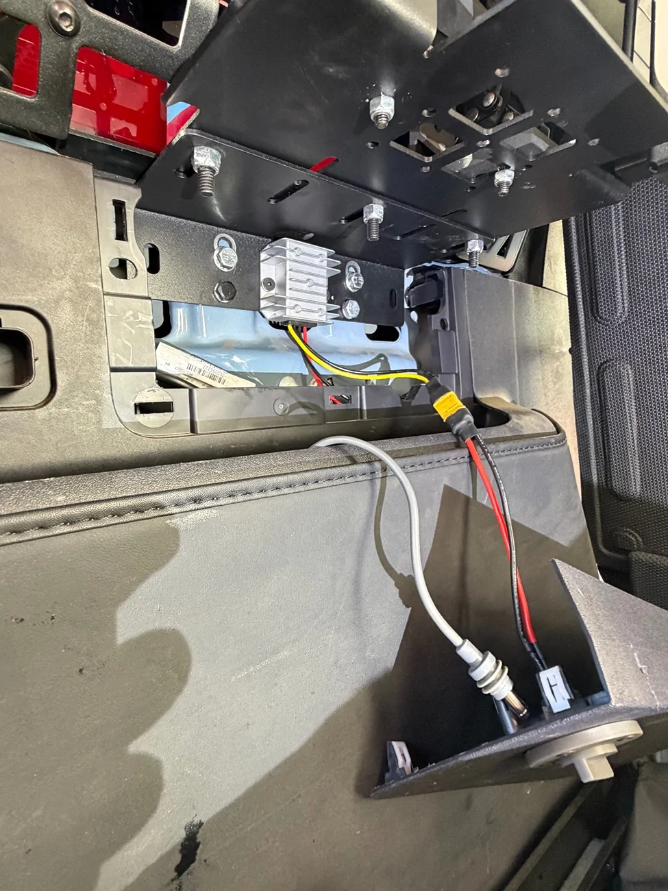

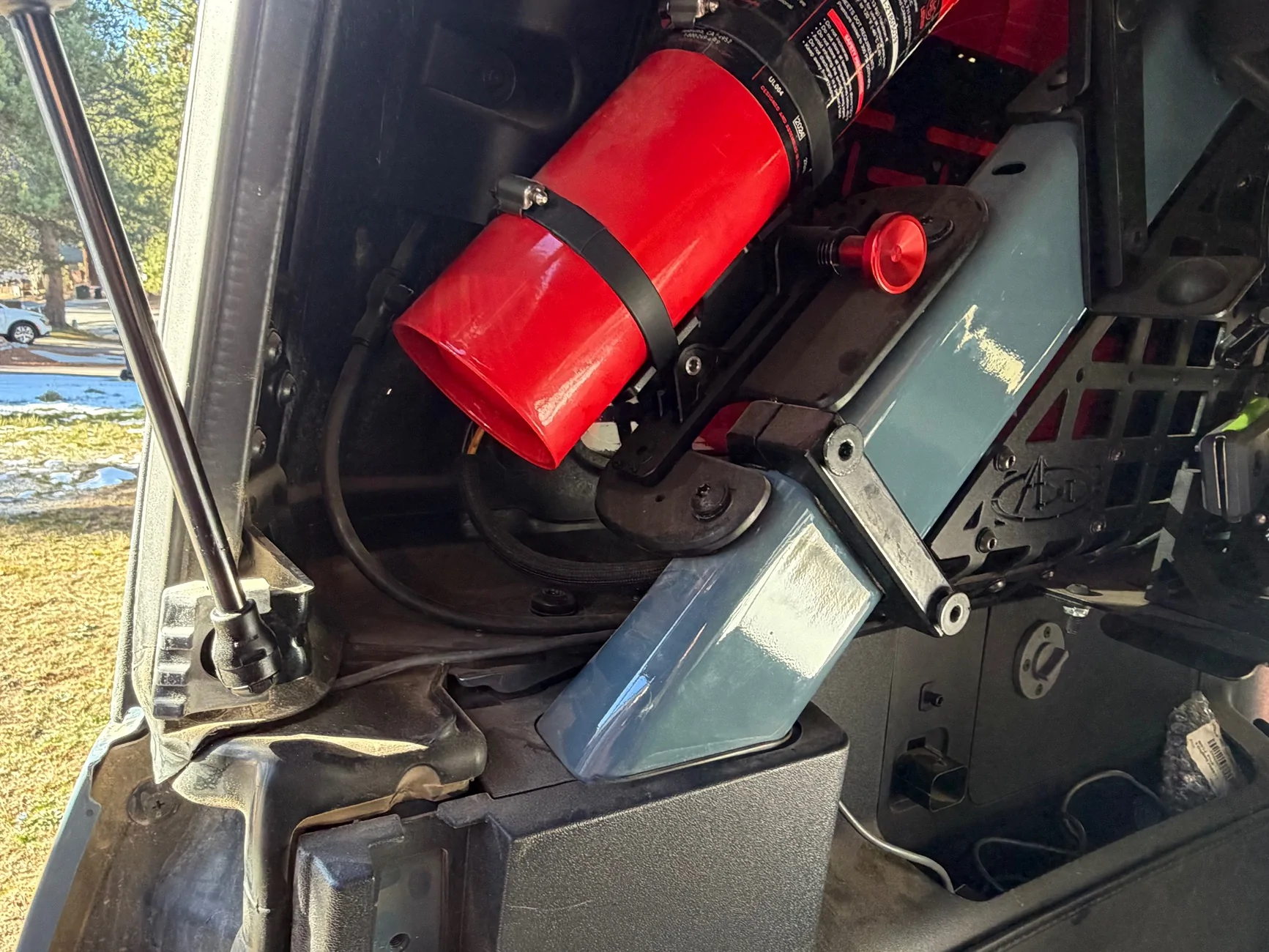

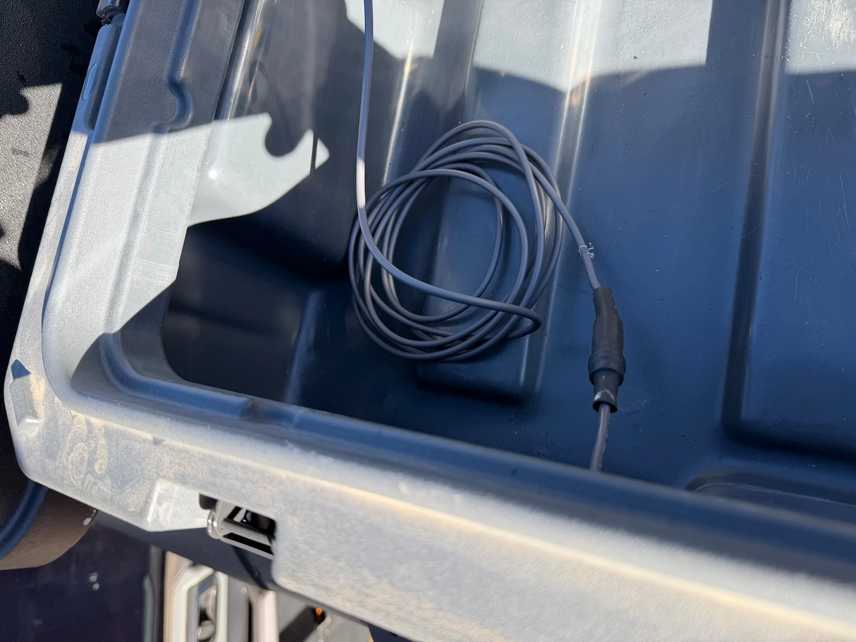

I originally had mine set up in the cab but ended up moving it to my Roam 66L case on the roof rack. I was able to run the Starlink off of my Jackery Explorer 300 and everything was contained in the Roam box, which was nice. However, I was only getting about 6 hours with the Jackery. So I decided to run the power to inside the rear of the Bronco. My current set up is as follows, I have the Starlink in the Roam case strapped to the lid and ran the power cord down the rear of the hardtop in the seam and through the bottom seal of the rear window. I have two options to power it, the first is using the Jackery and as mentioned before, I got about 6hrs with the Explorer 300 and I have an Exploerer 1000 and it last me all day with power to spare. The second way was, I wired up a power port using a Starlink Mini 12v Conversion Kit, both options have worked out well. I installed the conversion kit behind the small removable panel so it would be easy to replace if needed and ran power to the battery. Here are some pictures of the install and a list of parts I used for the power port.
Cable Panel Mount Compatible with Starlink Mini
Cable Entry
Female to Male Adapter
Female to Male Extention Cable

I have the parts to do something just like this. How did you get power to the step up converter? Right now I have the dish on top of my overhead molle, but it doesn't connect very well there.
pwaicon
Jun 6, 2023
66
South Lake Tahoe, CA
Ford Bronco Badlands SAS
I ran wire directly to the battery to power the 12V conversion kit.
I used the upfitter wire that’s run to the rear and tied it into switch one. (I’ll probably take it to an accessory circuit to free the switch up.) I have a portable power supply for when I want to run it when the Bronco is not running. The American Adventure Labs Starlink mount finally came and worked perfectly on my DV8 overhead molle.
