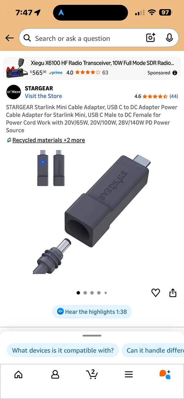

… interesting did you do that it get 20v to your USB-C needed for the STARLINK mini?
can you share what converter you use

I bought a USB-C cable for the mini from Amazon and plugged it into an Ecoflow Trail 300 DC. I've used it for several hours and only drained it to about 70% charge, so I don't know how long it lasts. I'll be trying it soon to work remotely and hope it will last 8 hours. The nice thing about the Trail is that I can use my Ecoflow solar panels and car adapter with it so I can keep it charged if I need to.
