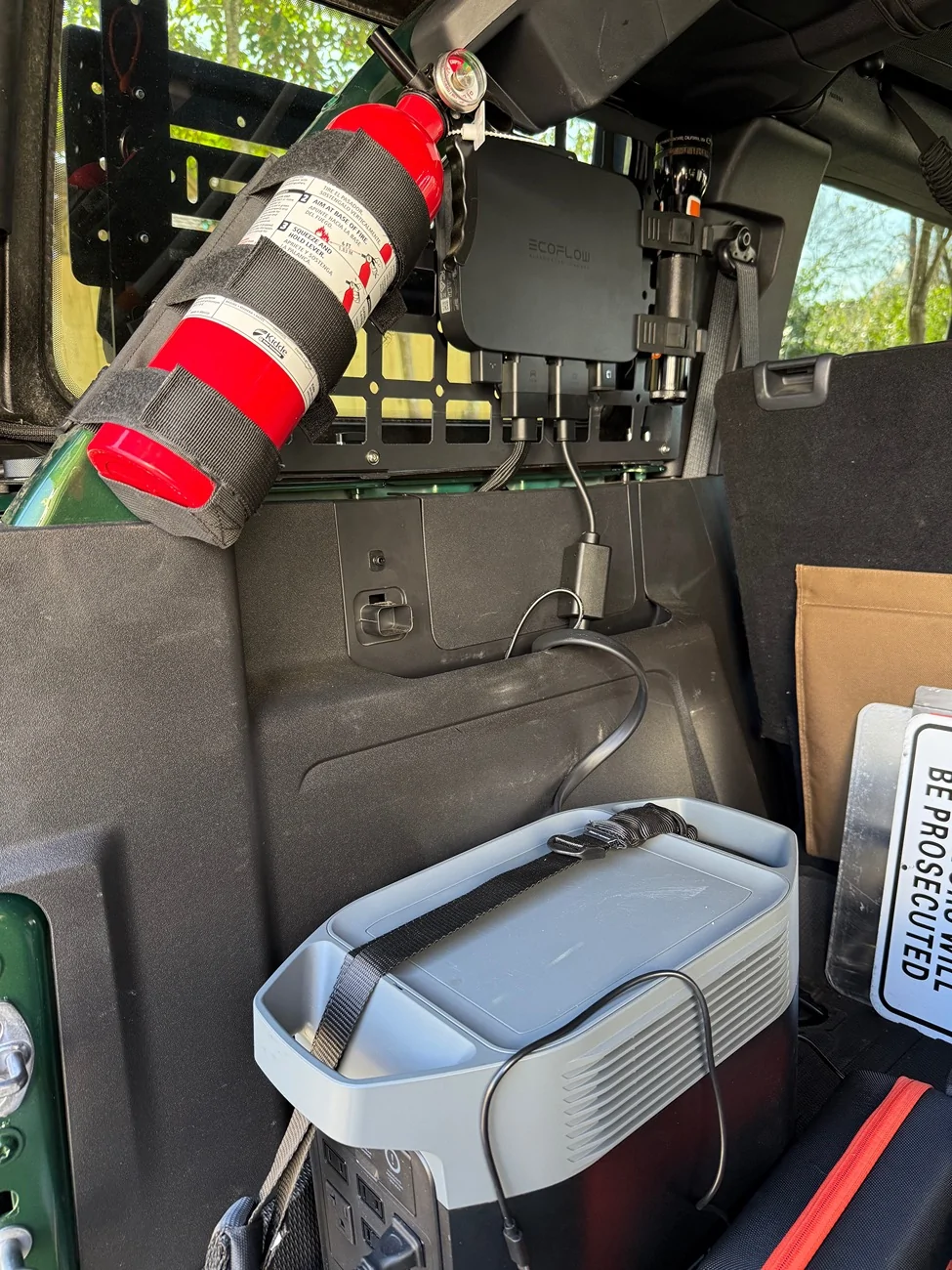

I used the EcoFlow Delta 2 w/ the EcoFlow alternator charger attached to the vehicle battery. With the EcoFlow App can toggle power to the Starlink and Delta 2 and not loose power.

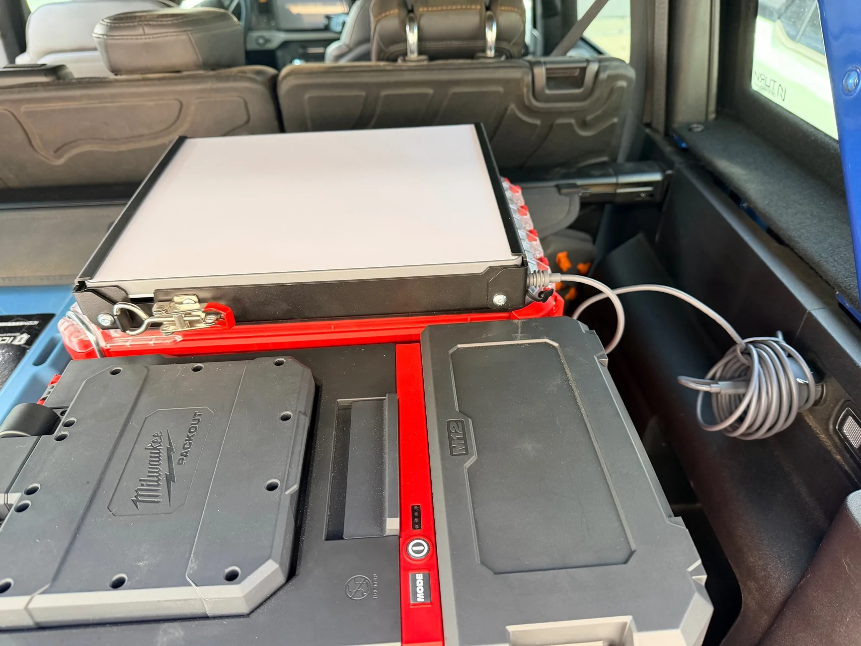

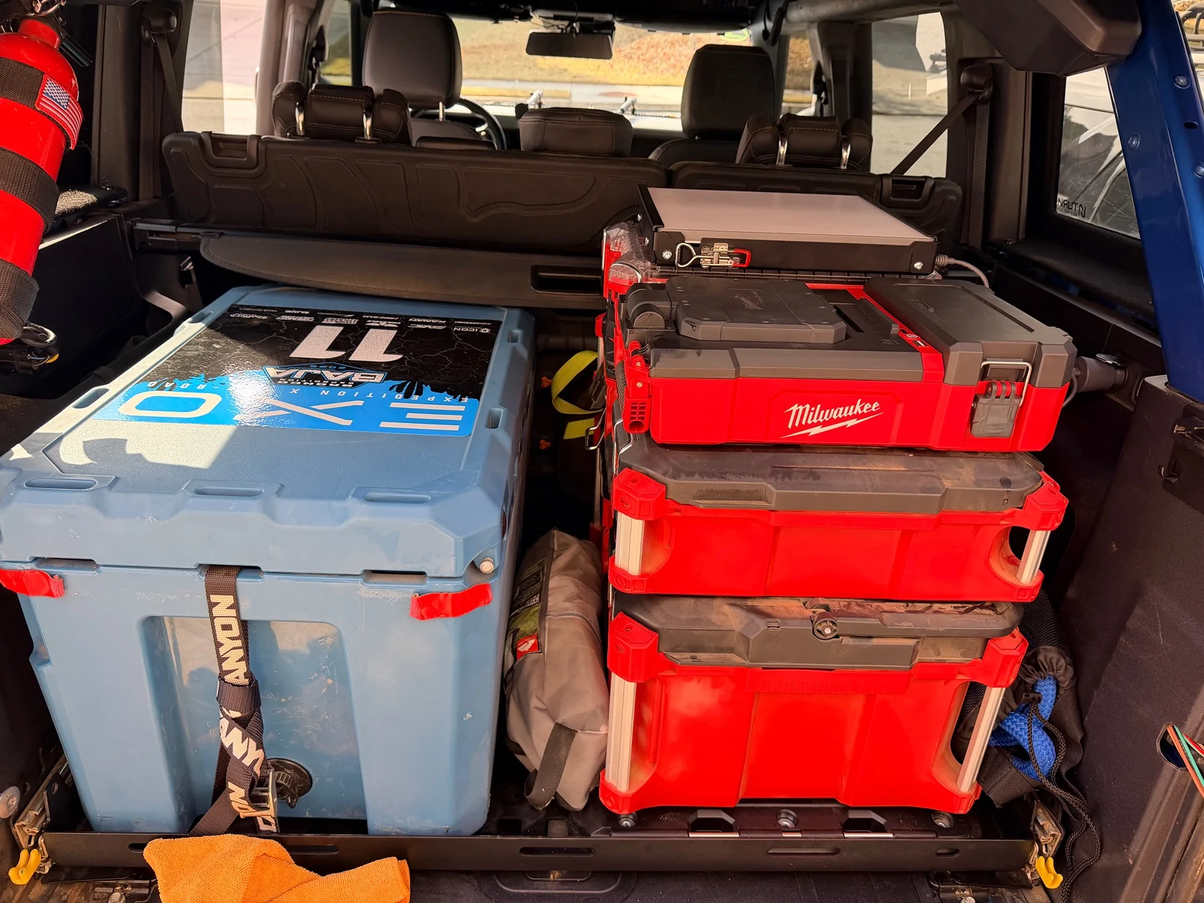

I used the American Adventure Labs packout mount and powered it with the cigarette lighter. Worked on the trails last weekend.
Did you notice if the 12V lighter power adapter ran hot? I tried using the power adapter that Revolink sells (here) and it got very toasty connected to that rear cargo 12V port. Maybe you can suggest one that works well and doesn't cook itself when plugged into the 12V power port?
I didn’t touch it so can’t confirm directly, it never alerted me of an issue needing to shut down, but I’m using the overpriced Starlink lighter power adapter from their store. Figured it’d be worth getting their approved one since I want to run it for extended periods.

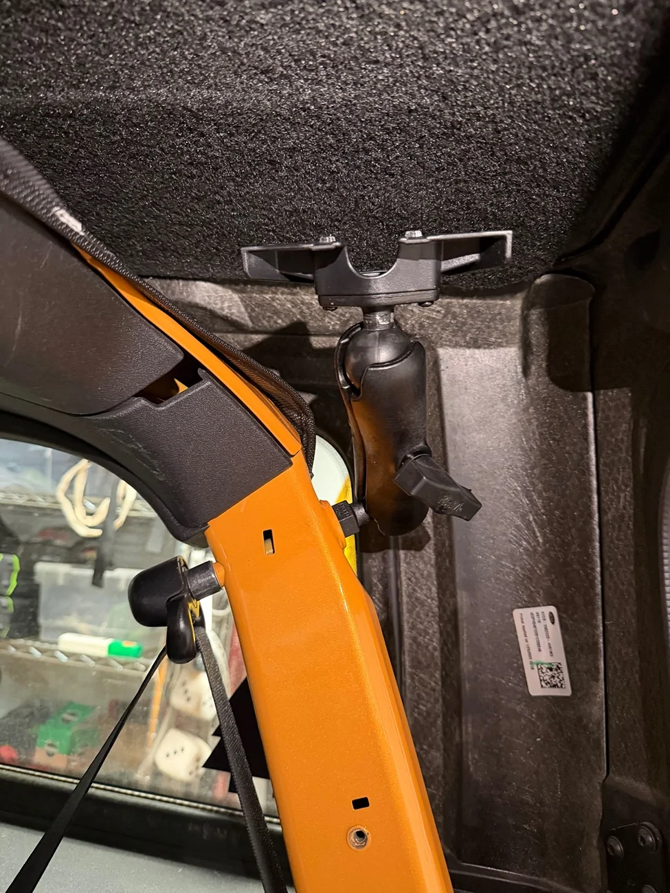

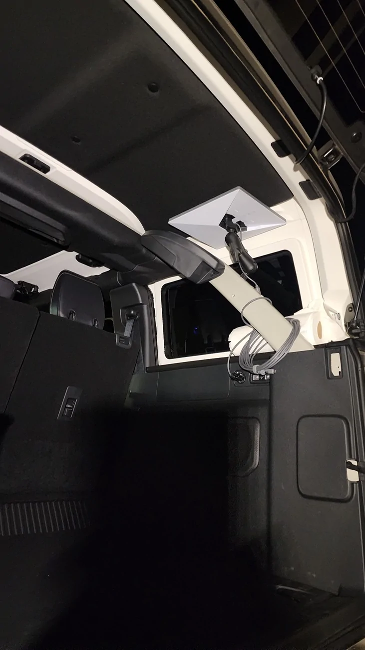

Ram mount
Ford Bronco Starlink Mini Setup / Power? IMG_0822
It’s great to see that setup! I’m going for the same on my 2 door. Had to tap the hole for the ball, but luckily it’s the perfect size for an m10x1.5. Currently waiting on my “free” mini to arrive. I’m not 100% sure I will be able to orient the dishy quite as nicely, but we shall see.
planning on just running from the rear power point. I have a 300Wh power bank that can charge from the bronc while it’s running.
