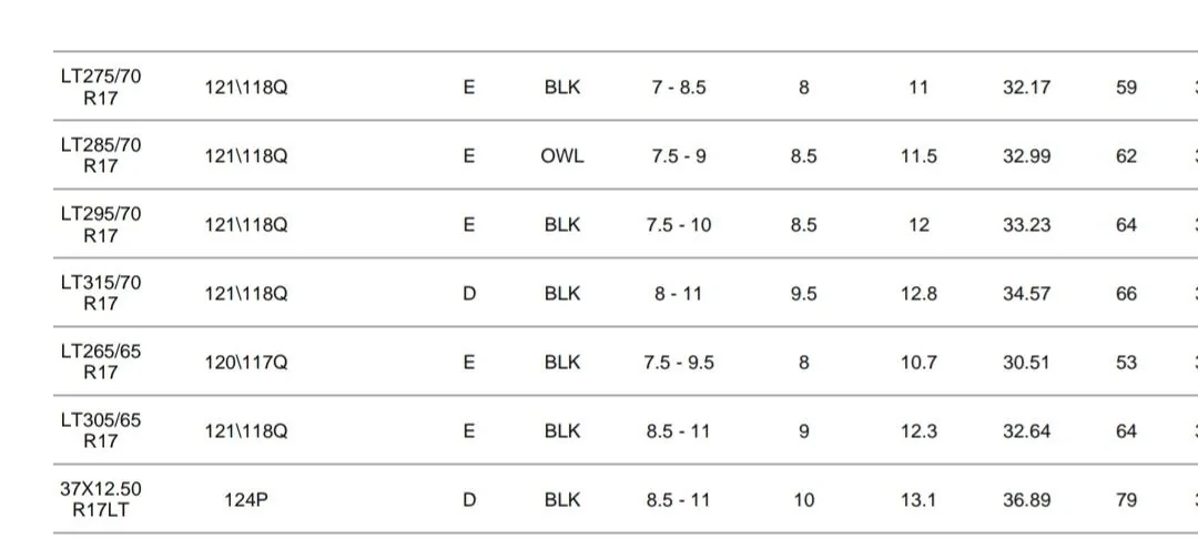

What size you need? I was suggesting if you swapped all 5 for those.
Stock, 315 70 17
There website says they only go up to 295
