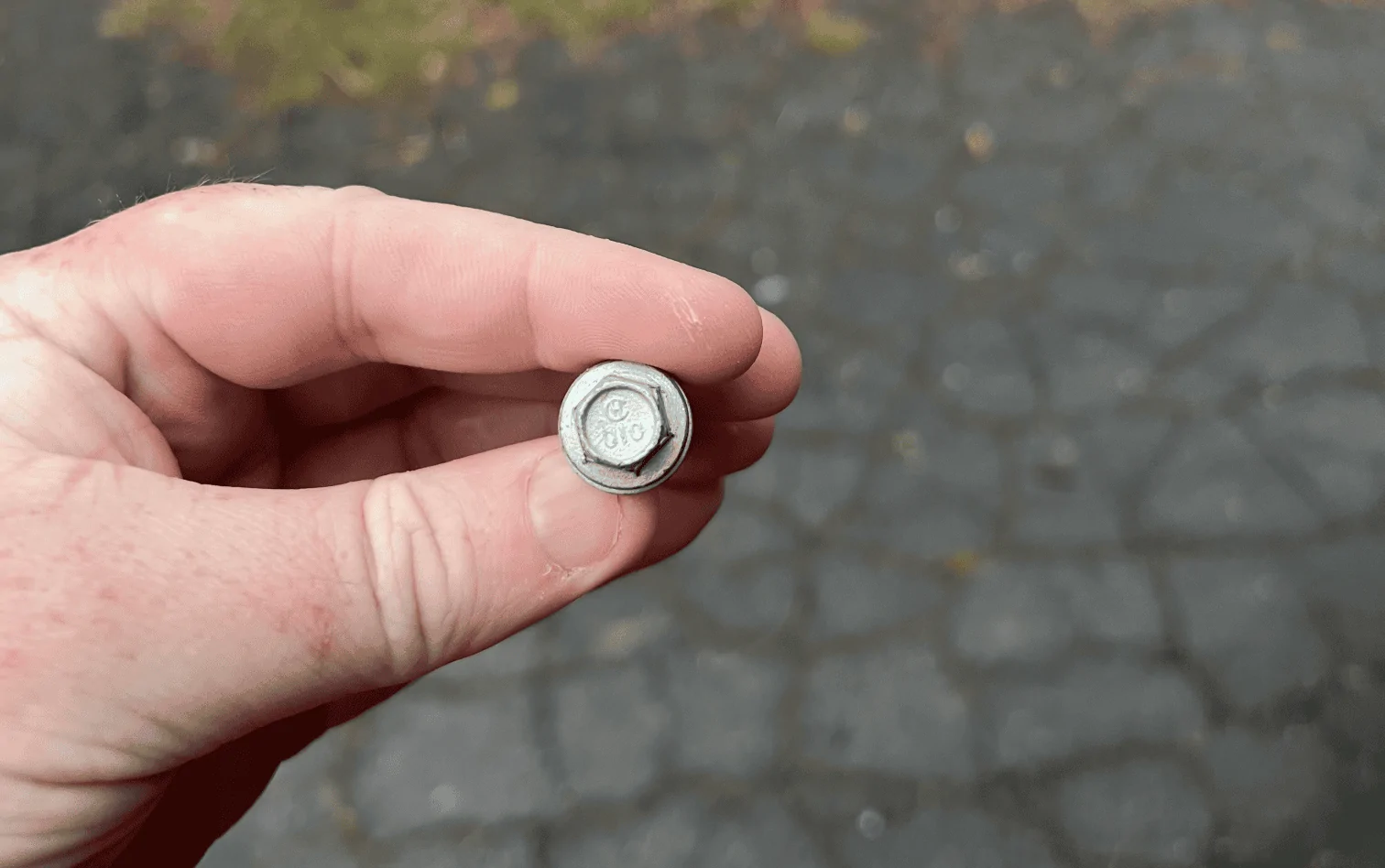

Alright I'm up to no good again on my Bronco, and need some help identifying a bolt grade.
Allow me to present to you THE BOLT OF MYSTERY. This is a Cold Heading Co. bolt marked with "010". What in the world is a "010" grade bolt?? Anyone?? At all?? Please?? 😫
It is rare my Google-fu fails me, but it has failed me spectacularly this time.
Also, if anyone from Ford reads this... W706027-S439
Ford Bronco Need help:  What is a "010" bolt? THEBOLTOFMYSTERY

Gonna guess here but 010 often marks 10mm. With no radial markings or grade markings it's a Grade 2 bolt.

Are you sure that is 010?
It looks like 01C.
In that case I think the C just refers to a low mechanical property and large tolerance on dimension.
Definitely 010.
Ohhhhhhhh... ya know.... 010 may be 10mm, because it is indeed a 10mm head.
As far as Grade 2... it's metric. M8 bolt. As far as I know metric doesn't follow the little line/notch system.

Definitely 010.
Another pic:
Yep, now that you've stated it's metric for sure, it's an ungraded bolt. Low torque/yield. Of course now I'm curious where they came from
The lasso/tie-down points in the back... which makes me just a little confused that they would be ungraded.

Definitely 010.
Another pic:
I don’t think it means 10mm, because I see this same marking on many other Ford bolts that aren’t 10mm heads. I have no idea what it means though.
Well.... HUFF.
Alright... you happen to know the torque spec for the fuel rails on the 2.7L/3.0L? There's a handful of gigantic M8 x 50mm bolts in that thing.

18 ft. lbs
Oh look at that, same torque spec as the tie down points in the cargo area.
Tiny lightweight fuel rails seems close enough to 300 lbs of cargo on a slide. I'll think I'll have two of these fuel rail bolt packs.
