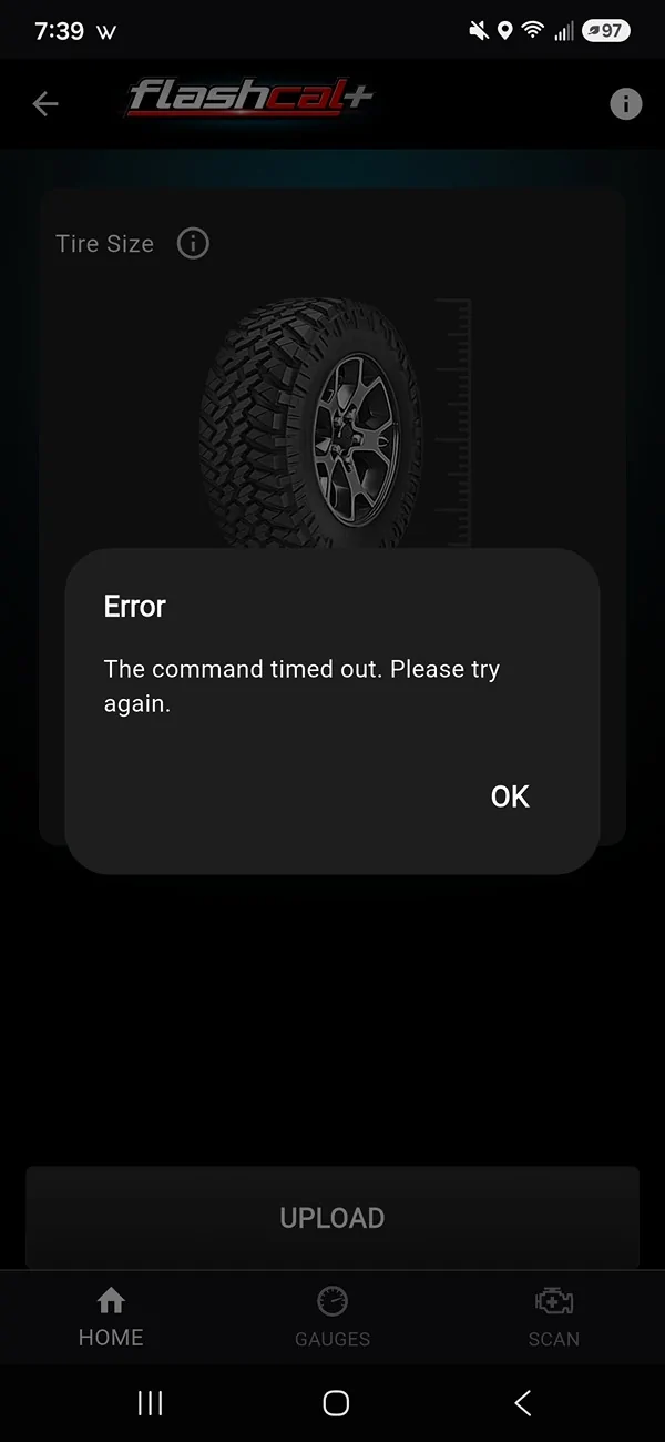

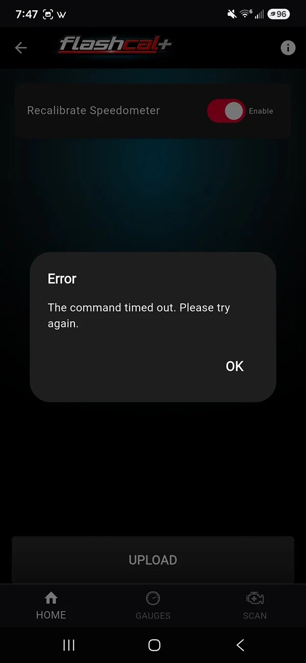

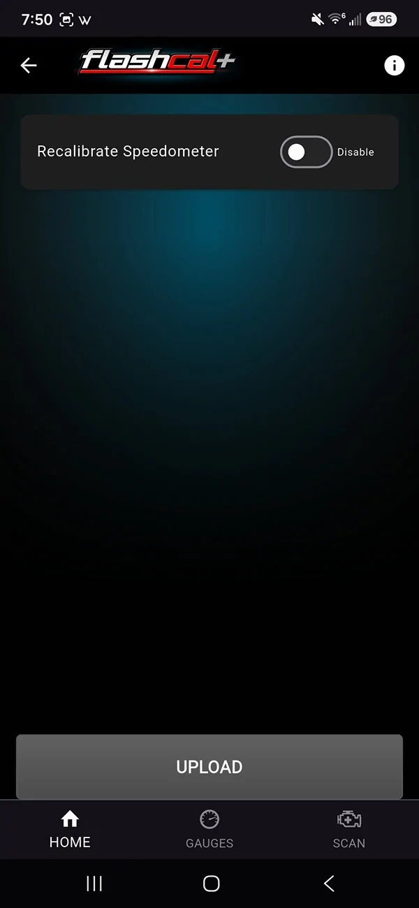

Tried again this morning. I found out the speedometer recalibrate is disabled and wont let me enable it without errors or timing out. Tire rewrites are successful but im assuming this is why im getting that code.
Ford Bronco NEW Flashcal+ Bronco Support! Screenshot_20260726_073930_FlashCalPlus
Ford Bronco NEW Flashcal+ Bronco Support! Screenshot_20260726_074749_FlashCalPlus
Ford Bronco NEW Flashcal+ Bronco Support! Screenshot_20260726_075013_FlashCalPlus
