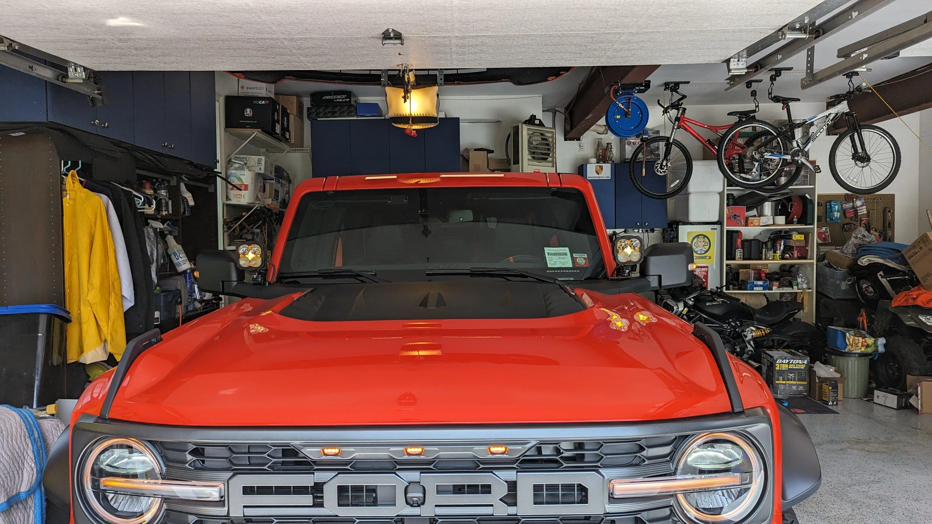

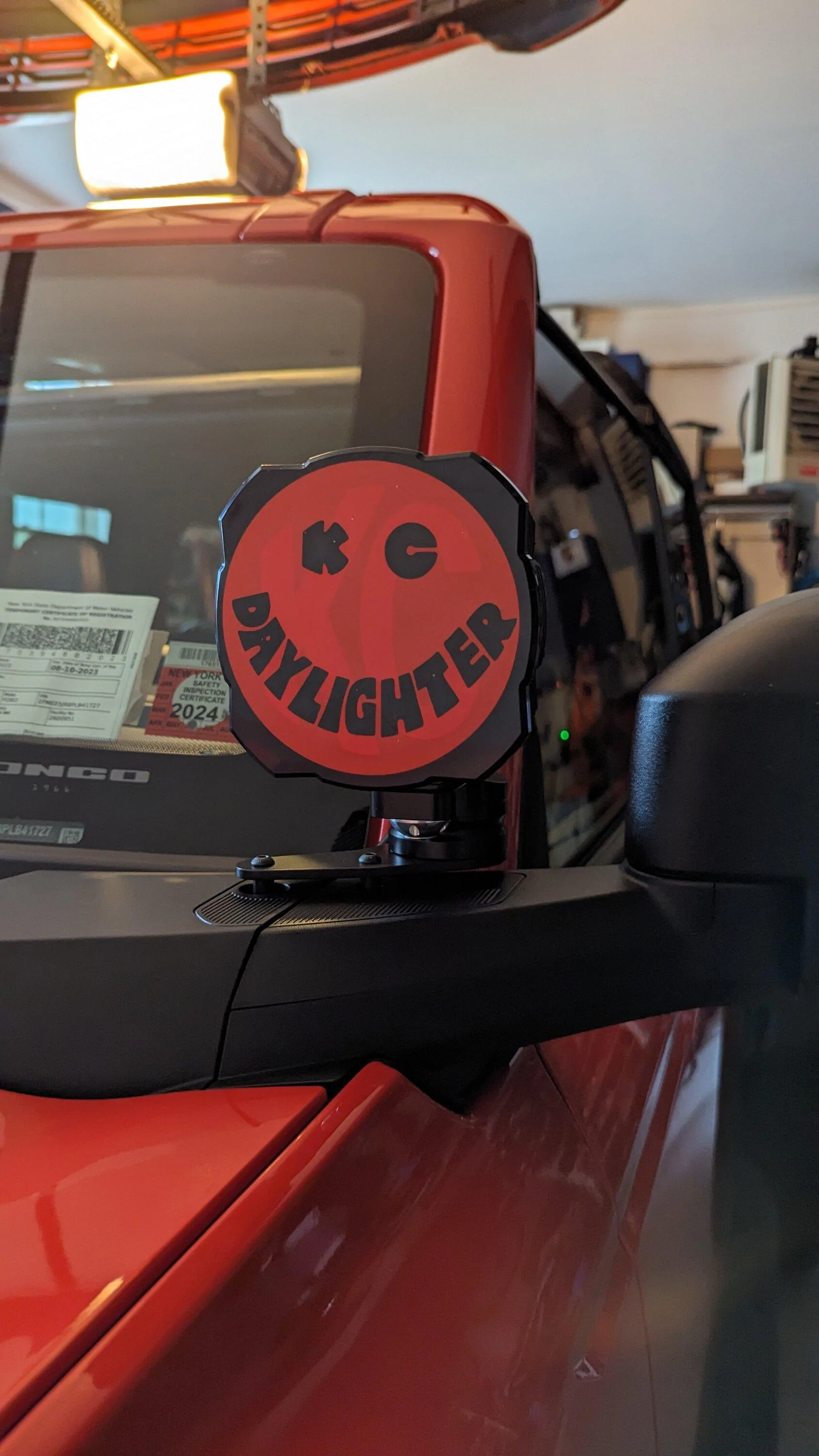

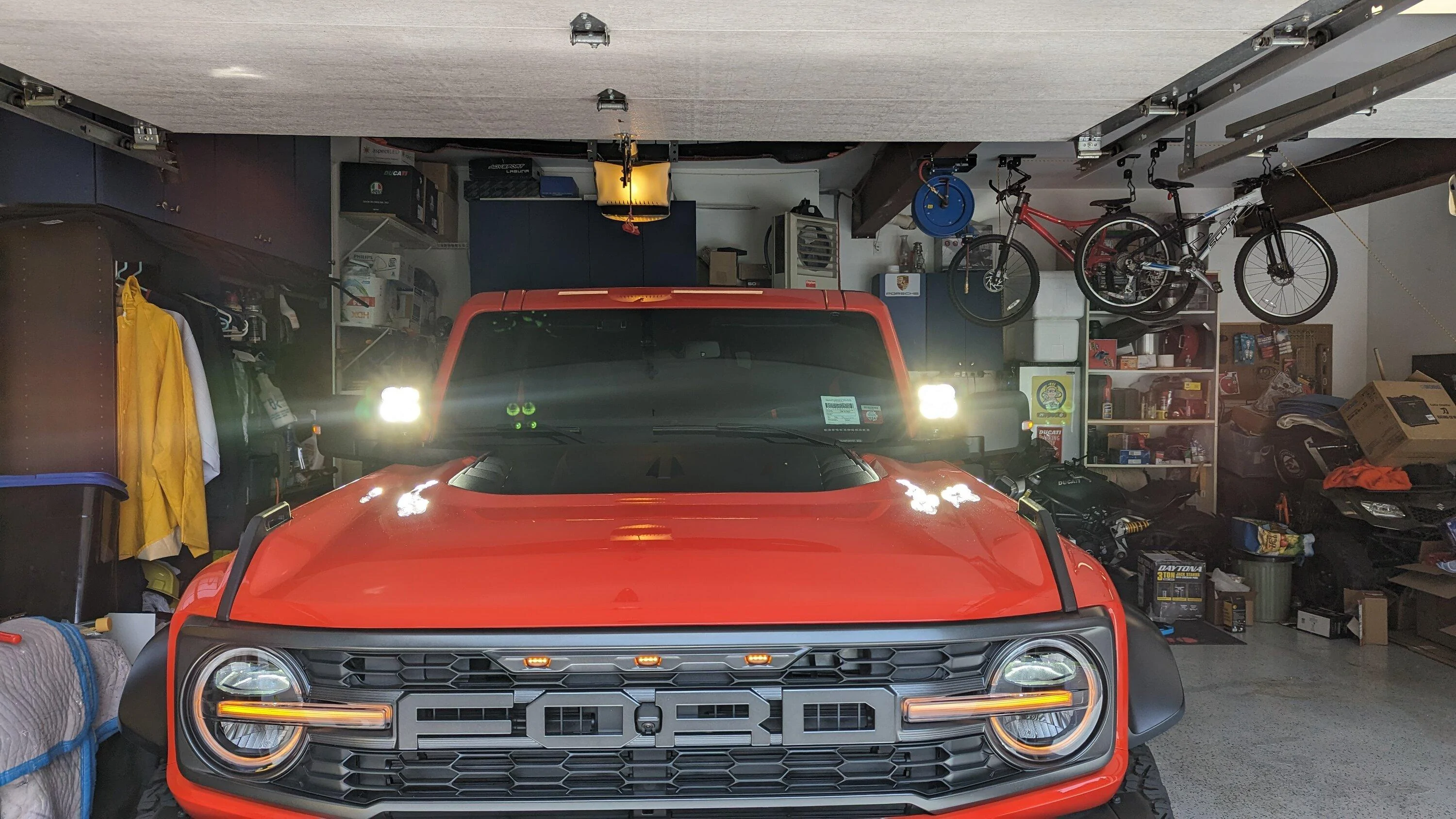

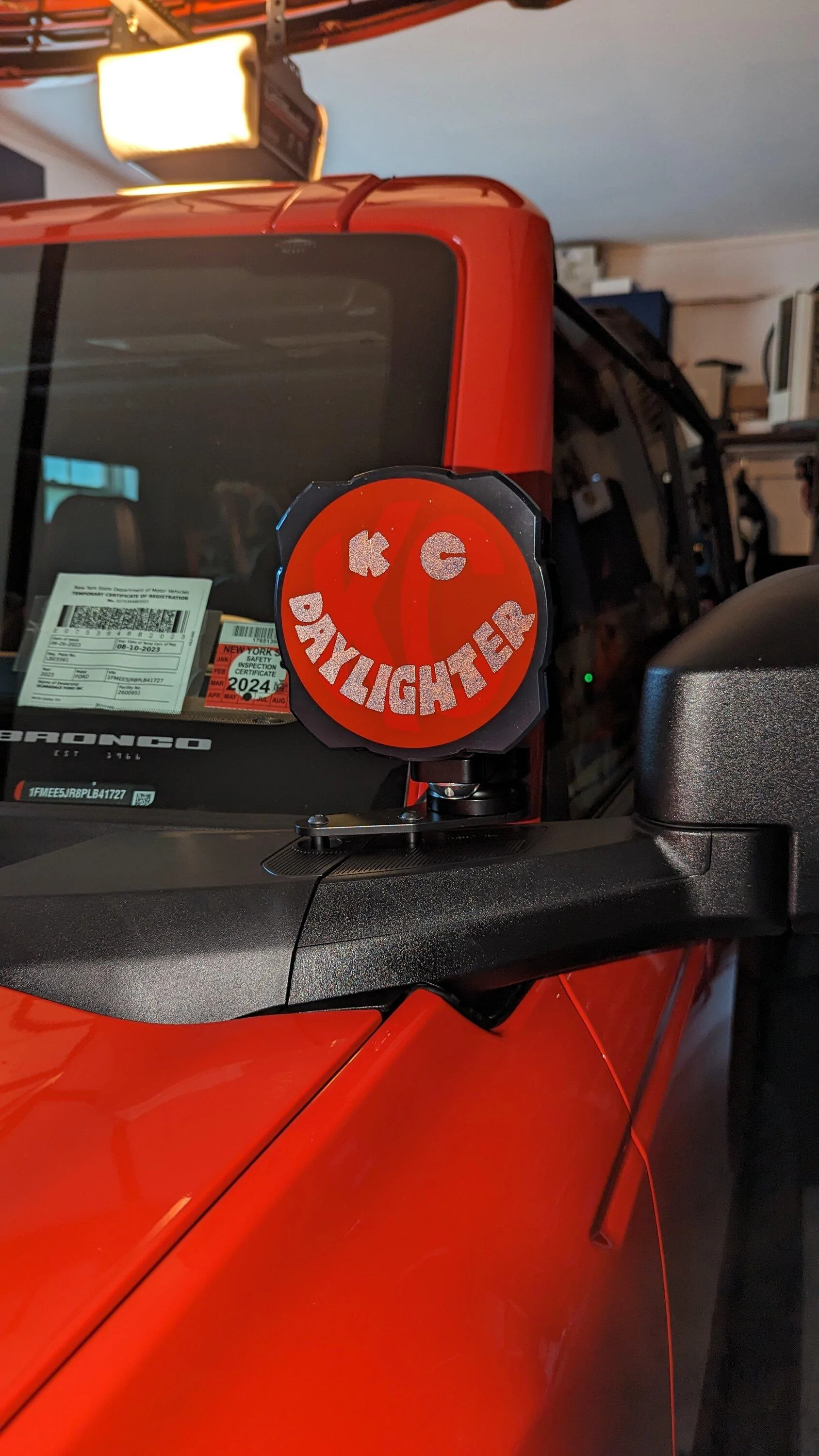

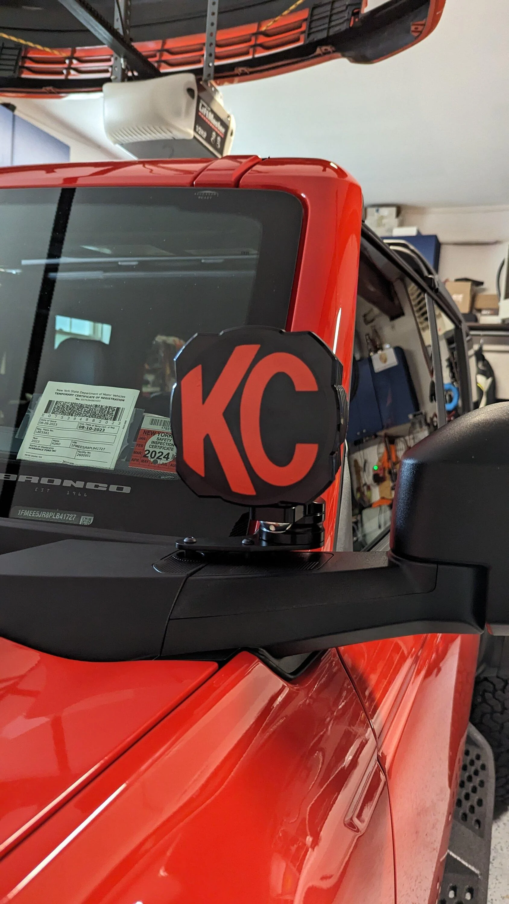

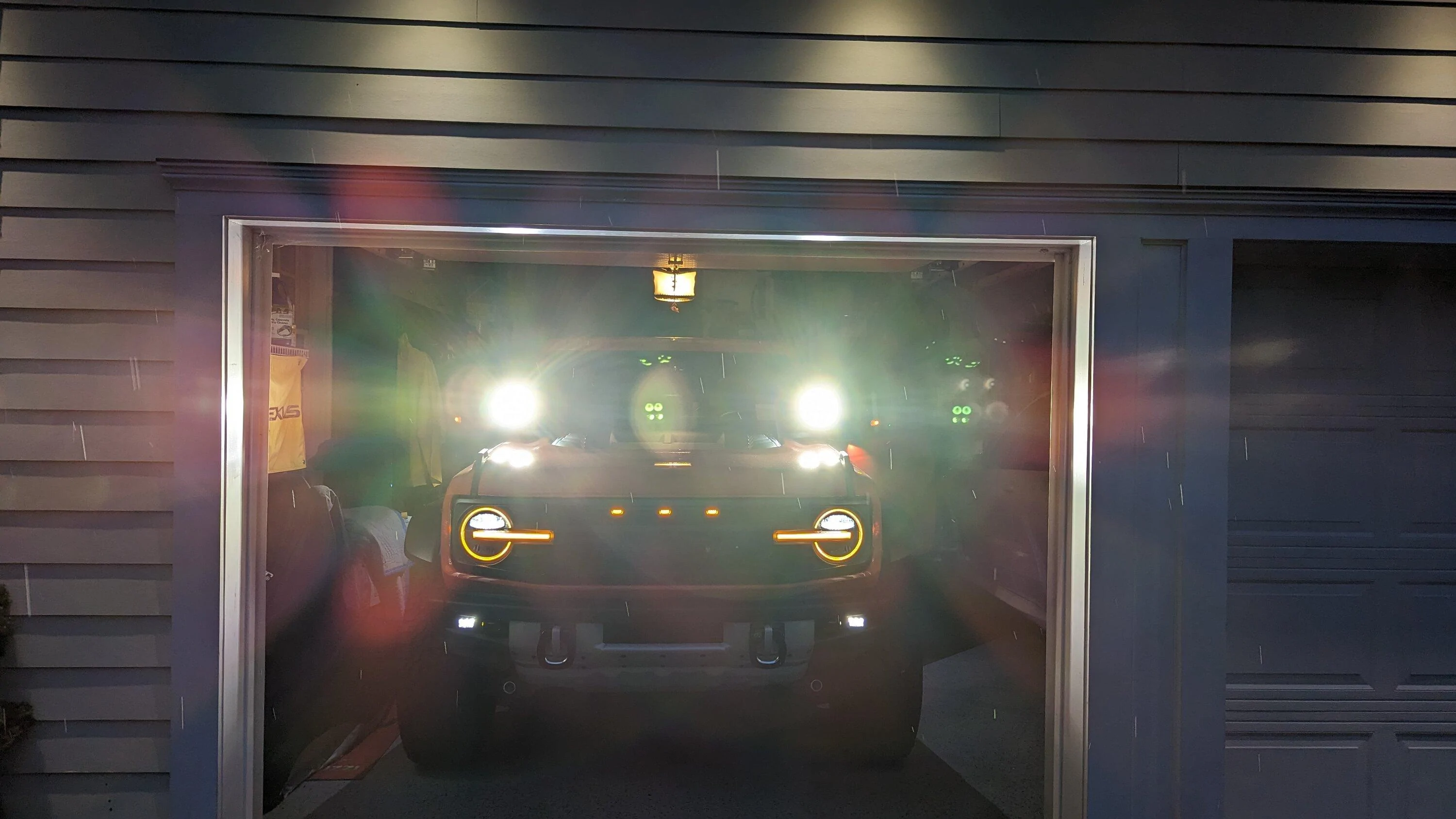

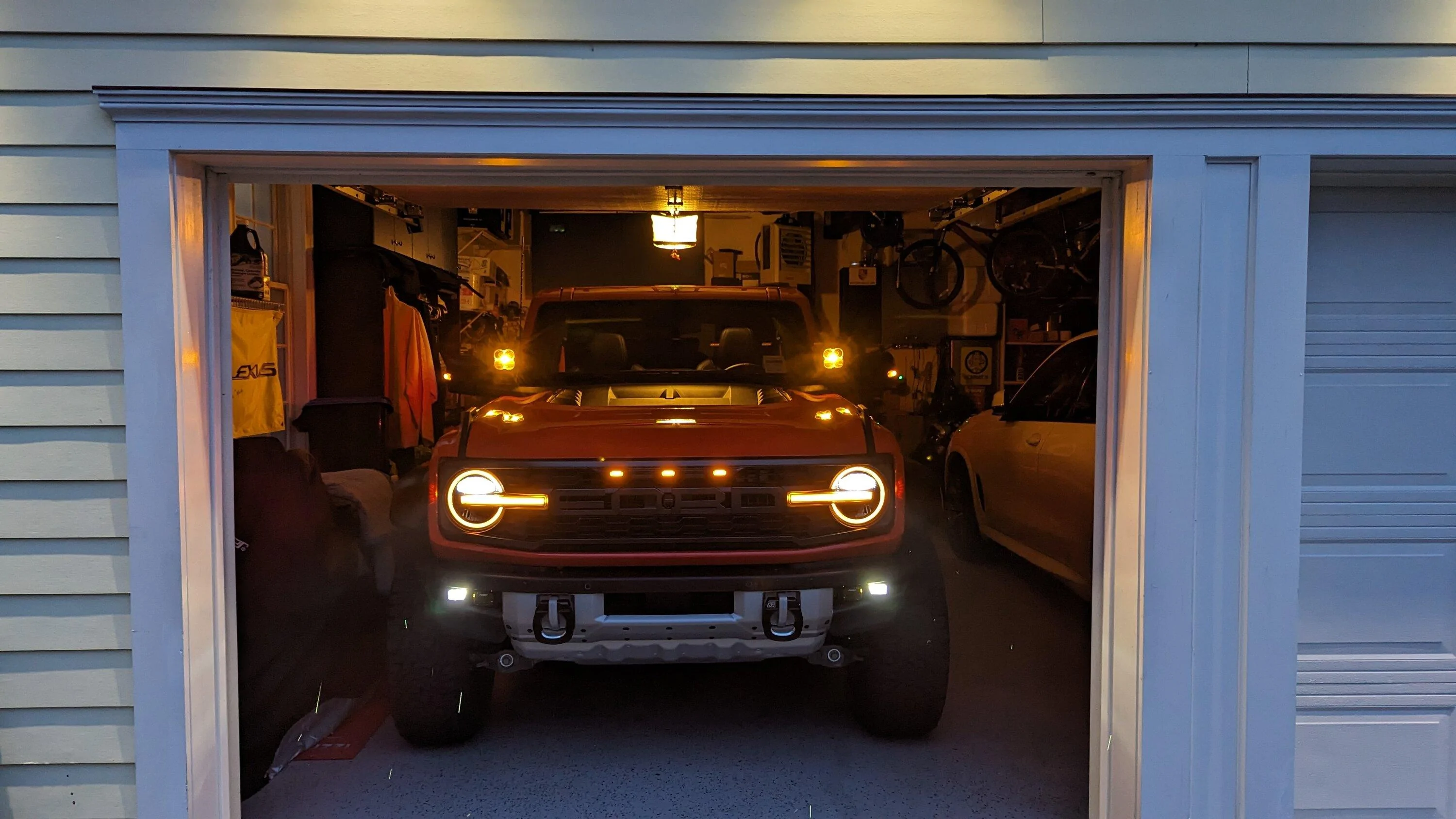

I got around to mounting my KC HiLites Flex Era 4 combo beams this weekend. Hooked up to Aux 3(30a) mains and Aux 6 (10a) amber backlight. The pair draws around 13.6 amps according to the spec sheet so if I decide to get something with more amperage requirements I'll switch it to the 15a circuit. Once you eliminate the relay and fuse harness it gets really simple. The upfitter switches work great. I also used my daughter's Cricut to make some custom decals for the light covers. Love the old school KC smiley - did that one in reflective black.

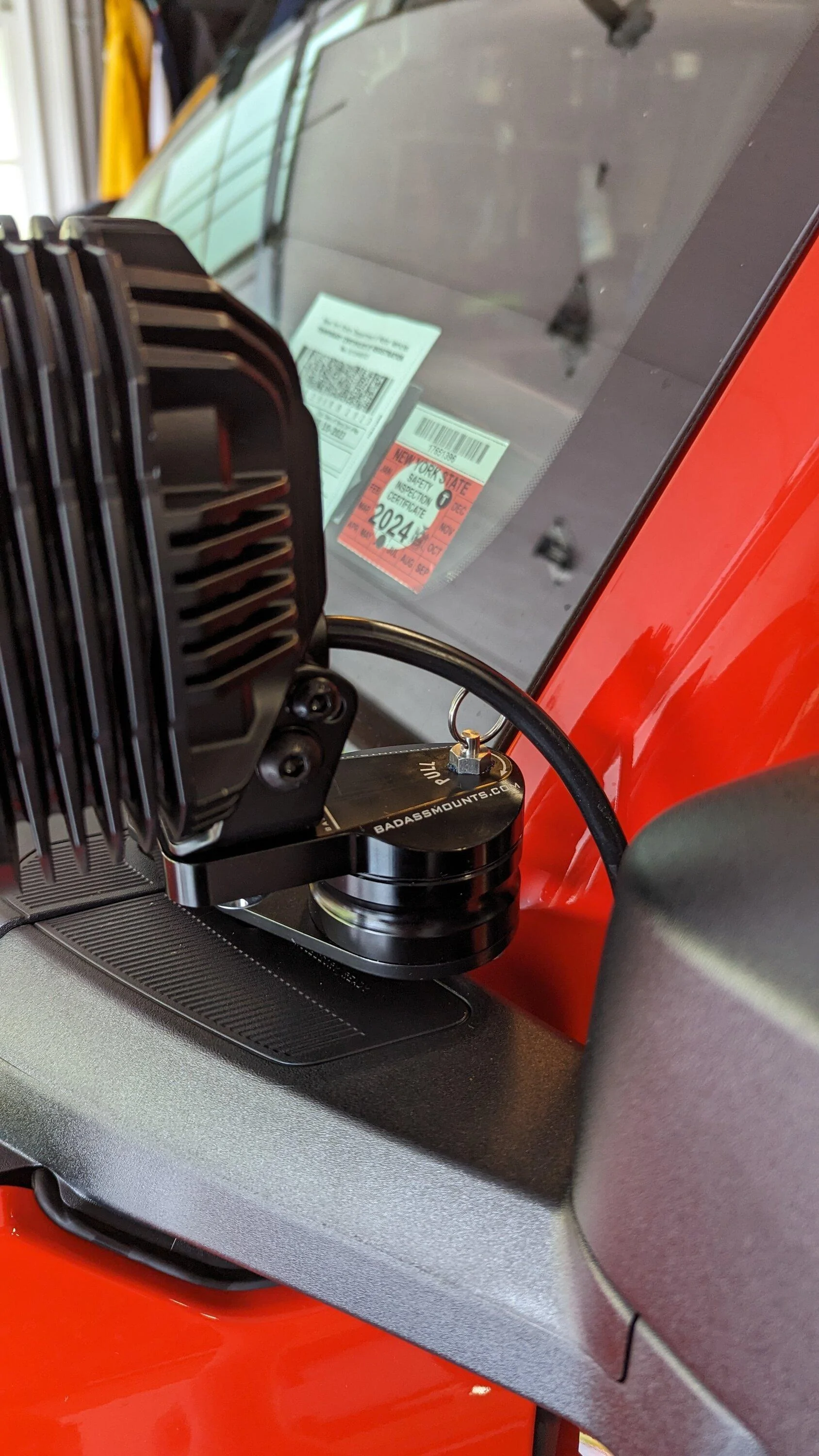

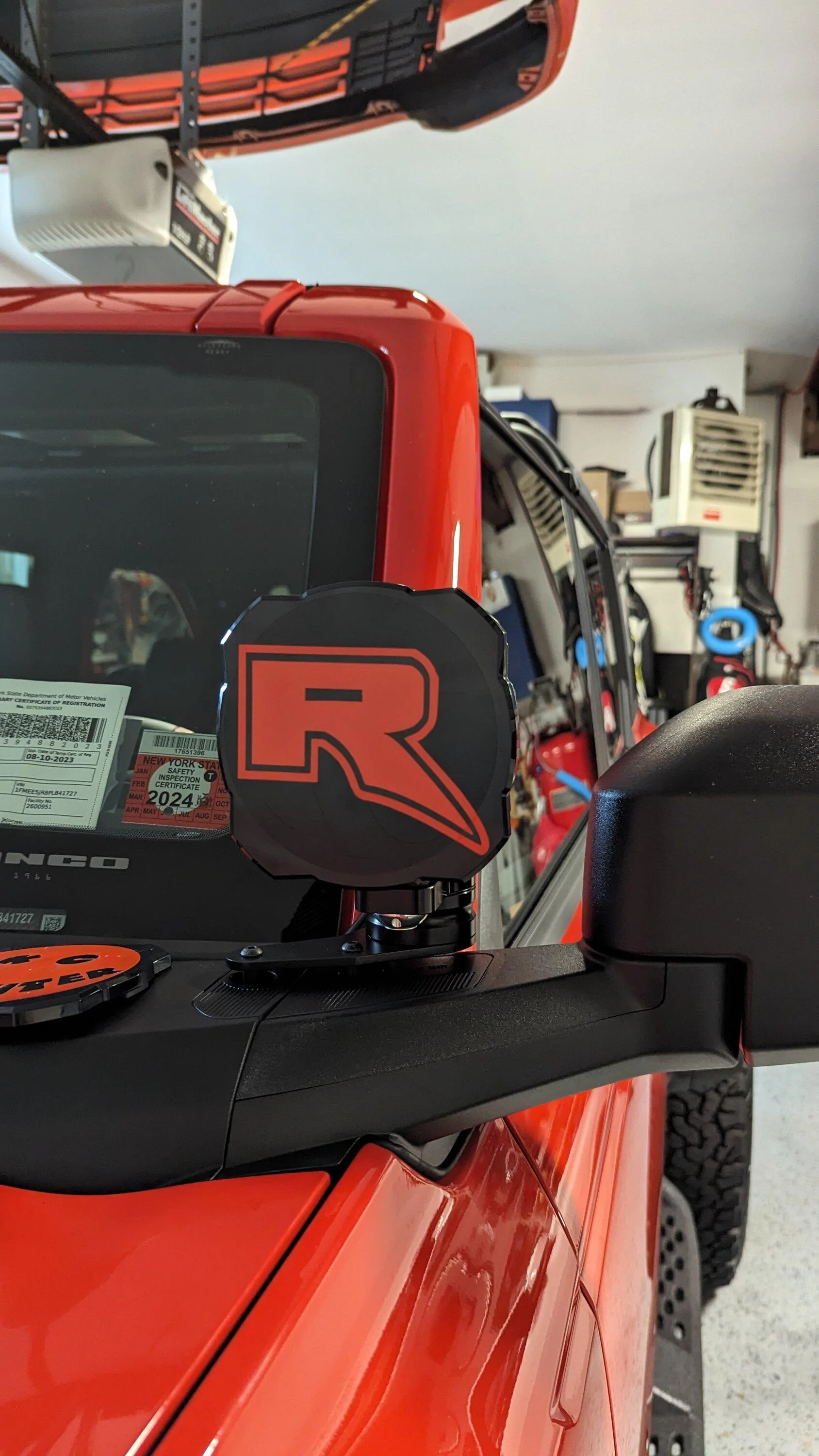

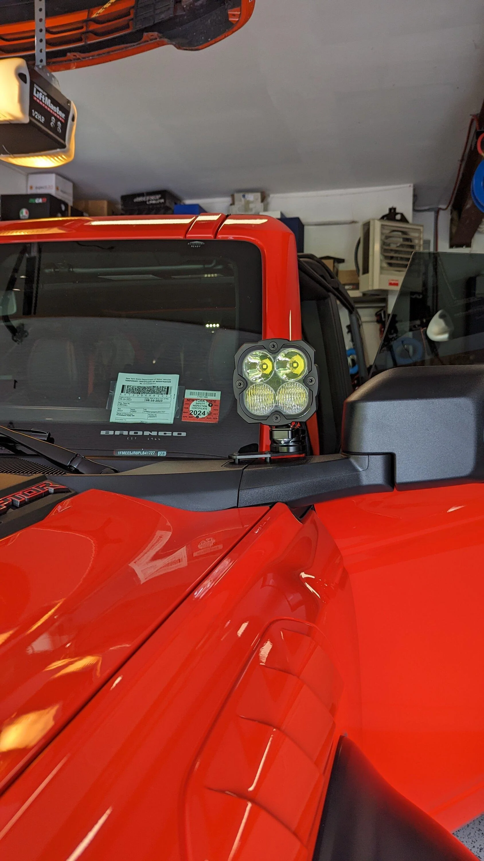

I like the badassmount. How do you like it and what made you choose it?
I liked the quick release swivel aspect. Last thing I'd want to do is keep my lights loose enough to swivel so they come loose while driving...they can be super tight and locked in and I can still quickly and easily pivot them left or right.

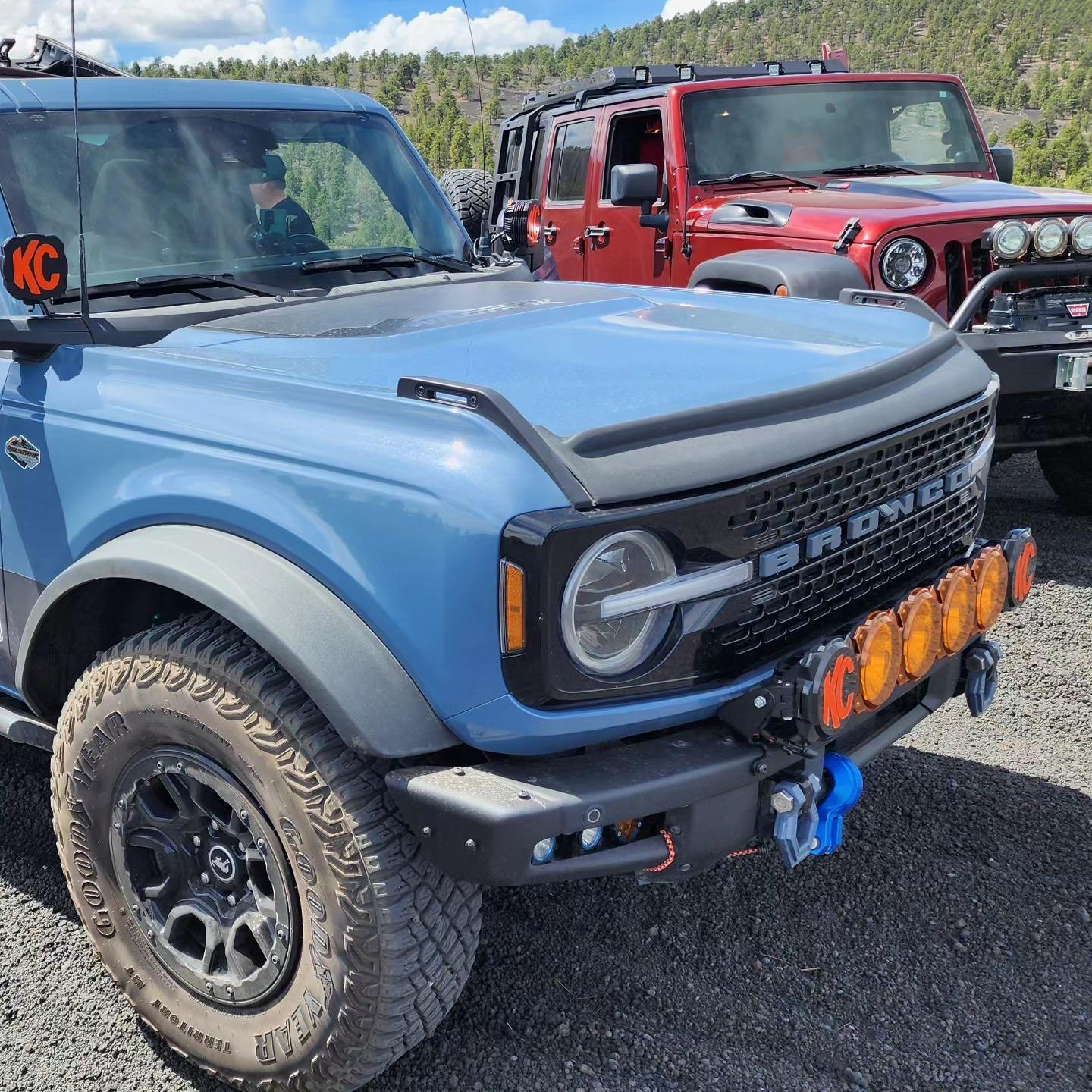

That badassmount looks pretty sweet. My drivers side mount is also holding the race radio antenna so it required a longer bolt.
Flex Era 4 here as well. On switch #2
KC Fog Lights Offroad setting is on Switch #1 - had the highest draw IIRC
PRO6 was I think the lowest draw of the bunch. I wanna say Switch #3
Flex Era 4 - Amber backlight on switch #4

Did you use the standard A-pillar bracket from KC for this mount?
https://www.kchilites.com/bronco-ford-bracket-light-mount-ditch-7333.html
I am leaning two the Flex vs the Pro6 for the A-pillar

I used the stock KC bracket. I was thinking of getting a Badass mount for the Chase light so I could re aim it when camping or whatever
