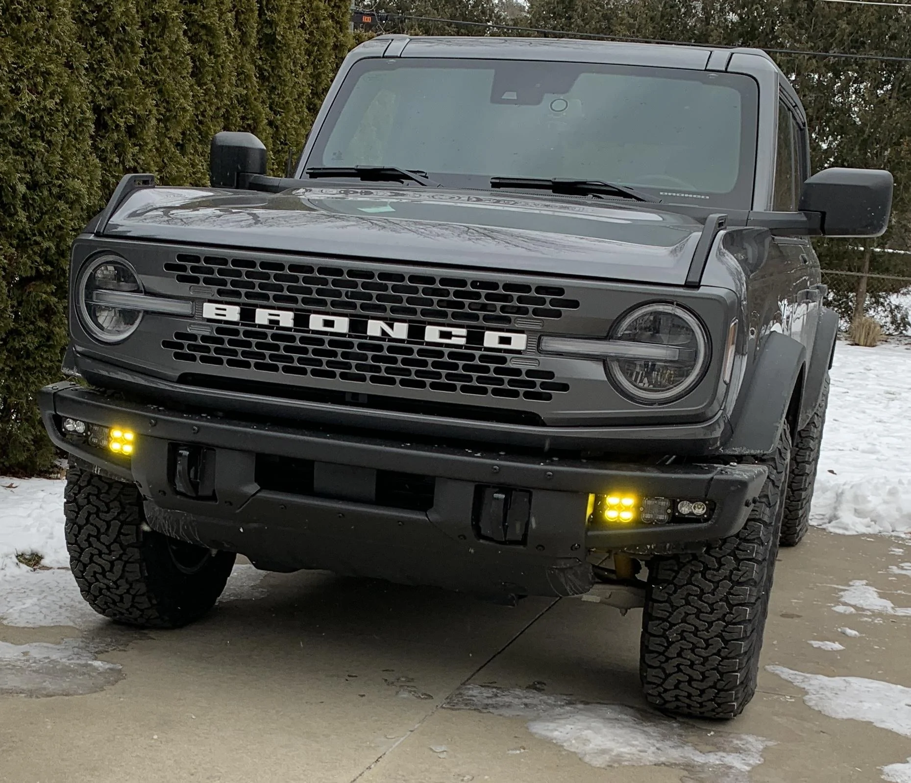

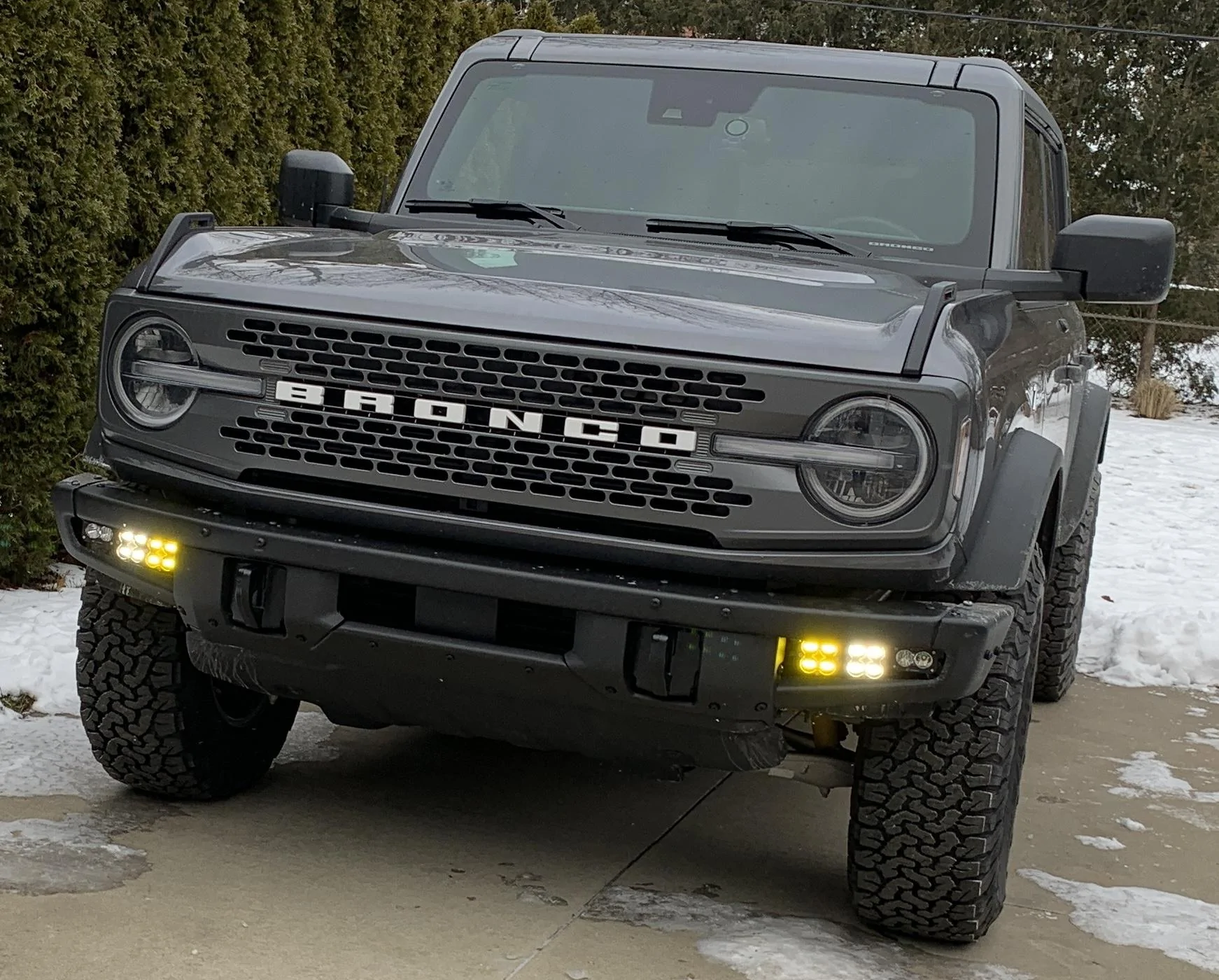

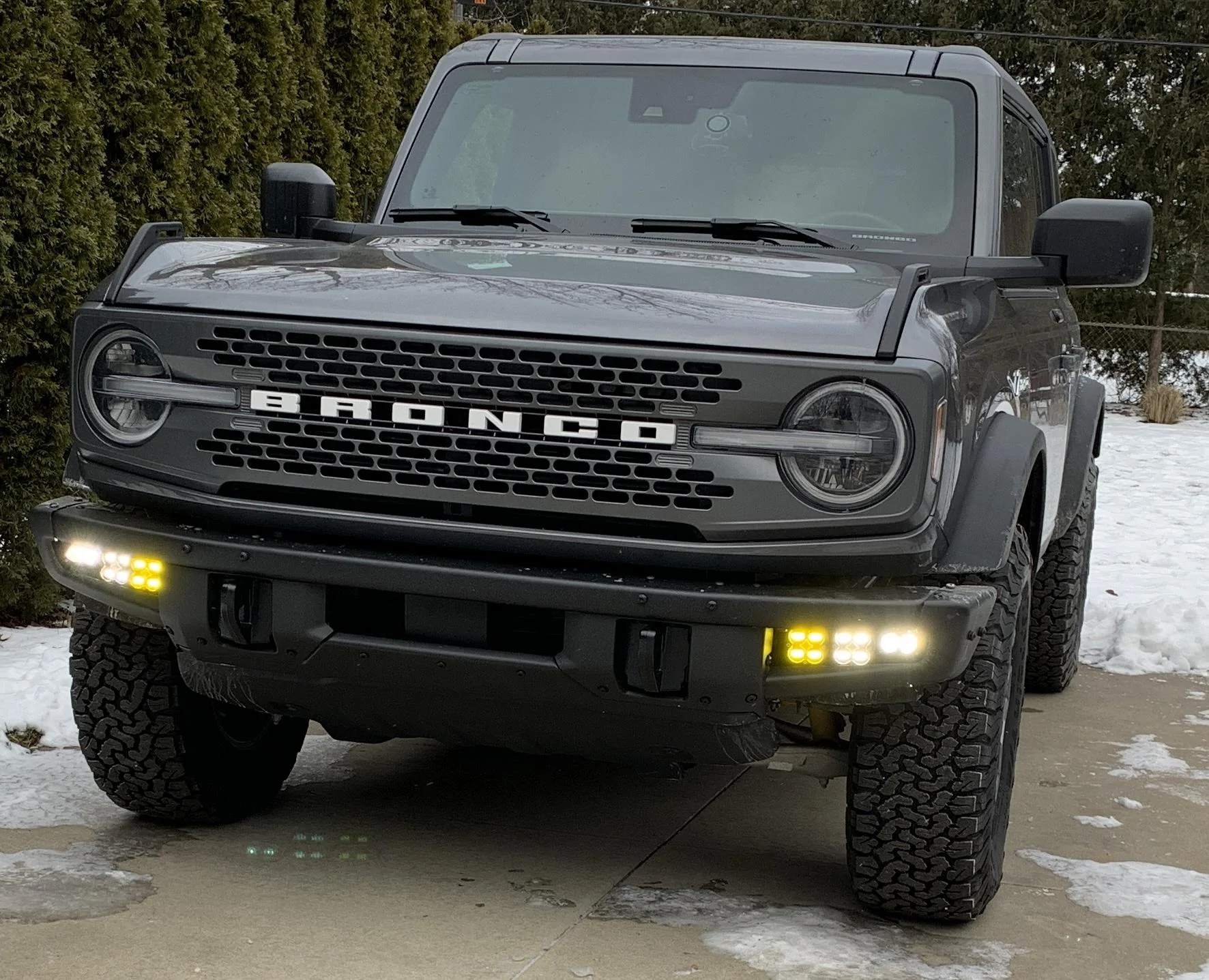

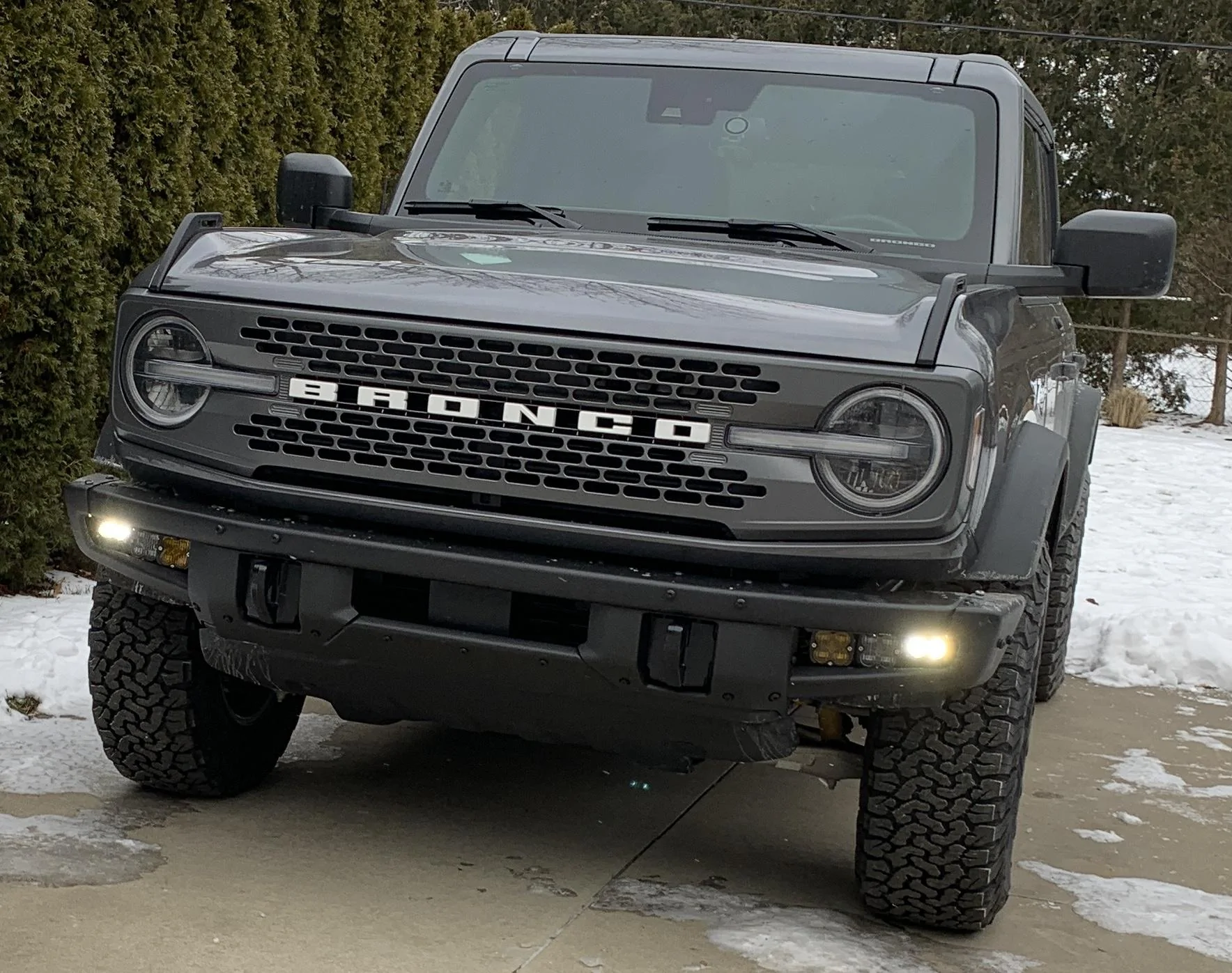

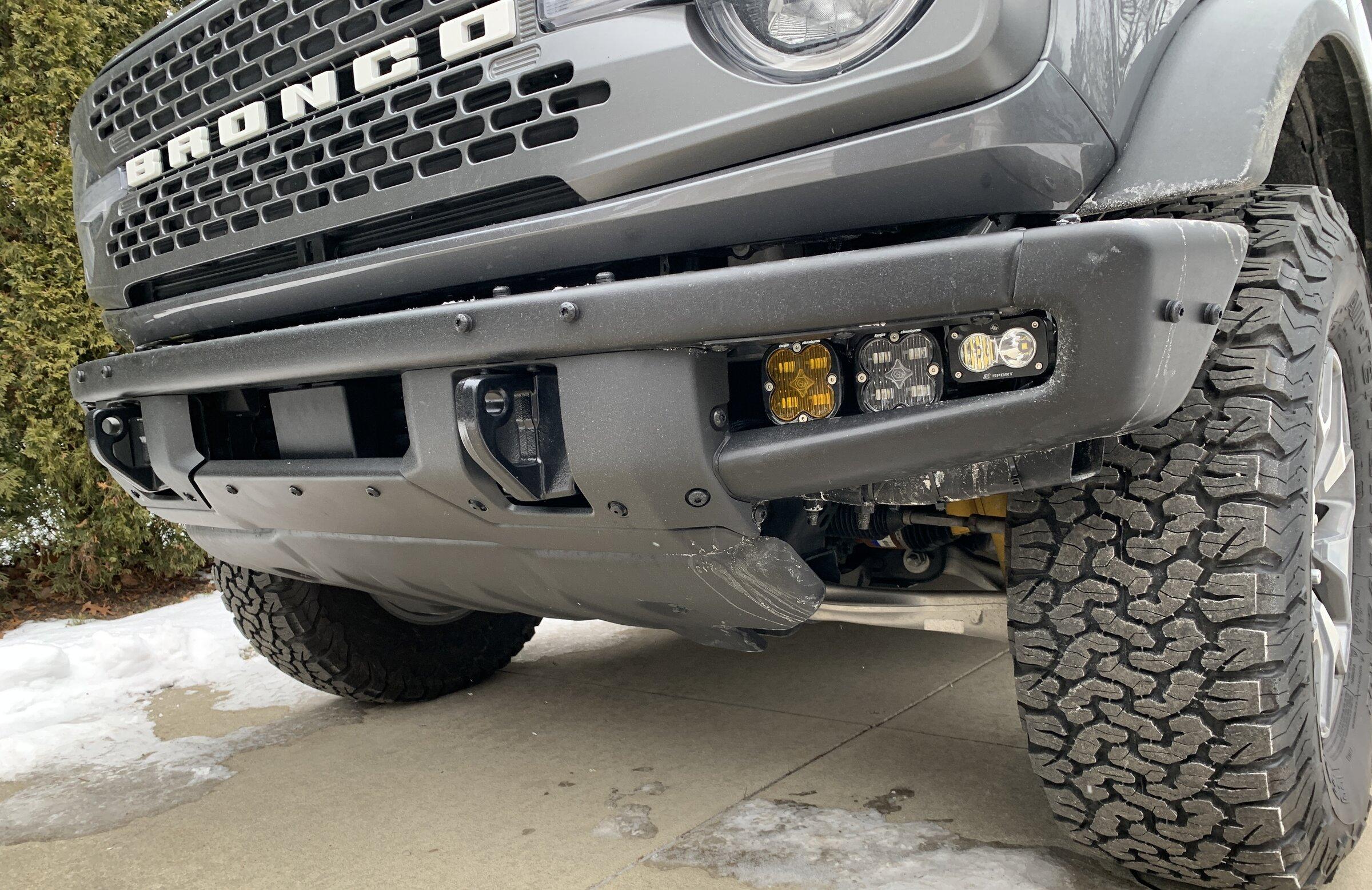

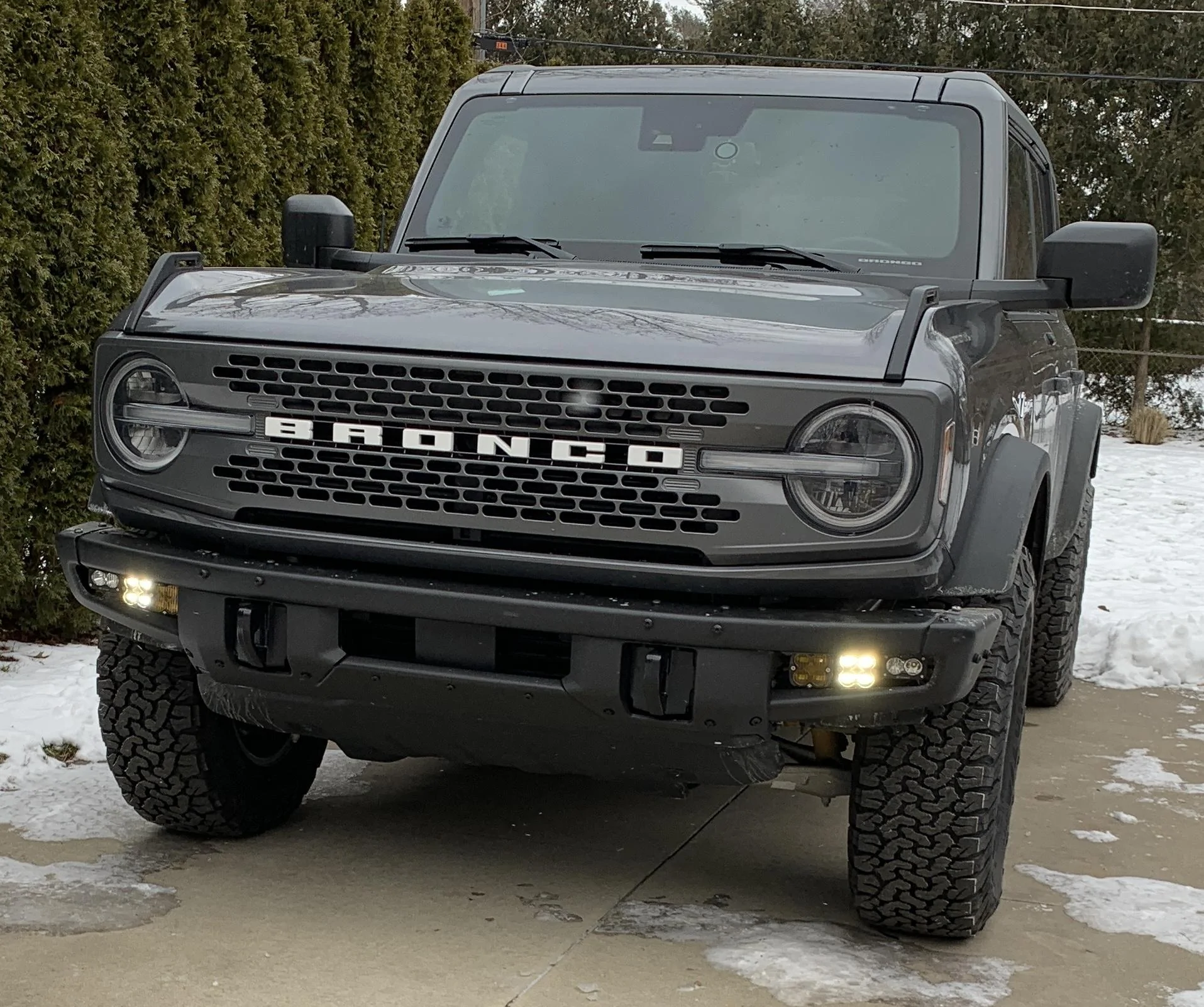

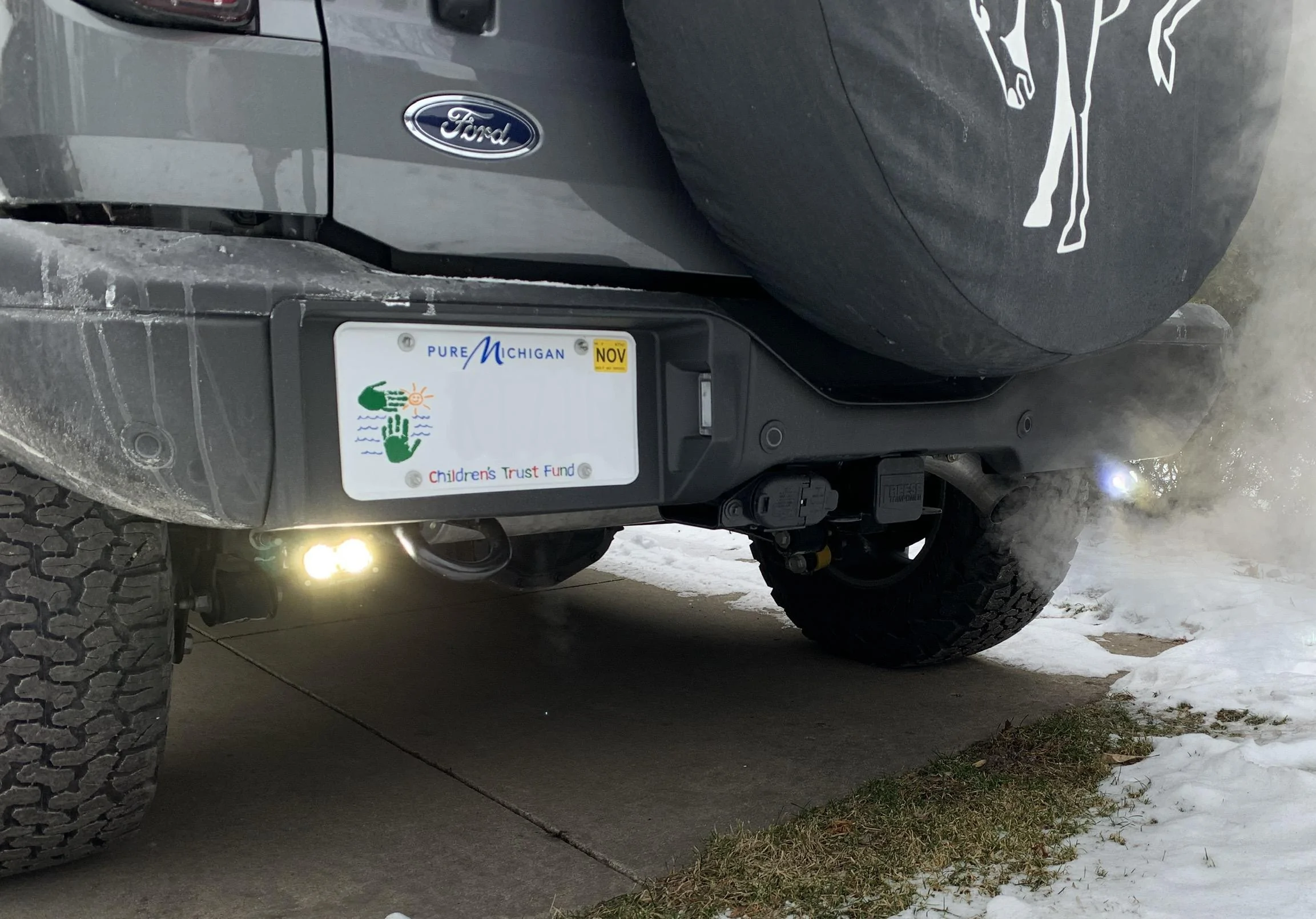

I just finished installing my Fog Pocket and Rear Bumper lamps from 4x4TruckLEDs. Went with Baja Designs across the board. The harnesses and brackets from 4x4TruckLEDs made the install pretty easy -- even with temperatures in the 20Fs. No, I don't work for 4x4TruckLEDs, nor am I affiliated with them except being a customer. Right now I'm controlling each of the fog lamps with independent switches. A fourth upfitter switch for the rear. Both pair of Squadrons in the front fog kit are SAE/street legal. S2 Sports are not. I haven't connected the rear lamps to the factory backups yet (wired 'or' with diode)... not sure I want to, but it's an easy tweak if I decide to do it.
Looks great! Thanks for the business.

I dig the rear bumper lights. Been thinking about red ones for bad weather, and down low like that should work nicely.... wondering @Diode Dynamics has something. Haven't really searched it out....and easy to mount and wire for us non-mechanicals....would be nice to just add into fog lamps wired to the Aux switch together...
We do offer a Flush Mount Kit for the rear bumper with a red running light that comes with a full fused and relayed harness. However, it is not bolt-on like the on in the above images.

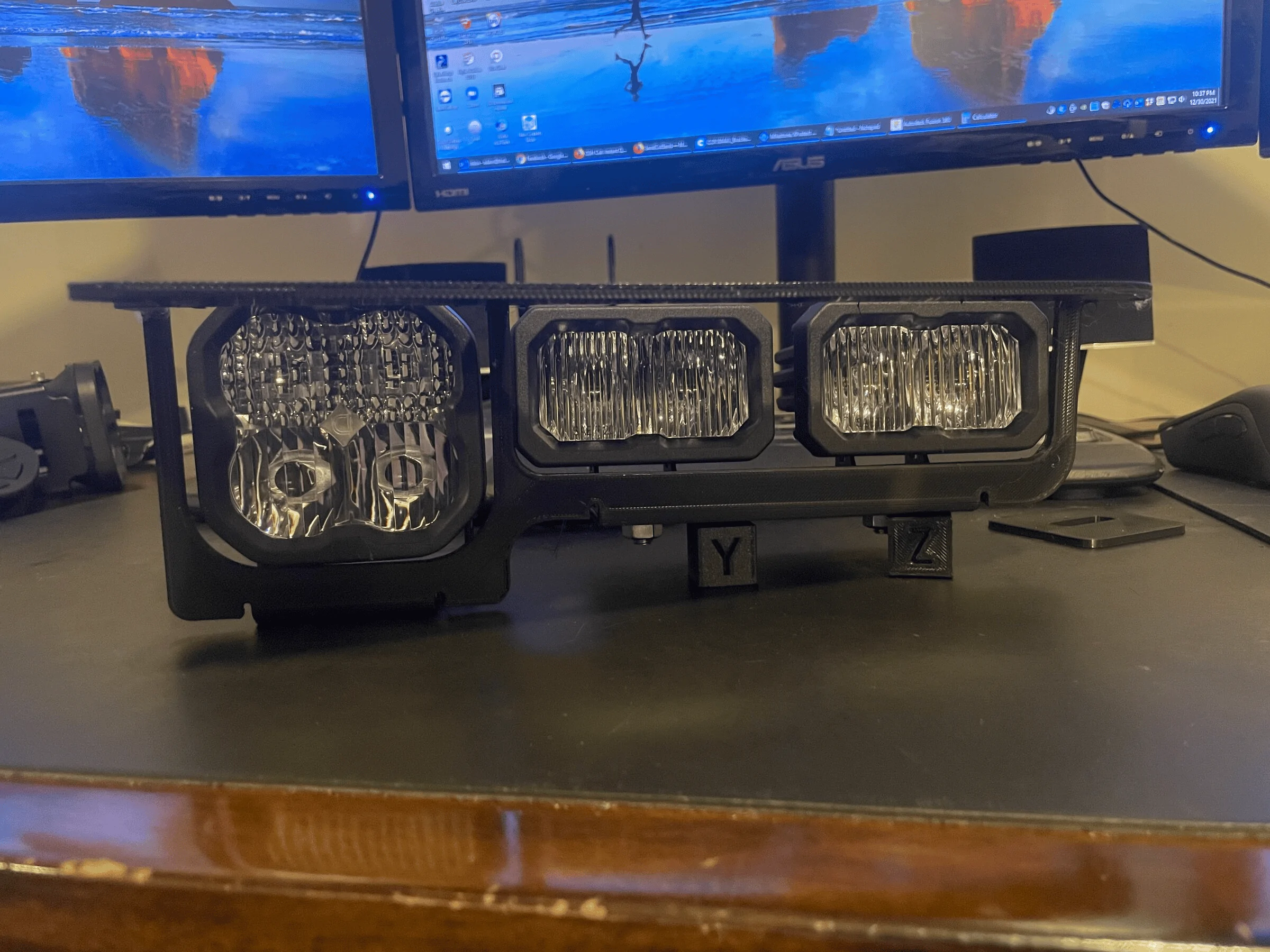

We're working on one. I have the prototype (made from stainless steel) arriving to me Monday for fitment. But it looks like this (this is a 3D model I printed)
Here is a photo with Diode Dynamics (grin). We designed them to work with both Baja and Diode Dynamics

Great, just one more thing I want. That looks way cool! Thx, Adam.

thats amazing new. Nice work, Adam. Rough time to being ready to sell/deliver?

Looks awesome!

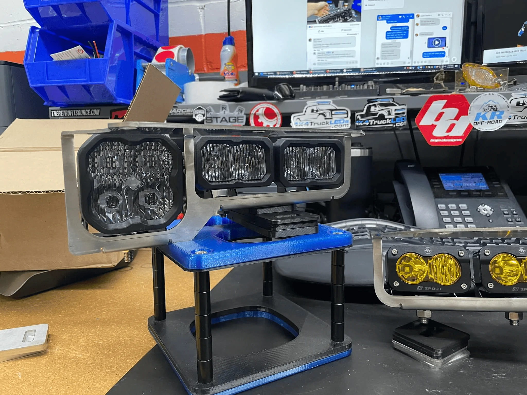

Here's the protype made from stainless (need to redesign it a bit)
BUT making progress!

No, I haven't. Inner lamp is 1 (Amber SAE), middle is 2 (White SAE), outer lamp (White Sport S2) is 3. The rears are on 4. It's pretty easy to move them around if I want or need to. I've been wondering if there is a good marine grade/underhood junction block for the upfitter wires. Seems it would be good to have.
