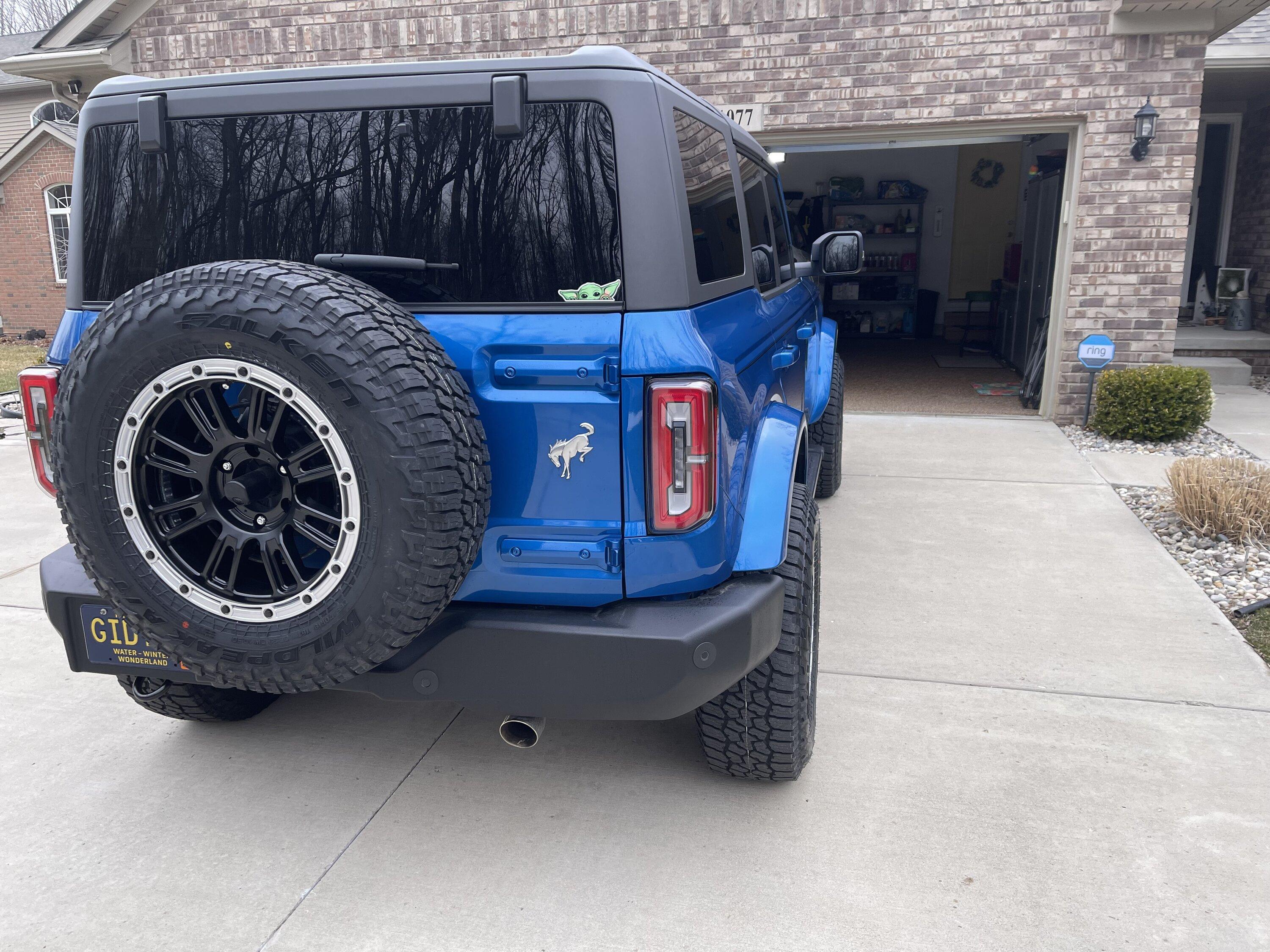

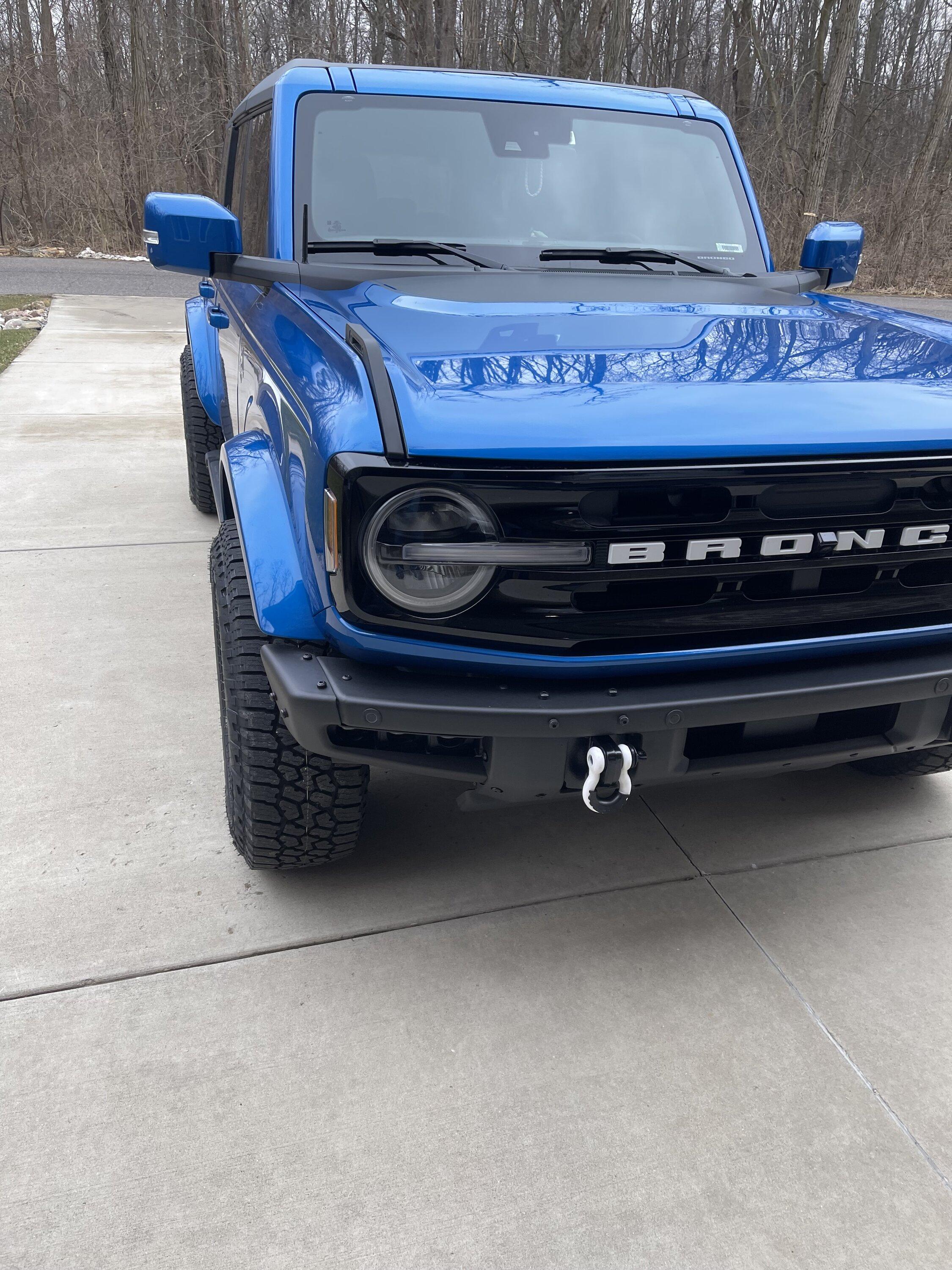

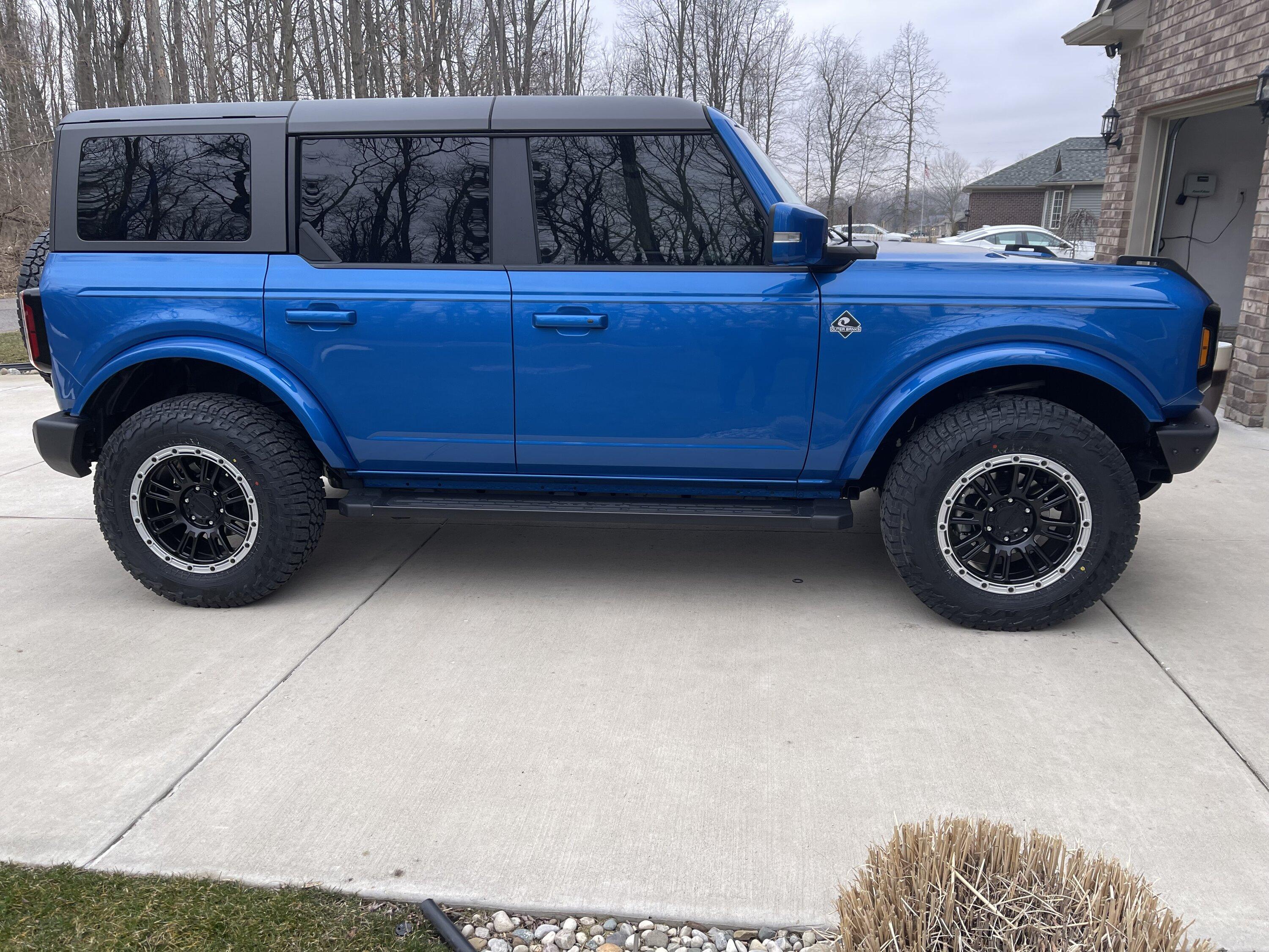

As a fellow OBX owner that also didn’t care for the stock wheels I put on 18 in Raceline wheels with a +12 off set and 26570R18 Falken Wildpeak tires. This gave me a better side to side look and. 33 in tire with no impact to ride handling or mileage. The largest I could have gone was a 285 but that would have provided a poke past the flares. Good luck.
