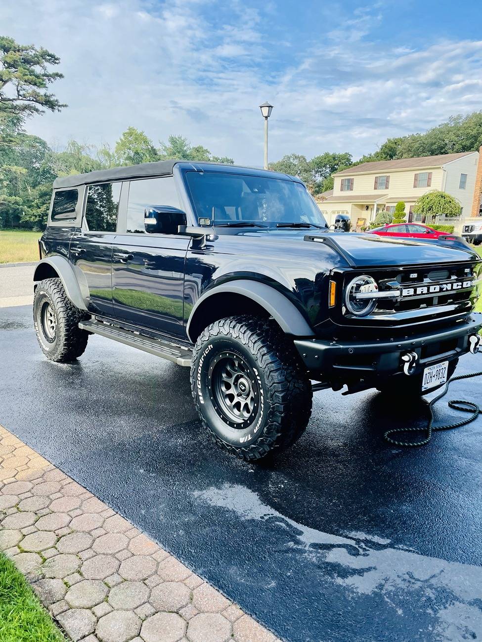

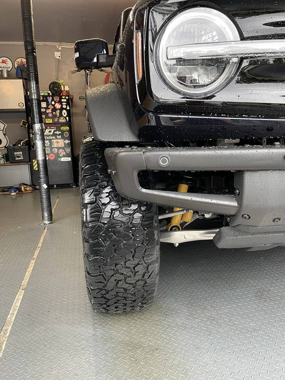

Here's a couple of pictures I grabbed off here with 17x8.5 -10 offset wheels on a truck with Sas flares. They will poke out some but it's not too bad.

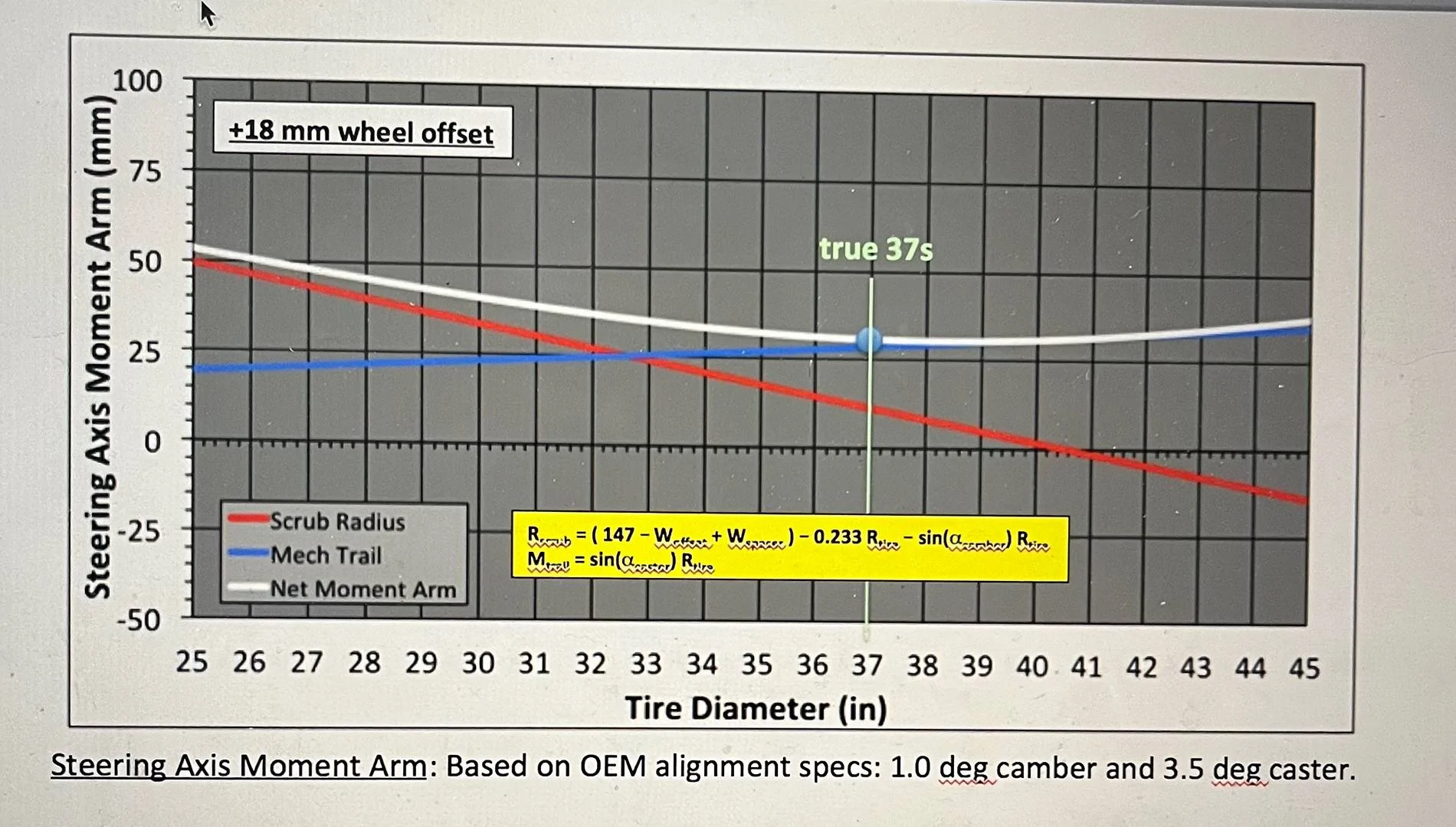

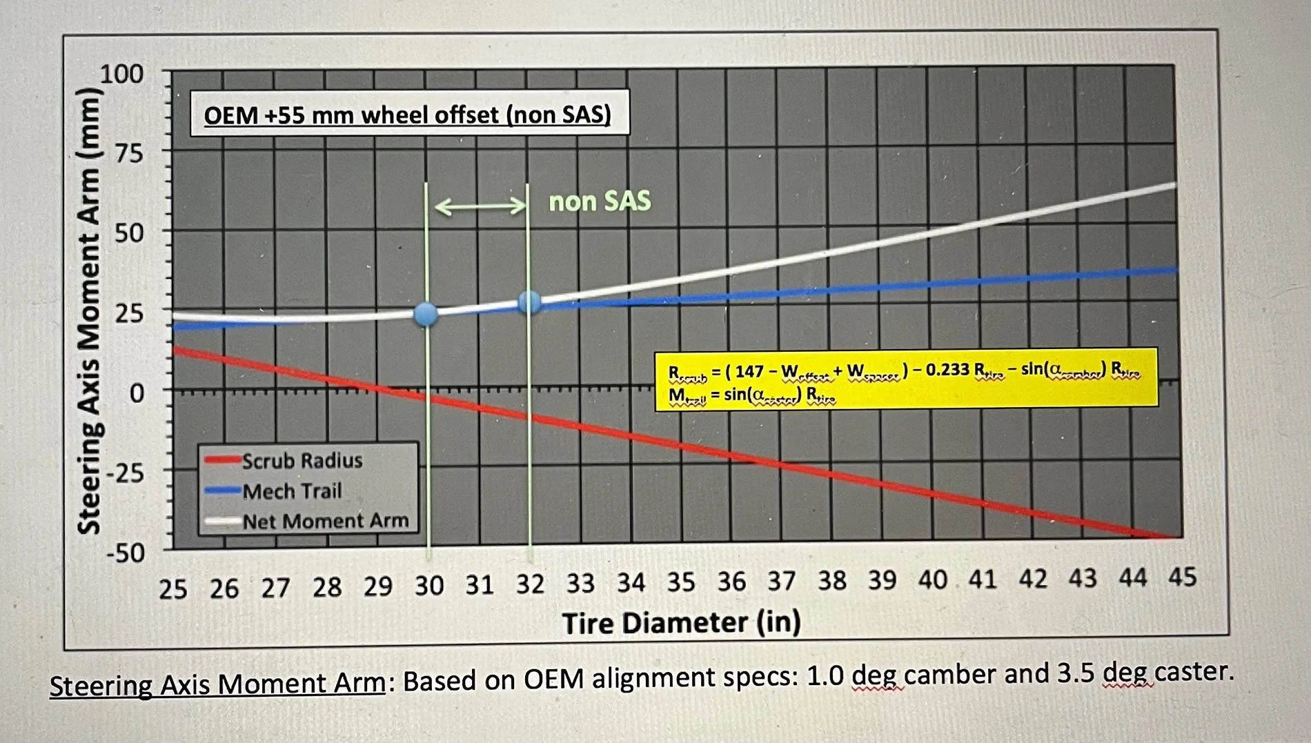

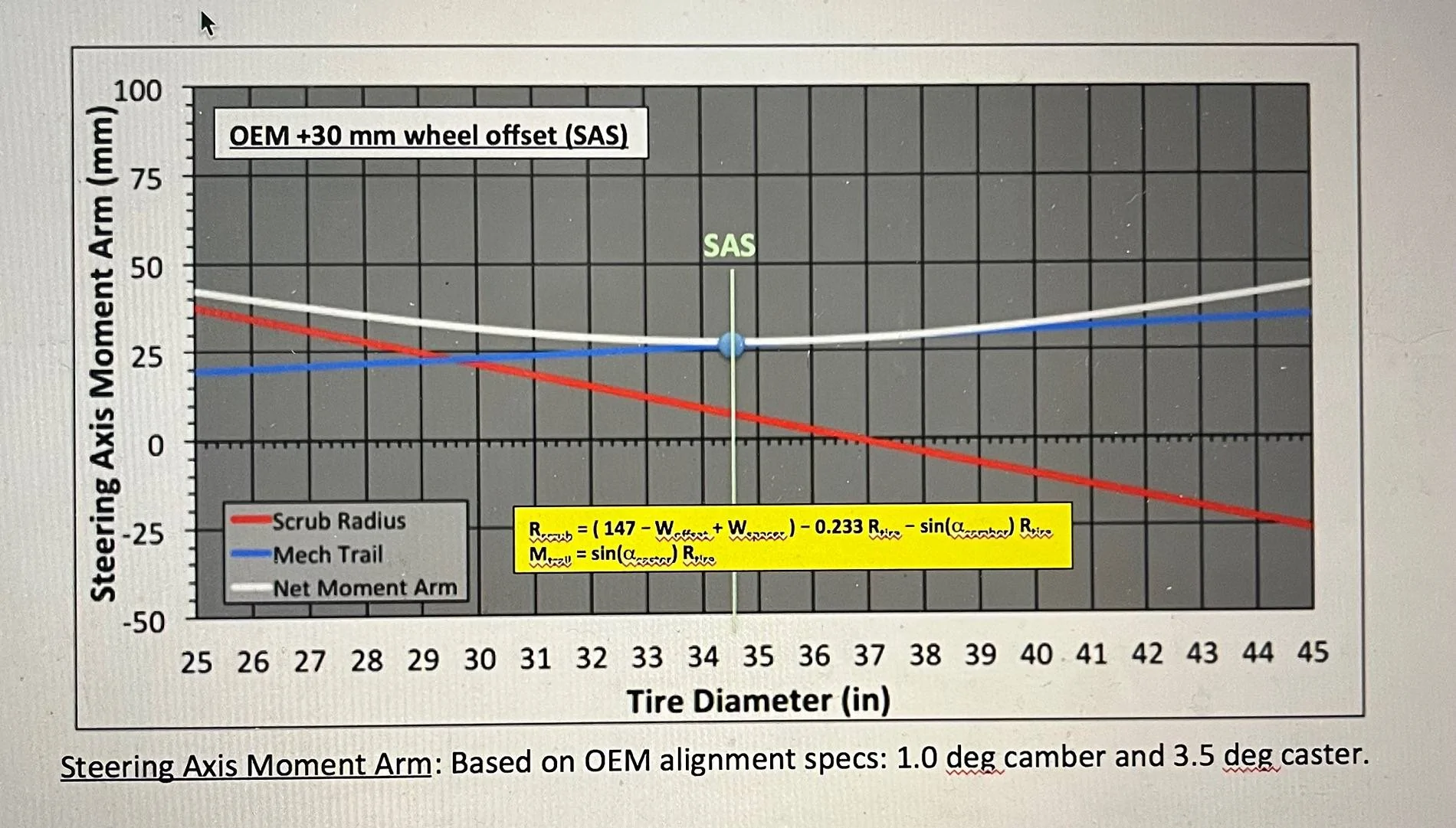

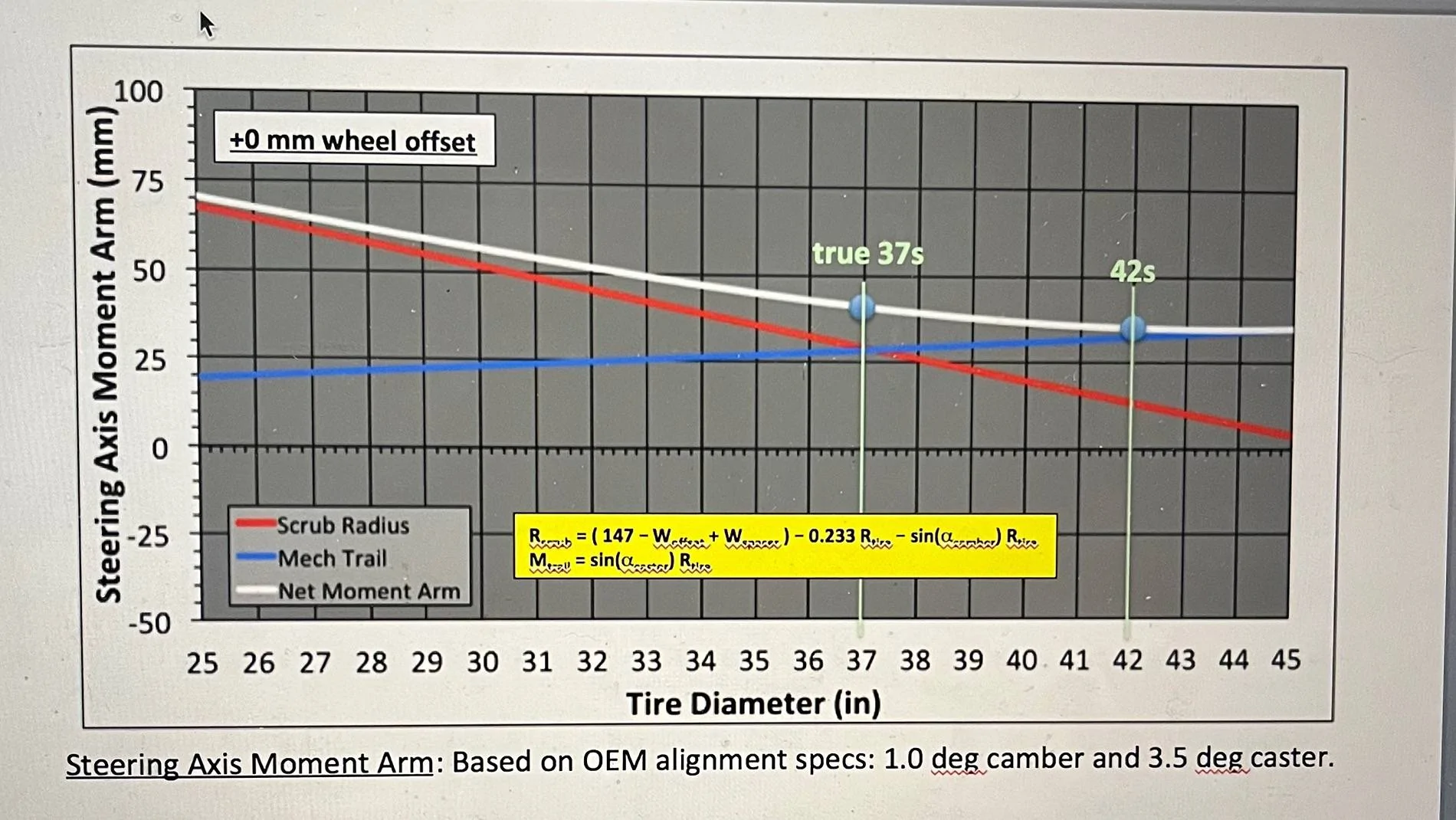

If you are wondering how offset affects both scrub radius and mechanical trail then here are some plots. Otherwise just ignore.
