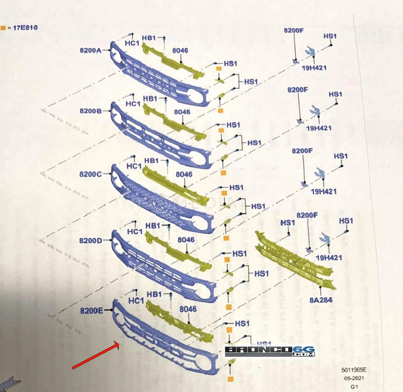

So check out this picture. Notice the 8046 part looks a little different depending on which grille it's paired with.
My thought is that if someone really wanted to do a swap properly they would order their grille of choice AND the corresponding bracket 8046. It looks like that 8046 part is what is going to provide that hood latch mechanism protection.
Of course this is purely speculation as I don't have my Bronco yet.

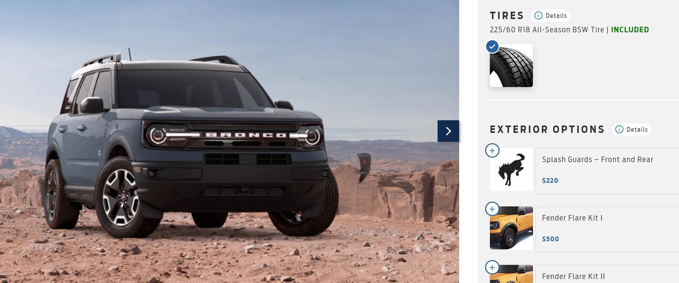

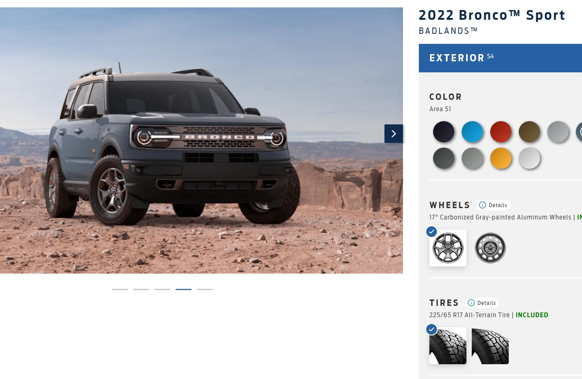

I just joined this forum today... I'm about to get either the Badlands (BL) or the OB (outerbanks) bronco sport. I love the navy pier seat coloring and I'm trying to see if I can get the navy pier seat coloring on the badlands model. It won't let me add the pier navy seats to the badlnds model.. only to the outerbanks model when I enter in the build I want on the ford website.
Sorry to make myself look dumb... but when you guys write "OBX" are you referring to the outerbanks grille?
I like the grill on the BL (the egg crate-like design with gray finish ) and I'm trying to get the guy at the dealership to order me the outerbanks with the badlands grill...
From reading this thread it appears most people prefer the outerbanks grille? Meaning the OBX grille? Thanks!
PS: I am sill conflicted if I want the BL or the OB. I will never go off-roading other than light camping. Hence why I'm leaning towards OB model... but I don't like the grille on the OB.

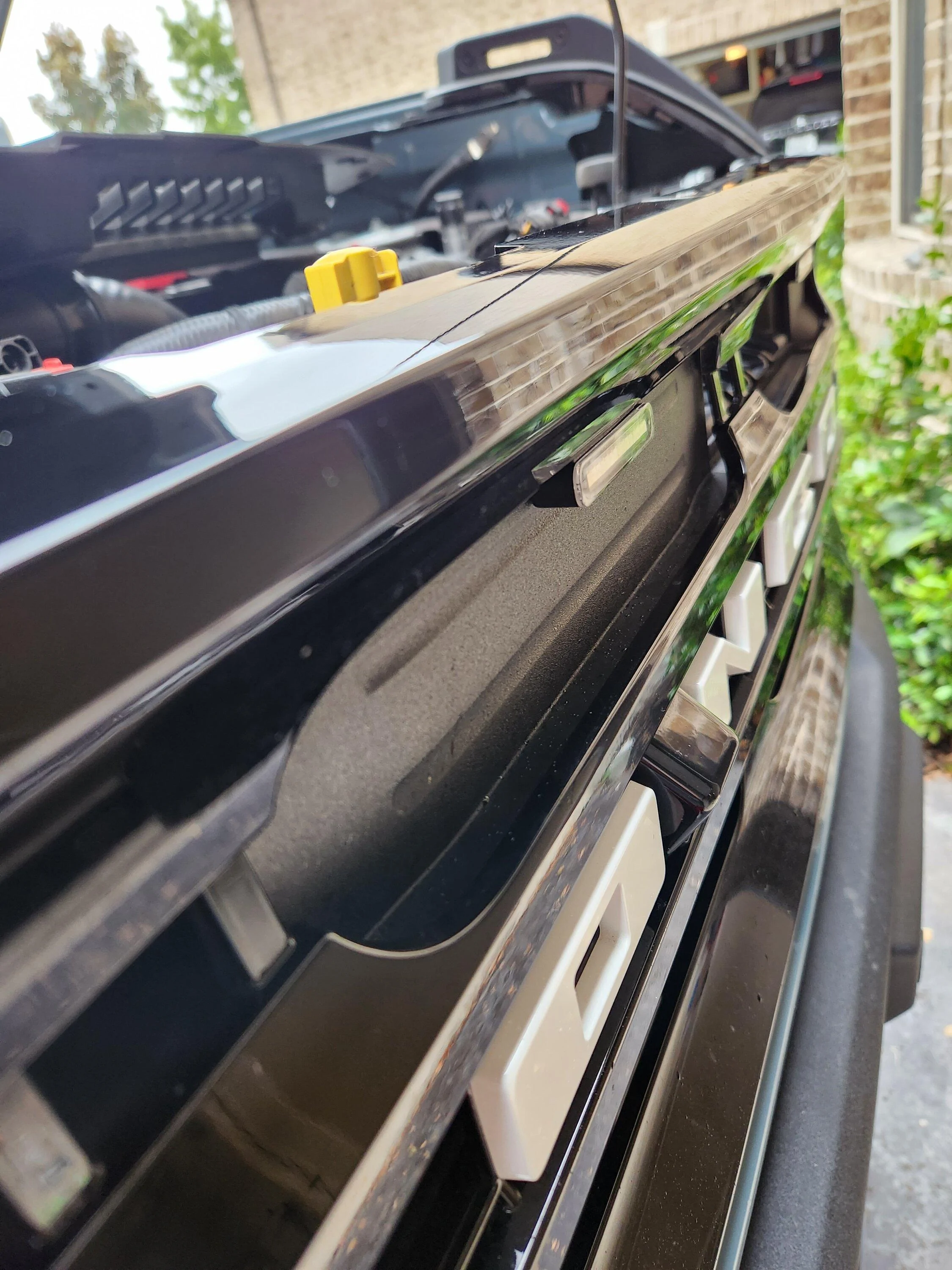

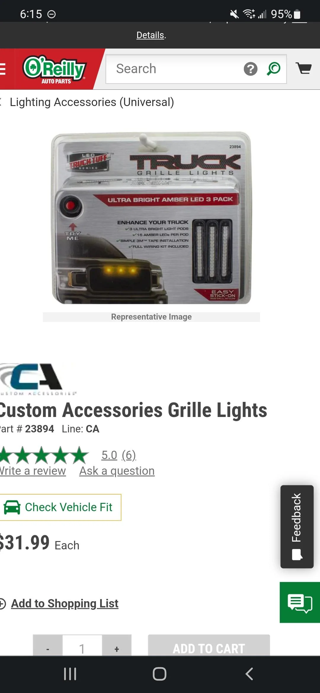

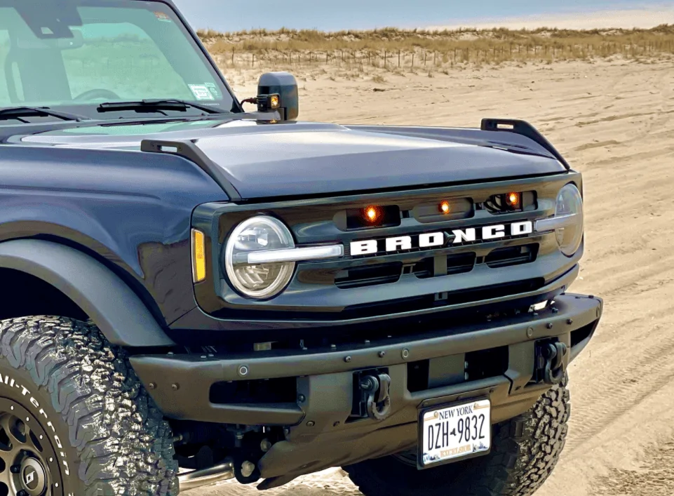

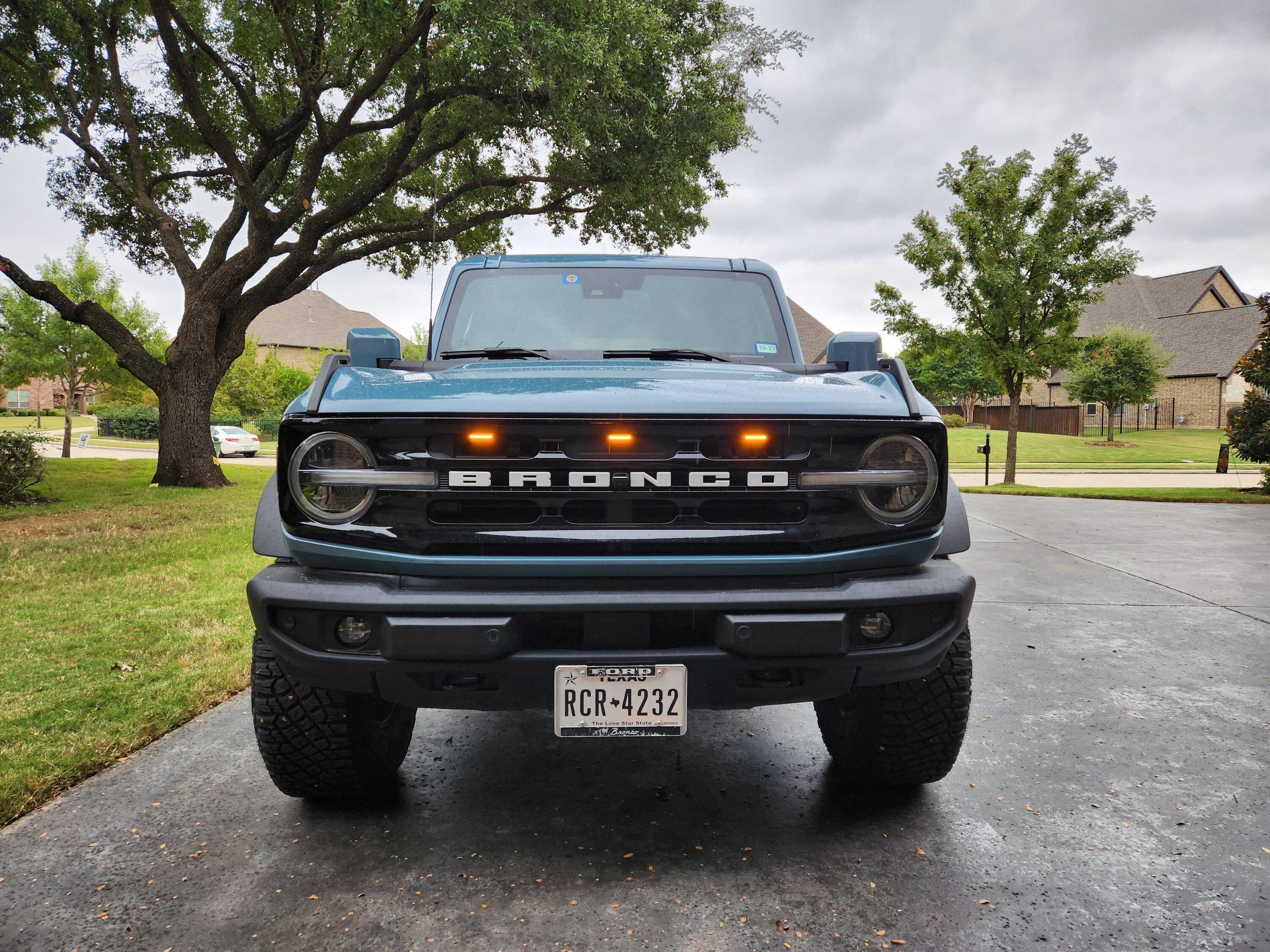

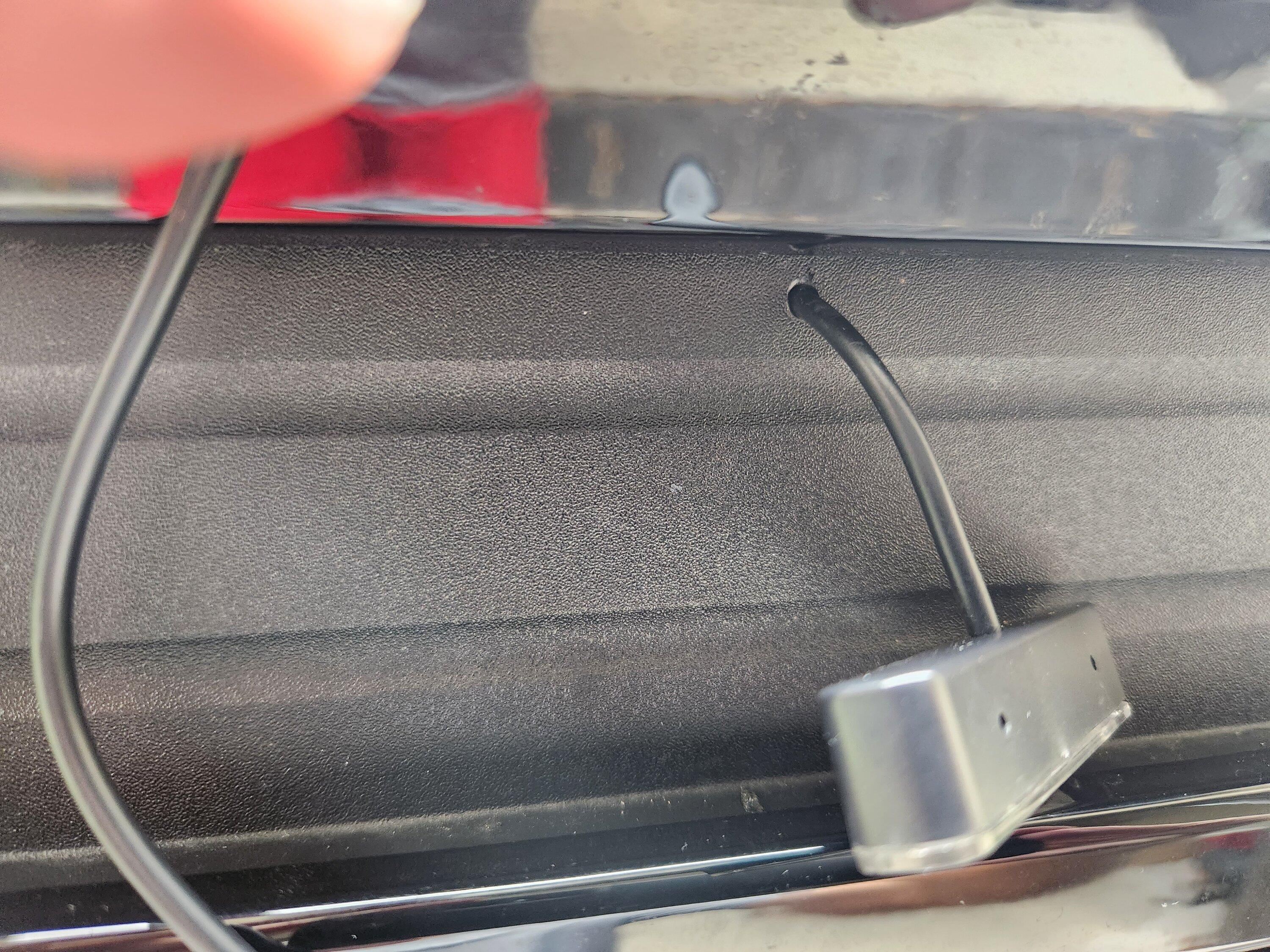

Below is some pics of my install of led lights from Oreily auto on my outer banks. They look and fit great and hope they last. I drilled a small hole in center grille to run my wire through otherwise the light would stick out to far. Simply spliced wire and soldered back together. Ran wire back to fuse block and tied in using ad a circuit to spare circuit that comes on with ignition. Lights install by using provided 3M provided tape.

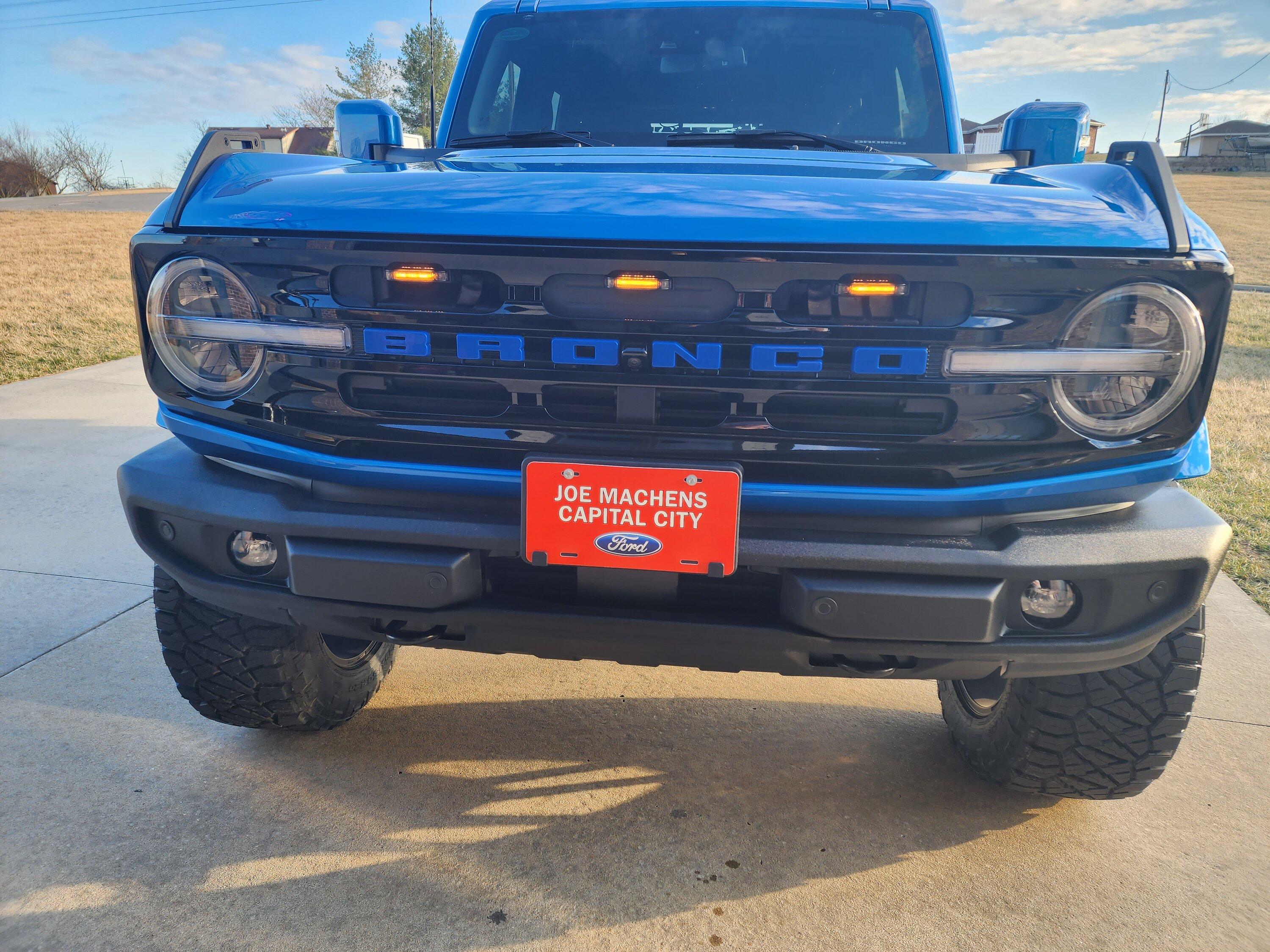

I ended up using a fuse tap and some amber LEDs from Amazon (links below). I used 3m heavy duty adhesive to attach the outer 2, sure seems solid, the center one is attached with screws since there is actually something to mount to. Total cost was less than $30.
Micro2 Fuse Tap (5A 10A 15A) and Fuse Puller https://a.co/d/cmap0n5
3Pcs 4" Inch Amber LED Center Grille Running Marker Light Kit Smoke Lens Pro Grille https://a.co/d/3m9VKcn
