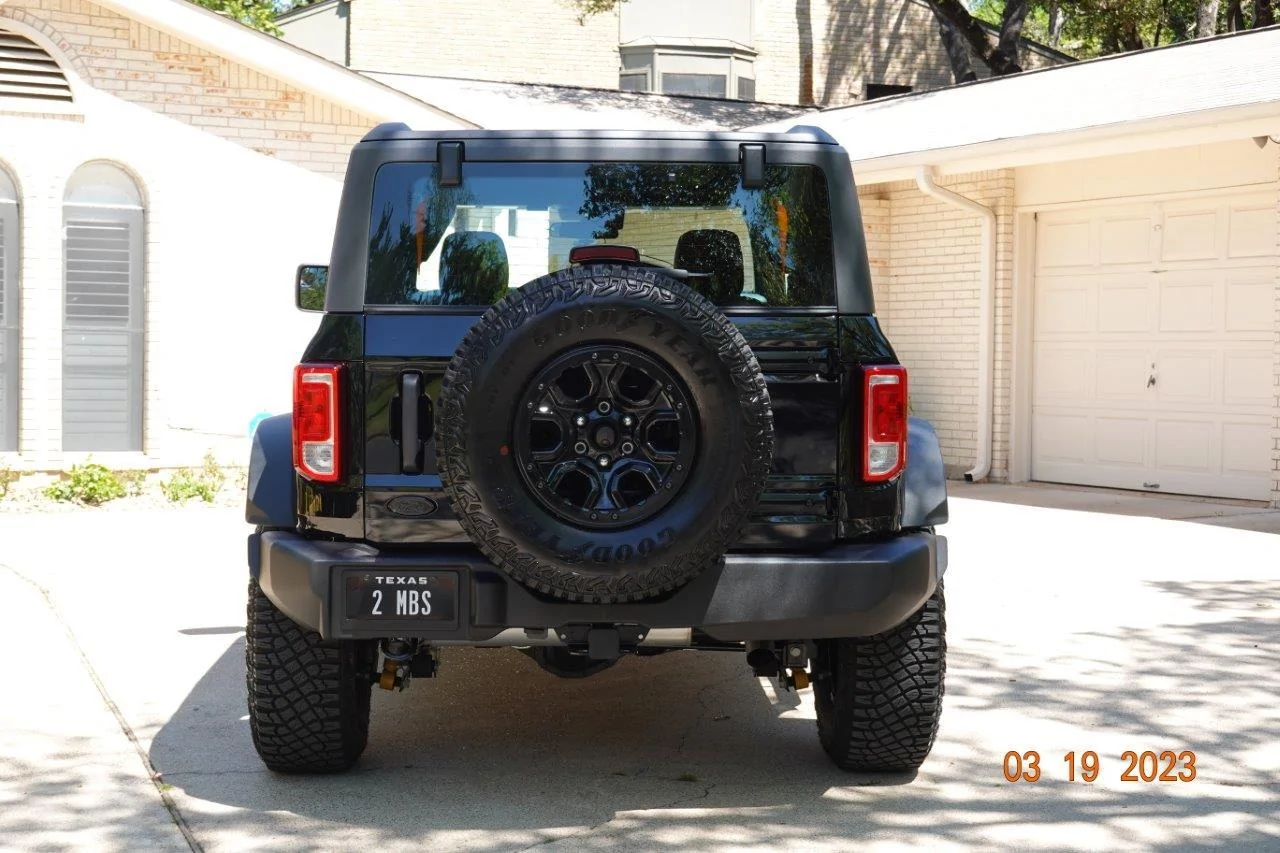

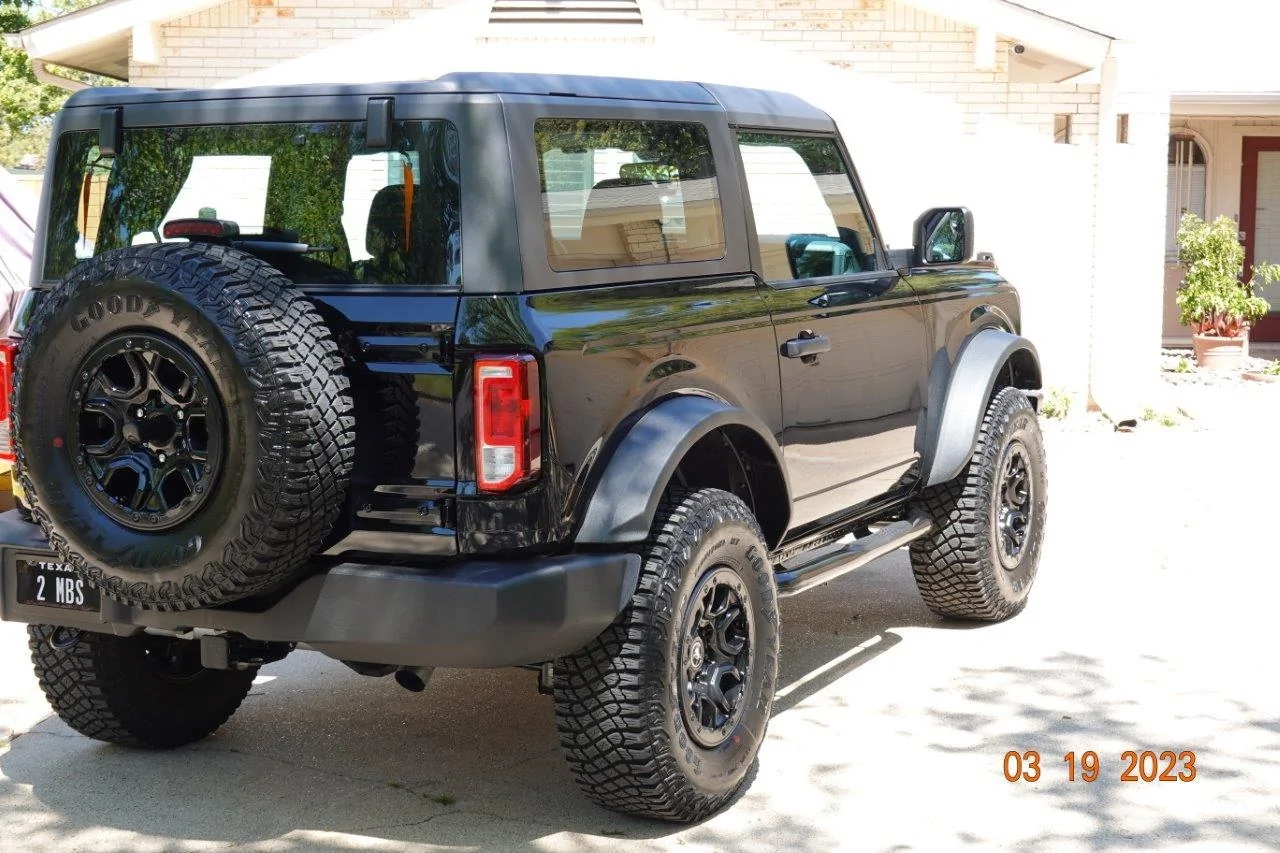

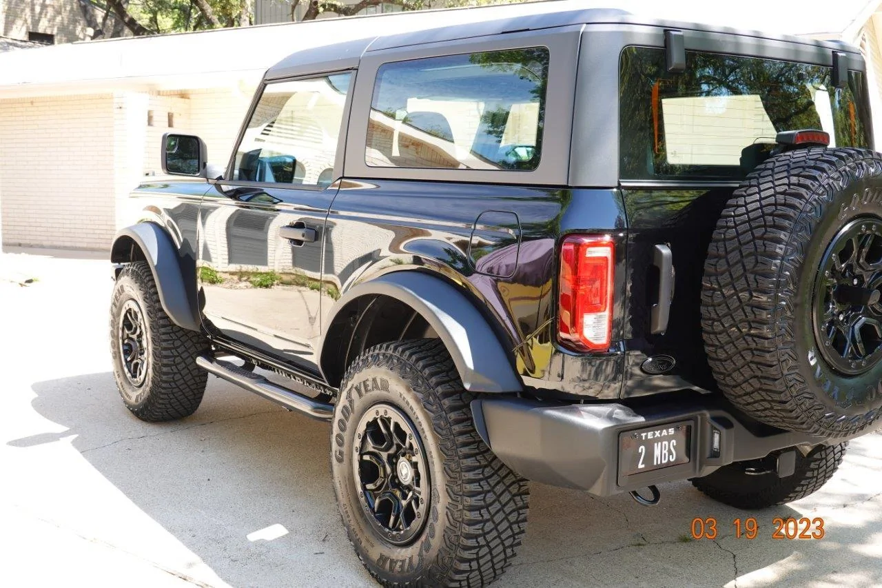

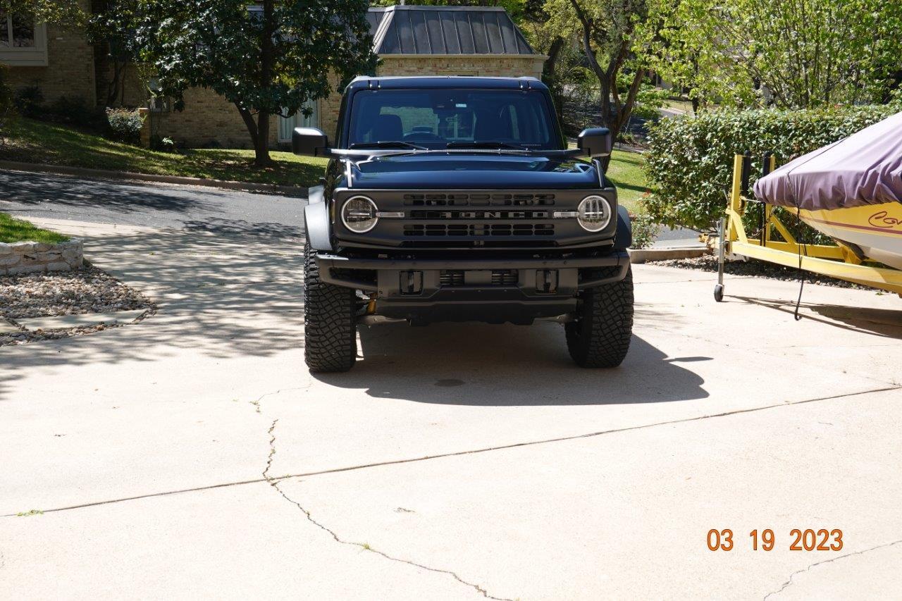

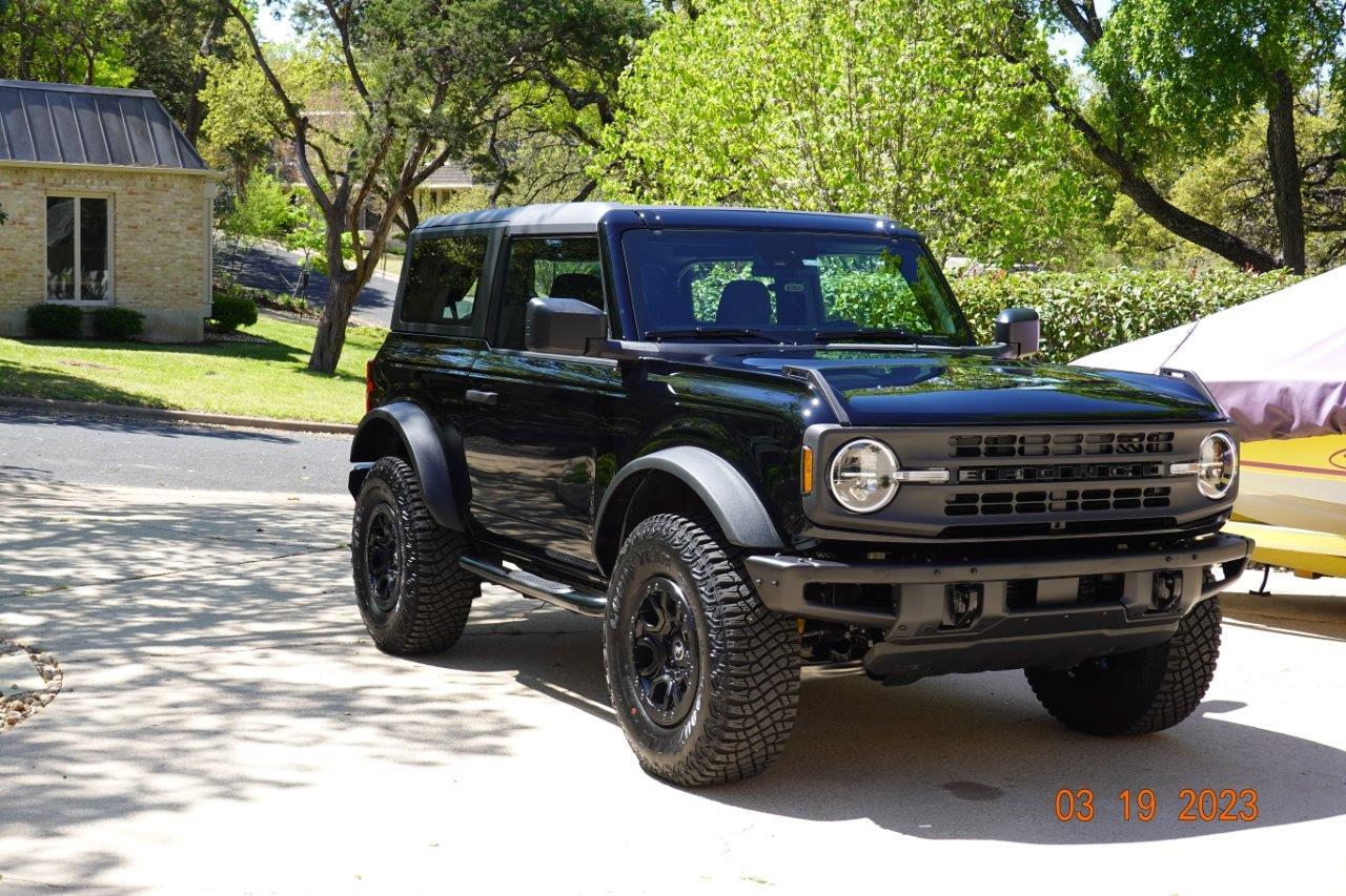

Just picked up my my fender flares and grill from the paint shop. Loving the all black look.
Ford Bronco Painted fender flares and grill gloss black F63E42F8-0A70-4C17-A5EF-92EB52D8030F

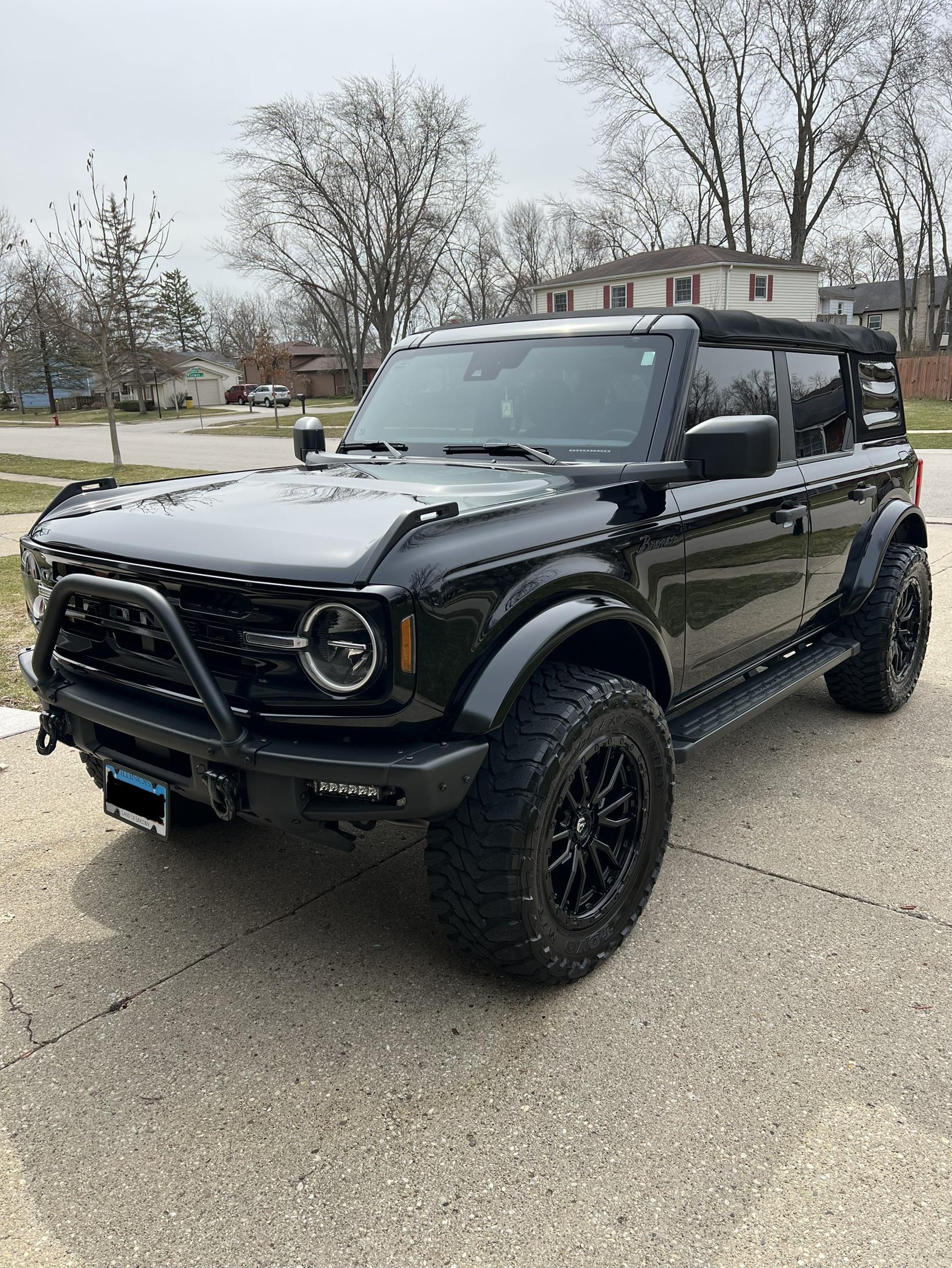

Where did you get the LED lights on your front bumper? Is that the Modular Bumper? Also, where did you find the black Ford oval emblem?
