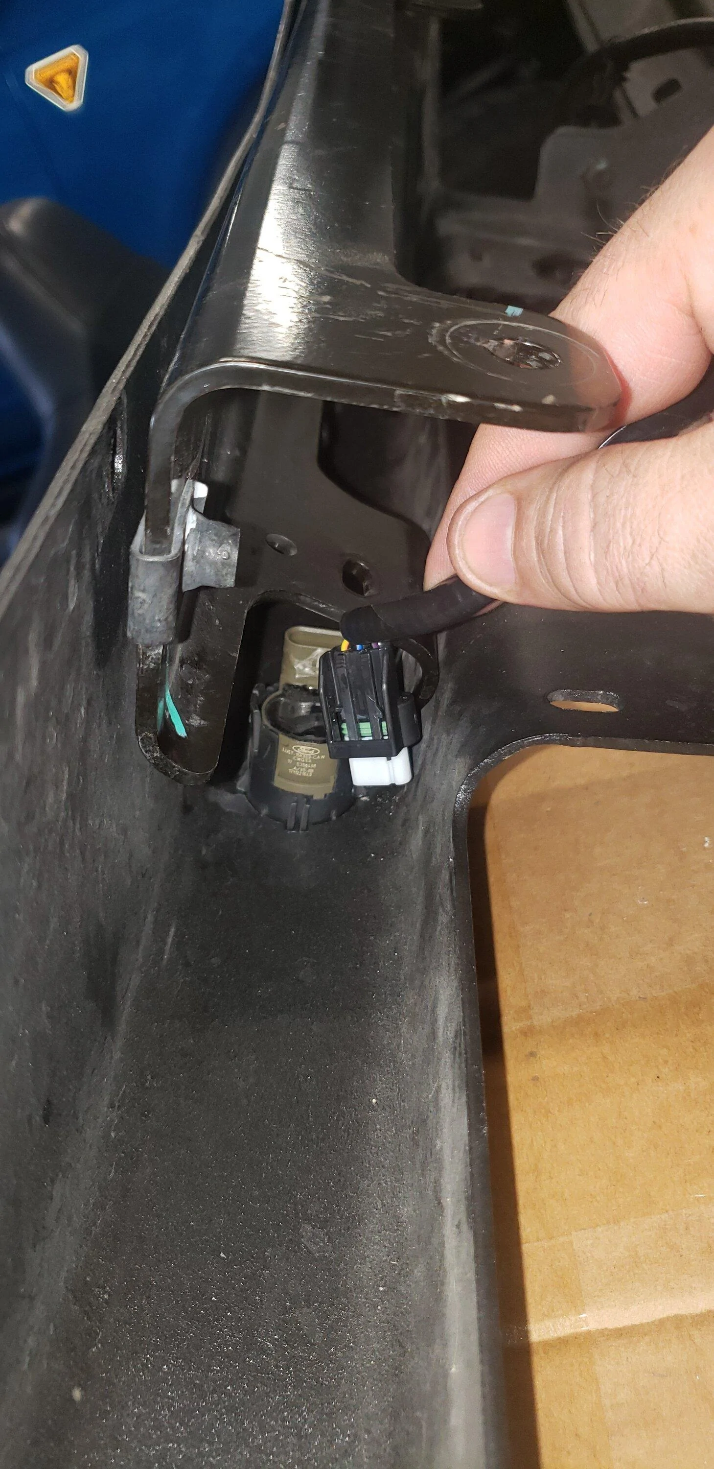

I went from badlands with capable to modular and had to buy different parking sensors. The original sensors had a connector that mounts front to back on the vehicle, while the ones you have and the ones I purchased mount 90 degrees and the plug goes in side to side . My original sensors did not leave enough room with the added modular steel brackets.
Also I ended up adding a hole with grommet in the steel support bracket to fish the outer drivers side sensor connector as I found this allowed me to shift the wire harness more drivers side. This allowed for an easier time connecting the main bumper harness to the plug inside the driver side fender

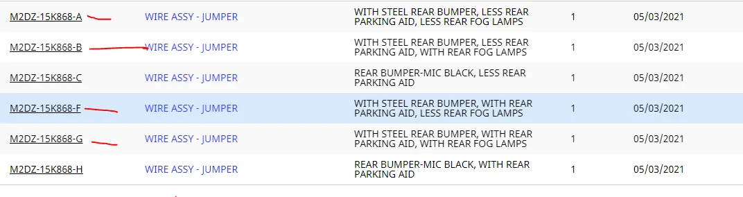

Steel rear sensors are LU5Z-15K859-AAPTM, left inner sensor bracket M2DZ-15K861-H, right inner sensor bracket M2DZ-15K861-G.
Left outer socket M2DZ-15K861-CC
Left center socket M2DZ-15K861-CB
Right center socket M2DZ-15K861-CD
Right outer socket M2DZ-15K861-CA
Here's your list of choices for rear harness.
