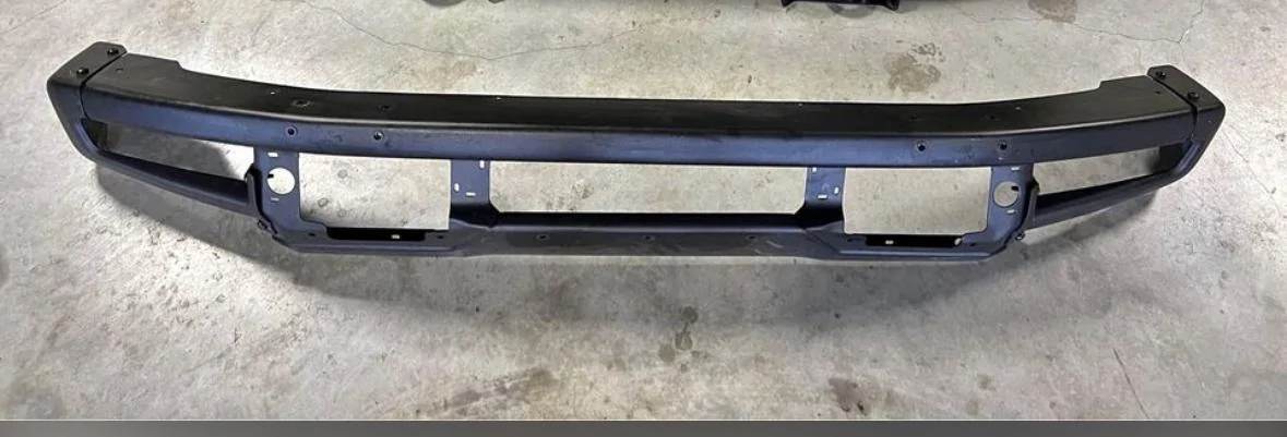

I have a 2022 Base bronco with the plastic bumper. i recently purchased a modular bumper off Facebook marketplace pictured below:
Ford Bronco Plastic to MOD bumper install IMG_0165
It does not come with tow hooks and I am aware i will have to cut off the original tow hooks if i dont change them out, so I went ahead and ordered brackets without tow hooks. Is there anything else I am missing for install? I tried mocking it up but there is no way it can get bolted on in its current state.

So there are three major pieces to get it mounted.
  • (2) Tow hook support bracket
  • (2) Bumper mounting plate
  • (2) "U" support bracket that goes over the frame and gives the bolts something to bolt into.
I believe the base bumper has the U support bracket, but everything else you'll have to source... and of course you need the bolts and the handful of trim pieces you are missing.

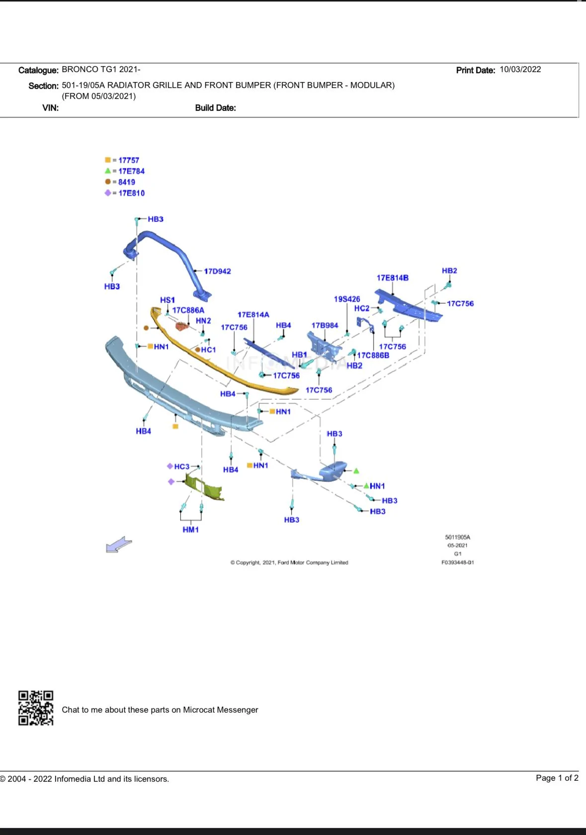

Do you have any part numbers or aftermarket solutions? I tired looking at this expanded view of all the modular bumper parts, but it's too overwhelming
  • (2) Tow hook support bracket - Not pictured
    • MB3Z-17A954-A
  • (2) Bumper mounting plate - 17B984 in your image
    • Left - M2DZ-17B985-A
    • Right - M2DZ-17B984-A
  • (2) "U" support bracket - 17C886B in your image
    • Check to see if you have it on your base bumper, I think you do.
    • Left - M2DZ-17C887-C
    • Right - M2DZ-17C886-C
And then of course you'll need all of the bolts/cips for it all. Realize you are going to have to spend several hundred dollars on the miscellaneous trim pieces, brackets, bolts, etc. to make this bumper complete. If the image you posted is everything that came with the bumper you are pretty much missing everything except for the three main pieces.
What I need to know is which parts are actually on the bumper you bought. I can't tell which parts you already have without seeing the underside of the bumper. For example... you probably need the reinforcement bracket (17E814B in your image), but since I don't know if that came with your bumper or not, I'm not sure if you actually need it.

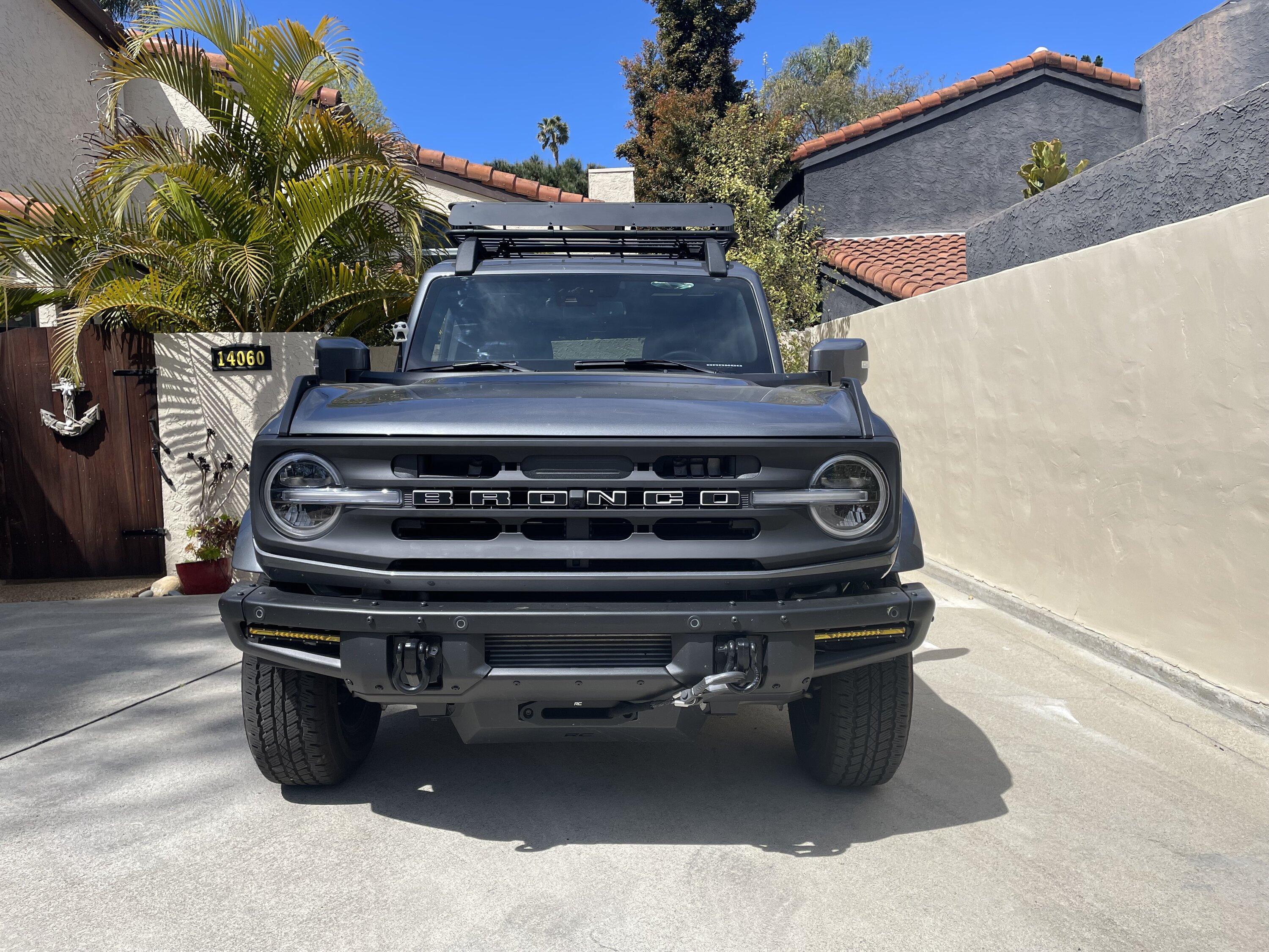

Here is a picture of the end result
Ford Bronco Plastic to MOD bumper install IMG_1697
as others are showing, your missing some pieces.

This was actually extremely helpful. Thanks for taking the time out of your day to help me.
