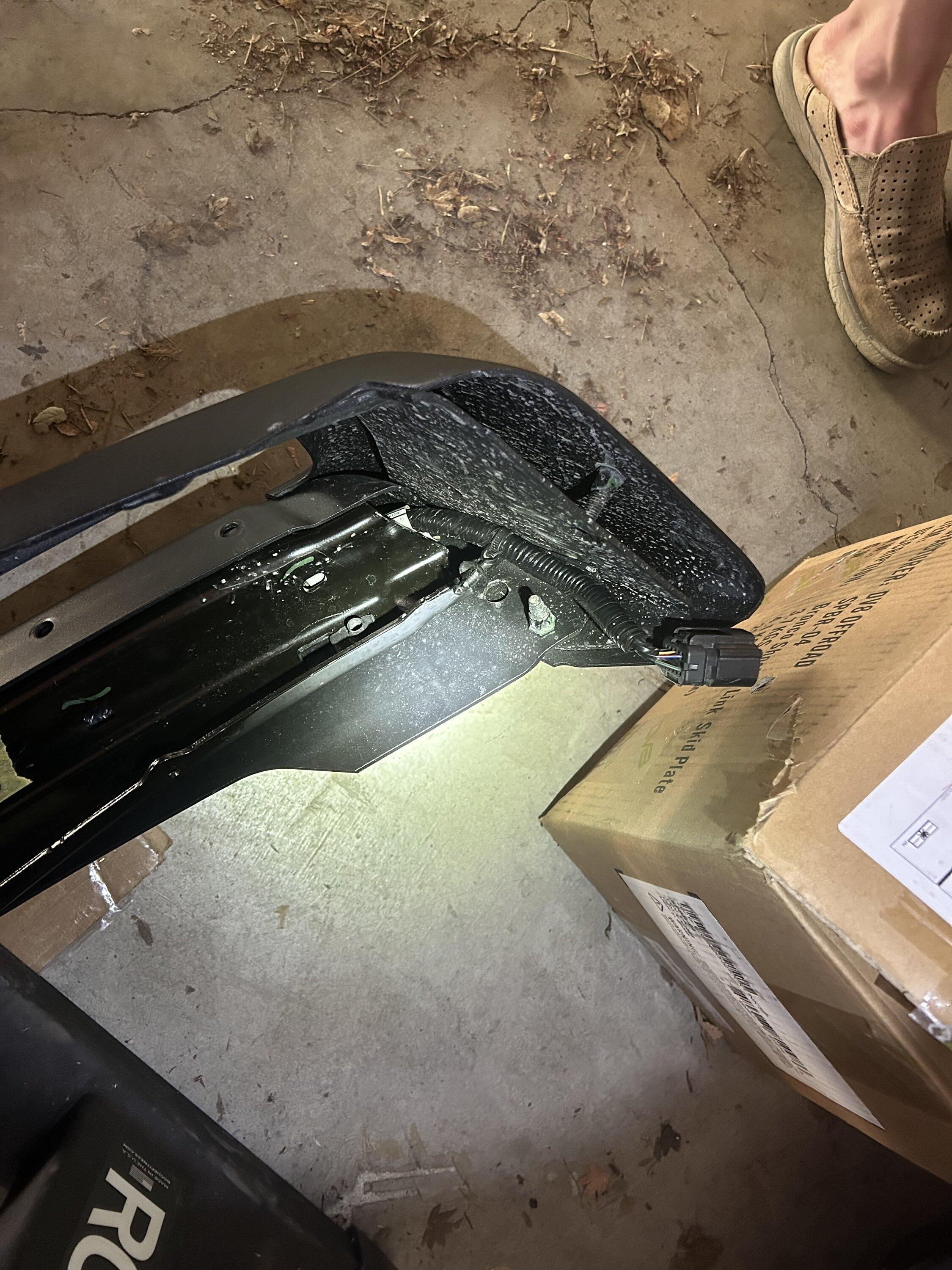

How did you get the harness for the parking sensors plugged back in? For the life of me, I can't get the sensor/fog light harness to plug back into the connector behind the fender/grill.
Same - I ran the harness out of the opening between the support and bumper frame on the far driver side but don't have enough length to reattach the plug. Any advice?

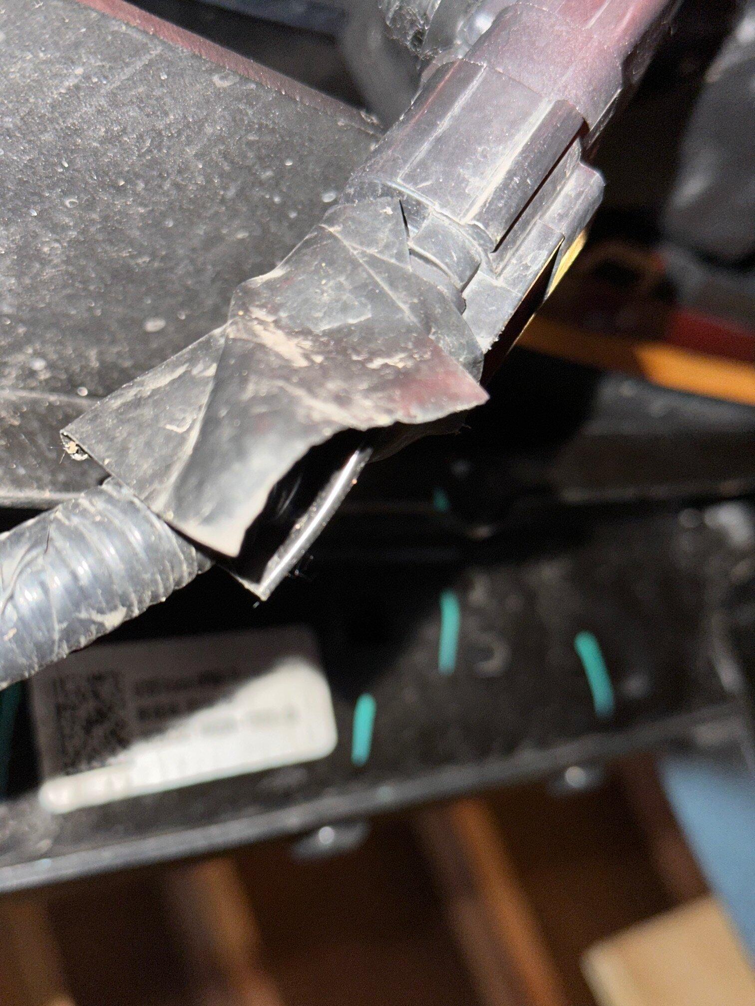

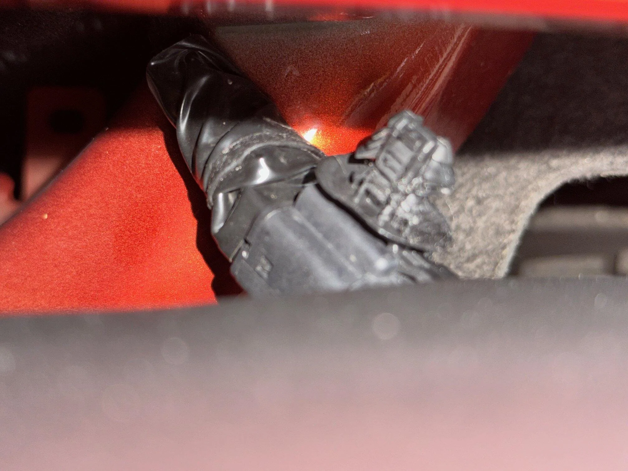

ok, where the harness in the bumper connects back to the plug just underneath the driver's side headlight, that plug underneath the headlight is held there by a plastic anchor. Pop that plug out of the anchor point and that gives you just enough length to get the harness connected. The plug is anchored in there pretty good and I had to give it quite a pull even after working on it with a trim removal tool, but after that came free everything connected up and worked fine.
I'll put in a couple of photos. 1 of the connector's anchor after I removed it and the other of the connector from underneath/behind the bumper. Hope those help.

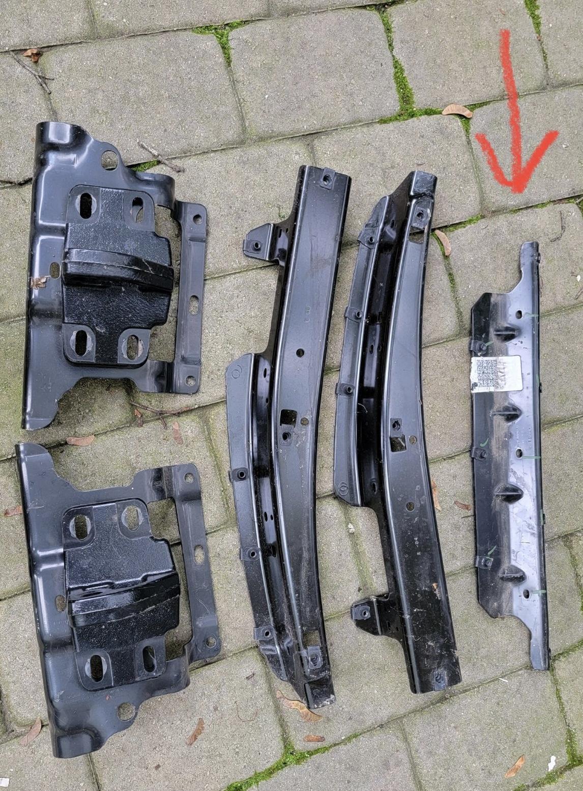

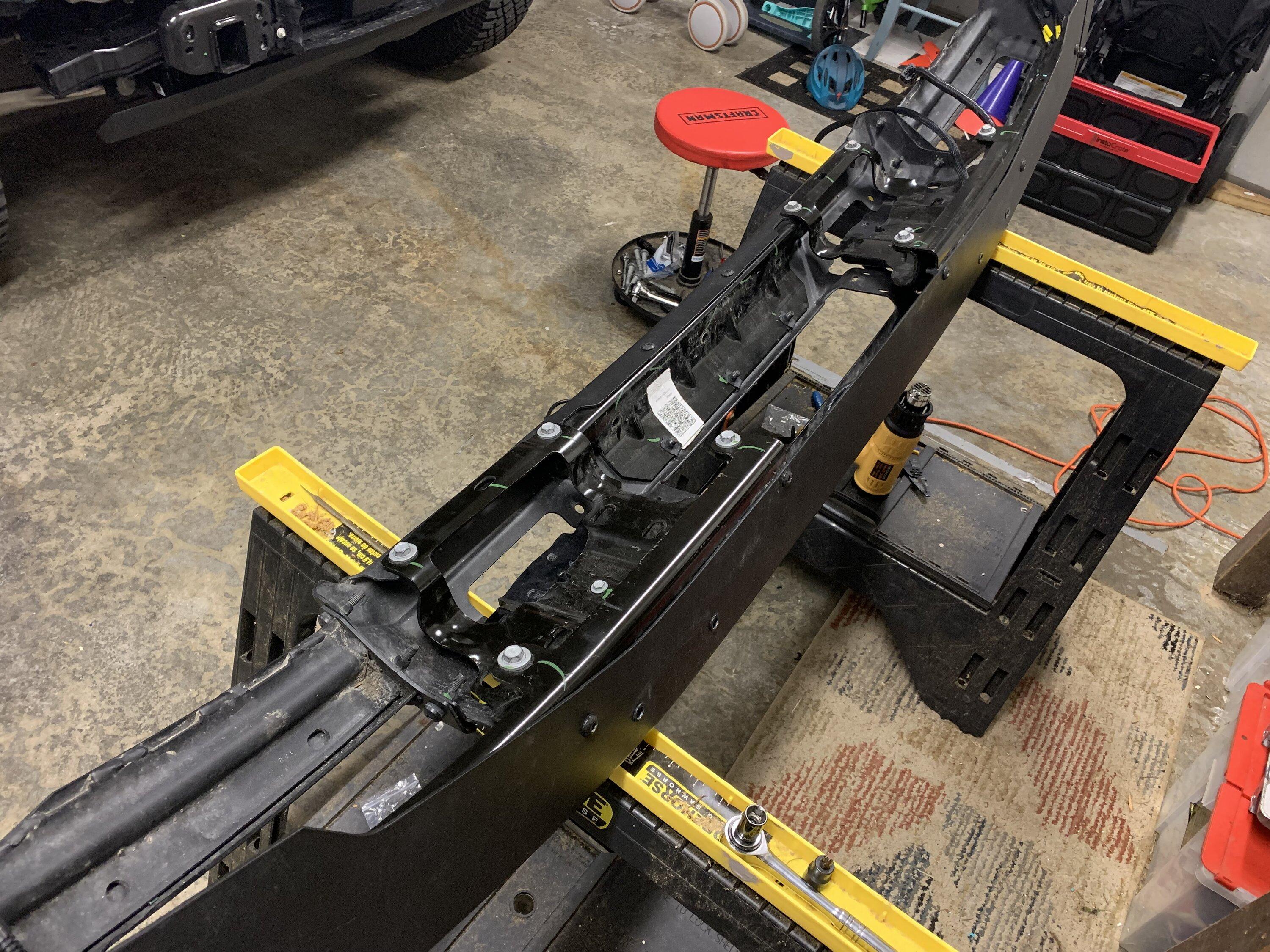

Besides the ford schematics are there good sources for images of the back of the MOD bumper? I have all of the parts loose but nothing seems to sit flush as I mock it up.
thanks

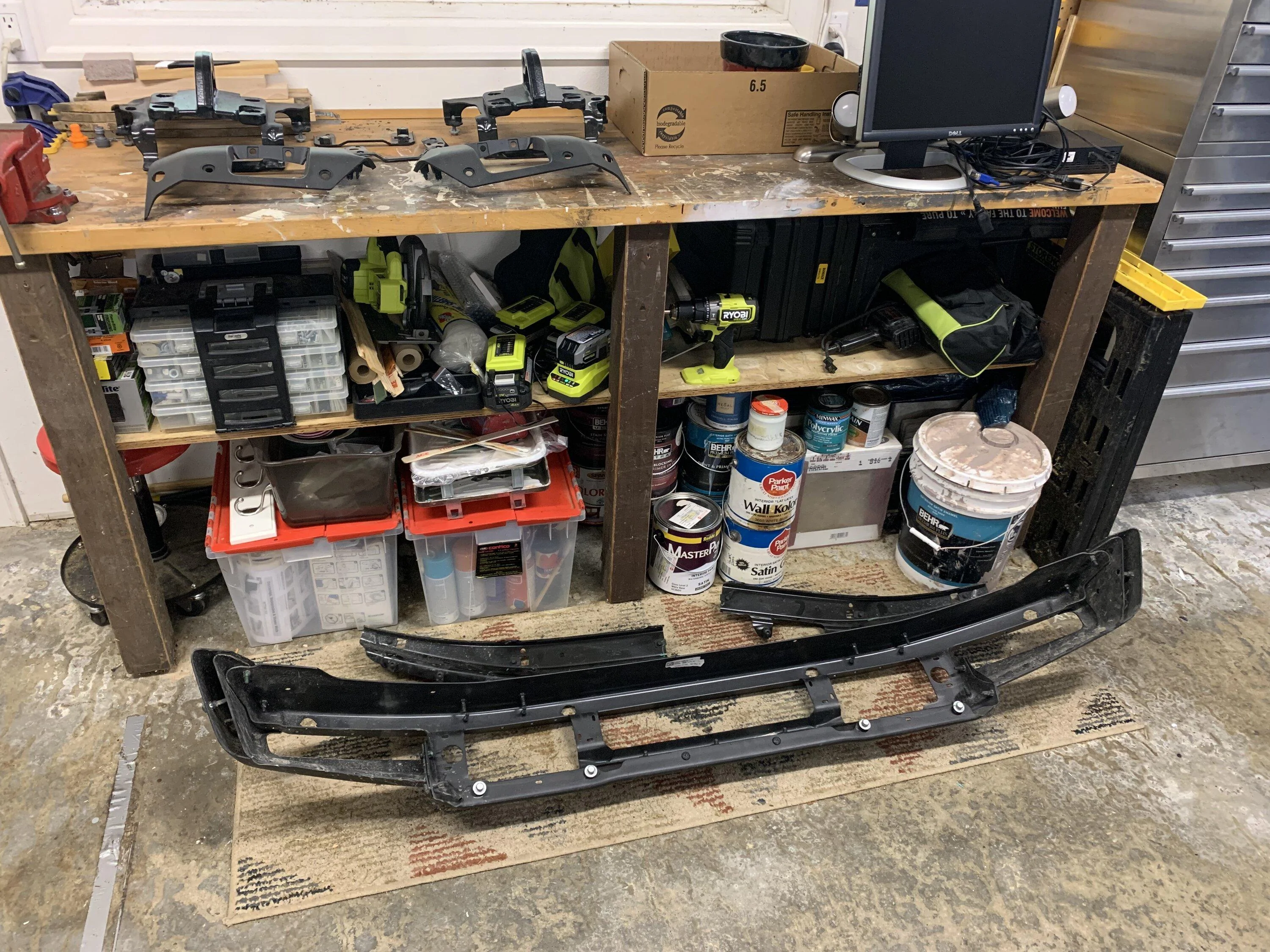

This is the closest I've got. If you'd have asked me yesterday, I could've gotten some more detailed pictures. Some of the parts are up on the work bench.

Thanks! The arrow in my pic shows which one I can’t figure out at the moment

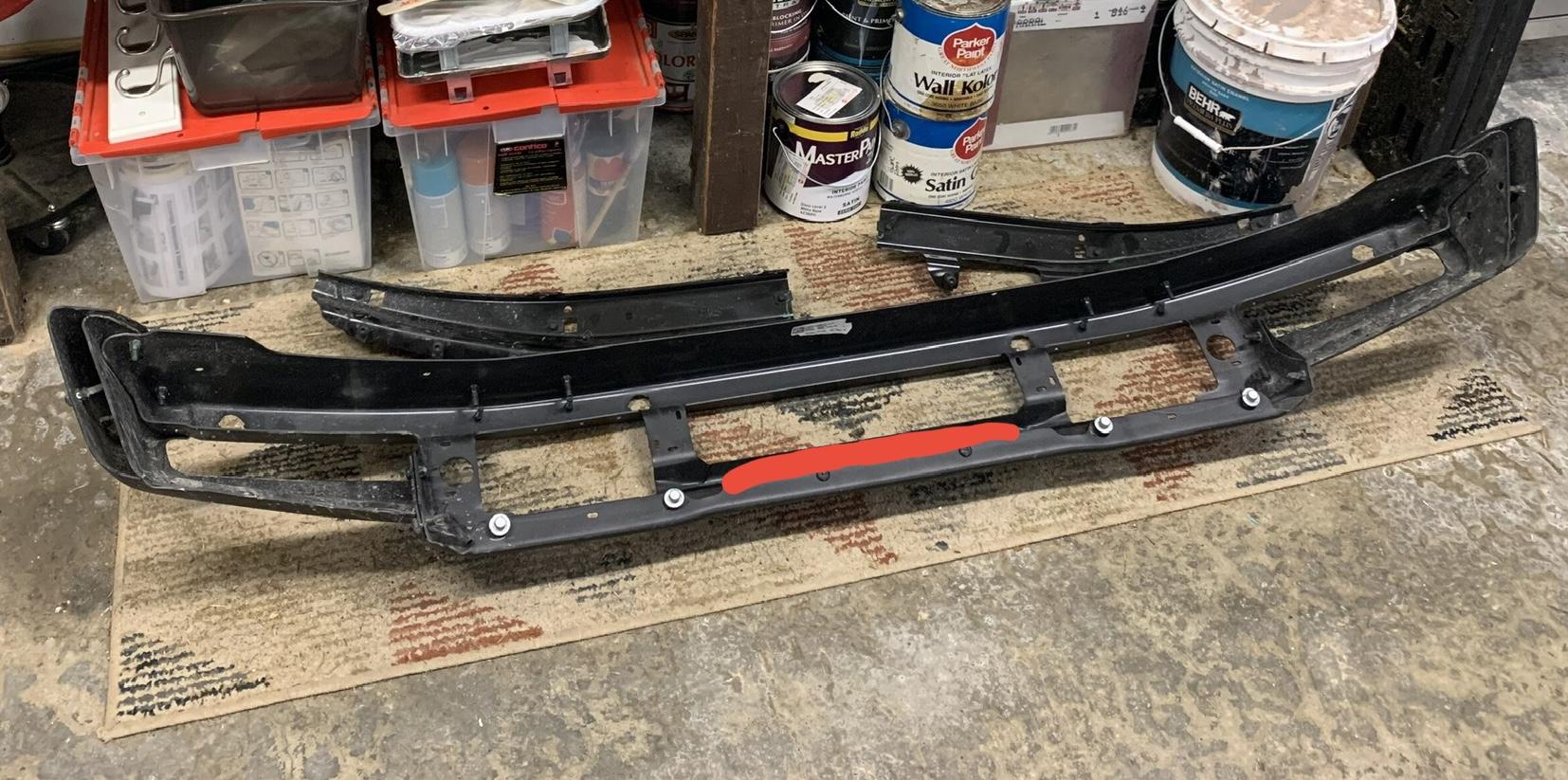

Ford Bronco Plastic To Modular Bumper What It Takes To Install. 123_1
That bolts into the lower middle area behind the mod bumper. See the red line in the photo below. Out of all the pieces in that photo, that should be bolted on first.

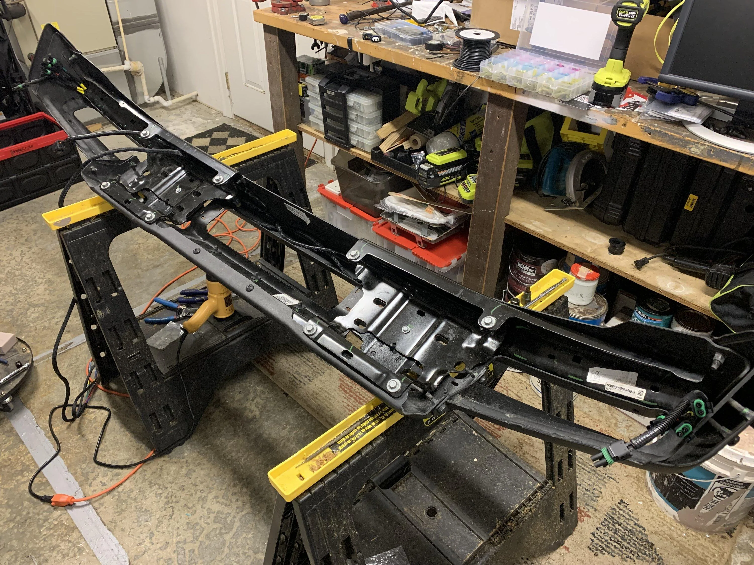

Ended up disassembling my bumper again to do fog light wiring, snapped a few photos of the backside. Hopefully this answers your questions.
Ford Bronco Plastic To Modular Bumper What It Takes To Install. IMG_8517
Ford Bronco Plastic To Modular Bumper What It Takes To Install. IMG_8518

Thanks! Really appreciate it! That will be very helpful as I assemble the bumper!
