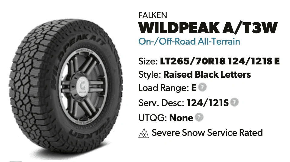

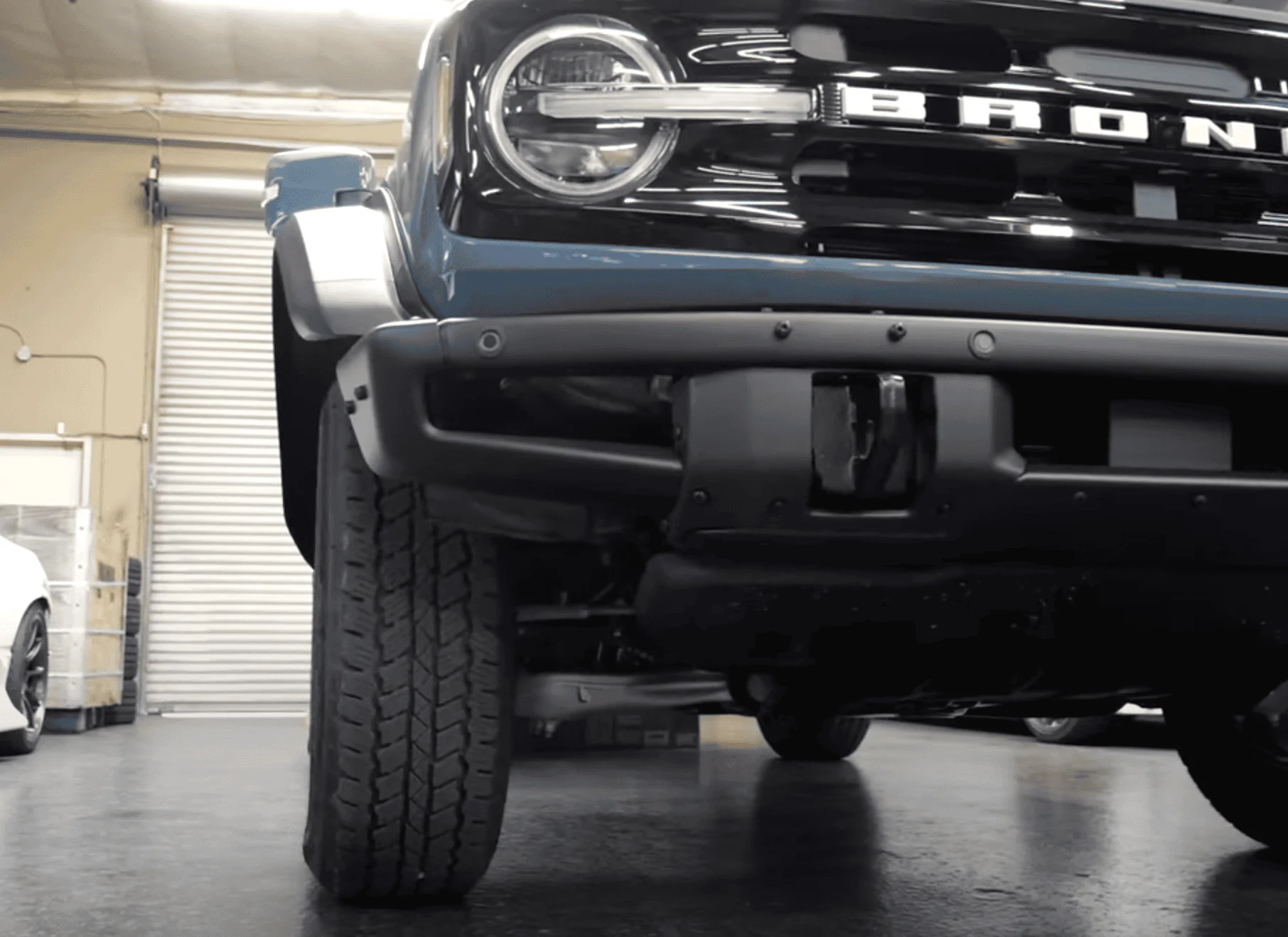

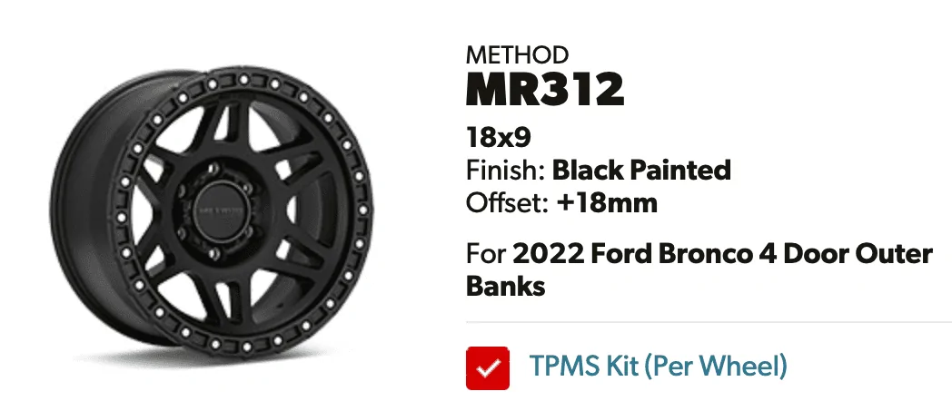

Anyway, here is my question. I am looking to get the Method 312s with some more aggressive tires. I have had a hard time finding definitive information on the Appearance Package. I know that it is a dealer installed option, and I have already asked my guy at the dealership to only install the Hood Scoop and the Fender Flares, I will decide if I like the door mouldings enough to install later on (just not sure). I found a video showing the installation of the Appearance Package fender flares, so that example picture is with the stock tire set up. The stock tire is a +55 offset. If I go with a +18 mm offset, and the same stock tire size, it would move the outer edge of the tire approx 1.46" and I would think would take up most of that space. Would the wheel well accommodate a 275/70R18 tire size without complications? I believe the tire would go from 32.1" to 33.2", so it seems there should be plenty of room.
I would love some feedback. M y Bronco is getting closer and I want to get the wheels and tires ordered!
