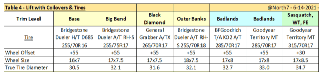

Hey folks,
trying to figure out the stock offset for the Sasquatch package wheel. Been reading mix reviews.. not sure if anyone can clarify what the offset is. Trying to keep the stock 35s tires but upgrade wheels!

offset is 30 on Squatch, 55 on everything else

Ford Bronco Sasquatch package wheel offset Screen Shot 2021-12-29 at 8.33.05 AM
This was posted elsewhere.
Sasquatch +30 offset on a 17x8.5 wheel.
