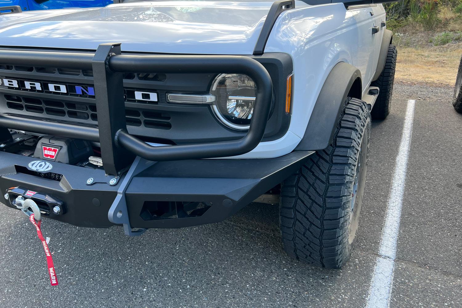

- they will be slightly beyond the flares. I will take a pic when my wife gets home with the wildtrak
- alignment specs do not change with poke.

1) yes, they will poke 30mm out
2) I donā€™t think so, but if you make a poor offset choice combined with changing tire size you may rub

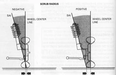

The tires on a Sasquatch are tucked in under the flare a little, so you won't see a full 30mm of poke.
Alignment specs do not change, but you will see an increase in scrub radius, basically more tire leverage between the tire centerline and the point at which the ball joint axis hits the ground.
Ford Bronco Sasquatch aftermarket wheel offset Scrub-Radius-1
Edit** Just noticed that drawing shows a McPherson strut suspension, not a double a-arm suspension like our Broncos have, but it should give the right idea.

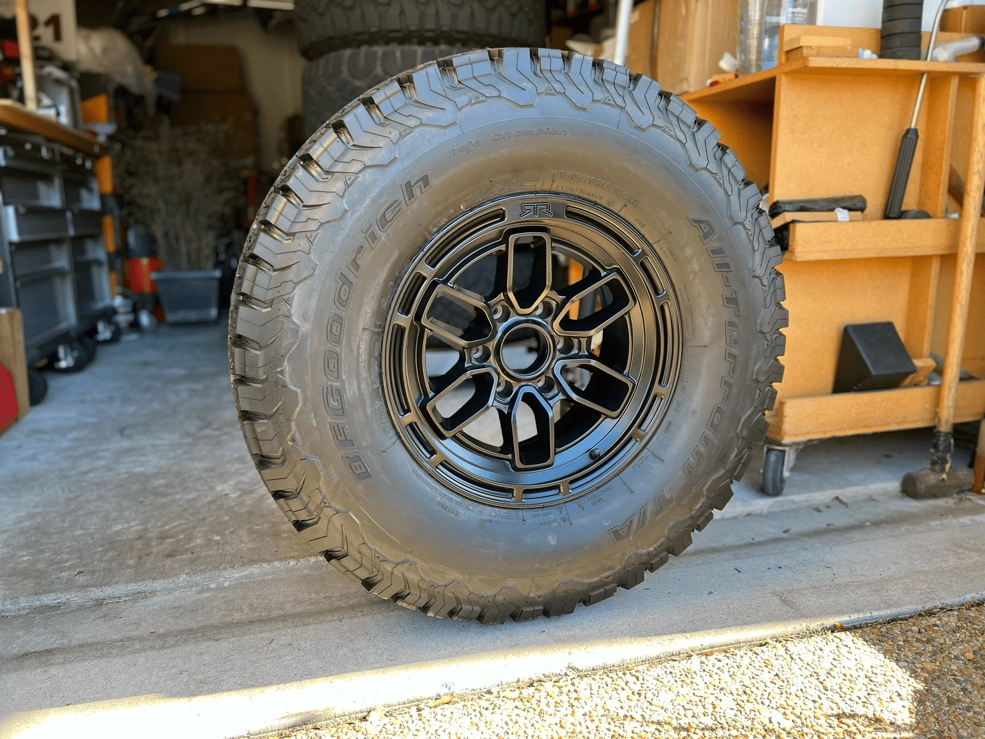

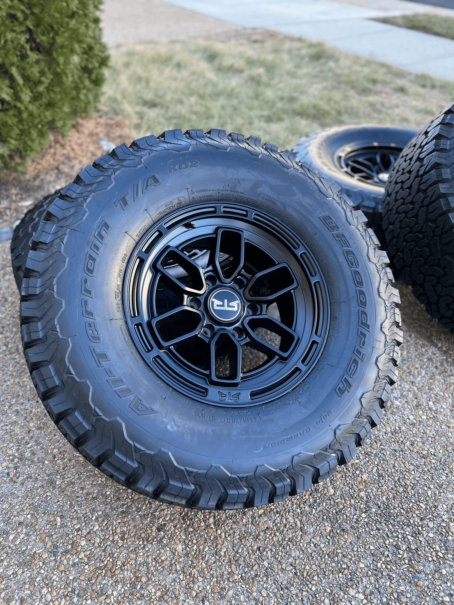

OEM SAS wheels are 35 pounds and that is just extremely heavy.
The wheels below are 24 pounds on my scale

nice! what wheels are those?
