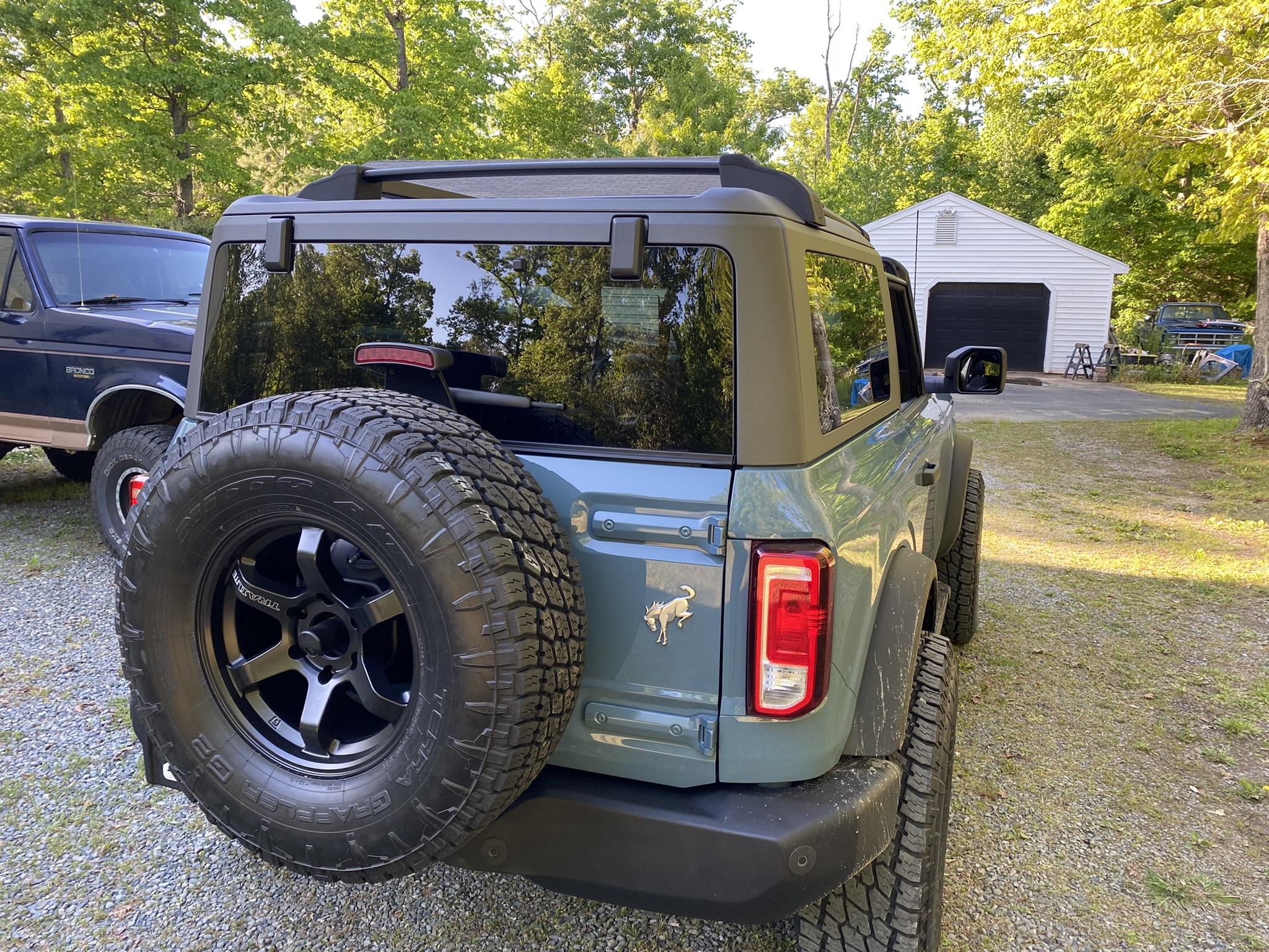

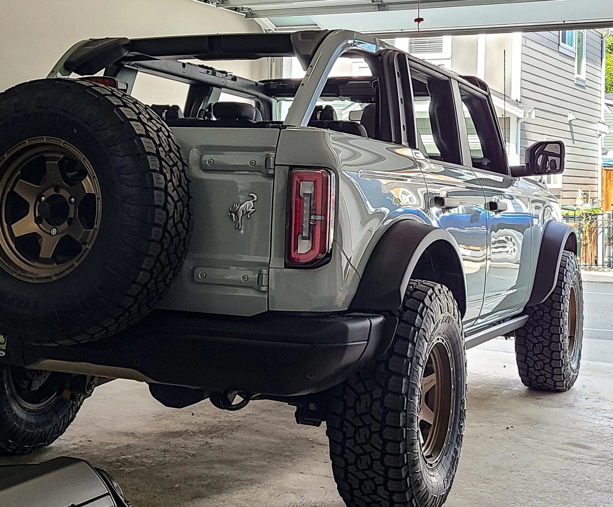

Non-Squatch BL with 00 offset Warn Jackhammers, 37x12.5's Coopers, Dirt Logic coilovers AND Squatch flares. Shows a bit of shoulder which is the perfect amount of poke for my tastes.
Ford Bronco Is Zero Offset Proper fitment for Sasquatch? 1652797071286
Ford Bronco Is Zero Offset Proper fitment for Sasquatch? 1652797133837

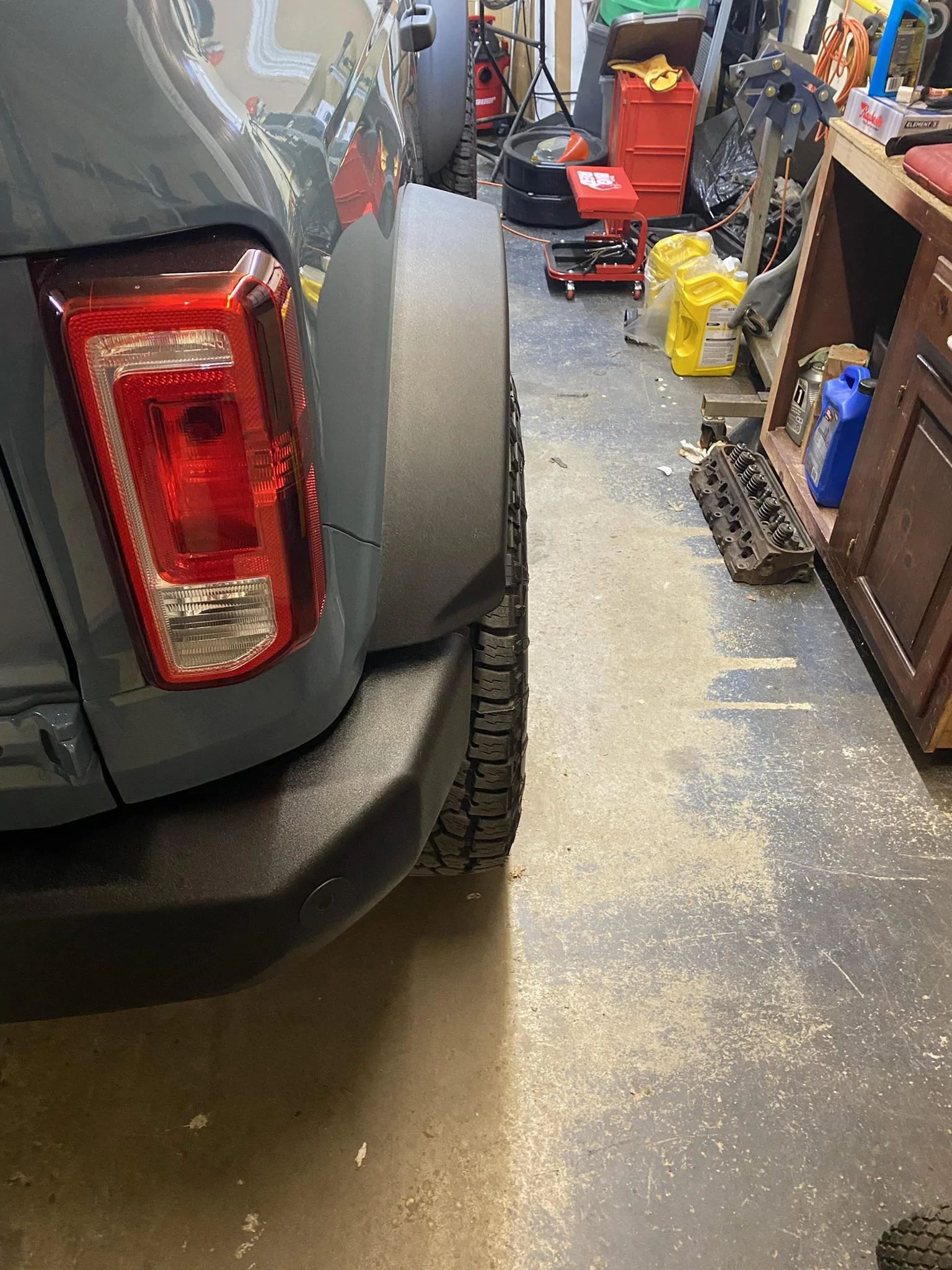

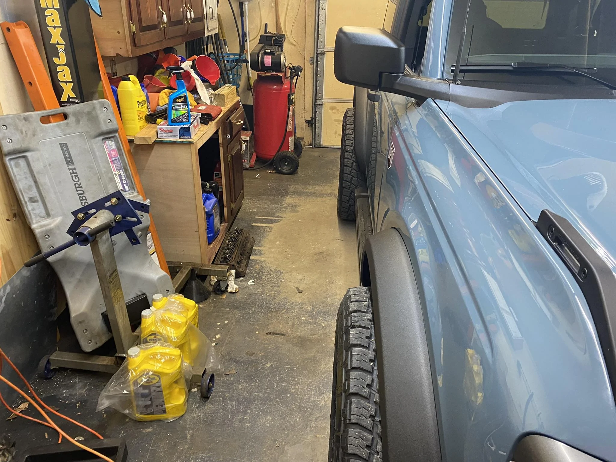

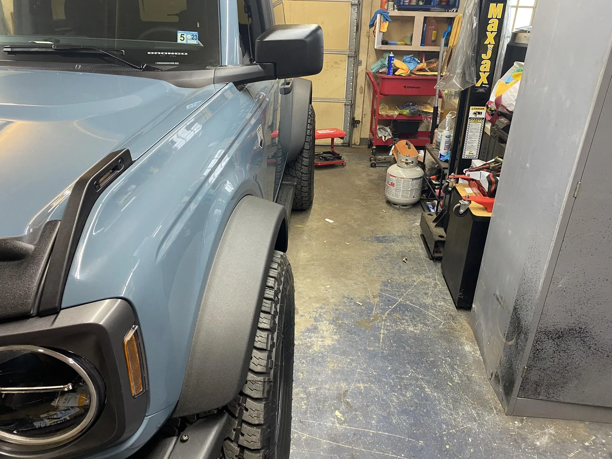

ZERO lift / spacer - '22 BB 2dr. 315/70/17 Nitto Terra Grappler G2s with 17x8.5 0 offset wheels. Remove crash bars.
No rubbing / scrubbing even under flex.
With BASE OEM flares
Ford Bronco Is Zero Offset Proper fitment for Sasquatch? IMG_4093
Ford Bronco Is Zero Offset Proper fitment for Sasquatch? IMG_4075
With OEM SAS Flares installed
Ford Bronco Is Zero Offset Proper fitment for Sasquatch? IMG_4094
Ford Bronco Is Zero Offset Proper fitment for Sasquatch? IMG_4092
