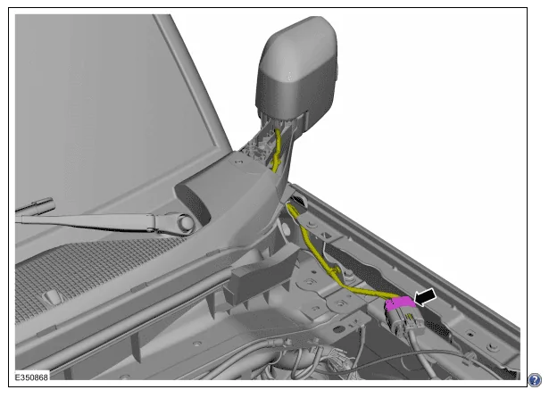

Here's where the wire for the spot mirrors route:

Thanks Bonnie! So looks like that wiring assembly, plus replacement mirror assembly, plus forscan (?) might get us there.

Maybe. It appears to me that the wiring is the same to that connection point under the hood, regardless of mirror style. I’m not familiar enough with the computer / Forscan to know if it’d be possible to rig the system with a new mirror assembly.

In my Big Bend ( no mirror lights) there are no wires for the mirror lights in the harness leading to the mirror connector. The camera circuits are also missing. I haven't dug back to the next connector upstream to see if it has the right wires, as it is much more difficult to access.
