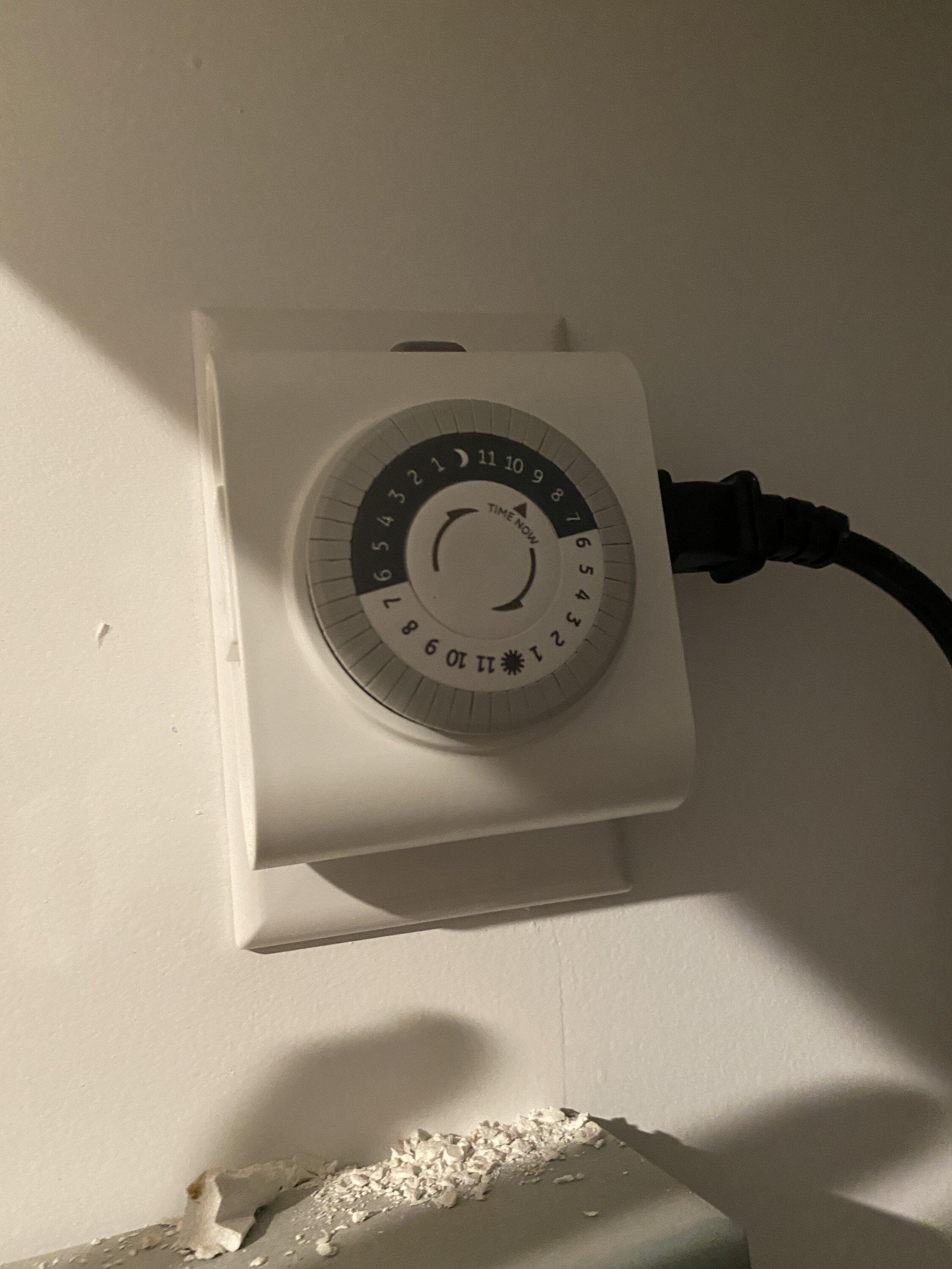

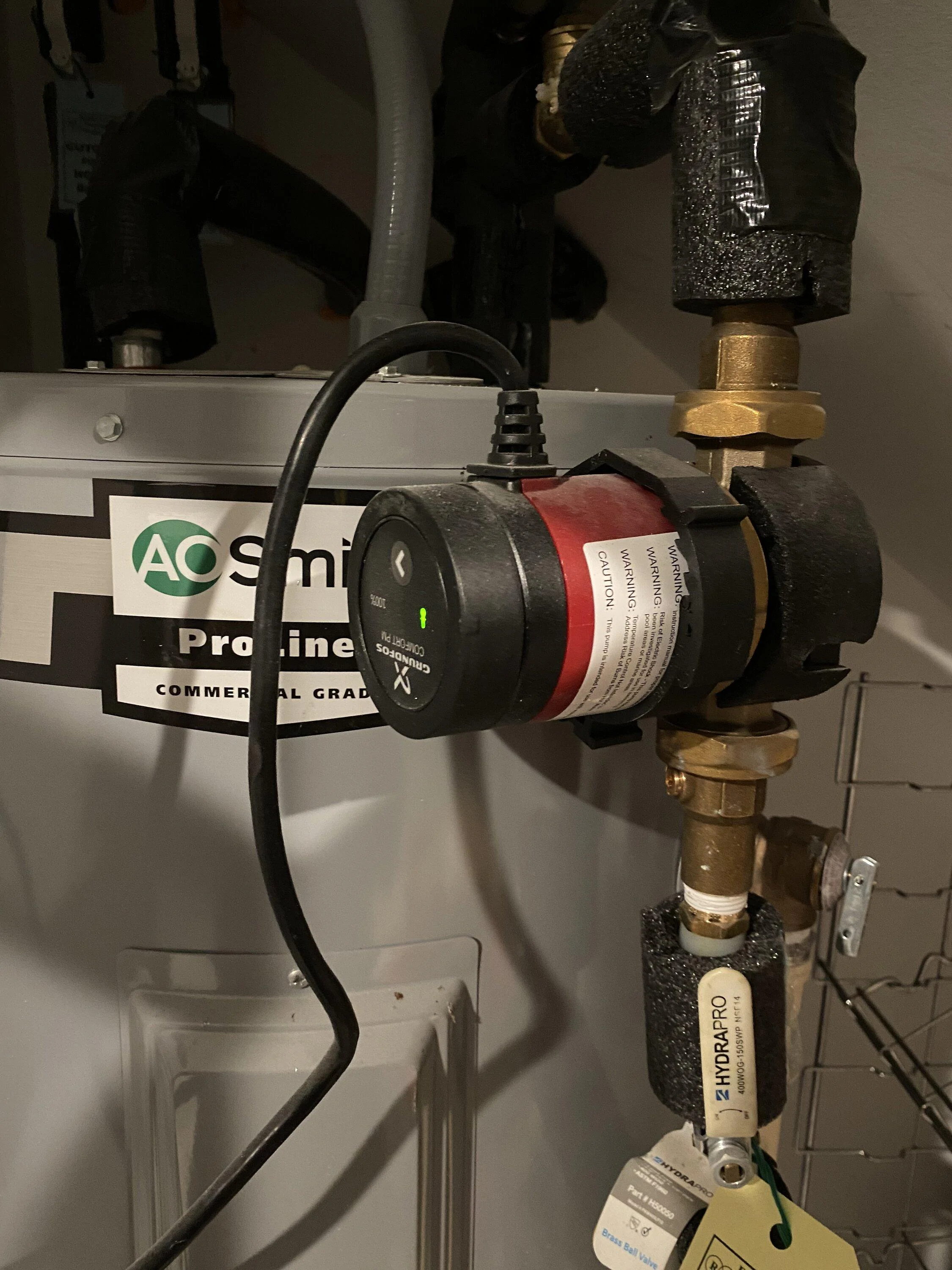

I just moved into a newer home, only a couple of years old. After the move it was pretty late and I decided to take a shower around 11 pm. The water was only luke warm. We had run several loads of laundry prior to my shower so my first thought was all the hot water got used up. My sister wanted to also take a shower so o told her to wait a little while after I got done with mine. This morning she told me she waited until 2:30am to take a shower and the water was still luke warm. Any this morning I decided to take a look at the water heater and noticed some kind of timer plugged in to the wall outlet, then a power cable going to the water heater. Is this whatā€™s causing me to not have hot water late at night? Could it be something else? I attached a couple of pics so you can see the timer and where it leads to. It is an electric water heater. Appreciate any help. Thanks.

That Grundfos unit is a recirculating pump that is supposed to keep hot water recirculating thru your pipes so you donā€™t have to wait for hot water to reach your shower, etc. Why itā€™s on a timer I donā€™t know. Doubt itā€™s the cause of lack of hot water but would first take it off the timer.
Suspect your electrode ma6 be shot - they are life limited parts and reasonably easy to replace (hard part being draining the tank first).
Does the outflow pipe on top of heater feel hot to touch?

As mentioned , the pump is a recirc for instant hot water at the tap.
They put it on a timer so save electricity, it should start running right before you wake up and start your morning routine.
Newer ones are "smart" they can learn your routine and operate themselves accordingly... but the timer idea is fine also, but it is not the cause of the cool water.

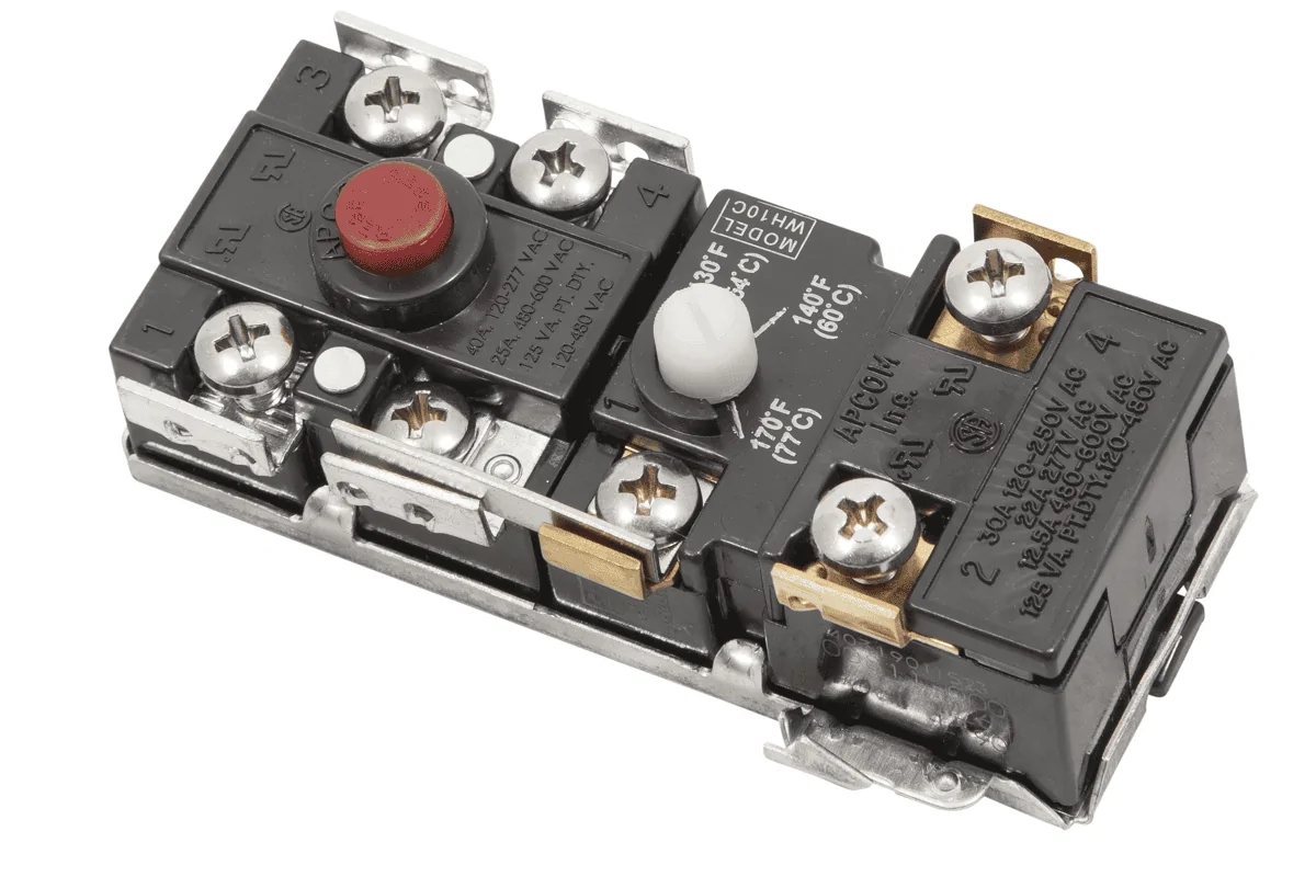

Here's an electric water heater thermostat, it will be behind a cover.
Note the white temp setting dial.

As mentioned, thermostat is not allowing it to heat up enough... or bad heating element, see posts above.
I see one of the covers in your pic, the T-stat may be behind one of those.
