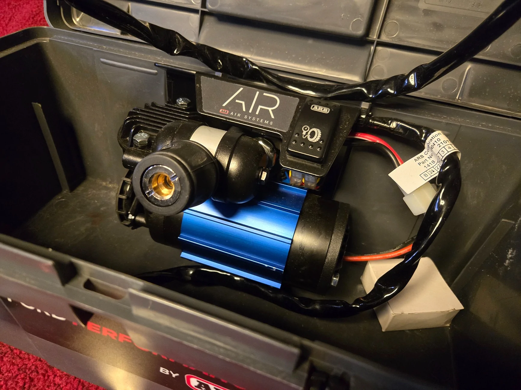

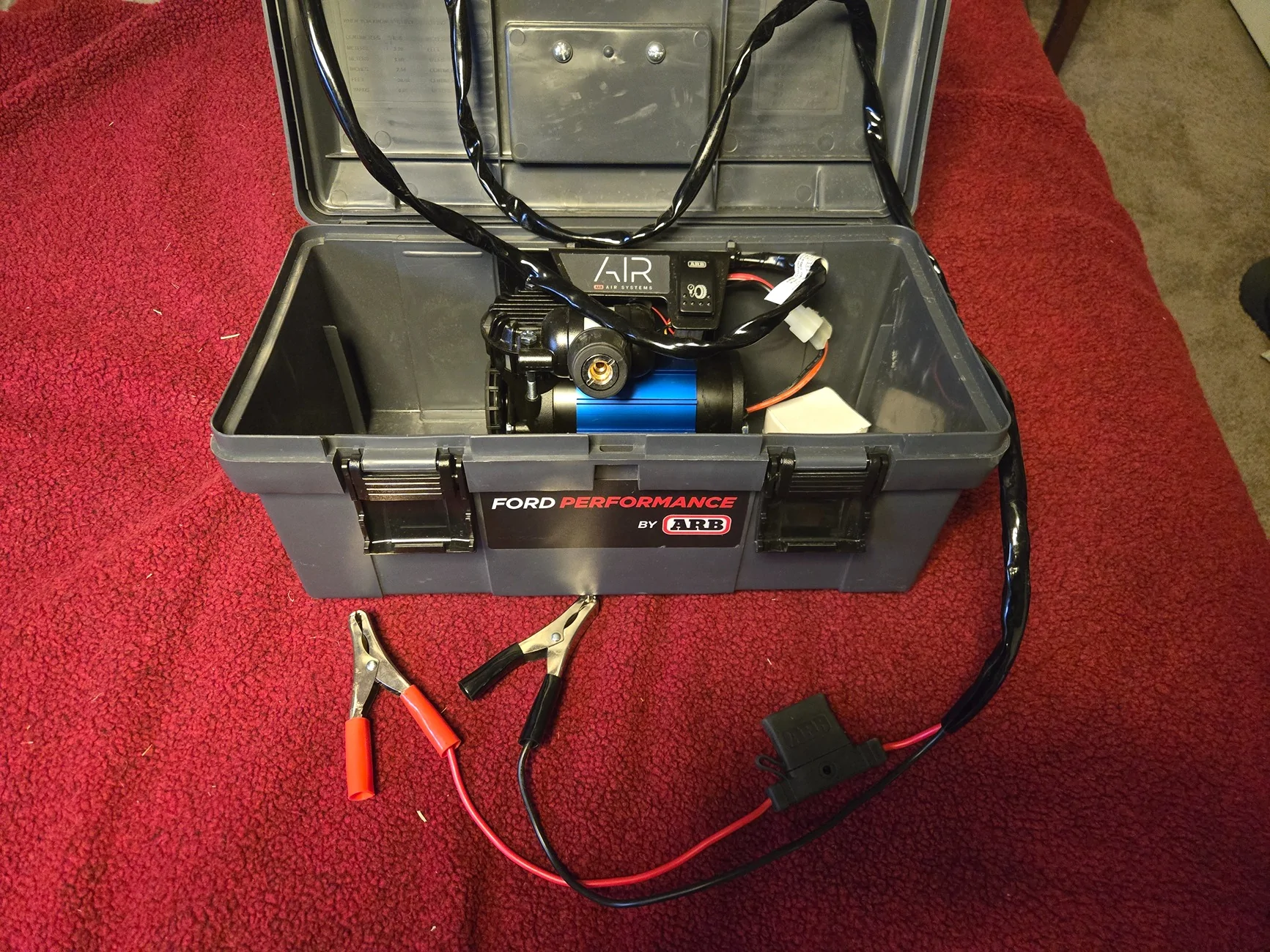

In preparations for the upcoming spring/summer, I'm looking to transfer my Ford Performance single ARB compressor "toolbox" kit to an underhood mount. Honestly, just looking at everything out there, is there any reason I can't just grab one of the mounts out there on the market, remove the compressor/bracket assembly from the toolbox and just use the existing wires from the attached harness (cut off the clamps and add connectors) and wire them to the battery/ground and call it a day? It just seems like all the wiring is already there, I just need to mount and wire it to the battery. Any thoughts would be greatly appreciated, along with any info if anyone else has done this conversion as well! Thanks!

Yup, should work. You have half of a twin, so bolt pattern on the mount plate would be the same. If any are missing, you can always drill them.

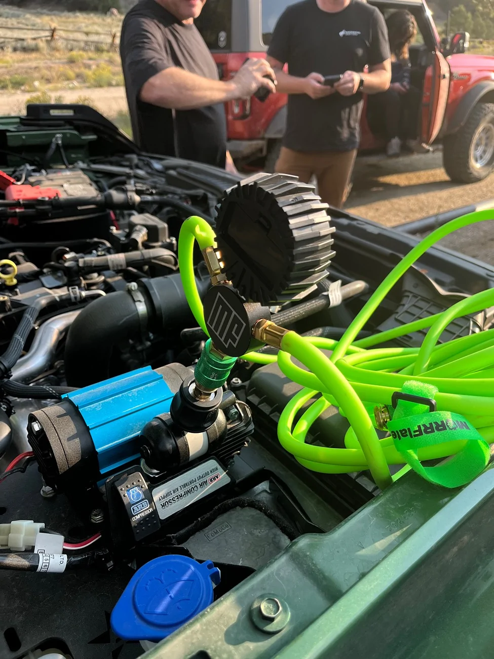

I did this. I already had the compressor. I only had to drill a few different holes in the mount (Barnes) ran the wires behind the cowling above the firewall. I chose to do a marine blade style battery disconnect vs wire to Aux switch or take the chance of direct to the battery and killing it with a parasitic draw. I was also worried the momentary load of the compressor would blow fuses on the Aux switches. I plan on running it until it doesn’t work or dies then I’ll upgrade-should be an easy if pricey swap. If interested I can take a few pictures tomorrow. I typically air down to 10-15psi on trails and the most time it took me to air backup was 30mins with a few breaks. I run the dual morrflate hoses vs. the quad to avoid taxing it too much.

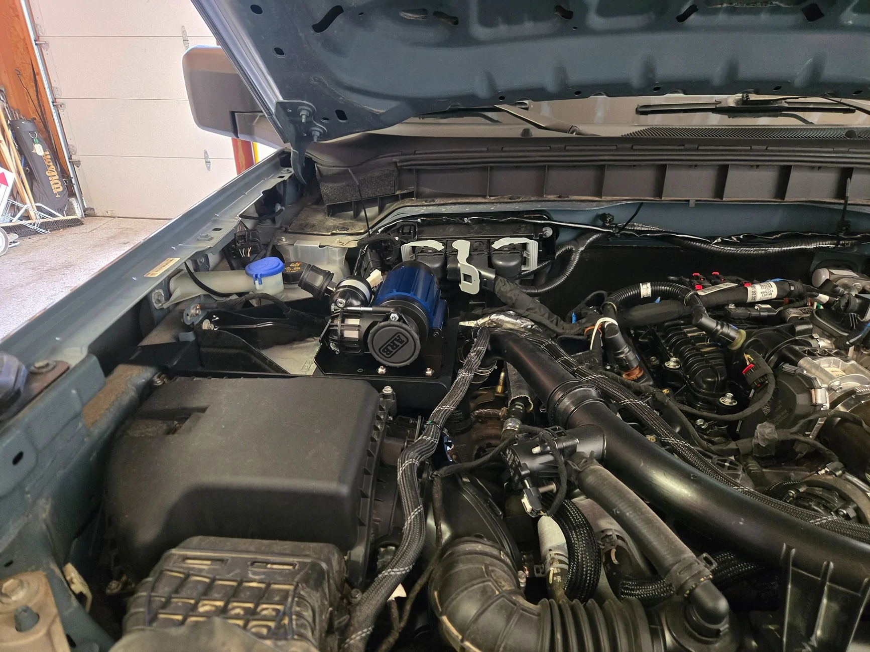

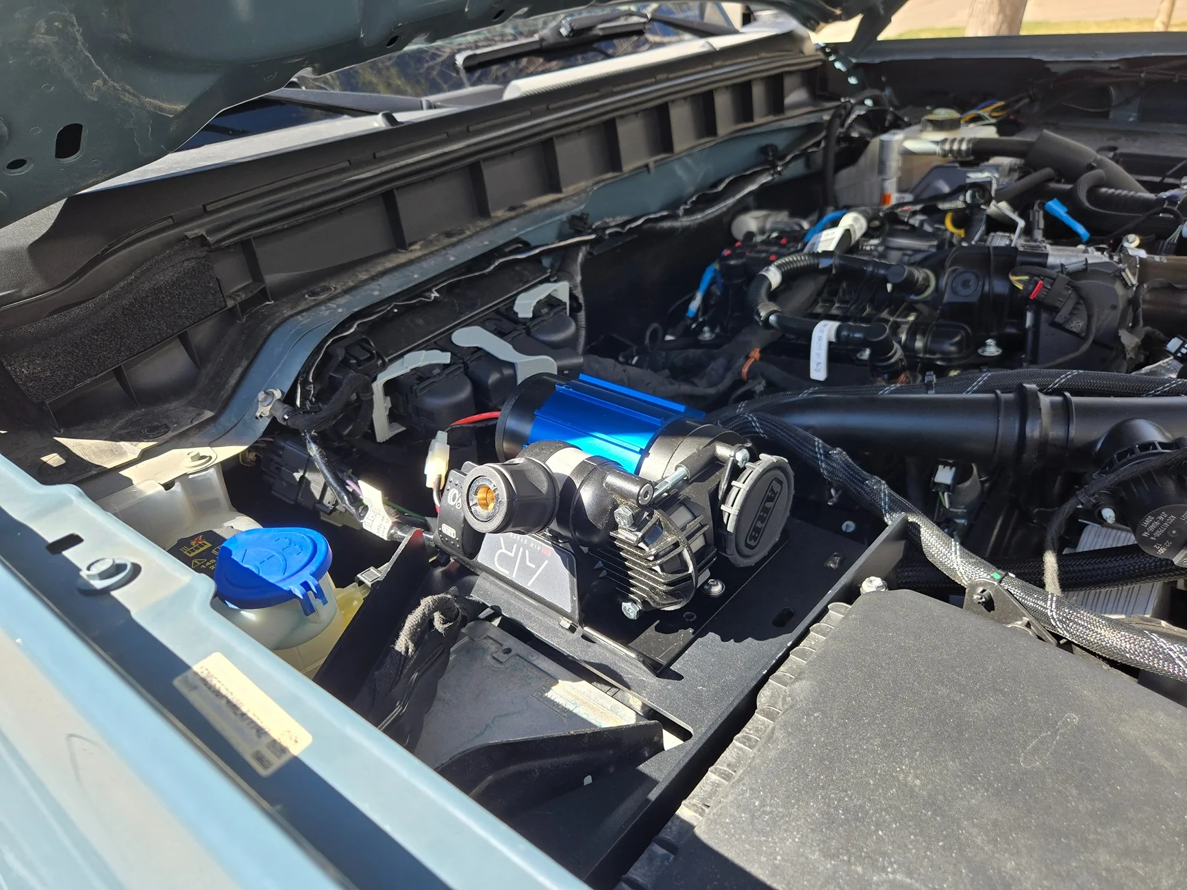

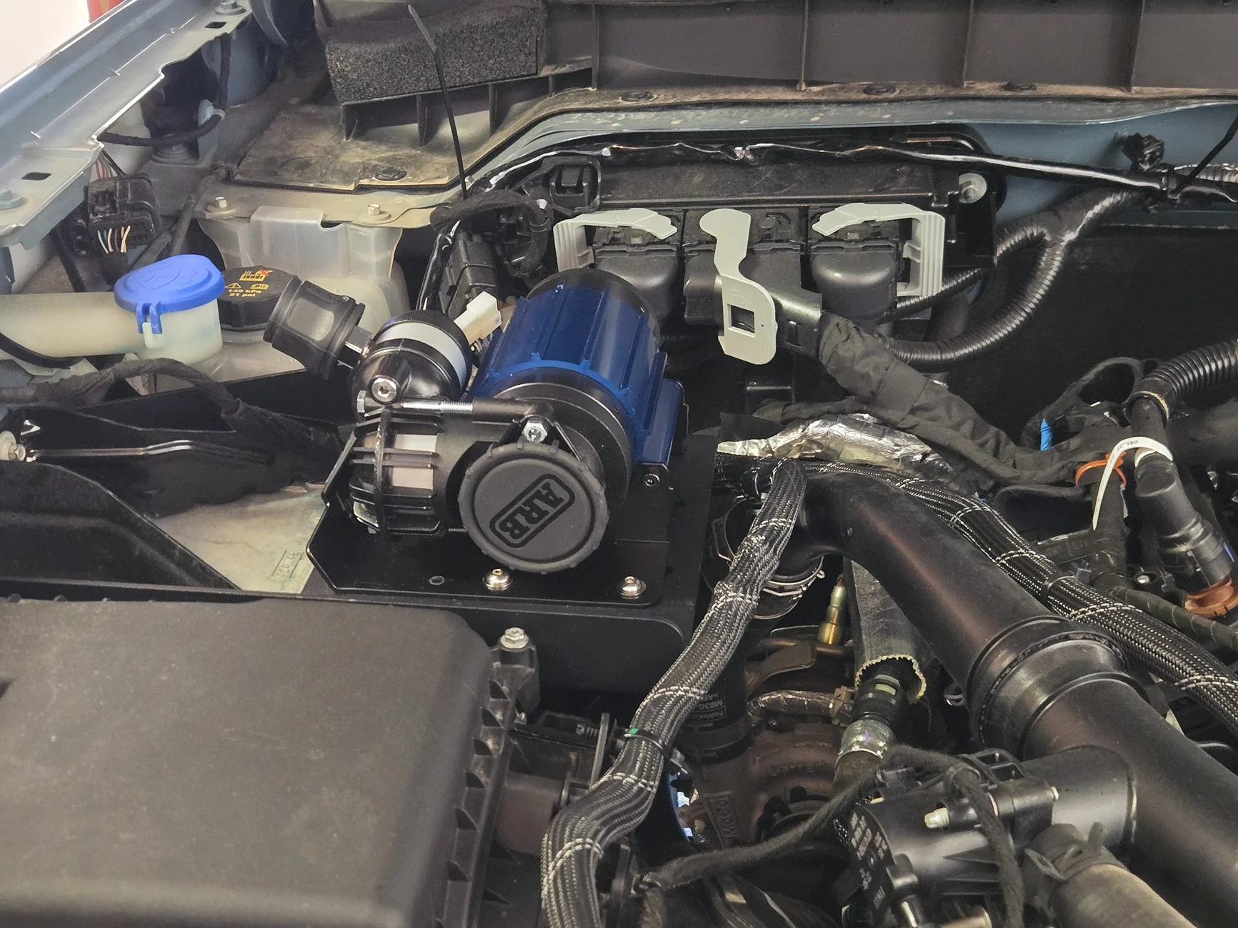

Thanks everyone for the information. Finished the install today with the only casualty being a couple wheel liner clips. Still need to watch the hood and adjust the angle of the output, but it looks good for now. Ready to roll for the summer!
