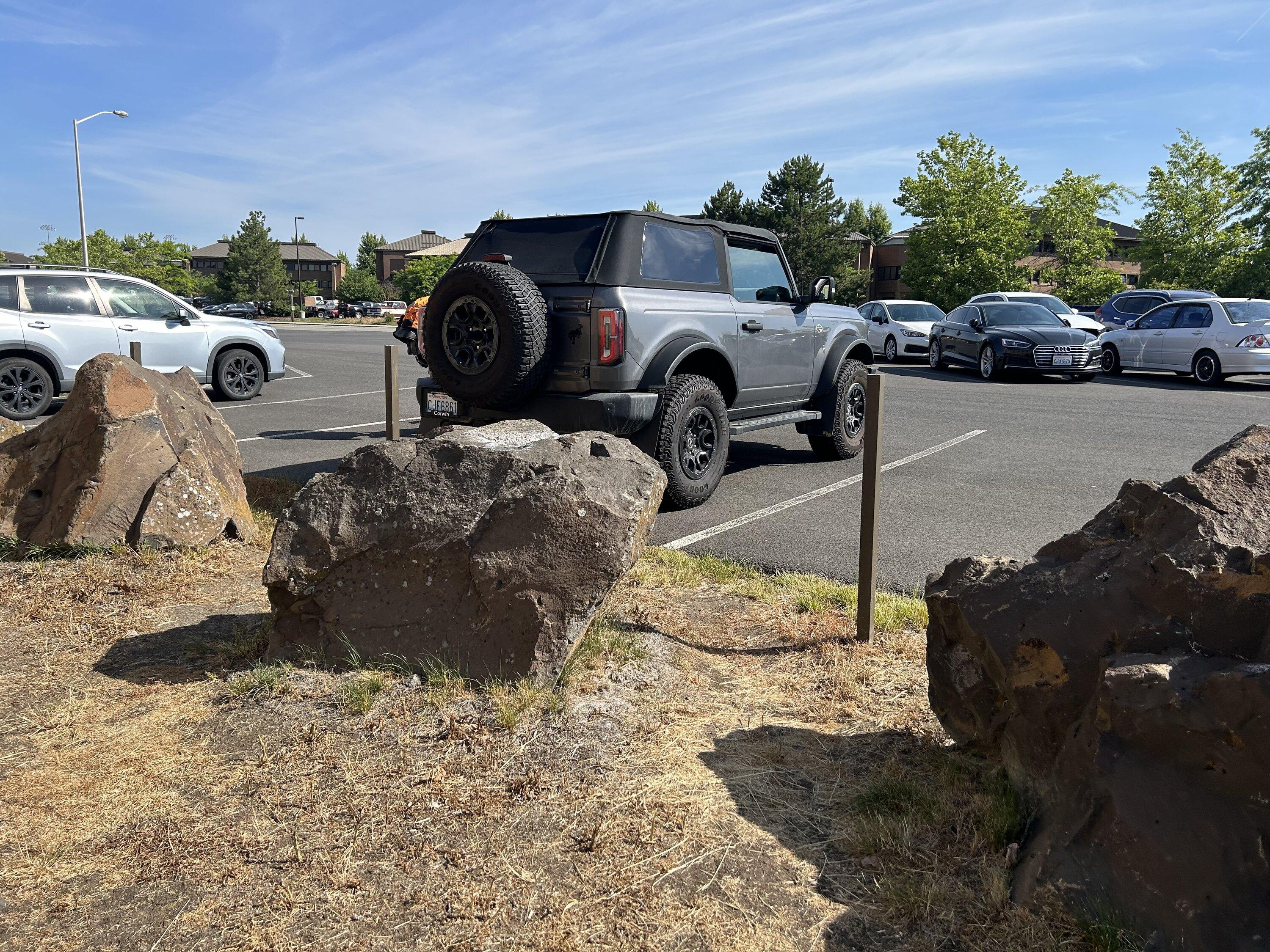

I just installed mine. I couldn’t find a video and the instructions were less than adequate. After having done it, the whole thing is actually quite simple. If you’re interested I might be able to make a tidbit video to bridge the gap left by the instructions.
I didn’t know until it arrived, but make sure you have a River Nut tool that can do M10. All the local options only carry m8 around me.
