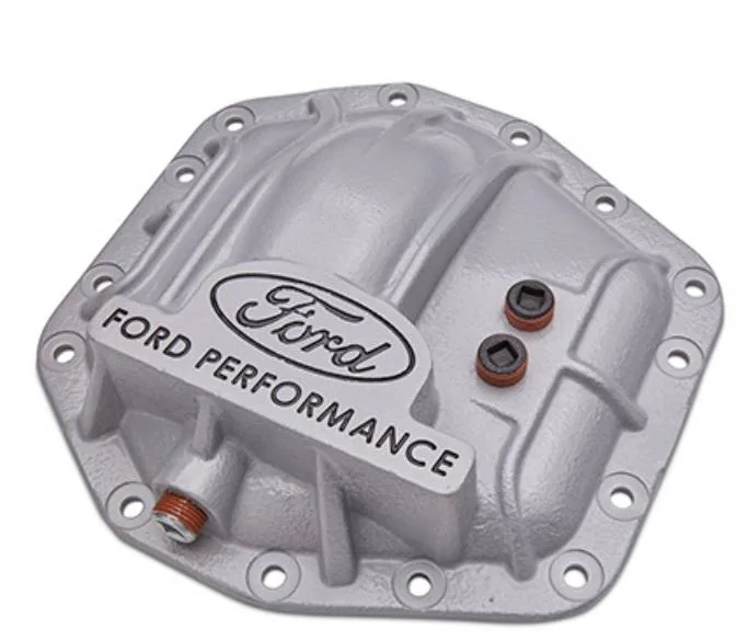

Just for looks?

Much beefier.
It's cast iron instead of the stock aluminum. Assuming the likely scenario that's it's nodular cast iron then:
  • The material itself is about double the strength. The part then could be even more than double if it's thicker.
  • It's coefficient of thermal expansion will match the axle itself, creating less stress on the gasket.
  • It's thermal conductivity is worse than aluminum, but that could be offset by its greater mass.
Best price I could find was $210 with free shipping from blueovalindustries.com .

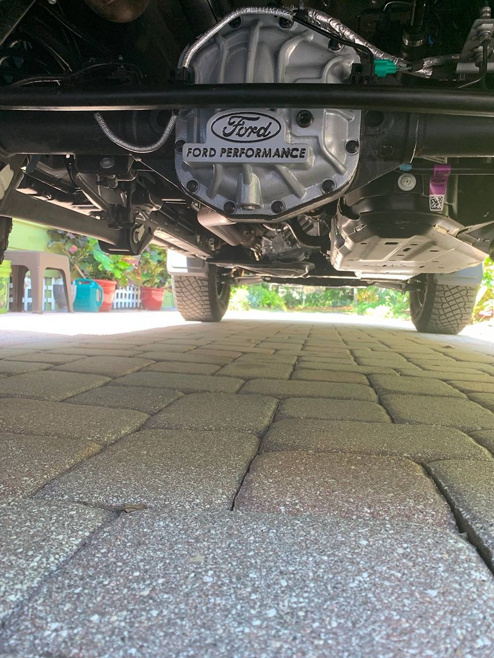

Added the Ford Performance Diff' cover last April.
Seem to be a heavy cast material (Aluminum) and powder coated.
Ford Bronco Raptor Ford Perf Diff Cover 2024.04.30 Ford Performance Diff Cover

Also, I bought mine completely with Ford Points.

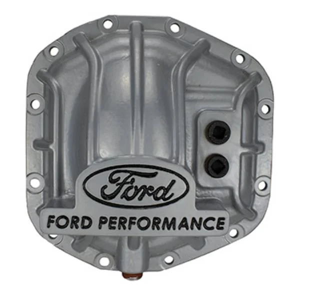

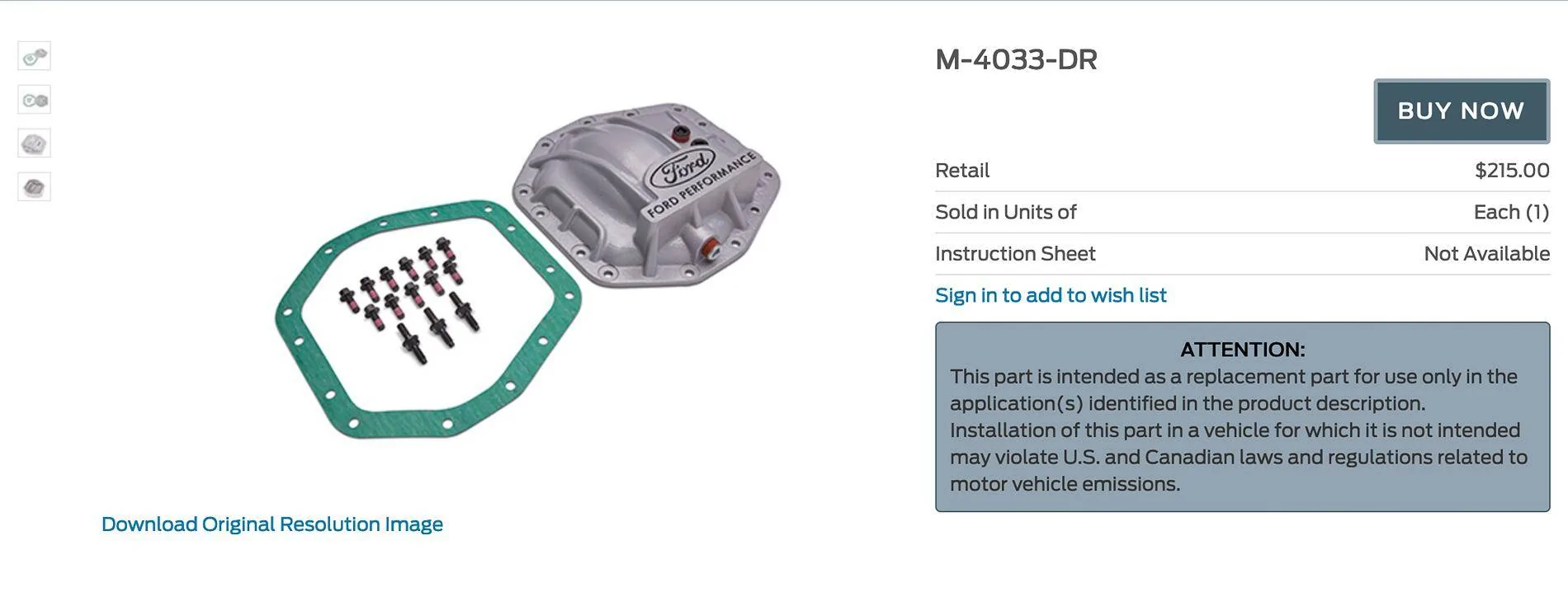

^^. That’s the Ford Performance cover.
The Bronco Raptor cover is similar and has an “R” on the right side.......
Yes, but it's Raptor specific.
The factory stock Raptor cover is aluminum with an R.
FP non-Raptor and FP Raptor are different as axles are different.
Raptor:
Ford Bronco Raptor Ford Perf Diff Cover Screenshot_20250101-140204
non-Raptor:
Ford Bronco Raptor Ford Perf Diff Cover Screenshot_20250101-140140

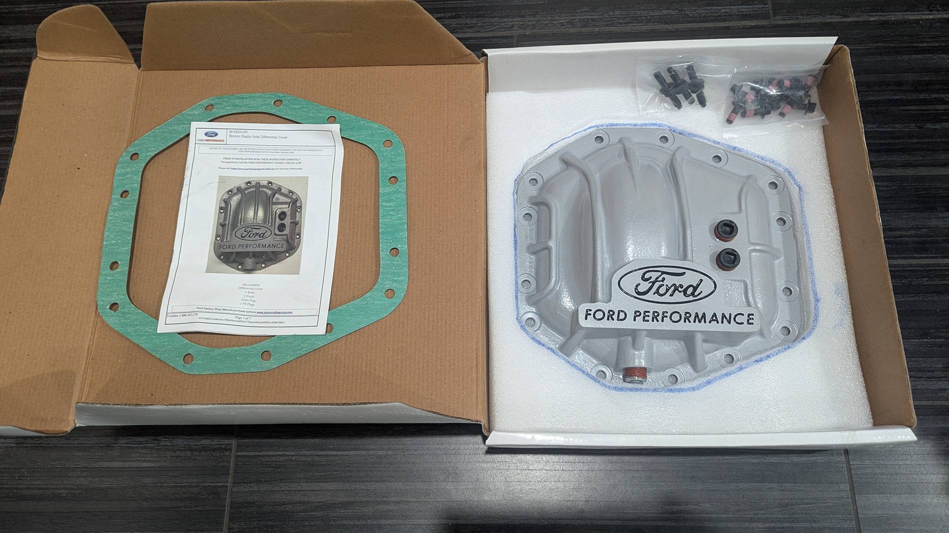

Ford Bronco Raptor Ford Perf Diff Cover PXL_20250110_222305414
She is a monster (thick/heavy).
