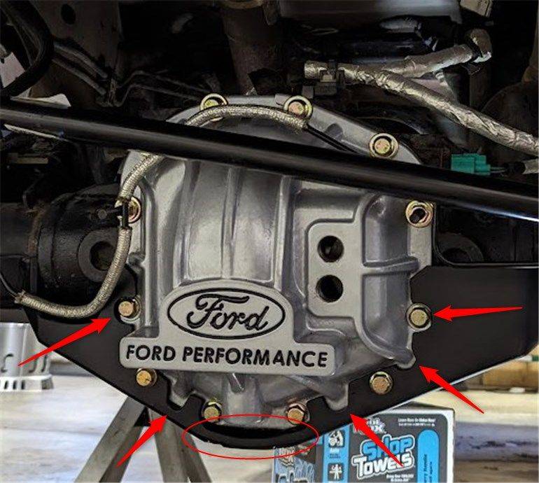

Unsure how your diff skid attaches... When you say "thicker" it sounds like your diff skid wraps around from underneath to attach to the diff cover bolts.... Mine does... It is non-raptor D44 but if this is what you are referring to then it is the same issue... I had to do a little custom cutting on my diff skid to get it to fit with the new cover.... Was not hard. Made a cardboard template to mate with the diff cover and then used the template to mark my cuts on the skid...

And this from another member on here...
Ford Bronco Raptor Ford Perf Diff Cover Modified Diff Cover what to cut
