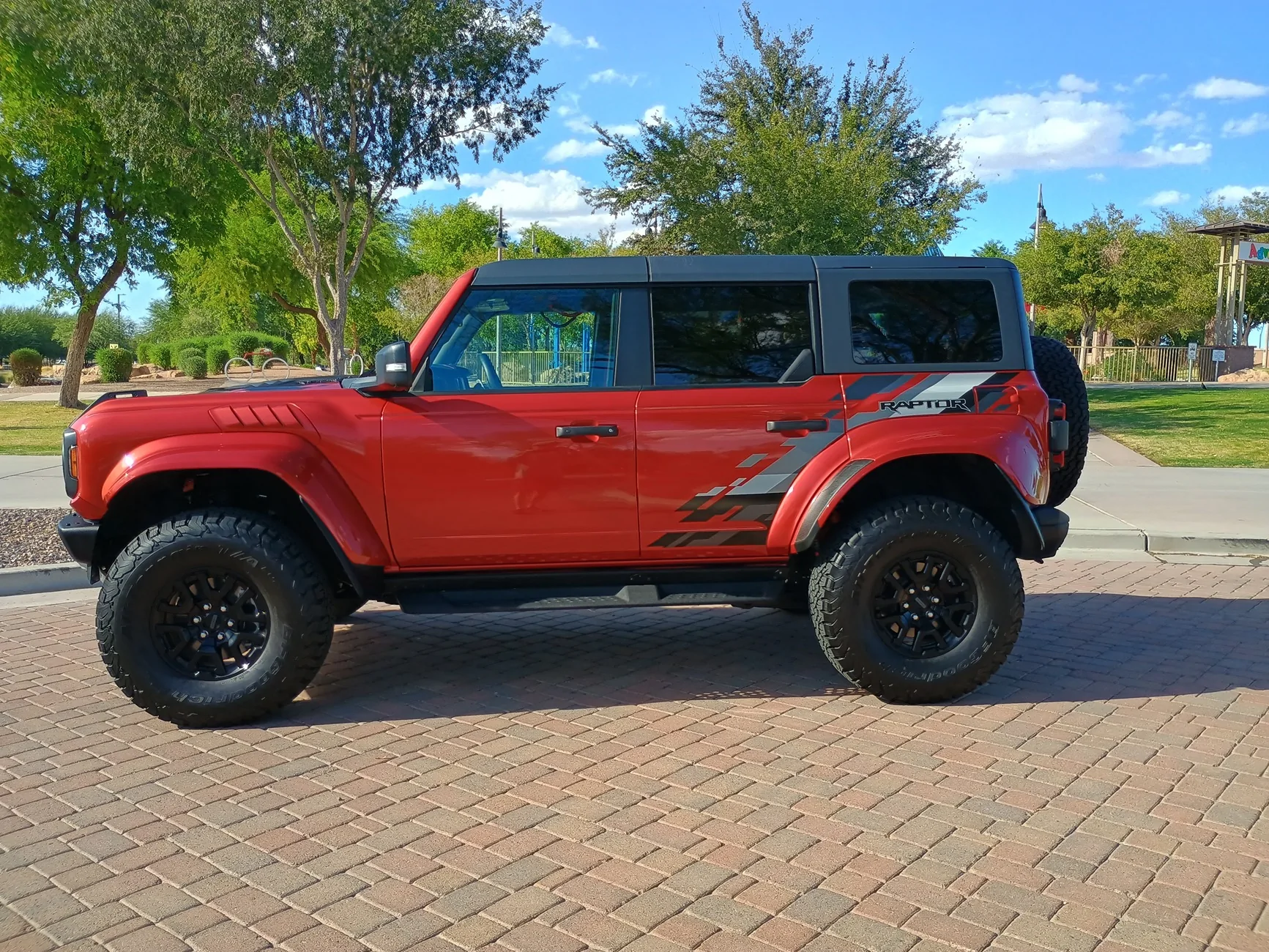

My 24 HPR came with wheels that do not have the trim rings:

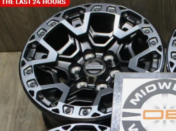

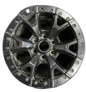

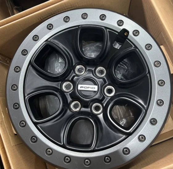

I have been contemplating an upgrade. Almost all of the wheels I like are Ford OEM:

Which brings me to a question, Are all Raptor wheels the same as far as fit to the Bronco? I'd expect they'd all have a 6x135 bolt pattern, 17x8.5 size, it the backspacing I'm curious about.

Well most seem to go to a 17x9 0 offset which is what I have but that profile will stick the tire out 1.5", but if you want to keep the same profile 17x8.5 the OEMs are decent but heavy. you can also run F150 raptor wheels. I have a set of Weld Racing wheels that are actually drilled for both bolt patterns and just use hub centric rings that are aluminum.

You probably already know but the trim rings are non functional bead lock things which can be easily upgraded/replaced with real bead lock rings if desired.
Factory Braptor wheel is 17x8.5, +34 mm offset, 6x135, 87.1 mm hub bore. Ford F-150 Raptor R wheels are identical.
F-150 Raptor wheels with factory 37" tires are identical EXCEPT they are +30 mm offset.
Thus all of these wheels are interchangeable.

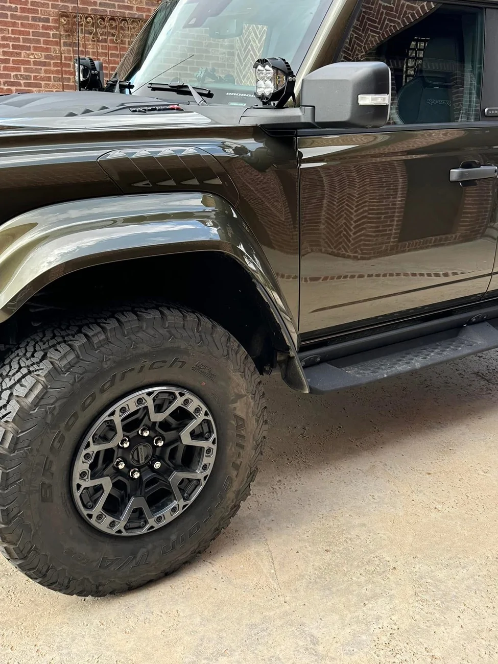

I’ve seen a few pics of Raptor R wheels on a BRaaptor. They look the best out of all the OEM wheels IMO
I really like the way those look, but for me they would be a nightmare to clean.
They are fantastic wheels, indeed.
Ond of my buddies put Braptor take offs (just with factory beauty rings) on his F-150 Raptor and those fit and look great.
