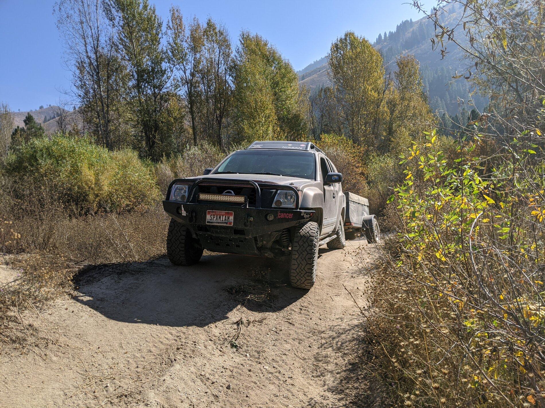

This is when a rear diff locker is nice to have. My momentum would have kept me going but I wanted to attempt a pic posing...rear tires spun, locked up rear diff with the "easy button" and out I went.
