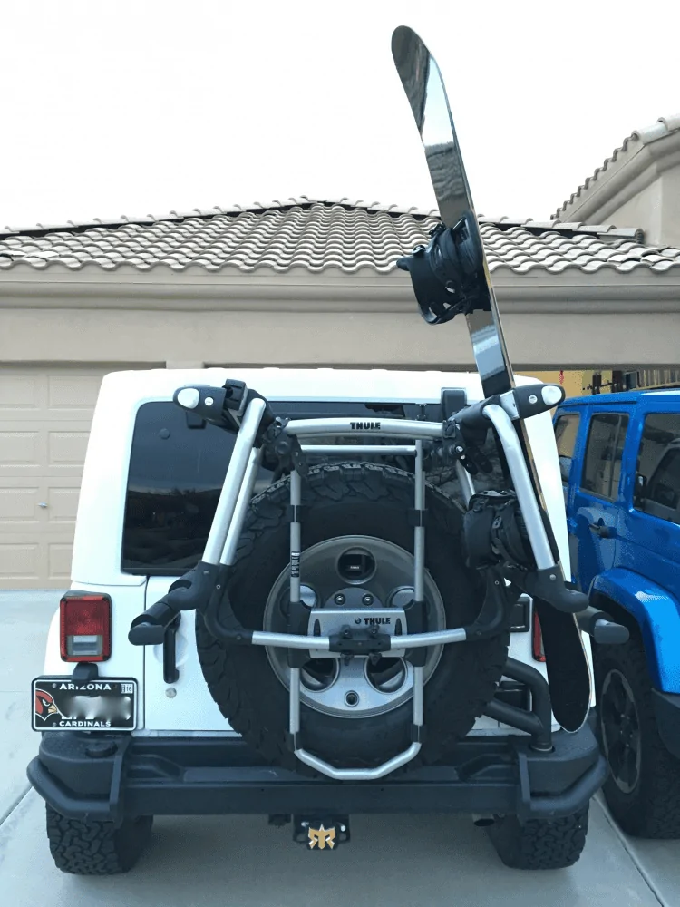

It's called the Thule Spare Me (which they still make) with ski/snowboard attachment that they call the Tram that holds up to 6pr of skis or 4snoboards. I had this setup for my '97 TJ, but don't see the new setupworking with the backup camera which is where it mounts. Here's an example of both on a JK.

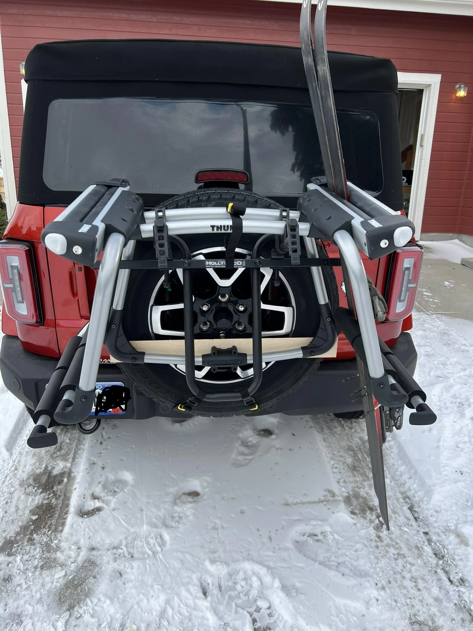

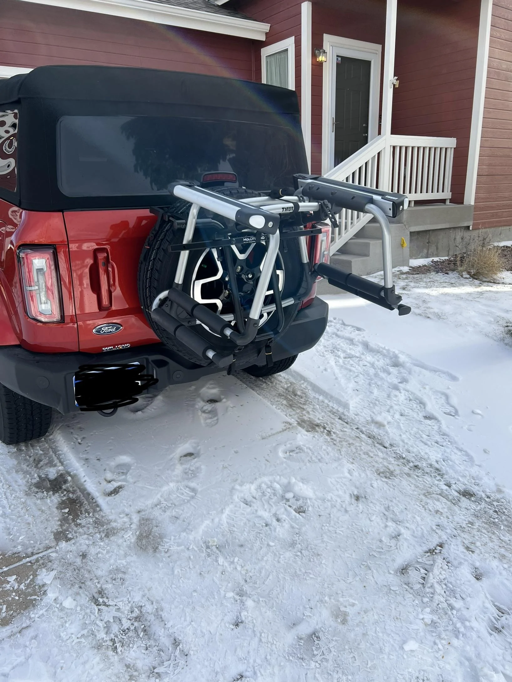

I made it work with the Thule Tram and the Hollywood Racks SR1. If you don’t want to do drilling and modification, it will still work (and it’s incredibly sturdy) but it can look a little bit messy. I got both parts just in time for a trip, so I didn’t drill new bolt holes, I just assembled as is.
I have gone 85 with skis in it, no extra noise coming from the back and they didn’t move at all. I did put a piece of wood on the bottom of the Thule because I didn’t like where the bolt heads were resting on the sidewall, but I ordered rubber bumpers to get rid of the wood. Just have to wait for them to come in.
The downside of not drilling new bolt holes is that the Thule and SR1 have to interlock to fit together, where the Thule sits behind the SR1 on bottom.
The upside is that it will cost a just a bit more than a hitch alone if you buy both used, the camera works great, and the tailgate is still fully functional!
