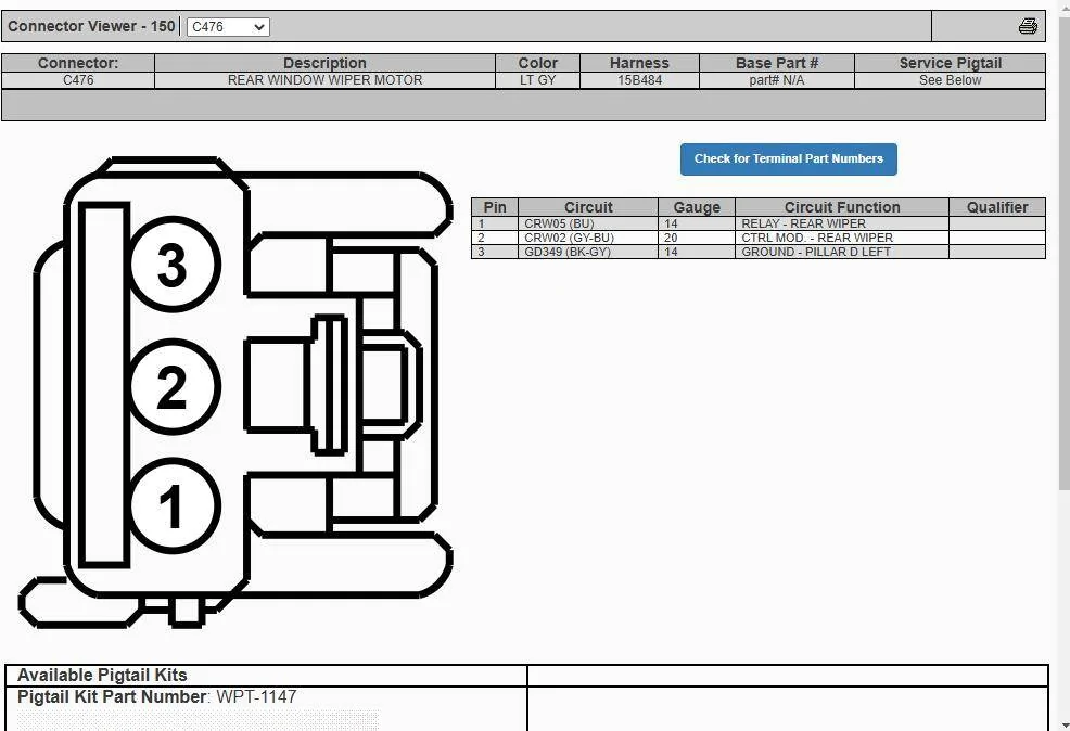

I went to my local ACE hardware store where the 1” plug was easy enough to find, but the 3/8” has yet to be solved. The removal of the wiper assembly was easy. First remove the wiper arm from outside. Then the interior cover, two Allen head screws. Lastly three nuts and the connector. The motor will pull out the rubber grommet in the glass.
There is nothing you can do about the mounting plate that is glued to the glass. I am intending on installing the Mabett rear cargo light, but I am looking at cutting the plastic housing down.
I’ll take some pics
