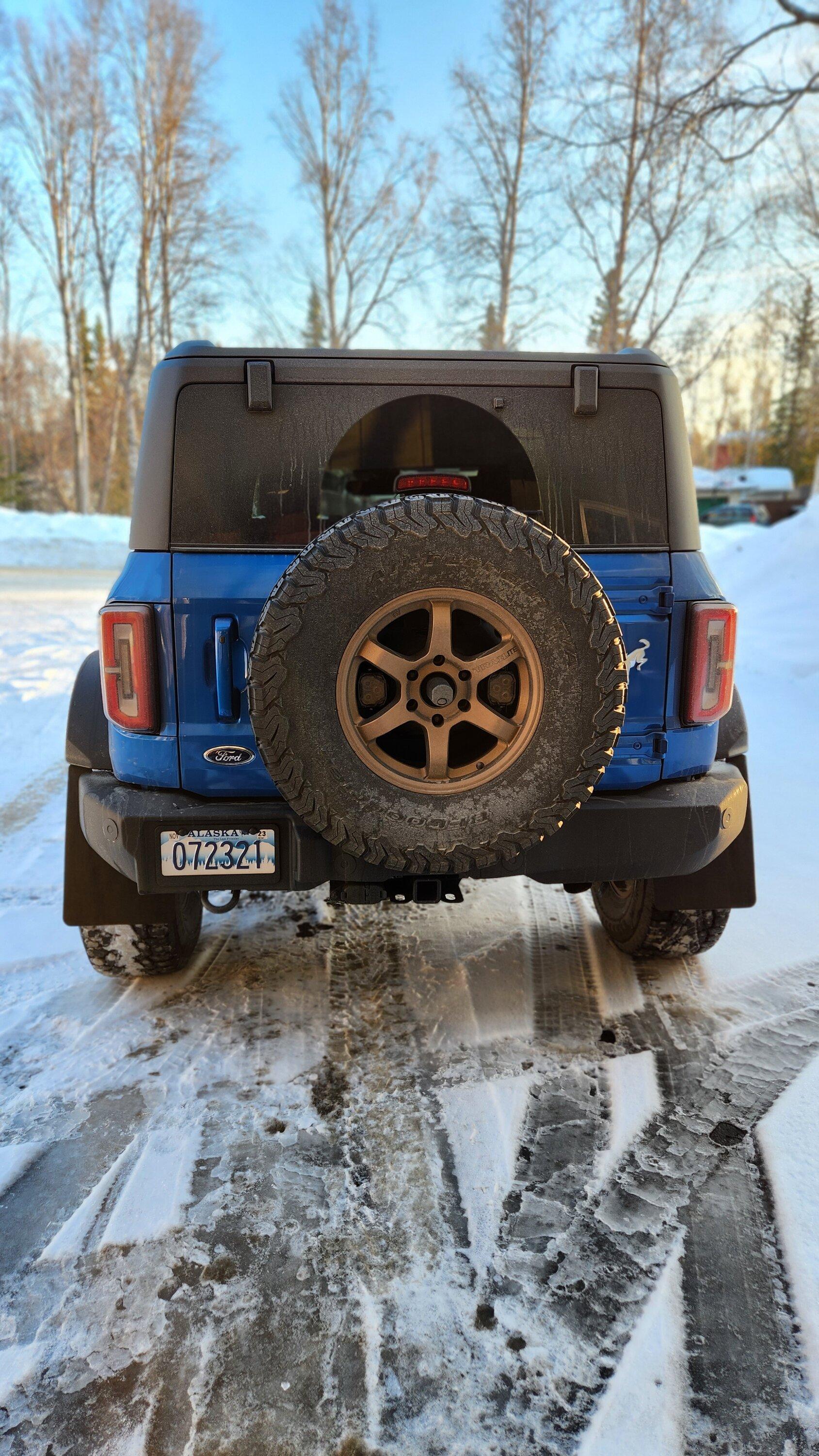

I use the hell outta mine, I shaved it off my old Explorer and loved the look hated the lost visibility.
Ford Bronco Rear Wiper Delete 20230307_174536

Yeah. no thanks! I’d rather have some glass cleaner and a microfiber on-board and do the whole window on salty days (albeit, a lot less here than Alaska). How much do you really gain from that? Pretty much just the dude riding your ass.
Again, the amount of effort and money for parts it would require to add as a pre-prep kit build - certainly not worth it for a 7” rainbow.

I love my rear wiper. Even though it’s small, sometimes it’s the only place I can see out the back!
What do you gain from all that effort of handwashing the entire glass every 5 miles?
Not a damn thing, UNLESS, you keep the rear headrests down all the time.
In my two door, the wiper clears damn near 100% of the only bit of window you can see thru the rear view mirror when the head rests are up.
The only time I use the rest of the window was when my (recently departed) poocher 🐕🐶 was back there and I was fueling up .... so of course you have to make faces at the pupper.
