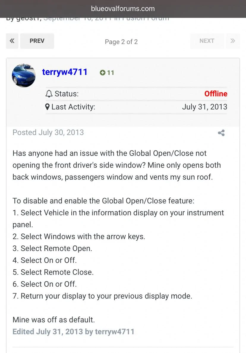

I had the same thing happen on my F250, can’t remember what it’s called, technical term. On the key fob (which sucks) if you hold down one of the buttons it’ll roll the windows down. I’m always laying down, crouching etc for work and I’d come out to my truck and the windows would be down, same at home playing with kids. There is a setting you can change in the info screen that turns it off. Sorry, but I can’t remember what it’s called.
https://www.ford.com/support/how-to...-i-open-or-close-the-windows-with-my-key-fob/
It’s a cool feature but it really should be turned off when vehicle leaves the factory, I got lucky all my stuff wasn’t stolen on job sites. Like I said you can turn it off, it’s in the info screen on dash.
i found it...
