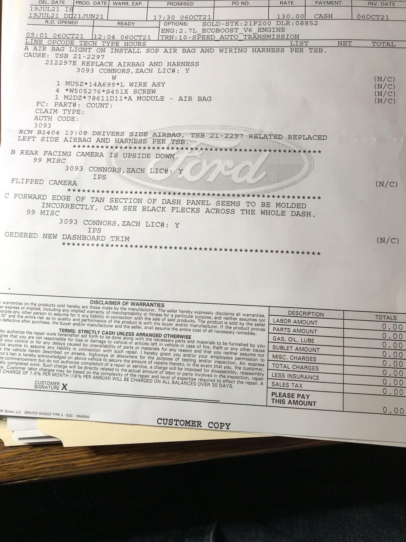

This is the TSB the dealer performed, so far so good the airbag has remained off.
Thanks for sharing this info. Mine just went off this morning after my daughter adjusted the seat to drive. Yes, I’m letting my 15 YO with a permit learn in the Bronco.
