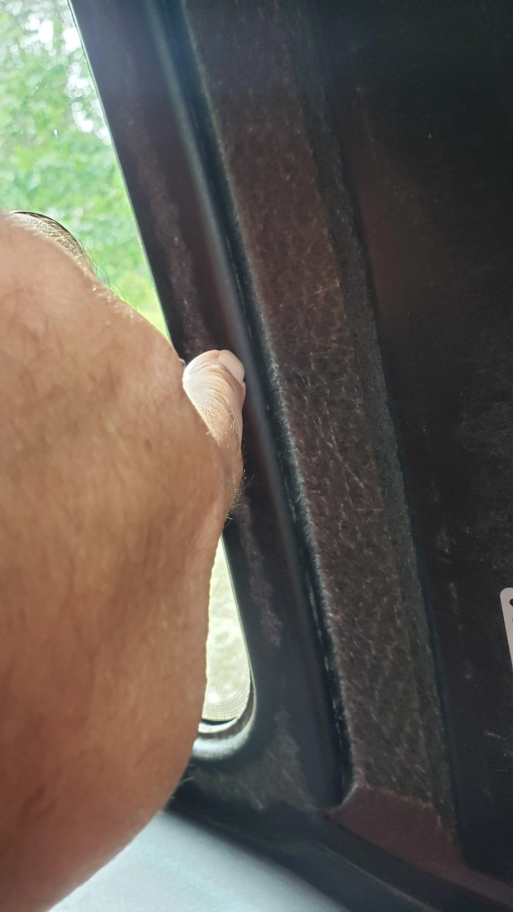

The pockets on the windows of the MIC top are much shallower:

You can see here the much deeper recess to accomodate the window frame and seal:
Ford Bronco Retrofit MOD top removable windows? 1694103564496
Oh well...

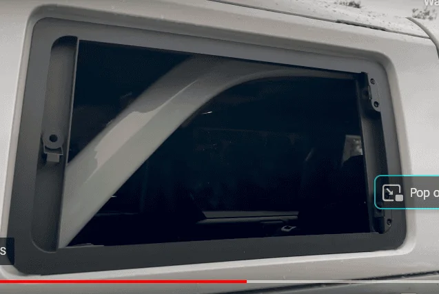

<iframe width="560" height="315" src="" title="YouTube video player" frameborder="0" allow="accelerometer; autoplay; clipboard-write; encrypted-media; gyroscope; picture-in-picture; web-share" allowfullscreen></iframe>

That frame is the part I'm interested in, and of course the mod top rear windows since they're different. Although with about 10 minutes more research it looks like it won't be possible...
Oh well...

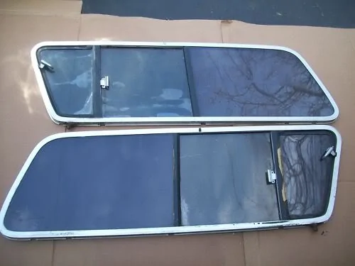

I'm really surprised that someone hasn't made sliders yet, that's all I really wanted vice the whole window coming out and then having to store them and not getting them broken.
Sliding windows or even pop out ones would be amazing. With the frameless windows on the doors there really aren't great options for venting while camping in the back. Removable windows would open up possibilities for maybe replacing a window with something vented, not to mention just taking them out on nice days.

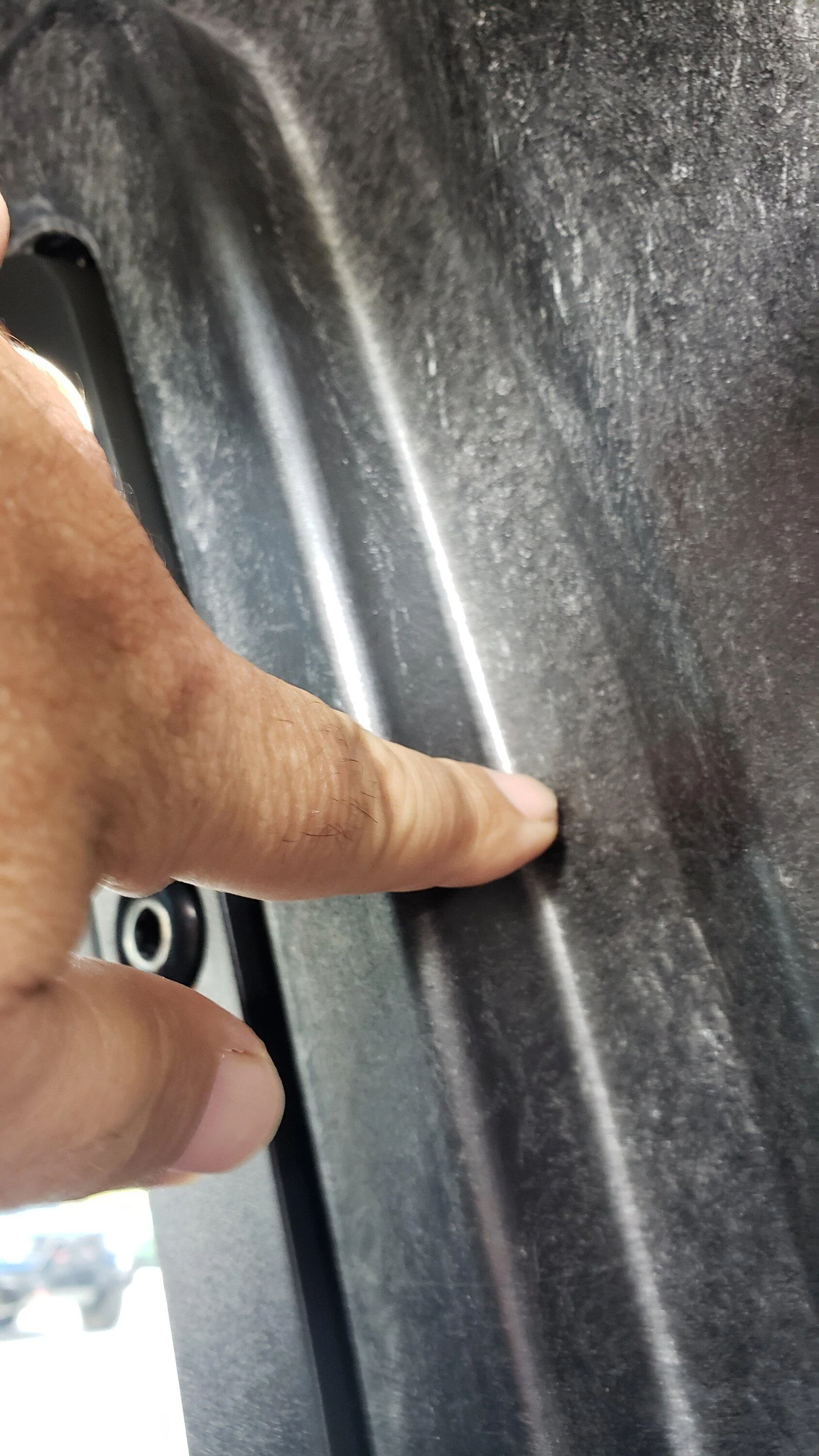

I was wondering the same thing. I got tired of waiting on the mod top and went with the mic.
After seeing a mod top in person. I can confirm the window pockets molded into the Mod top are much deeper. Us mic top owners will have to hope for an after market option.
Pic 1: The inside of a 2-door mod top.
Pic 2: The inside of a 2-door mic top
Ford Bronco Retrofit MOD top removable windows? 20230818_112221
Ford Bronco Retrofit MOD top removable windows? 20230909_104808
