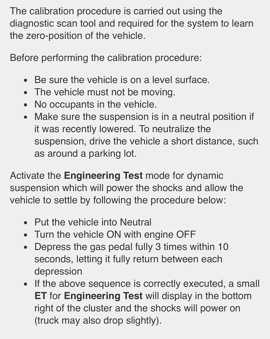

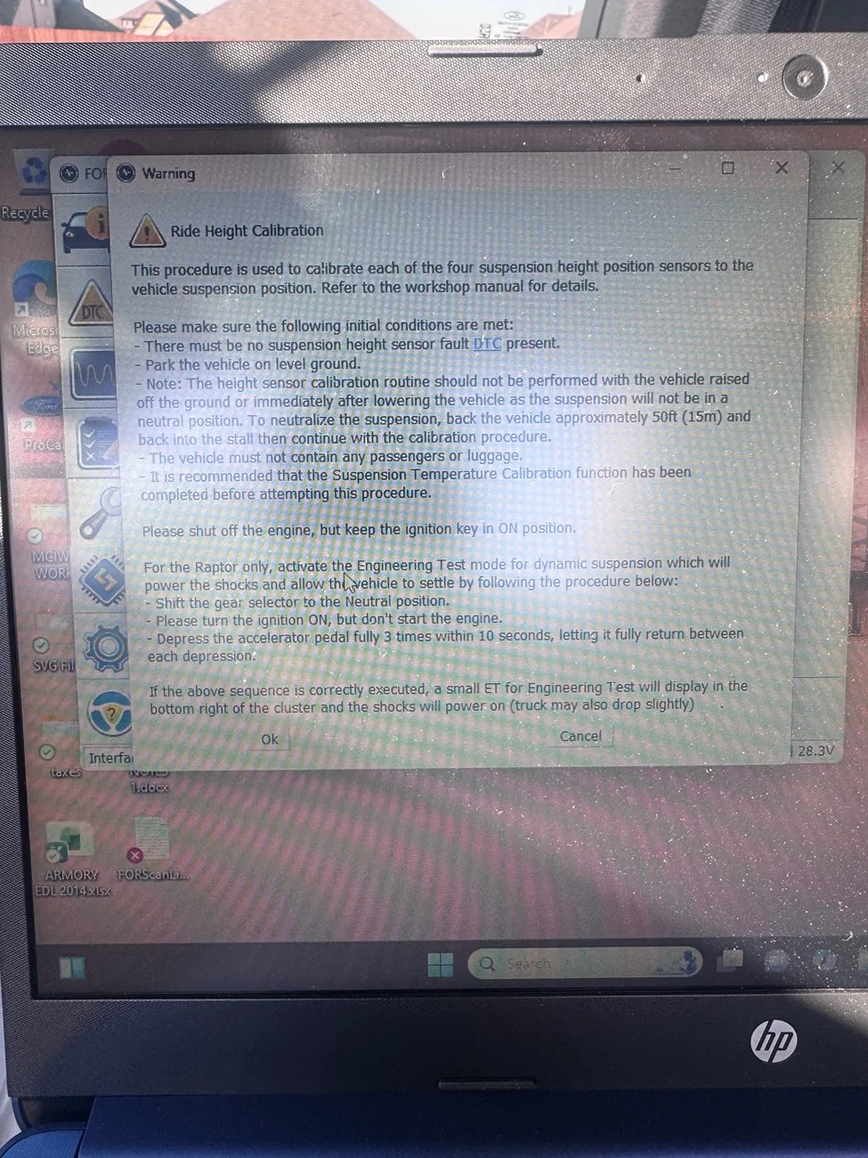

I’ve never dealt with this or seen this issue anywhere, but there are a few things it lists in the workshop manual to verify before trying the calibration. I’m not sure if forscan tells you all this also, but I would just double check all of this is correct. For instance, no person or cargo in the vehicle, level ground, etc.
Ford Bronco Ride height calibration issue IMG_9766
If you’re following all this and it still doesn’t work, to me the most likely answers might be that the calibration procedure is simply messed up in forscan. There are a handful of procedures like this that do not work correctly in forscan.
For example, and correct me if I’m wrong here @Brian_B, but didn’t you have some type of issue with the parking brake maintenance mode procedure in forscan?
There’s a good chance this simply may not work correctly without FDRS.
Another thing, and once again I’ve never seen this problem before, so I’m not sure if others have successfully done it or they’ve all had problems?, but maybe it’s possible that with the new parts you installed, it’s simply out of the calibration range for the procedure. After all this calibration is meant for stock Braptors, not ones with modified aftermarket suspension..

that is great info question, I need to put the truck in neutral before I turn the ignition on? Not sure how to do that. Is there a transmission lever release to accomplish that?
Ducati1098
9,909
22,991
Midwest
That’s great info. Thank you so much.
That’s a good question, I do not believe the order of that is correct. I think you should be able to place it in neutral after key on.
