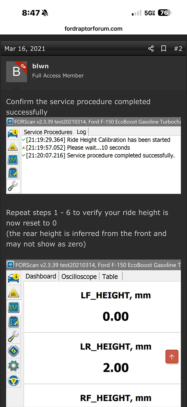

Good afternoon everyone wanted to keep this chat alive. Has any one tried the graduated re calibration with any feedback back. I’m planning on tring it out on Monday.

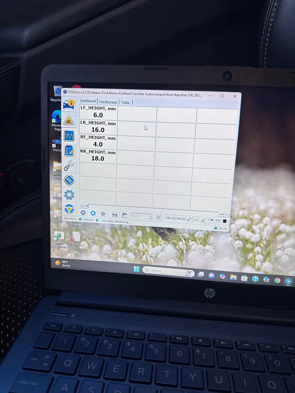

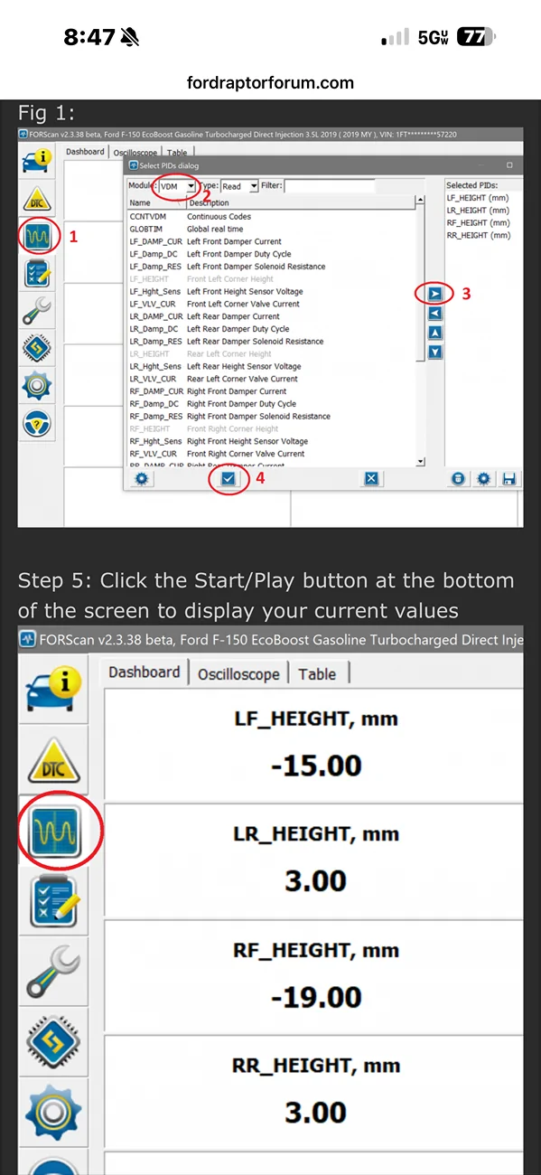

This is what i have been working on, and now im stuck. it worked on and off, i have successfully taken them from 40mm out on all wheels to 3 wheels near 0 and 1 at 13mm. i have done this by bringing them all down 5 mm at a time, now im stuck and at this point no mater what increment i try it does not want to get any closer. if i manually move the one wheel to zero it will work but then i have one wheel at 13mm out. i will give it another go but i am also looking at just making an adjustable arm for the sensor, lets see if that work :)

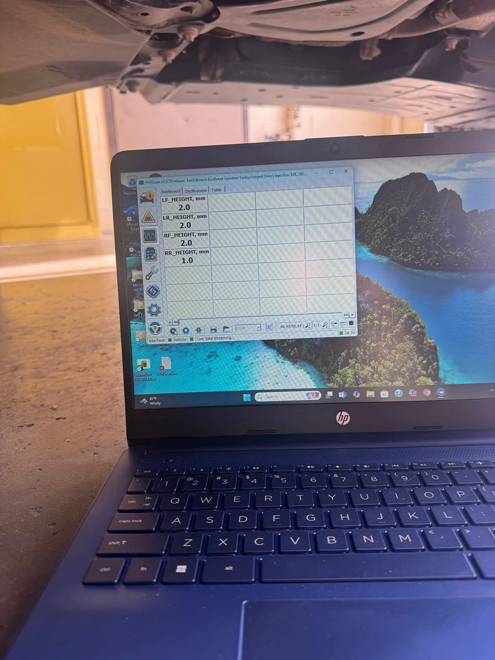

OK, boys and girls I got it figured out. E rod007 theory worked. So all the steps that I had previously in the post make sure you do that. Make sure you have no DTC codes. When you read your levels of where they are currently reading live on for scan I made 20 mm adjustments at a time after settling my front struts were reading at +46 mm and my rear were reading at 8 mm. So I disconnected the ride height sensors and set them to 20 mm evenly in the front and 7 mm in the rear. High then did a height adjustment recalibration. I then put the bolts back in just to see what it was truly reading. My rear struts were at zero, but my front struts still red 20 mm so I did it again and adjusted it manually to about 19 mm then I did the recalibration and then bolted everything together went for a test ride and then re-cleared all the DTC‘s. This is the closest I’ve gotten it. I will see if it’s worth refining it more but I feel like you’ll be chasing bubbles.

Ford Bronco Ride height calibration issue IMG_7759

Again, I can obviously refine some adjustments and it’s not quite perfect but significantly better than what it was before. I will continue to mess around to figure out this solution. But this is the key to the issue that we are having. I truly hope this helps. Let me know if any of you need any additional help. I’m willing to reach out and hook a homie up.

I also just realized the pictures that I took of the right height was with my truck in the driveway backed in my driveway is at an angle lol

That’s about as close as I can get I pushed it as far as I could have whatever the max calibration was to where it would allow me to run the right height calibration. The back is pretty easy, but the front has a metal bracket that the ride height bolts to if you reach up on the top and bend it towards you or away, you can make those micro adjustments.
