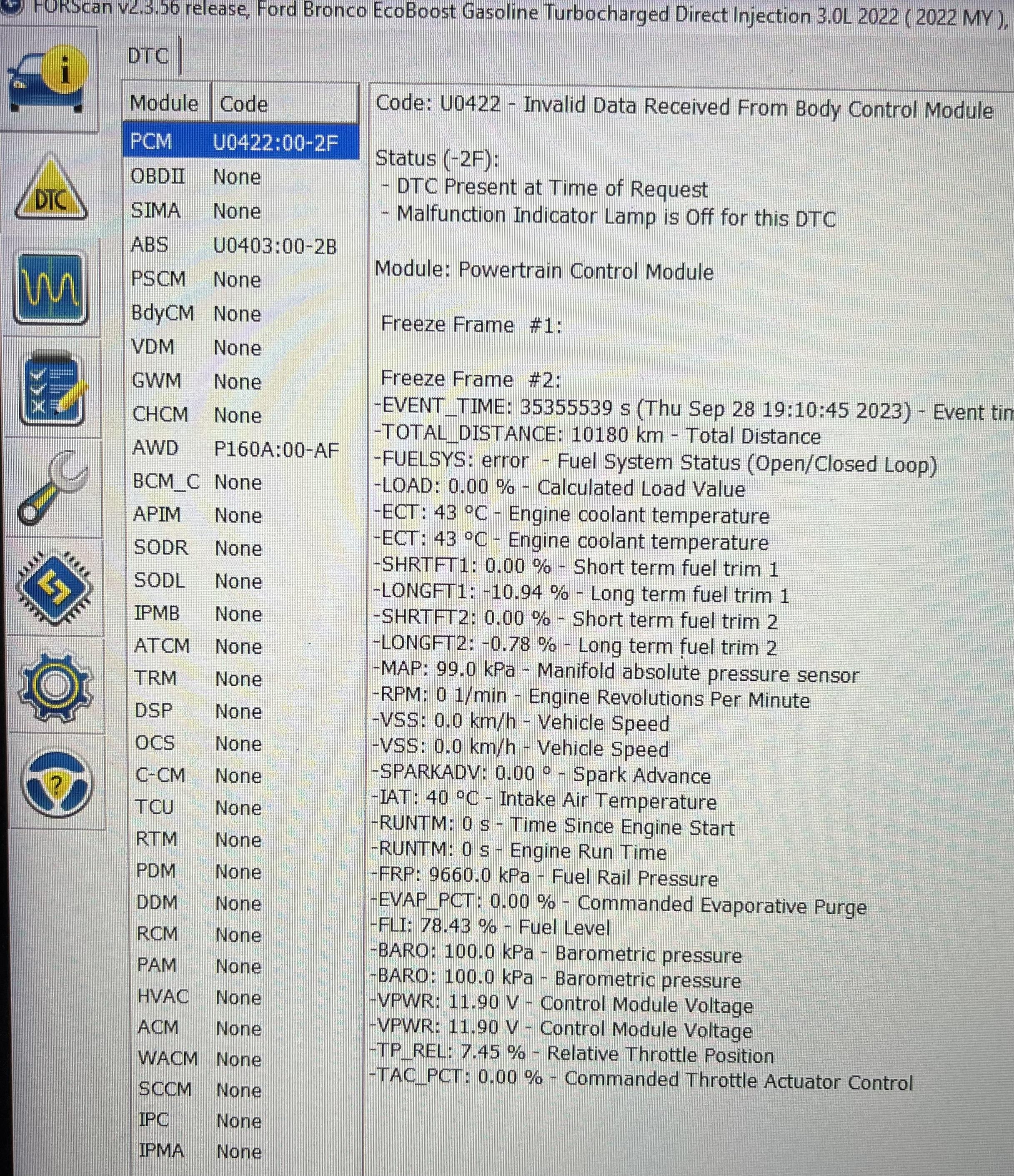

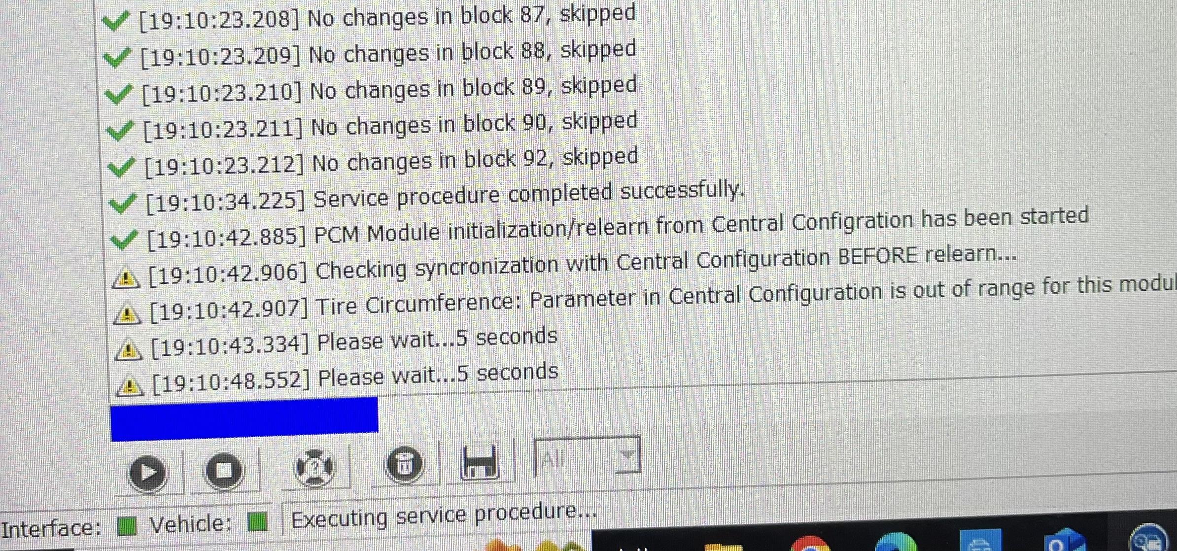

I have the same issue with my 40s. I’ve got past all the modules with forscan except for one! The new Forscan has features for each module to relearn from configuration. The AWD module throws a code immediately that says “tire circumference out of range.” I drove it a little ways down the road and never got an ABS light but the wrench light stayed on and everytime you start it, you’ll get a check 4x4 system/error. I assumed it has to do with the trail turn assist feature and the only way to fix it is to reprogram the AWD module with a new program but I’m not sure how to get that done. Forscan said they couldn’t do it. I’ve looked on other forums for the solution but haven’t found it. Tried fooling it by changing the gear ratio to a higher ratio but that didn’t work because it’s using the tone ring at the hub. I also thought about trying to find a way to add/subtract the number of teeth in the tone ring programming but never found where to do that or if that would even work. I’m not sure if we could physically change the tone with a different one. I haven’t given up, still brain storming.

2890 is the magic number for sure. I tried 2891 and after all the relearn only had a code in the pcm. Then I tried 2900 and got a code in all the modules. So the other modules may accept something between 2891-2899 but I didn’t take the time to find that number because no codes is what I’m after. I attached the codes I got when I exceed the magic number.
