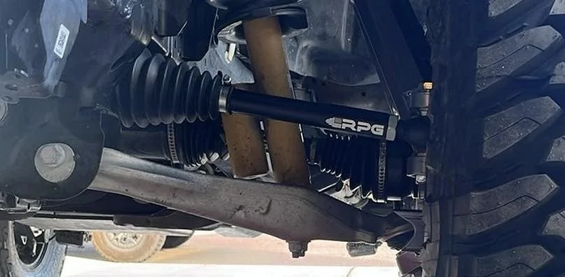

Now I’m regretting these stupid circular tierods
:ROFLMAO::ROFLMAO: I can remember in the early days RPG was one of the first to offer a replacement tie rod. But it was only the outer. I brought to their attention that it was the inner that was breaking. They said well that was what they sold for the Raptors and customers were happy. 🤪 Now they call just the outer a 1/2 kit. and what you have they termed as the full kit.
I would have issues with the full kit as well but seeing how 74Weld made a double shear all is good. :wink: Fabtech tried that early on as well and without the double shear it just bends the heim when you push it to the limit.

This style?
https://fabtechmotorsports.com/product/tie-rod-heim-kit-fts22349/

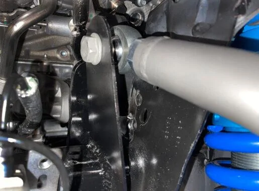

Yes, that style. Without an upper bracket to support the upper stem of the heim it will bend with being supported, like this.............
.............................I've seen it happen.

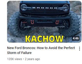

Of course, finding that video now has proven to be a bit of a challenge, I thought we had it posted here on B6G but have not found it, yet. Tried YT but could only find Tylers Bronc (broncbuster) with the heim style tie rods in single shear. Not Fabtech but same general design.
Ford Bronco Ride Shocks 1722469889774-49
Now this shows him on M/T 40's but I've seen him on smaller tires bend it as well. Back then he was trying everything out there but always had issues. Once you make it double shear no more bending, but he chose to make his billet block for the OEM tie rods.
On a side note, which I'm sure you know by now seeing how you have made lift kits for Broncos, the gurus at Ford seemed to have made the UCA mounts single shear for some odd reason. I say that because my 08 F150's UCA is double shear. Seems we have gone backwards with the Bronco. Big tires/portals/heavy use will eventually lead to failure.

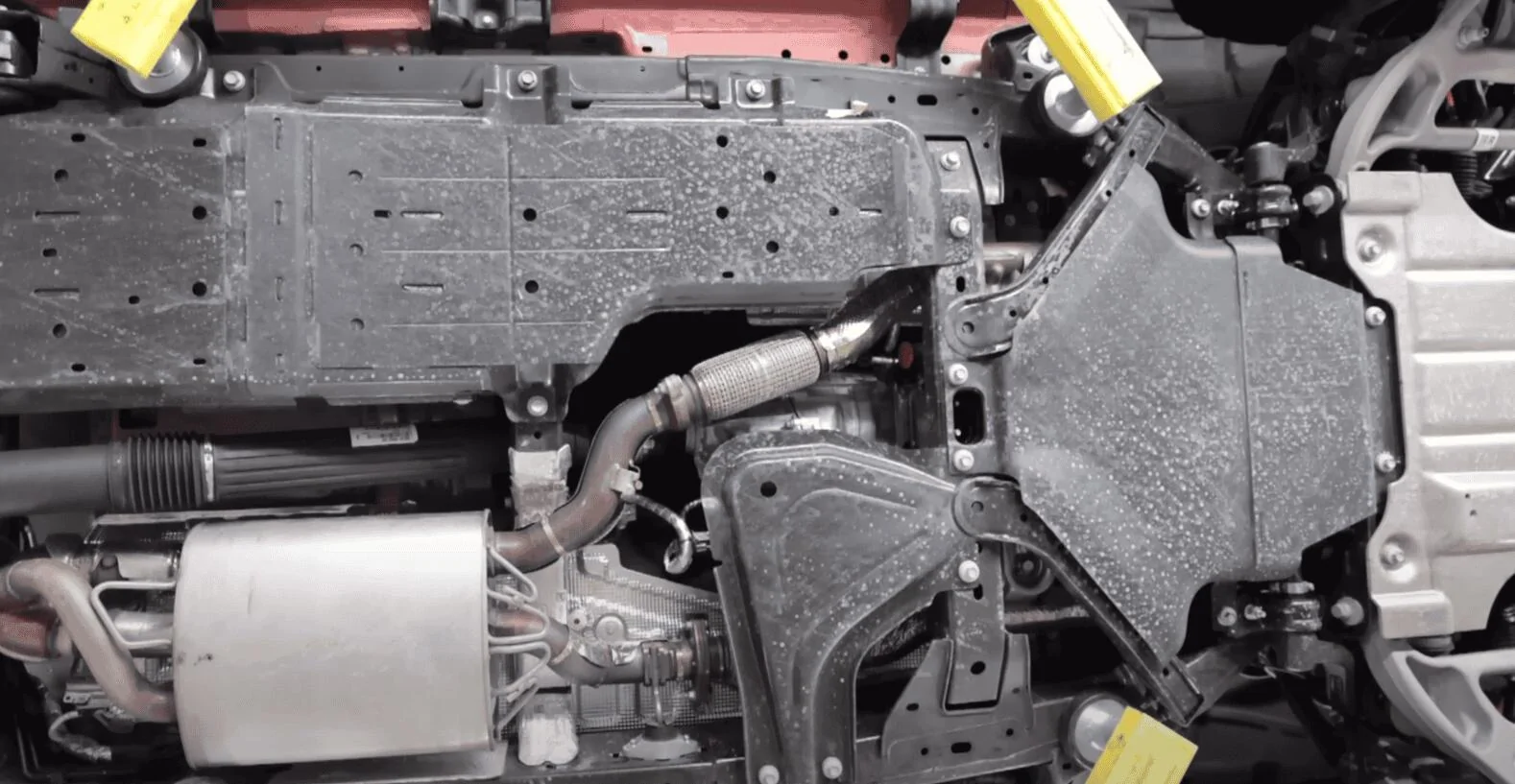

Braptor has a transmission skid as well, to protect that plastic trans pan, but not for the less serious buyers. :cautious:
