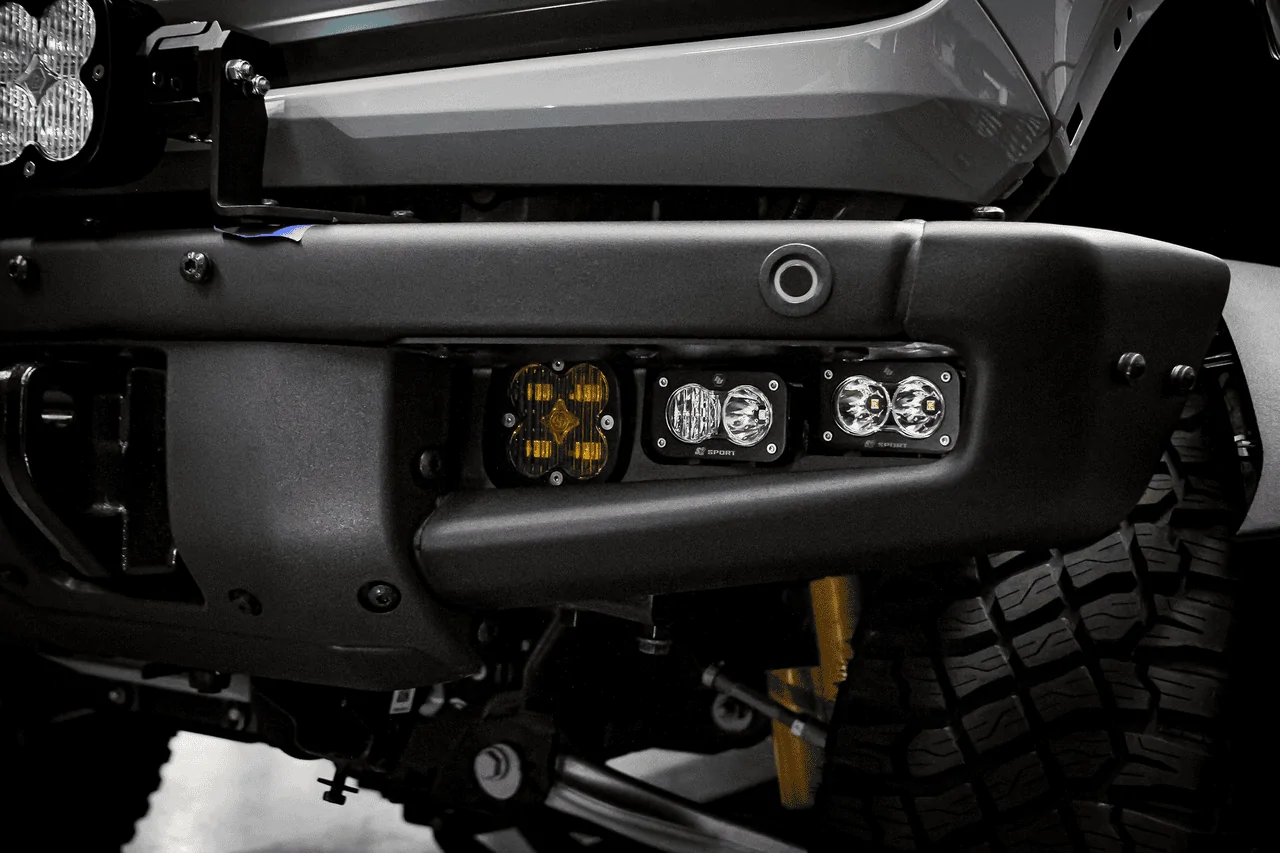

As for the fog lights, if you want the best, go with again Baja Designs. They have a triple fog kit that utilizes your existing upfitters. One upfitter switch per pair of fogs (you get 3 pairs if you have the HD Modular bumper). Check out the fog kit here: https://www.4x4truckleds.com/baja-designs-fog-pocket-kit-for-2021-ford-bronco-modular-bumper/ and you choose any combination of patterns/colors (white or yellow/amber that is)

Feel free to message me for help on lighting. Even if we don't sell it and you WANT it, we'll help point you in the right direction.
