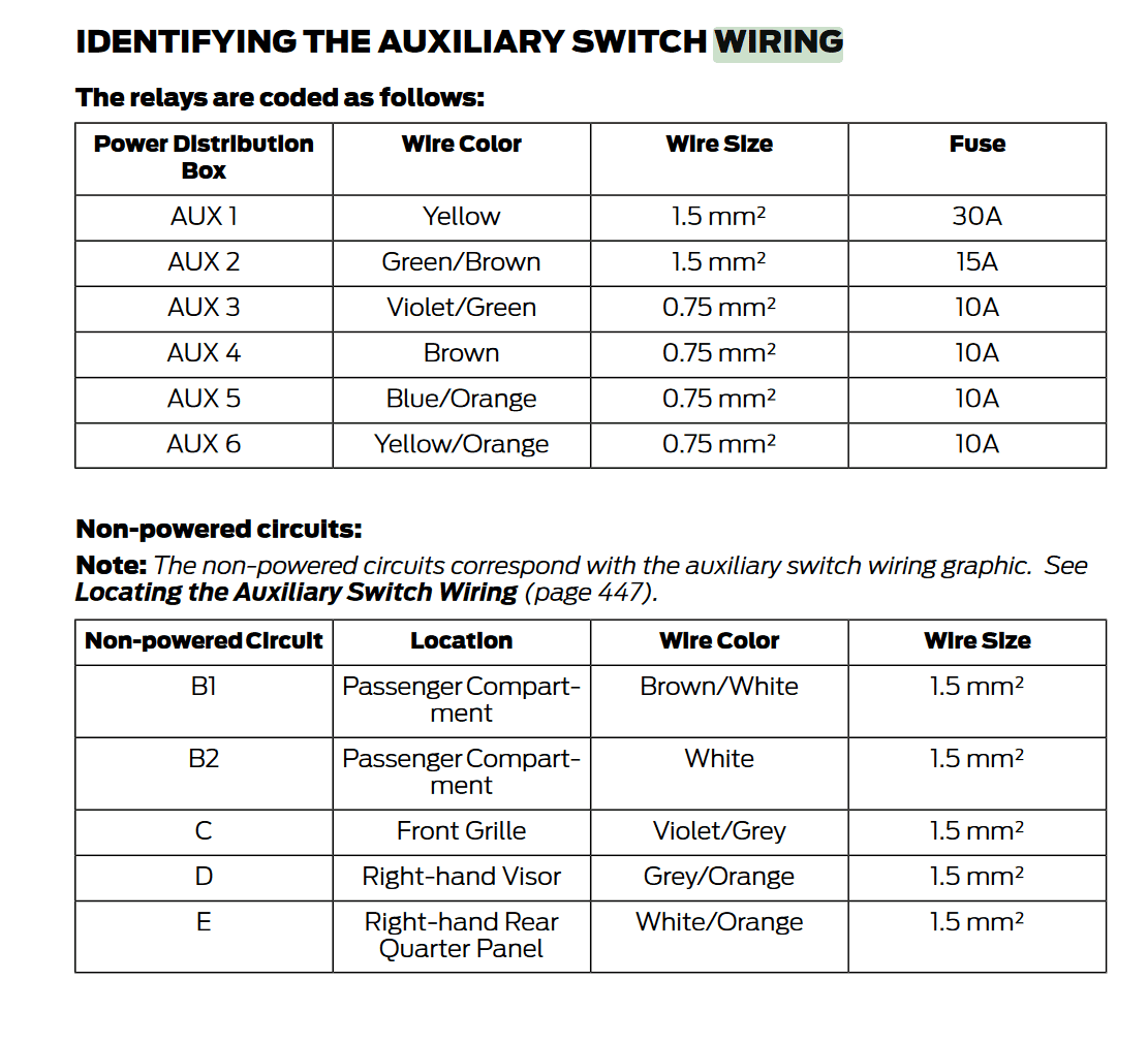

Aux 2 is probably not the best choice, aux 1 is a 30amp and aux 2 is a 15amp, everything else is 10amp. So you're kind of wasting potential amperage and if you ever wire anything higher than 10 amps you'll have to move your lights to a different switch. Not a difficult thing to do, more of a slight inconvenience. I ran into this conundrum when wiring my ditch lights, went with aux 6 on those because it's on the end and easy to hit without looking.
Awesome! Thanks for the heads up! I gotta be honest I am pretty un- educated when it comes to lighting and wiring. It’s just never been my thing but I’m wanting to Learn and understand it as well as make my bronco perform to the max potential! All you guys are awesome e

I’m already using aux 1 for the pod lights which is why I used aux 2 for the rock lights. :)

Which is perfectly fine, but if you ever decide to wire something with more draw you'll need yo move those lights to a different switch. An inconvenience but not the end of the world.
Also, not a huge risk in this particular situation, but I almost burned down my shop one day during snowpocalypse when I overpowered an outlet that was the only thing being run at the time by a 30amp breaker, everything else was off. The breaker had no issues handling 2 water trough heaters... the outlet was not pleased. So ever since then I try to match things up so a breaker or fuse will fail long before any damage is done.
