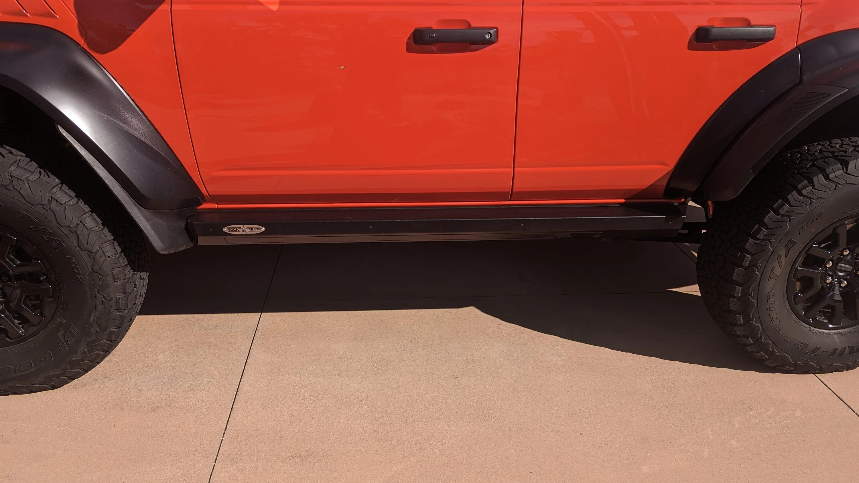

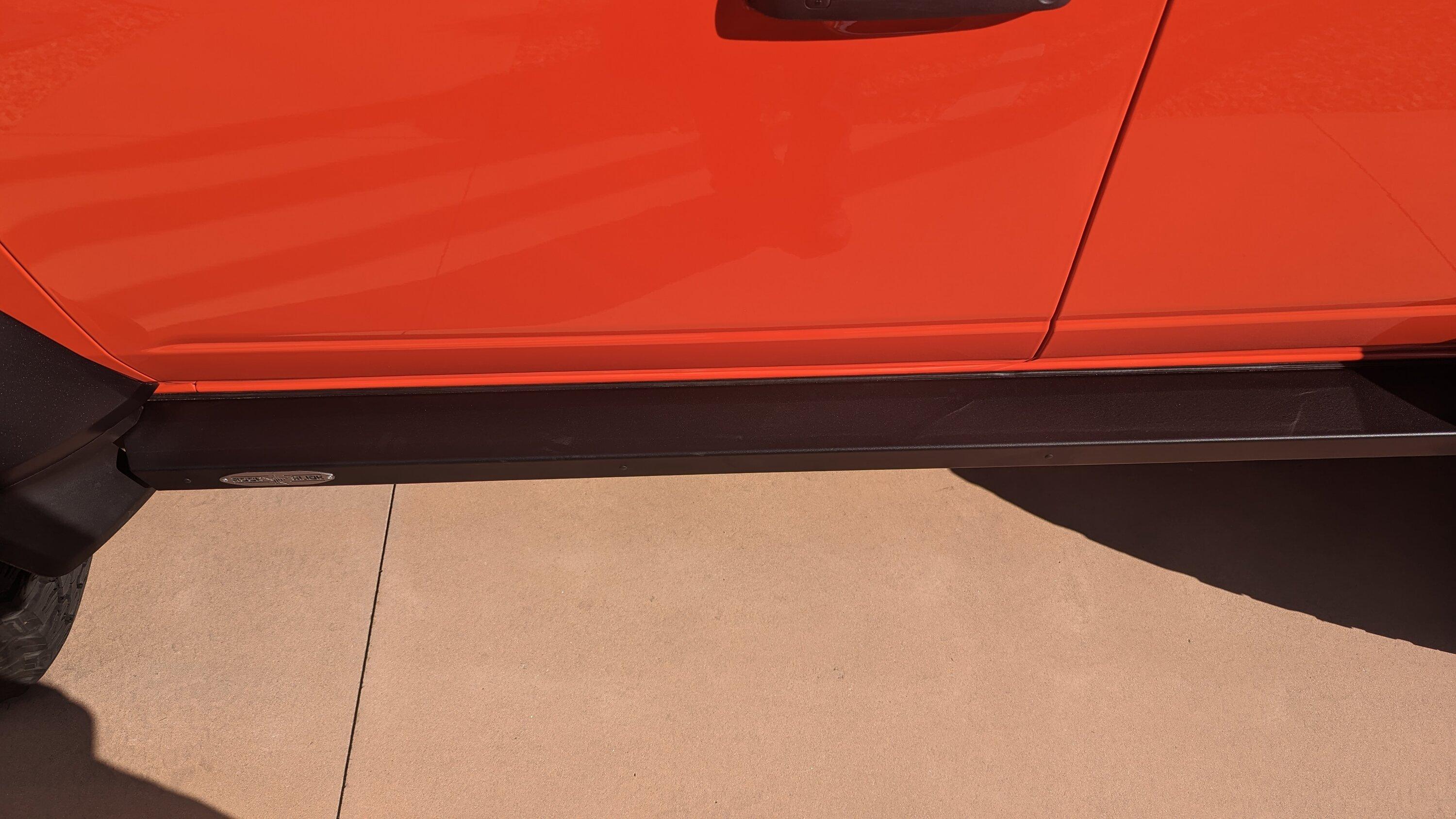

Got these installed and they are every bit as good as expected. Got the light add on kit as well. Not only do these make entering a breeze, but they will help spare wear on the seat side bolsters.
Ford Bronco Rock Slide Engineering Step Sliders Installed (Some Raptor Specifics) PXL_20240119_192126604
Ford Bronco Rock Slide Engineering Step Sliders Installed (Some Raptor Specifics) PXL_20240119_192226393
I considered removing the badge, but decided to paint it semi-gloss black instead (later).
Raptor specific install notes:
  1. The first spacer plate (@5:41 here) is not used on the Raptor. It will result in a crooked slider)
  2. Flap trim on front is required on Raptor, not on other models.
    Ford Bronco Rock Slide Engineering Step Sliders Installed (Some Raptor Specifics) PXL_20240119_192138540
Unfortunately, like others, I have 1 bad door sensor, which takes an extra strong magnet to activate. RSE suggested not trying to run a custom magnet, but sent out a new free sensor. Luckily, by simply disconnecting the bad sensor from the harness, all other doors work and I can fully enjoy these until the new sensor arrives.
Lastly, the edge seal fits perfectly flush against the rocker panel and makes for such a nice clean install.

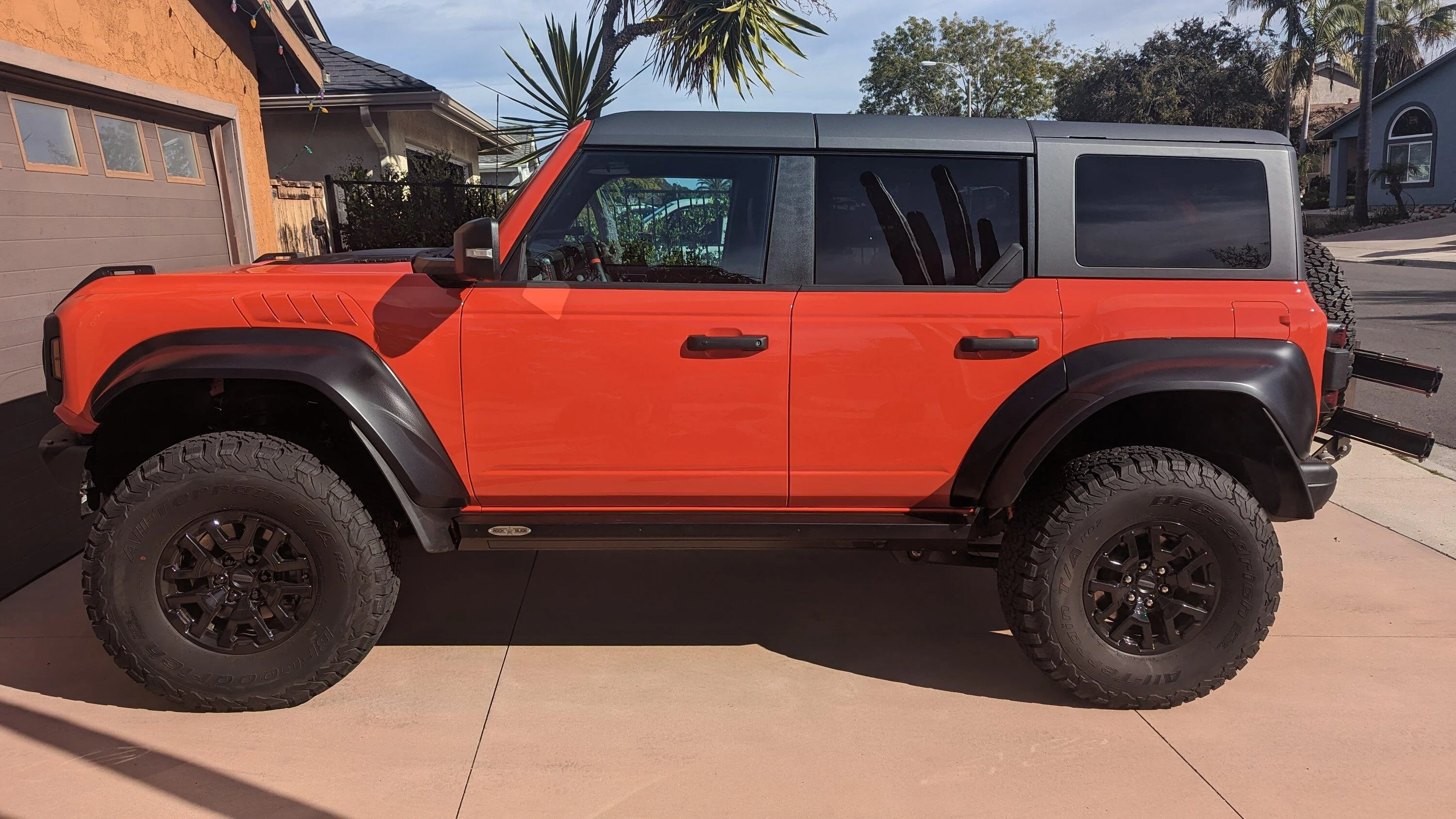

Looks good. Full side pic would be appreciated. Curious how they change the look.

Only for the better IMHO. Looks way better than traditional tube material sliders.
