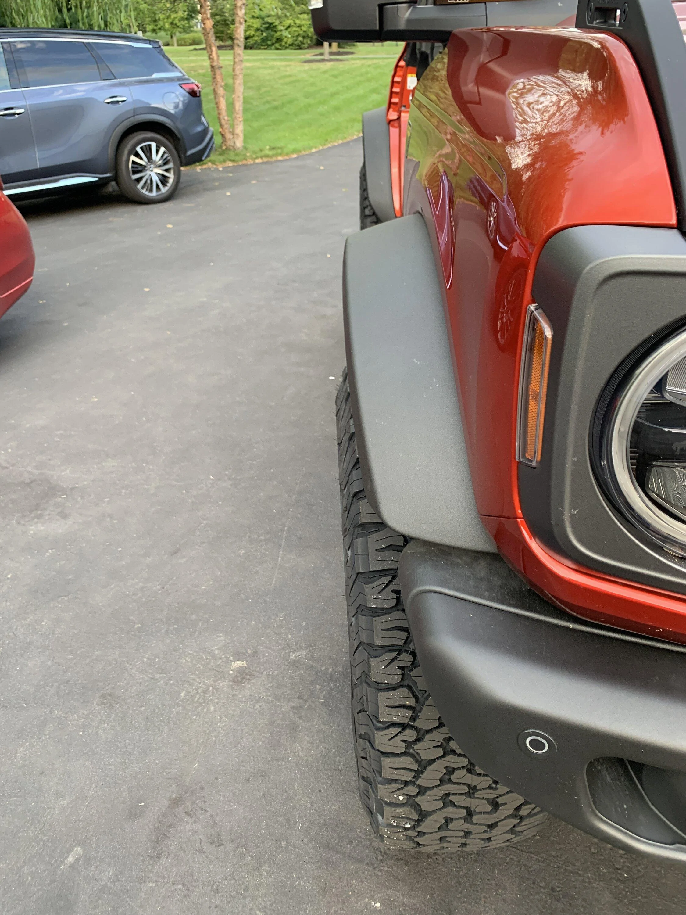

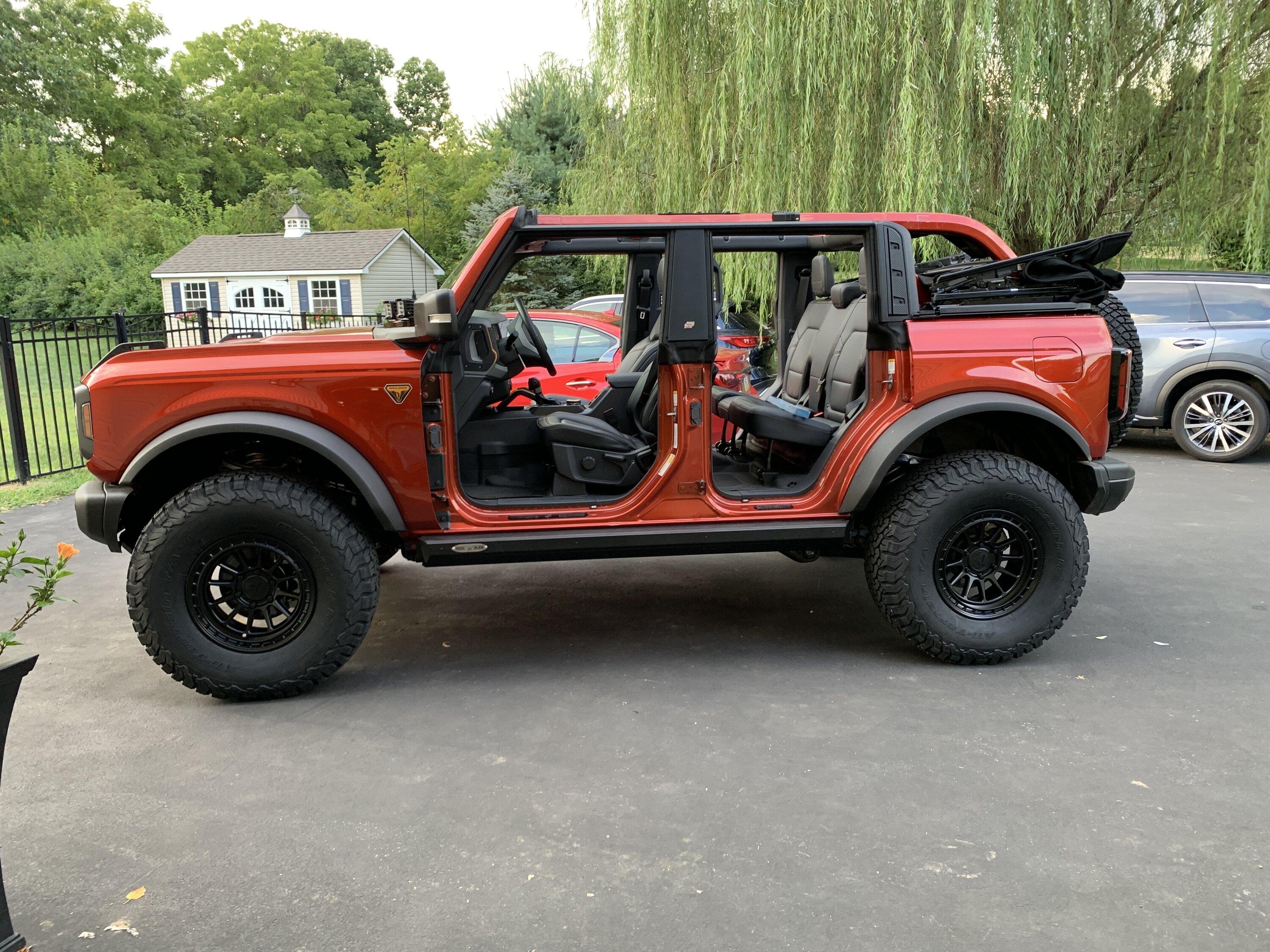

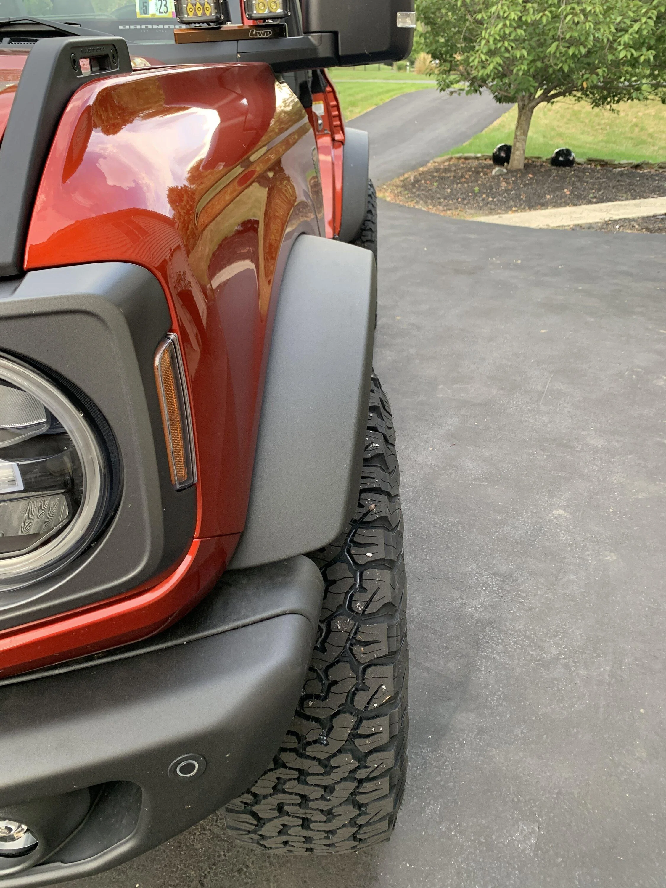

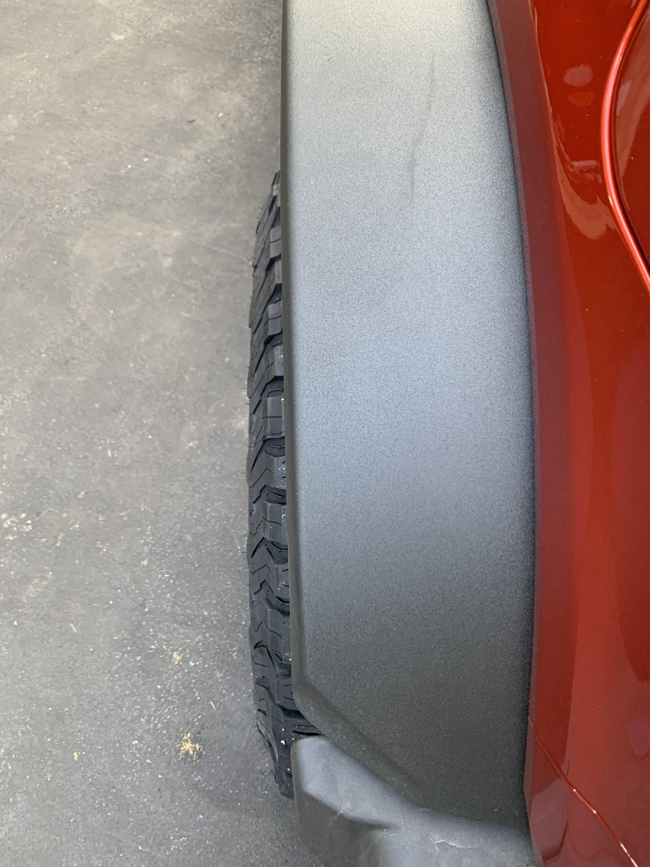

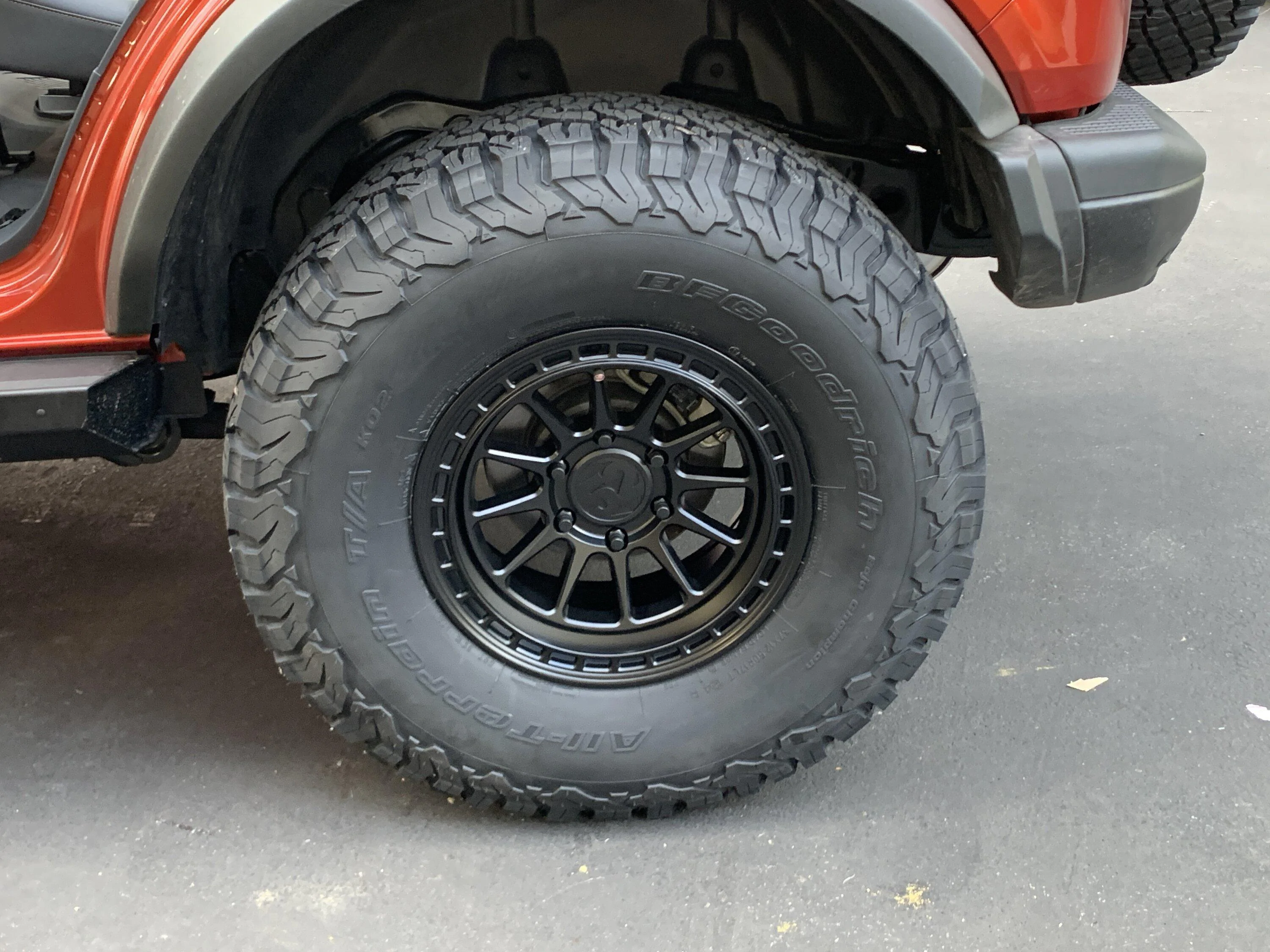

Fifteen52 Range HD with BFG KO2s. 0 offset, had to remove mudflaps - they rubbed at full lock. 2 inch lift with Eibach coil overs, little (very little) poke, no rubbing now. (SAS so no crash bars)
How do you like the ride? I was planning on doing the eibachs and 37'' KO2 as well. Any infor would be greatly appreciated.

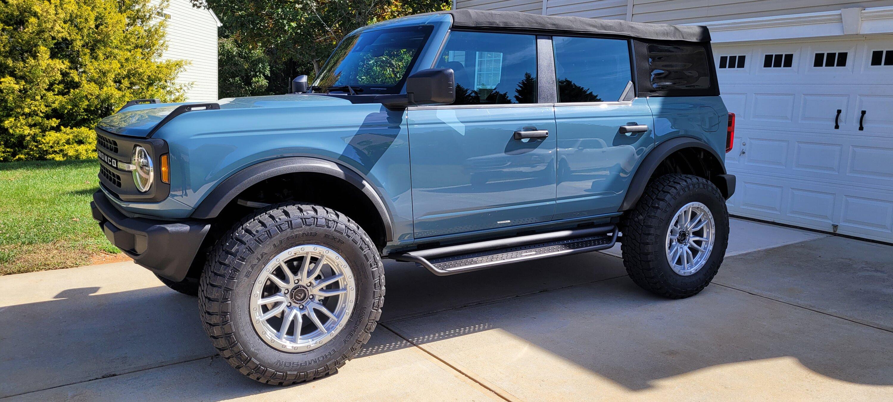

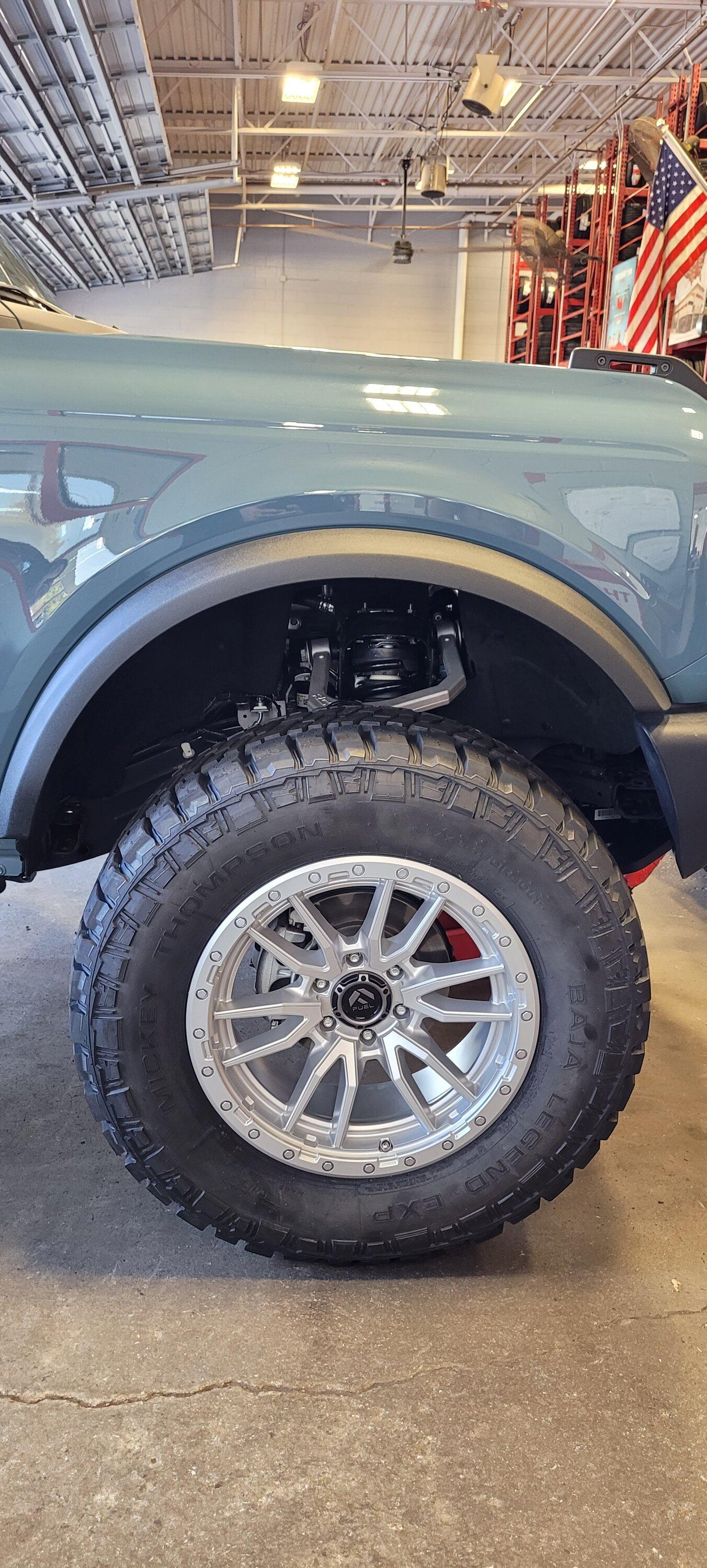

20X9 Fuel Off-road Rebel 6s Powder coated Porsche silver on 37" Mickey Thompson's, a 3.5" Rough Country lift, Go Rhino D1 step, RTR Delete Kit.
Digging the color contrast!

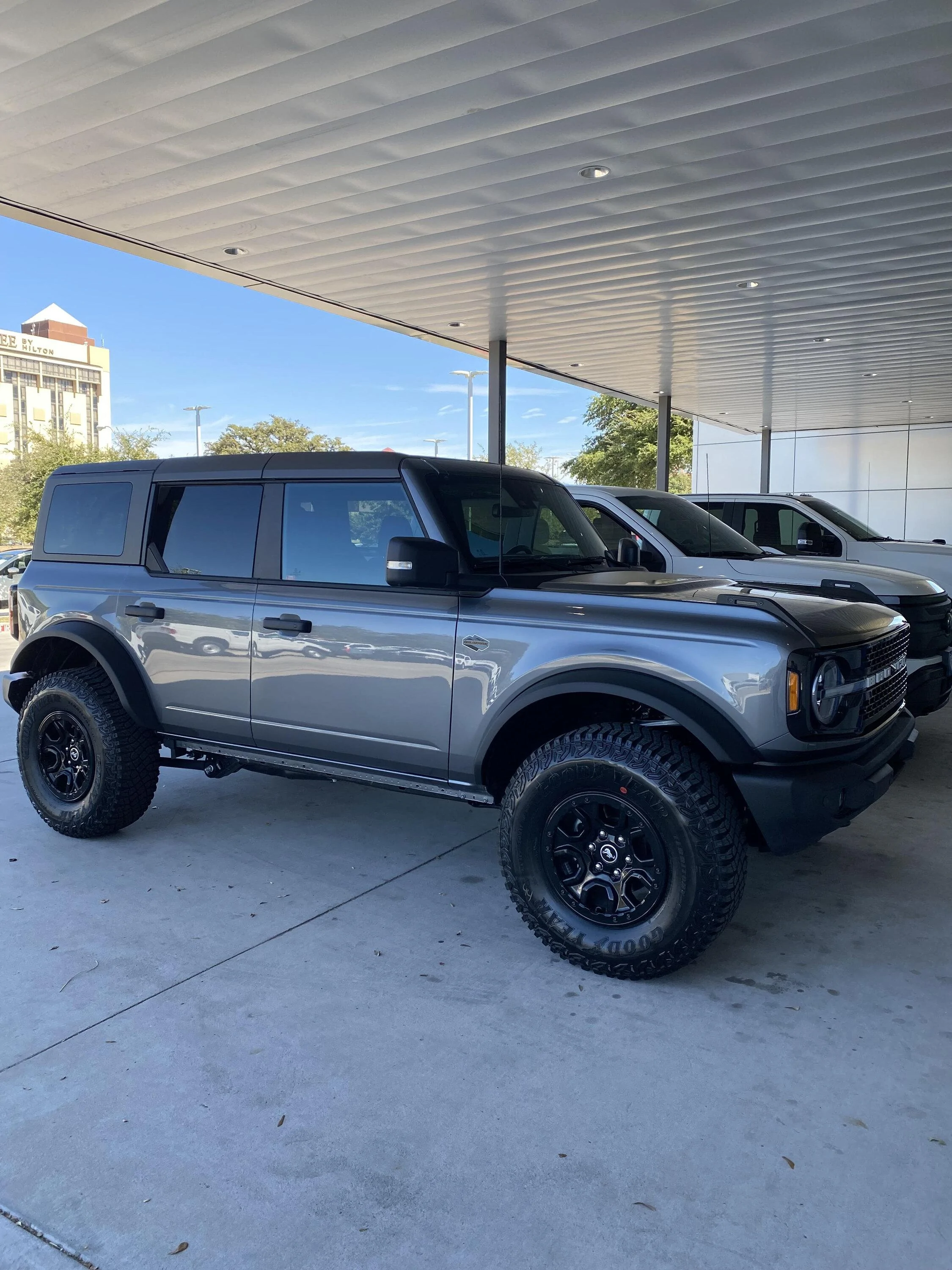

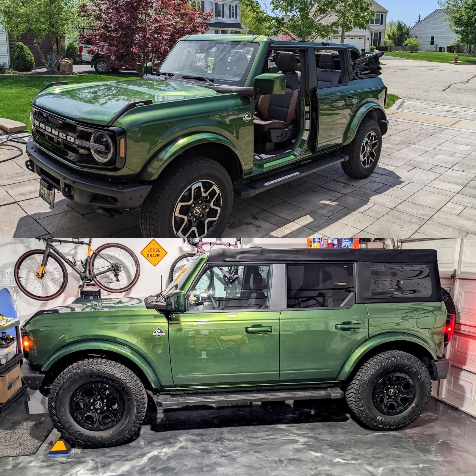

Got a set of Wildtrak take-off wheels & tires for my OBX. Had 'em mounted within 90 minutes. 😁
Did the Forscan change yesterday for the new tire size and removed the crash bars as well.
Nice, that is the look I wanted with my basesquatch, just need the EG fender flares.

If you like the stock ride, then you will like the ride with the KO2s and the eibachs. It is extremely close to stock. The springs have a little bit more softness to them which is more comfortable. They also have a little less rebound so they don’t bounce around quite as much as the stock SAS shocks did. I also prefer that. I’ve used a lot of different tires on jeeps over the years and have settled on KO2s. They clear mud extremely well, almost as good as the mud 3s, but they are nice and quiet and don’t harm on the road at highway speeds. In my experience they also wear like iron. It’s a big investment, so I like that they last a long time. The car in my opinion looks much better on 37s. Although to be truthful, I might have tried something even larger as I think the car in four-door version would still look good with a slightly larger tire. But the 37s are great.
I weighed the Fifteen52 rims with the KO2 tires and they are not much heavier than the stock 35 SAS wheels and tires. I did wind up putting the hammer built tailgate strengthener on the gate, but it took a while to arrive. In the time I was using it without the strengthener, I realized it’s probably fine, 10 pounds doesn’t make enough of a difference to warrant requiring a tailgate stiffener. I had already ordered it, so I figured I would install it but I don’t think you would have to if you didn’t want to since the weight difference is slight. However, if you’re getting a heavier rim, I would use something - the HammerBuilt item is good.
bottom line, don’t hesitate. The eibachs are a good deal. The tires are really great and the ride is very similar but just a touch more comfortable.
The install wasn’t too bad either.

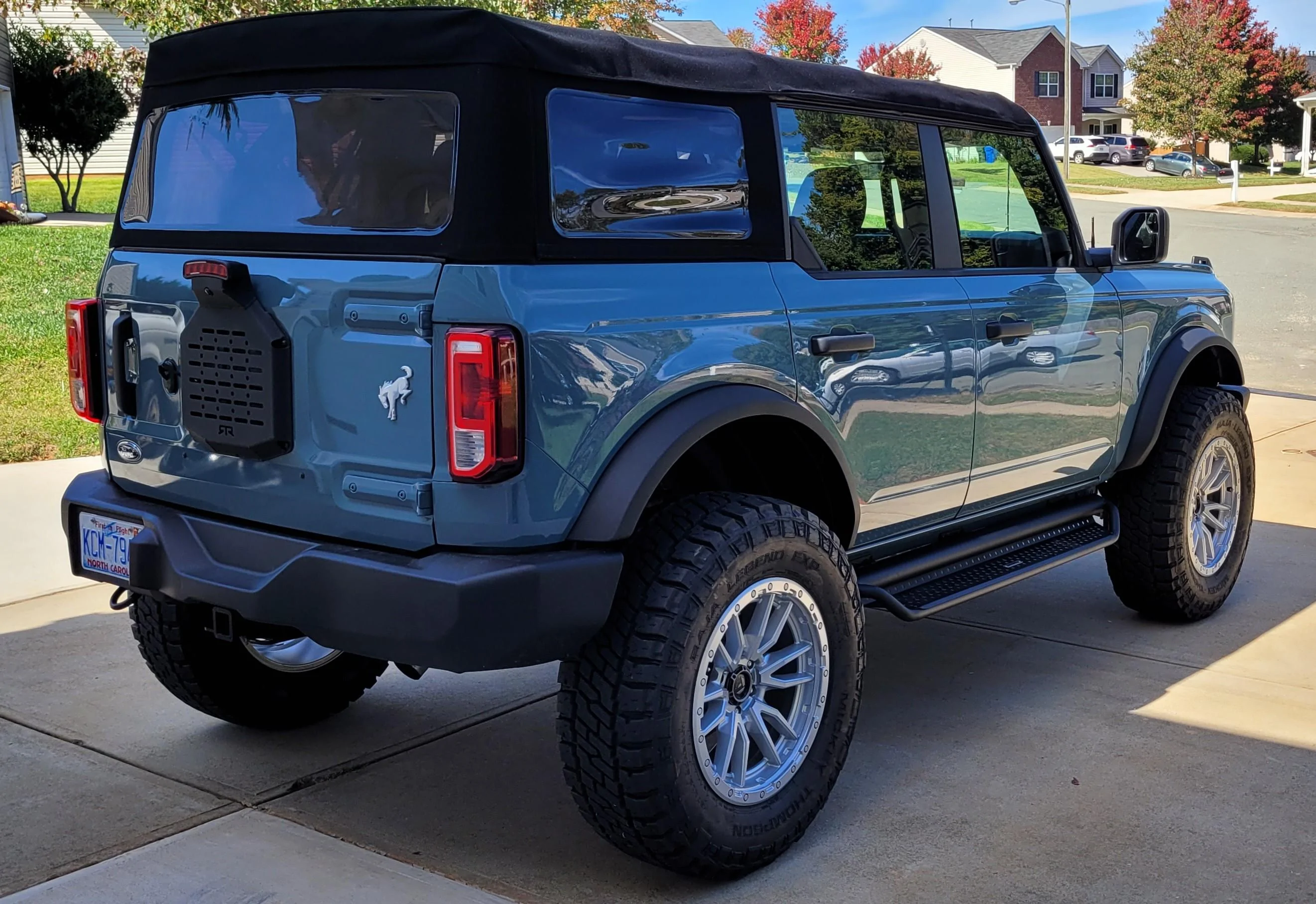

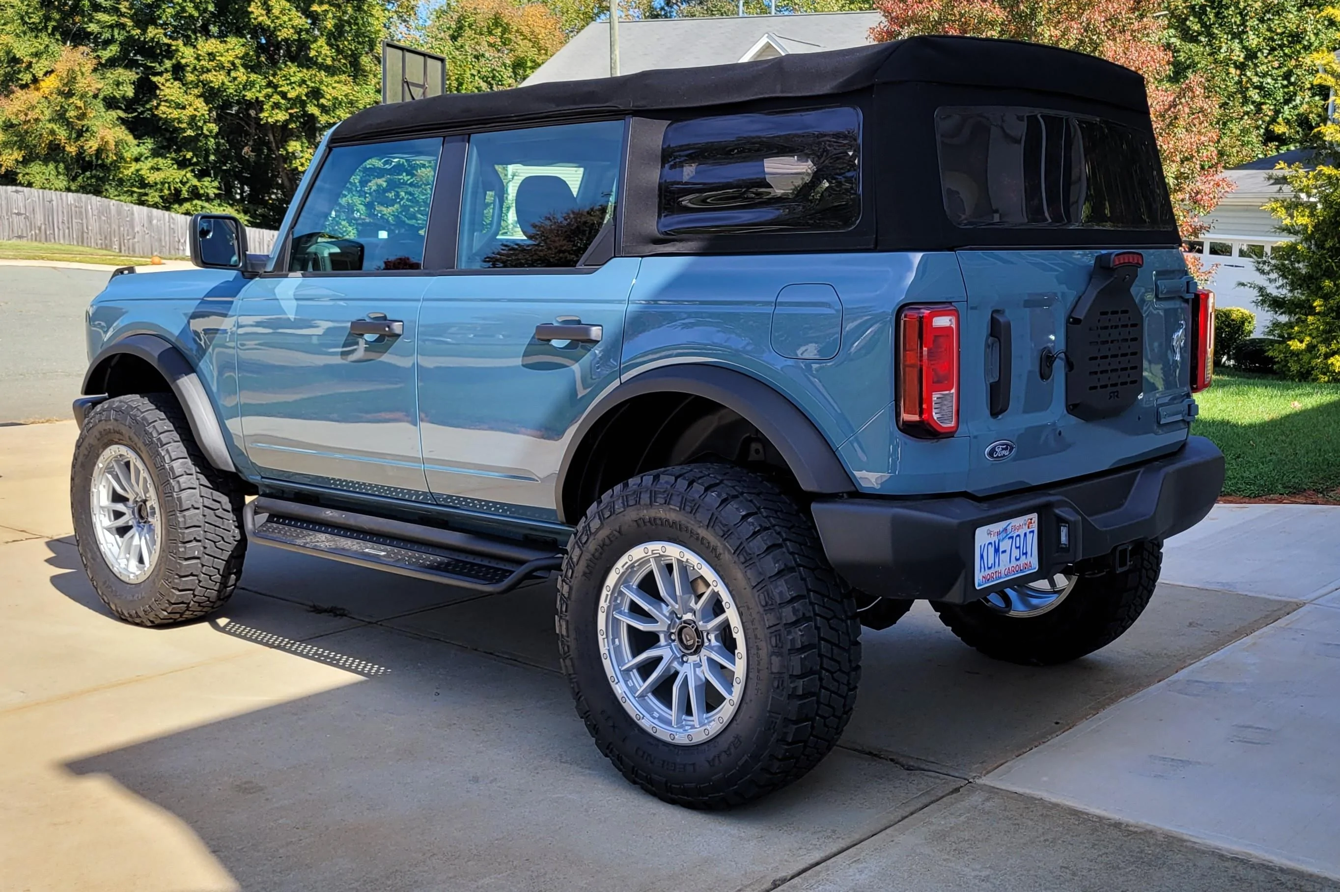

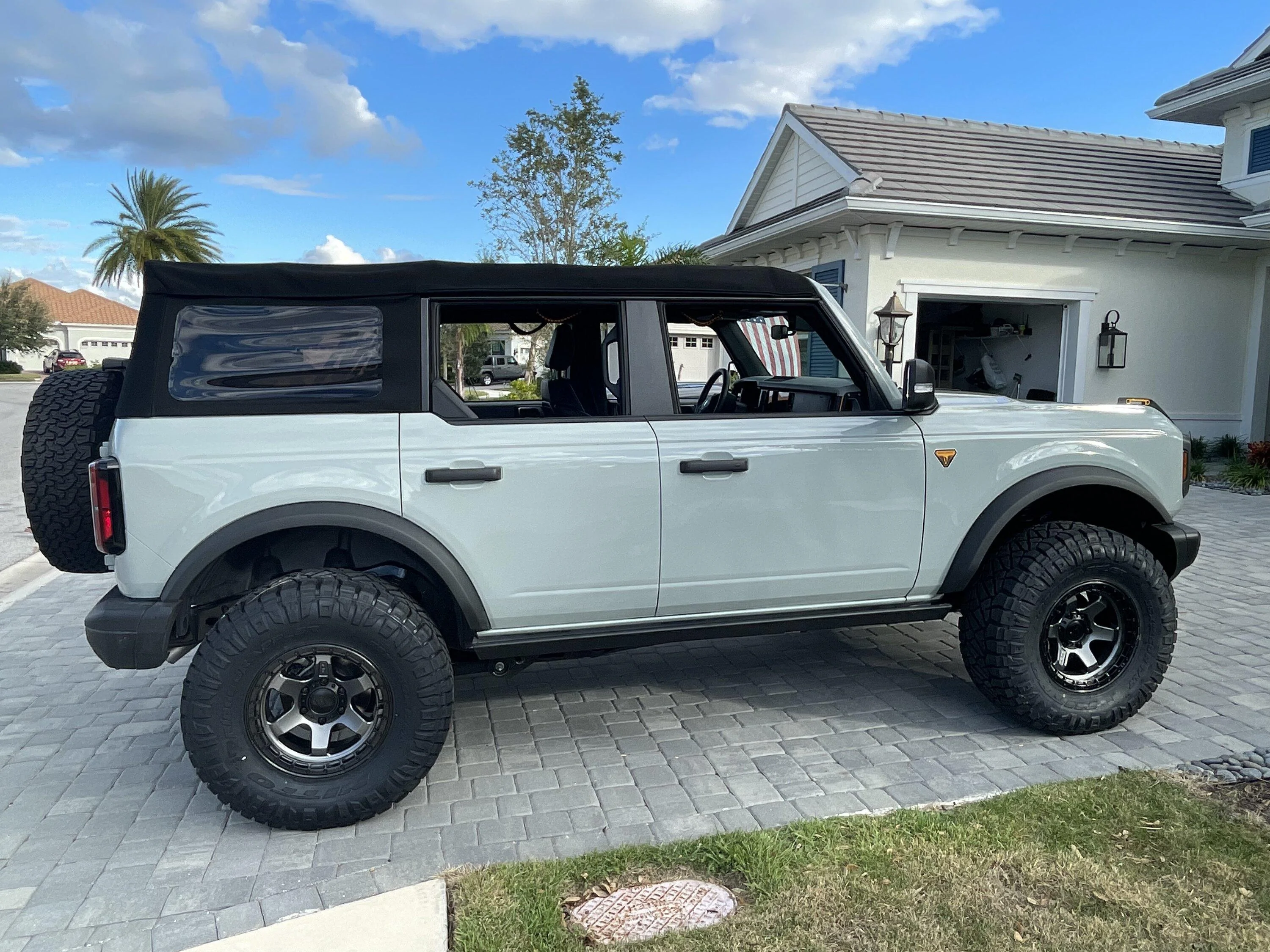

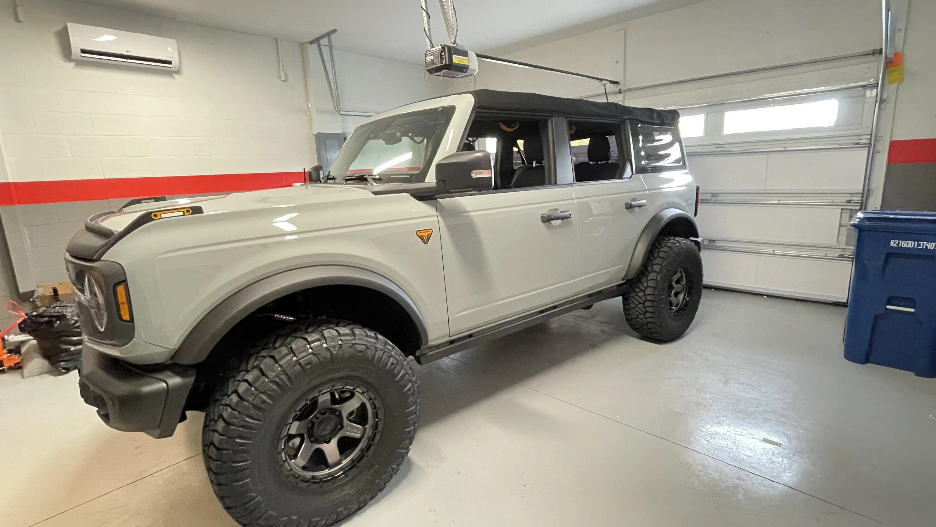

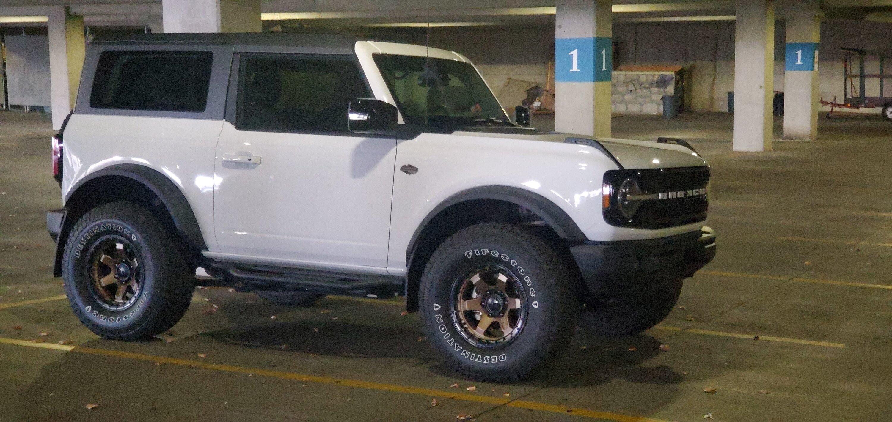

2.25” perch collars crash bars removed and BDS UCA’s.
35x12.50x17 Nittos on Fuel Block wheels +1 offset
Nice Blocks! I went with some bronze Blocks, but really love the look of the white letter Firestones, and they don't throw near as much gravel as the stock SAS tires.

I’m an old white letter guy but needed to move with the times, man she looks so sporty !!!, with the raised white letters

Thank you for the reply. The extra information you provided gives me the “go ahead” for this setup. Love the price point for this setup. Now I just have to sneak it passed the wife.

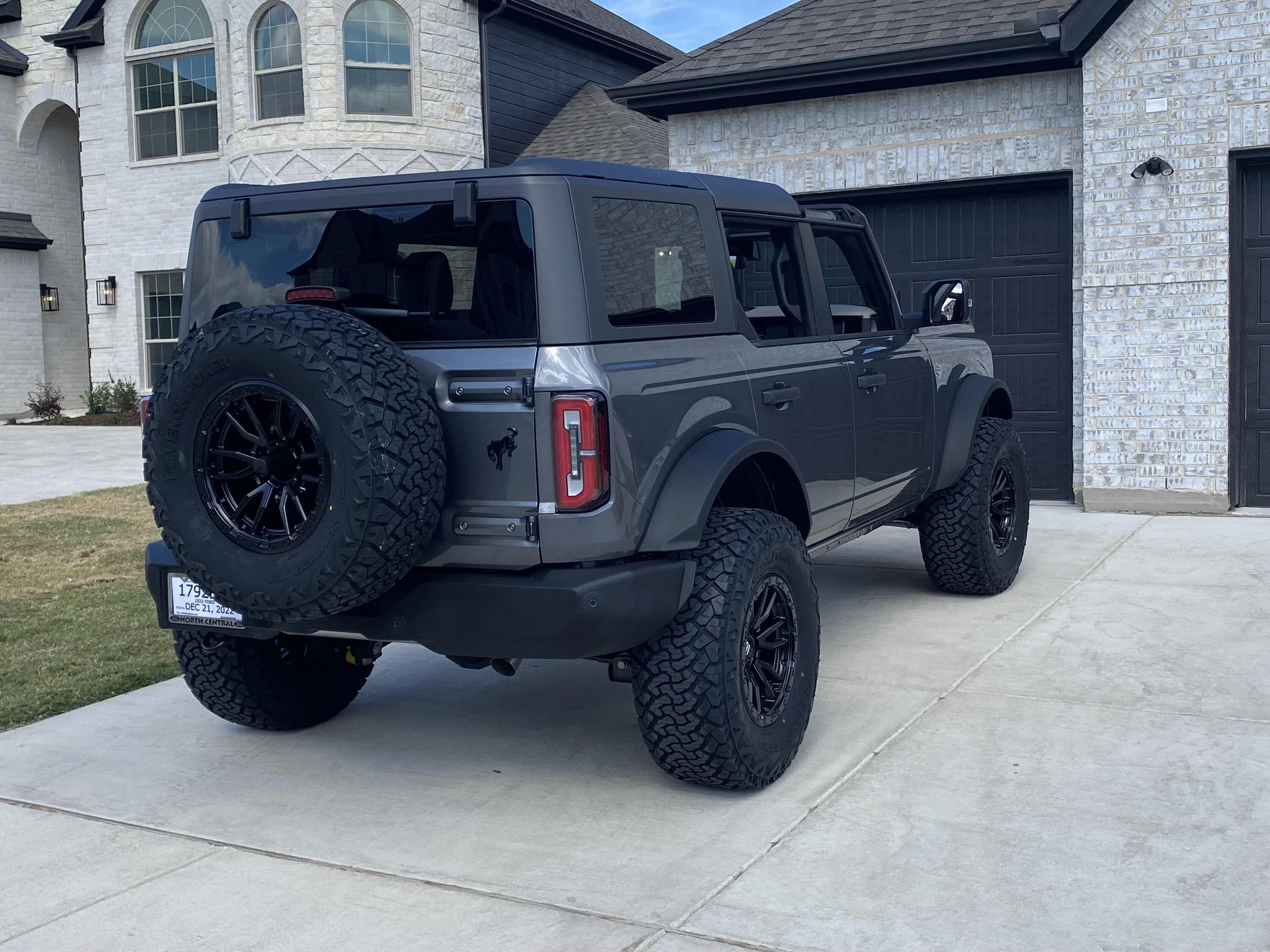

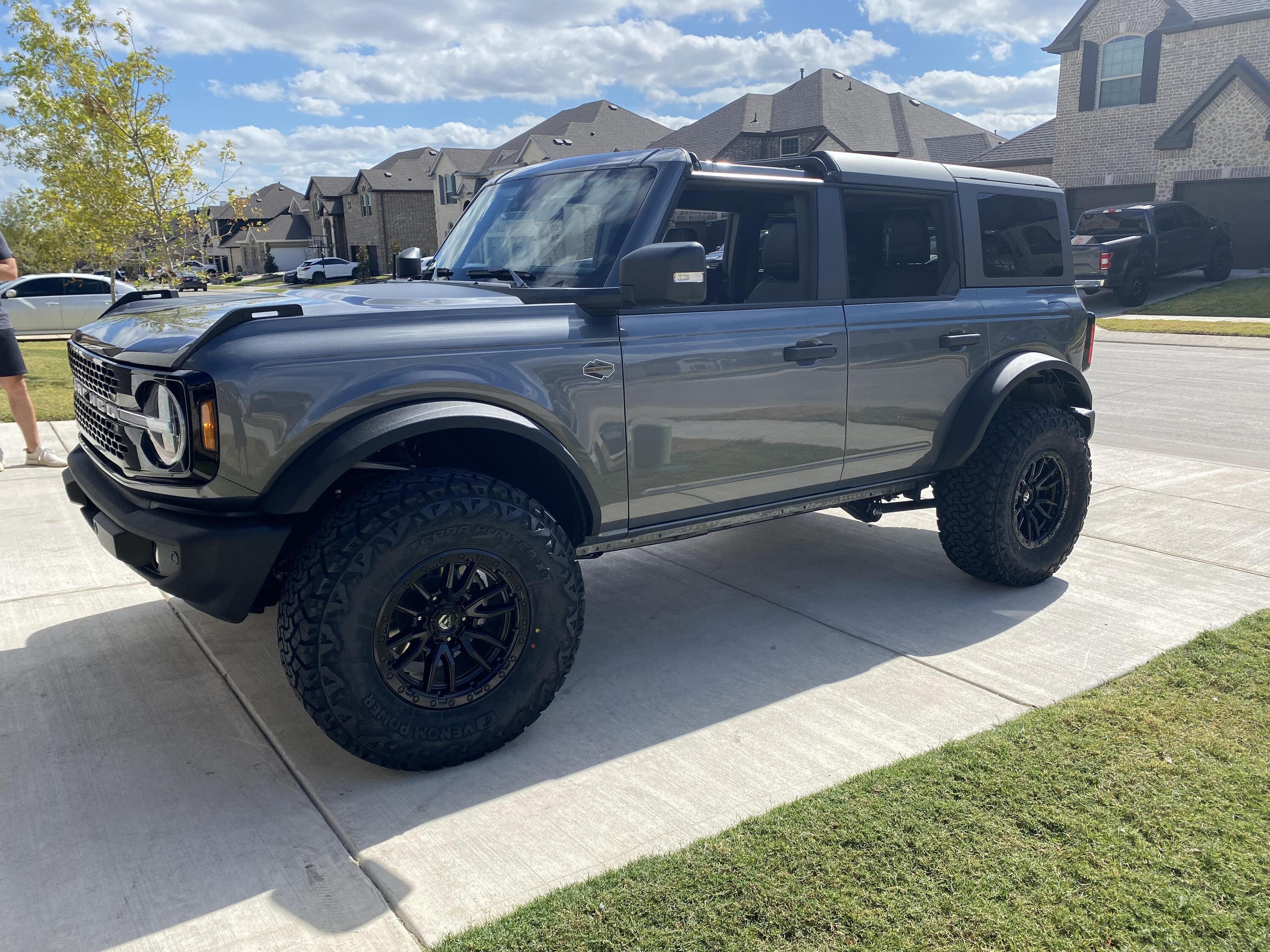

Fuel Rebel 17x9 -12
Venom Power Terra Hunter 35x12.5x17.
Sasquatch fenders (stock) aftermarket wheels gives us about a 1.5-2" poke. Its beefy!
I don't have any front profile pics, might add some later.

How much lift on that?

No lift sir. Just whatever the wildtrak sas adds from stock. No Hoss upgrade.
Also, no rubbing from the offset either.
